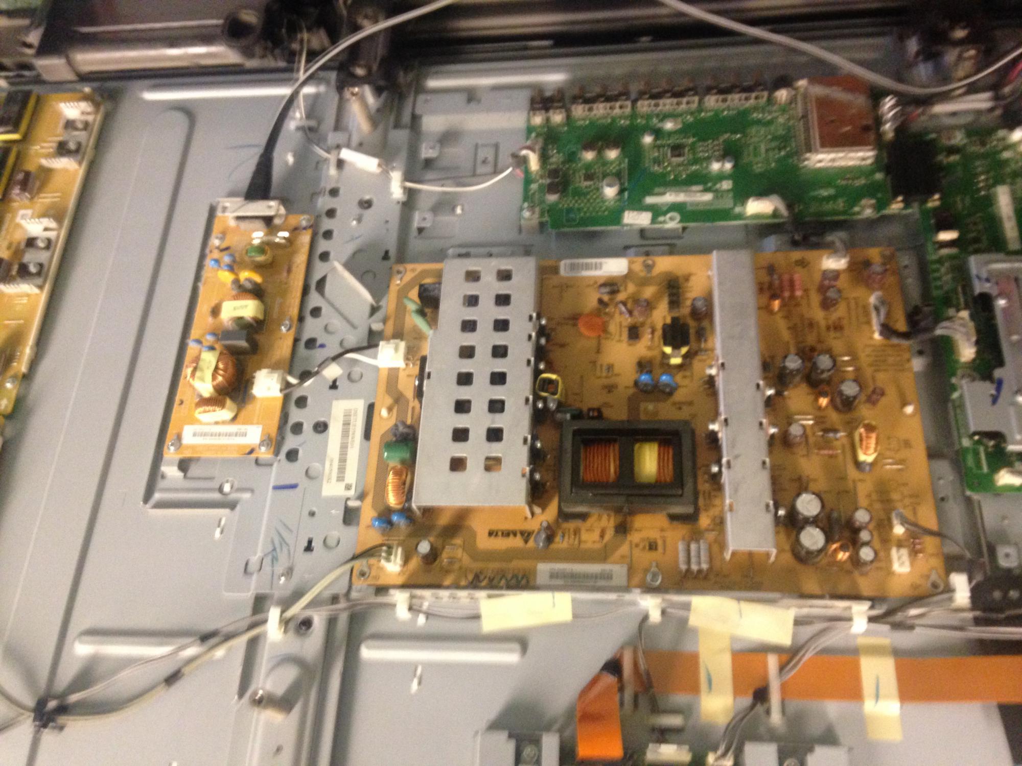

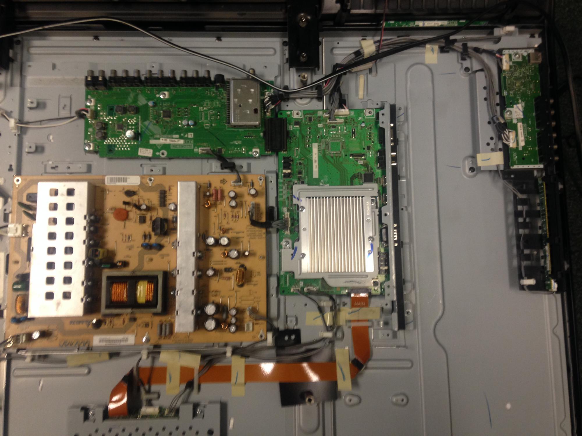

    Heres pictures of the boards. sorry the attachment things would still not work.
      Re: sharp lc46sb54u Troubleshoot.
      Could do with clearer pics please, Need to be able to see and read what is on the boards
        it'll be nearly impossible to the get whole board with legible writing. so ill start with the power board and upload those pics.
          Yes each of the boards is preferable

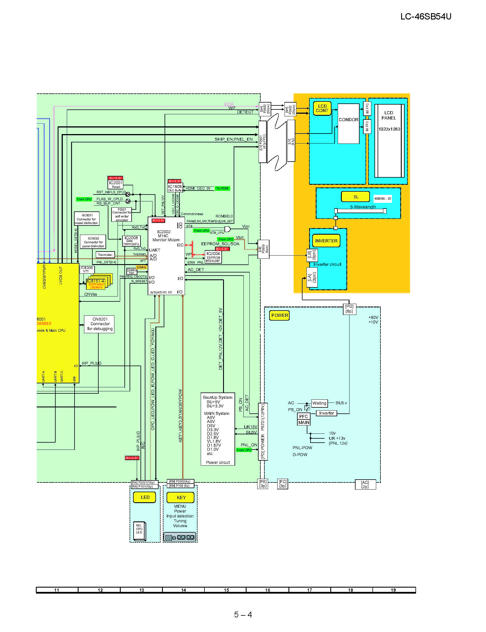

                            Per service manual page 49 5-4 block diagram, the power supply board gets the PNL_ON (>2.5VDC = ON) from CPU of the main board, then the power supply will put out 12VDC for the PNL-12V.
                            So if the command signal is there but no 12v PNL, then you need to do more troubleshoot of the power supply board, the service manual does not provide the diagram for the power supply because it is made by other OEM.
