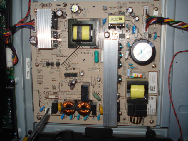

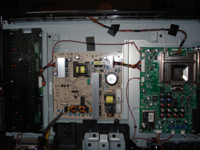

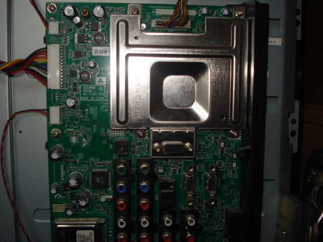

    A friend asked me to see if I can fix this Sony 26" LCD TV. It has been sitting for awhile and when I first plugged it in it came on and had power on light, I left it on for about 10 secs, then unplugged it to move to another location, since then I have not been able to power it back on and the STBY Light in front is not lit. I have voltage readings as follows.
    PS Board
    P on 2.6 V
    AC Det 2.7 V
    ST BY 3.3 V
    Unreg 15V is 16.3 V on both pins
    Reg 12V is 11.9 V on both pins
    Connector on PS Bd that connects to Inverter Bd
    Reg 24V has 24.7 V on all 4 pins
    3.3 V is present on both the IR Board and the On/Off Switch board.

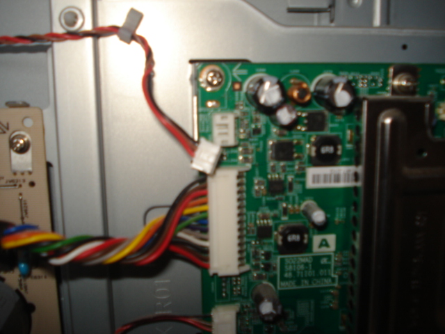

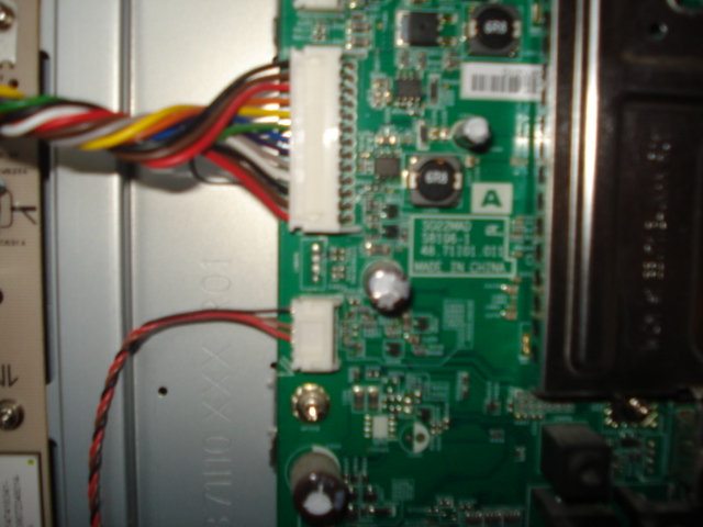

    Back Light will come on if I unplug small 3 wire connector (CN202) located at the top left of the Main Board, shown unplugged in Picture.this goes from the main board to the inverter board.
    I have tried freeze spray and heat on the Main bd. processor and got no response at all.
    Any help is appreciated. Thanks in Advance.

    If you got standby voltage going to the main board, no reaction on the Power LED and no PSON signal coming form the main board to the PSU, while trying to turn on the tv, looks like a bad main board to me.
      Re: Sony KDL-26L5000
      On left side of main board 3rd connector down from top is CN4201 and has 0v at black/top wire, 3.2v at middle/brown wire and 3.2v at bottom/red wire, when on/off switch is pressed the pin at the bottom red wire at this connector drops to 0v, then returns to 3.2v when on/off button is released. I'm not sure if this is normal.
      I think the problem is on the main board, I'm going to remove it later and inspect the back side of it.

          I have 385 VDC across the main capacitor, removed and inspected main board, no signs of any burnt traces or bad solder connections as far as I can tell.
          Could be the BGA connections are bad on the main processor, not sure.

            Right now you are getting the PS-ON otherwise you will not have the boosted Voltage, the 24V, 12V, ect. PS-ON is stuck at this point, may be.
            The connector that you removed there are pin names which I cannot read due to the picture is not focused, what are the names for those pins?
              The connector that you removed there are pin names which I cannot read due to the picture is not focused, what are the names for those pins?[/QUOTE]
              Those are reference numbers for components, R212, C201, R259, R217. Unfortunately there are no pin names at that connector only the reference CN202
                OK, I found good pictures at SJ, and can see the connector now.

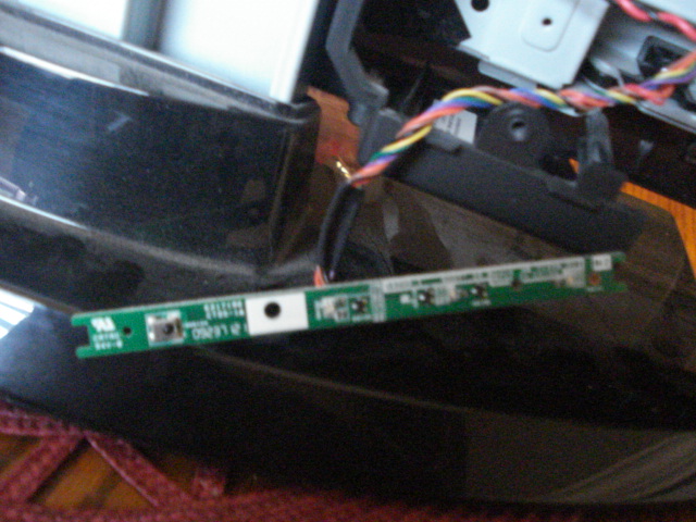

                What happen if you disconnect the button board? The TV is on without pushing the power switch (the boosted voltage and other Voltages are present).
                  Bud, I disconnected the button board and there is no change, all the voltages are still present but no backlight, no picture, no sound and no standby or power light in front.
                  This tv did show a picture and powered on (without me pressing the on/off switch) as soon as I plugged it in the first time but would not power back on once I unplugged it then plugged back in, I think it had been sitting unused and put away for several months.

                      I just took a hair dryer and heated up the main processor real hot on the main board while the tv was plugged in, then unplugged the tv and when I plugged it back in it powered on with sound and picture.
                      I suspected this area all along, so the problem must be the BGA solder balls and some were not making a connection, using the hair dryer heat has expanded that area making them re-connect.
                      I know this is only a temporary fix but gives me the chance to check the screen and other boards so I know only a replacement main board is needed to fix it. Still up and running for 20 mins now. I haven't had much luck with reflowing BGA processors

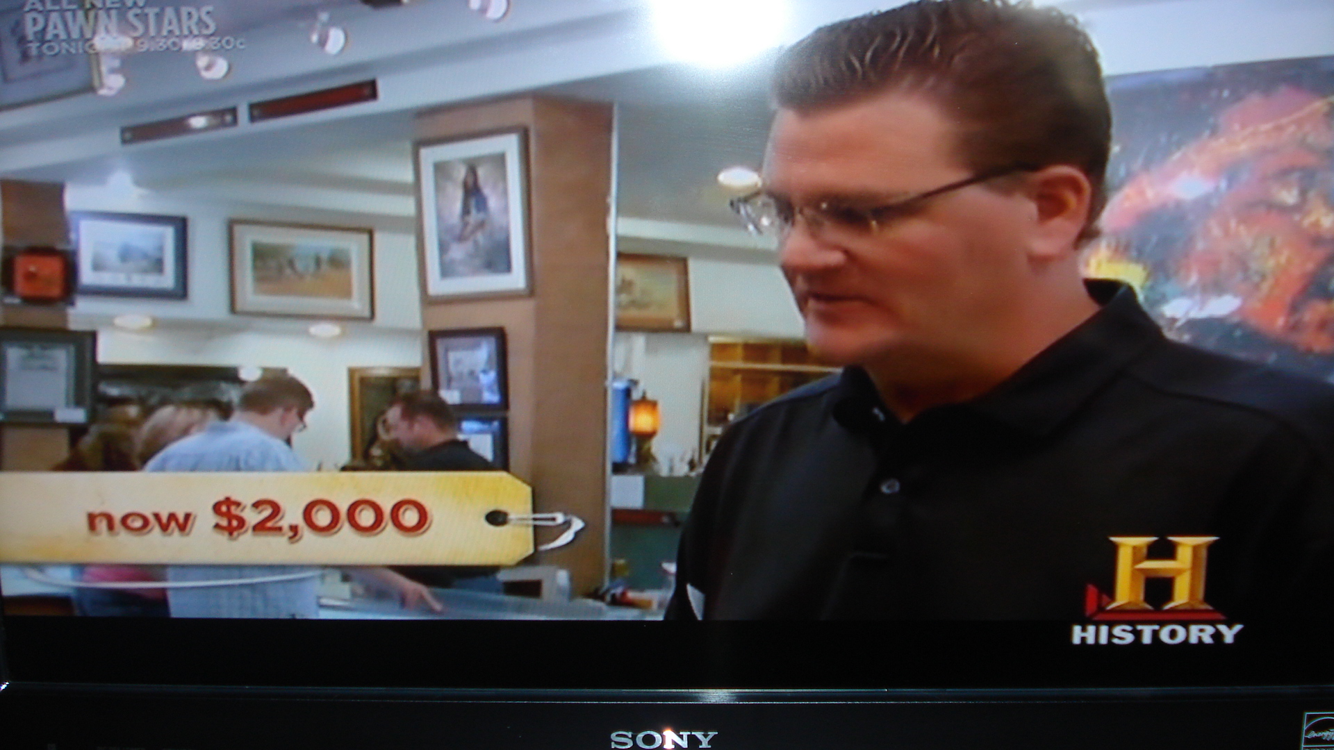

                              Thanks newtothis for all the great information, I had this TV powered on for 2 hours last night and 4 hours today with no problems, I wouldn't think the high heat from a high powered hair dryer would have actually melted the BGA solder.
                              Instead of trying a reflow, I placed a piece of surgical tubing (that I have for use in tab bond repairs) in between the heat shield and thermal pad at the top of the BGA processor, reinstalled heat shield and tightened screws down to apply pressure to the BGA Processor.
                              If it continues to work as long as I'm testing it I will give it back to my friend to try, if it quits again will order a new main board Sony 1-857-322-21 ( SO22MAD) SB106-1 48.71I01.011 if available and they are willing to spend the money.
                              Thanks to everyone that chimed in on this. here's a picture of it working.

                                If the BGA has poor solder joints it WILL fail again trust me.... Found it real funny how people used to bolt the heatsinks down on Xbox360's in hope of reconnecting the poor joints... All it will do is warp the board due to pressure and break even more
