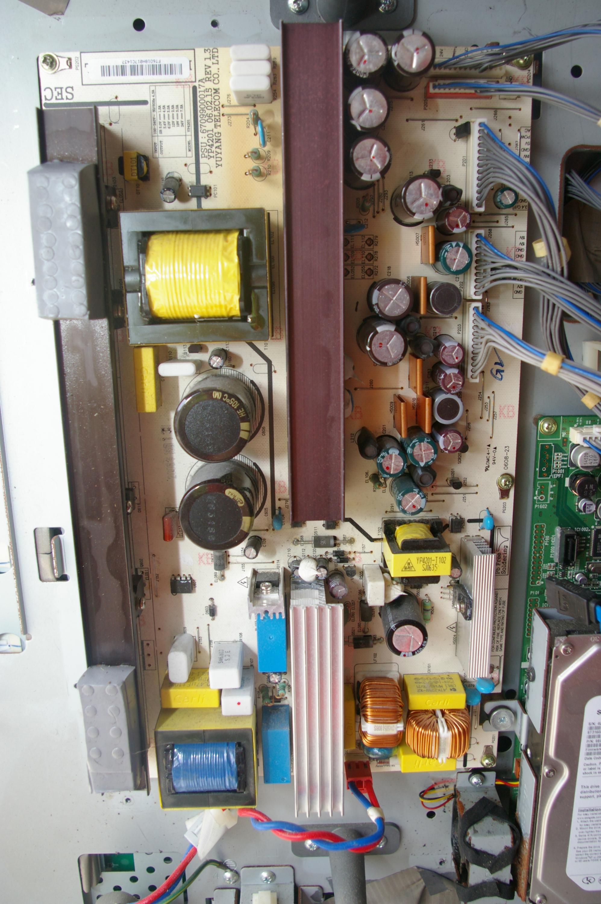

    Picked up this set a week ago . It's an older LCD with a "built-in" DVR. The guy I got it from said he'd fixed the set once in the past with cap replacement on the power board. Then, problems popped up again, and he says he tried both cap replacement, and a new (refurbished) board. He even gave me the old power board - so i have two of them.
    What seems to happen is if the set is started from cold, it will run for up to a minute or so, then shutdown to a red power led. I believe that's "protect mode" according to SM. After that (when warm) it shuts down faster.

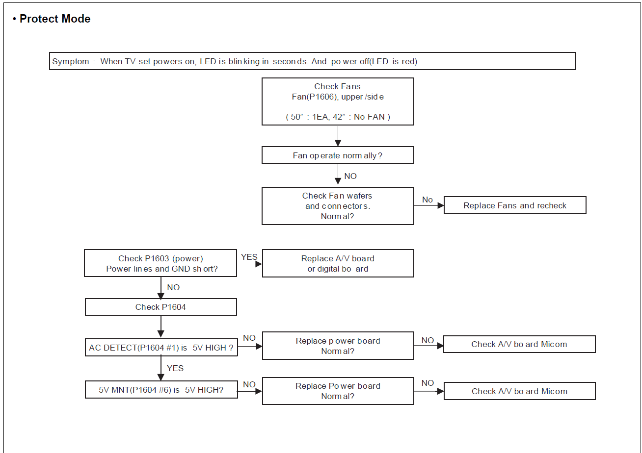

    Getting confused on this, because it seems the shutdown could be cause by power, main, or signal boards. Found a flowchart in the SM. Have tried to follow it, along with checking supply voltages. Supply voltages look good, except for one 6 volt line (if my eyes are reading right). Also, if "pin 1" on P1064 is the blue wire on the plug, then it is 5 volts high, which i guess would indicated power board problem.
    I'm not sure on the check for shorts mentioned in the flow. There are some leads that test positive to ground, but I'm not sure if they are labelled as power leads.
    If I can't easily fix , I'd just really like to narrow down to which board is the culprit, or likely culprit.

      Do some checks to find out. Disconnect the main board from the PSU and force the PSU on with the backlight connected. See if it still shuts down or not.

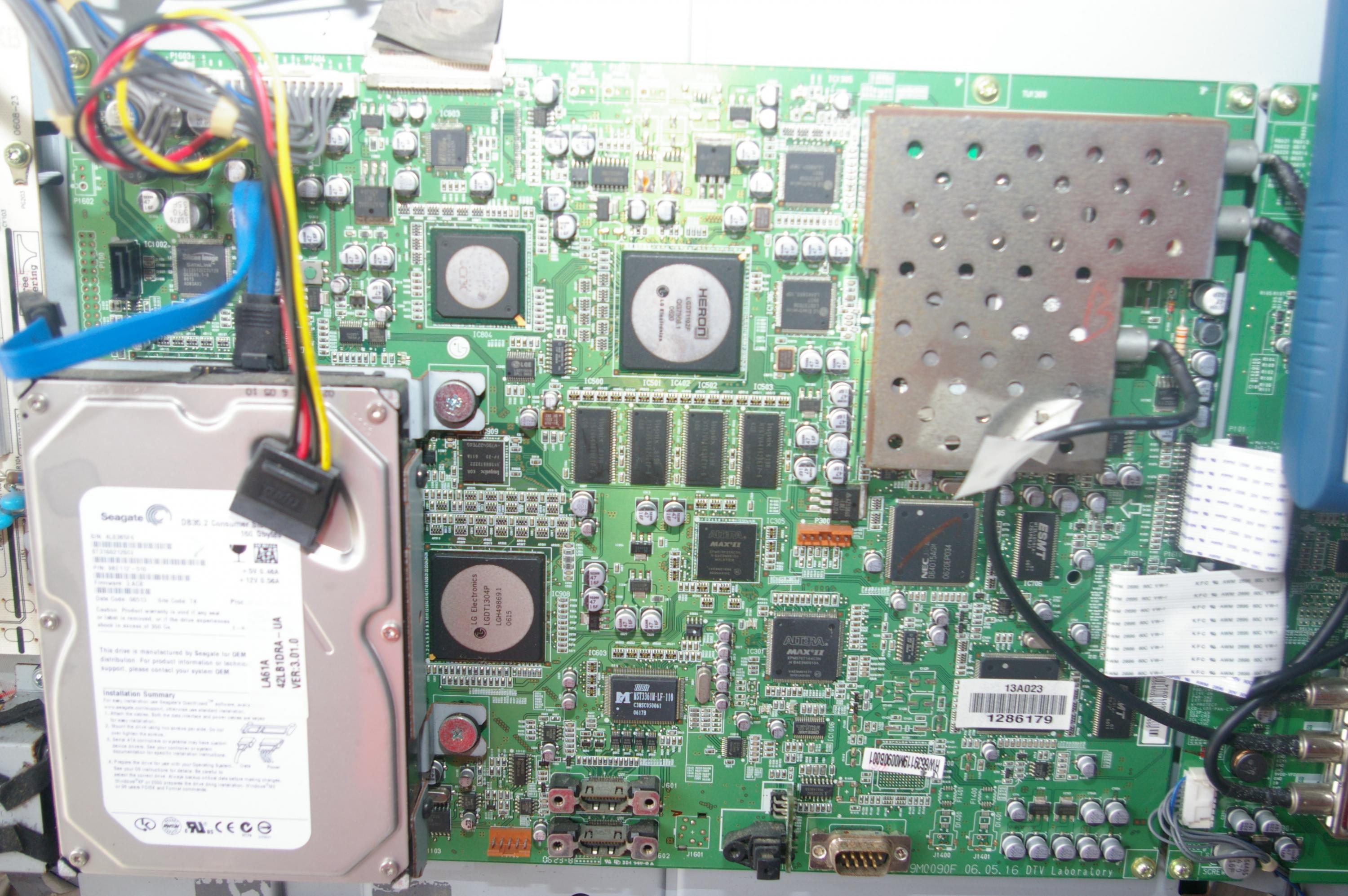

              I actually noticed that, and tried testing the the hard drive completely removed, and that hdd cooling fan unplugged. Made no different, so I'm assuming it's not the fan.
              I do see a red led , along with two briefly flashing green led's on the mainboard before shutdown.

                          The fan is a 3 wire. took it out. the rust is really just on the bracket, but the assembly was coated with some sort of goo. Still no go. Not sure if I can replace temporarily with some sort of pc fan, or somehow test this one?
                          Is there any documentation out there on this mainboard? I notice these two green blinking led's. they start to blink until shutdown.

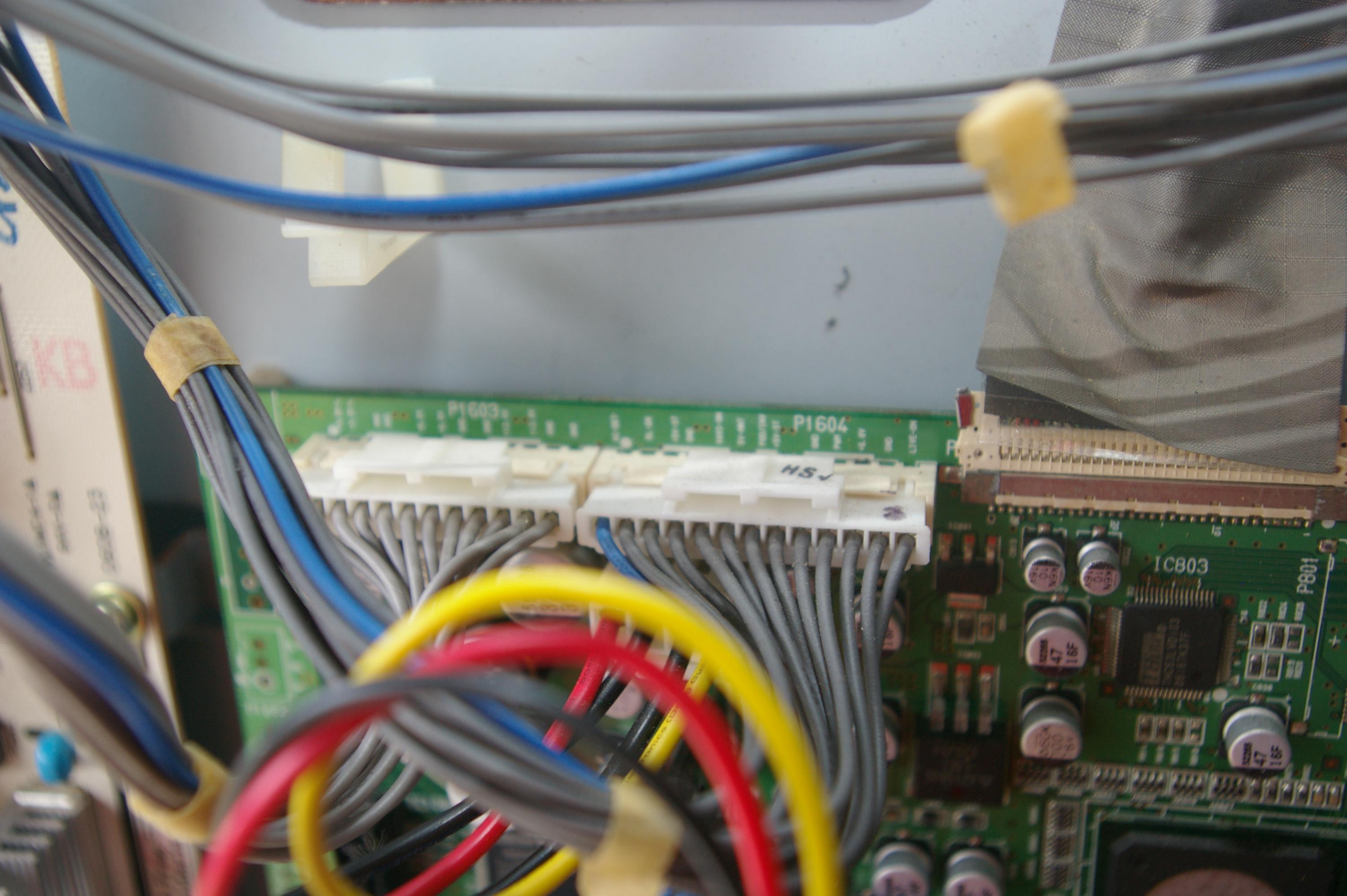

                            http://www.digikey.com/product-detai...399-ND/2560523
                            this appears to be the fan. has a "locked rotor sensor"
                              Re: lg 42lb1dr turning off. (protect mode)
                              Normal condition (FAN is spinning) the Blue wire should be LO (<0.5V), it will go HI if it locks up. So look at the Blue wire.

                                Thanks Bud. Actually the wire colors are red/black/yellow, and I assume yellow is the sensor.
                                I found a computer fan with 3 wires, but I'm not sure the sensor wire is the same.
                                Also tested the fan, and it does appear faulty. Would not spin with my bench PSU.
                                The computer fan spun with the TV, but still same shutdown. I'm now wondering if the yellow wire on the computer fan isn't sending the proper -5v signal, if the fan is indeed the problem. Any way I could easily recreate that?
                                  You need to get the spec sheet of the PC fan since we do not know for sure what the signal pin is. What Voltage do you get at the yellow wire of the old fan, if it is high then you can ground that wire to chassis to fool the sensing circuit.
