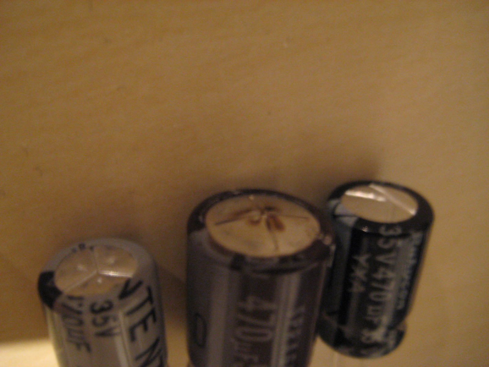

    Can we see the picture of this 470uF 50V cap?
    What other 35V or 50V cap do you have around?
    Something is not adding up here.

        Re: Vizio 47 vo47l power supply DPS-433BP
        from top to bottom, first, second, third time. the first and third caps in picture are good, but it is the same as one I used. because I threw the first one, third one is still on the board.

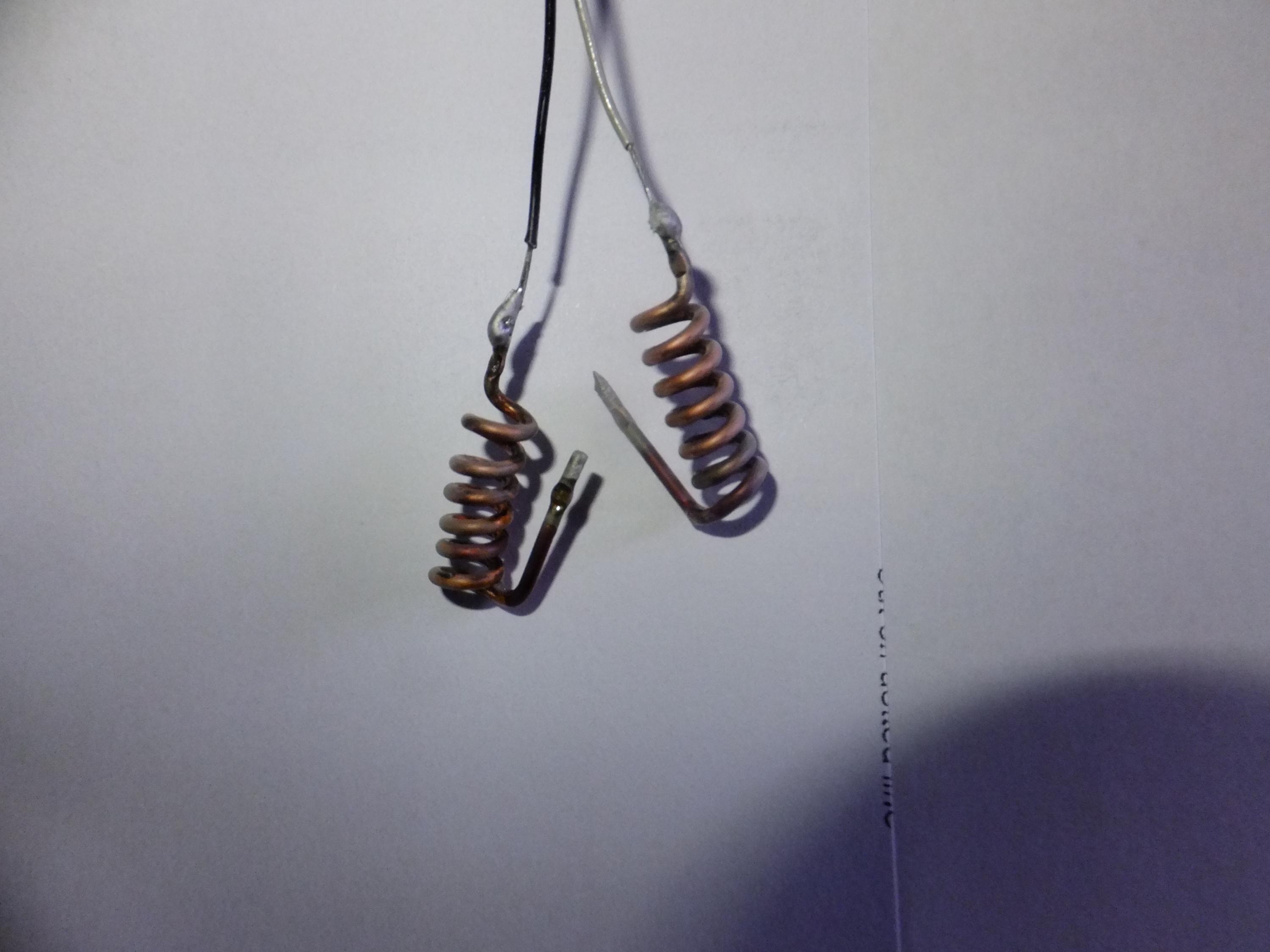

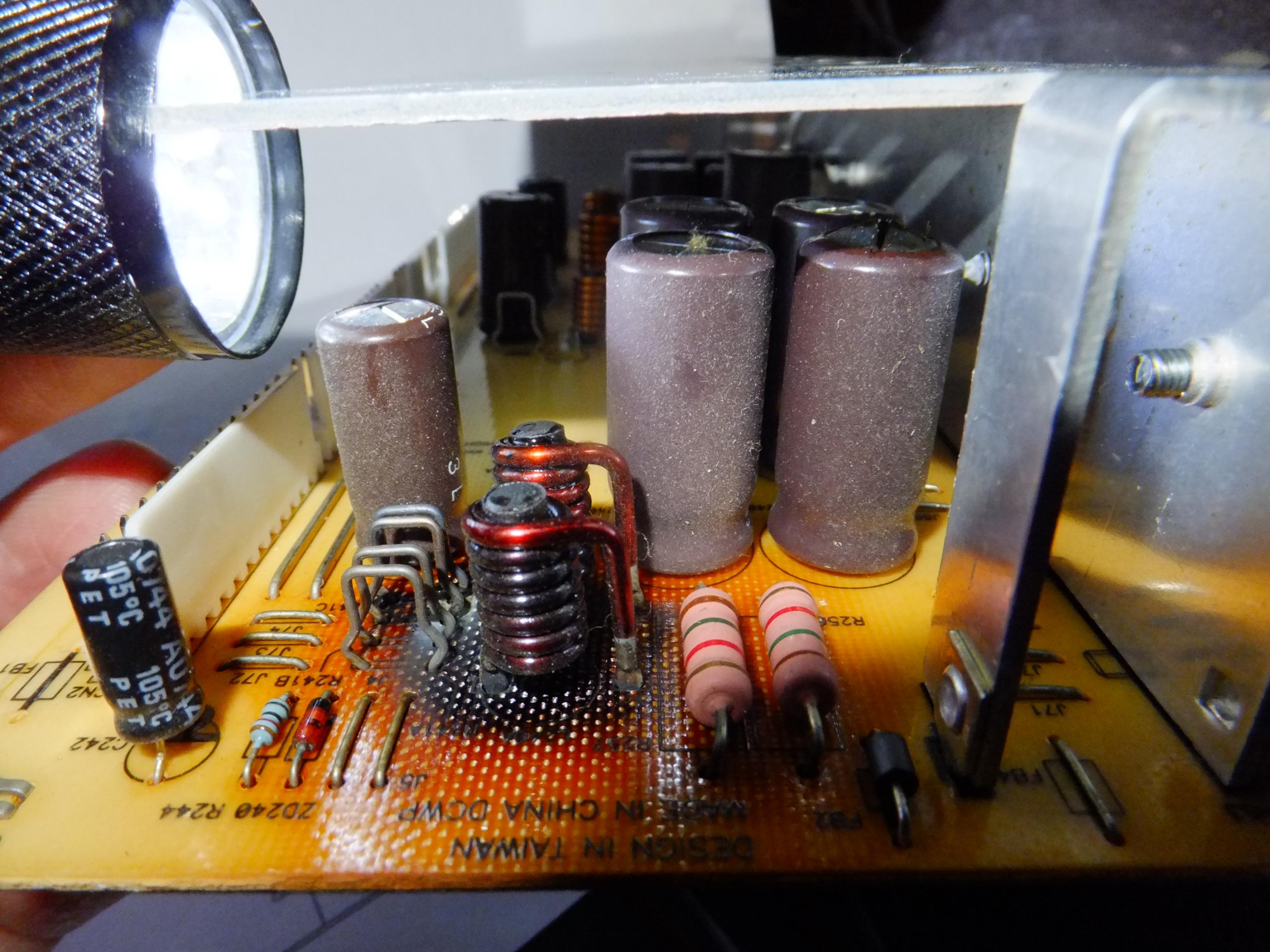

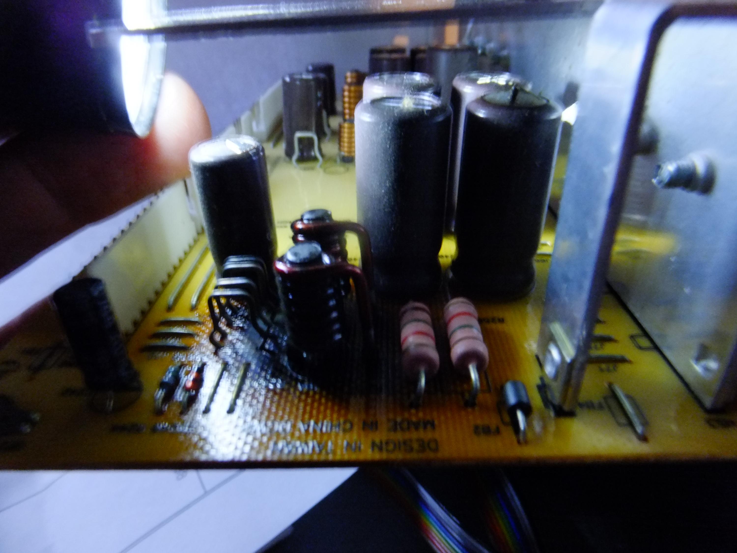

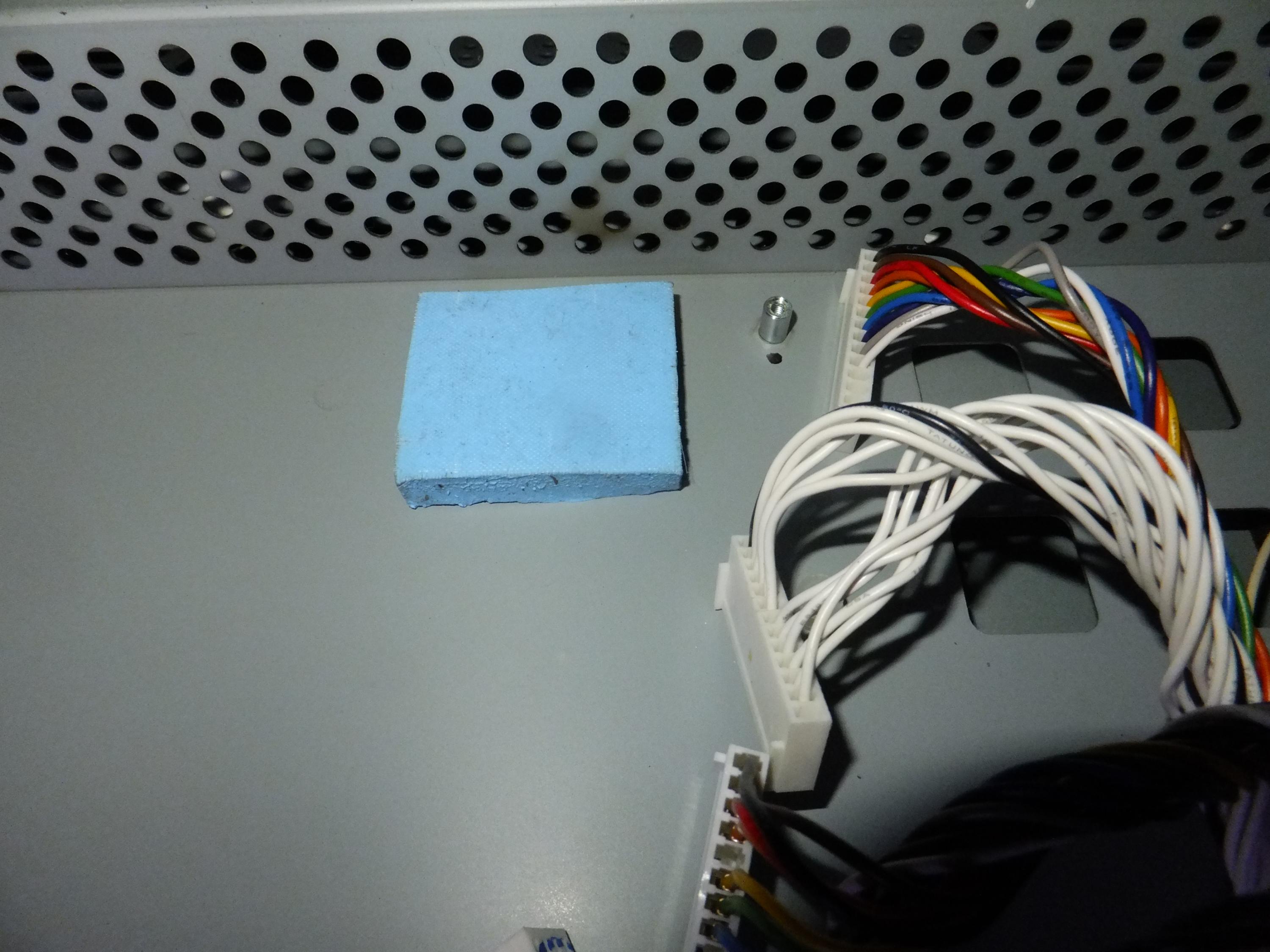

                              Wow, I wish I had sheen818's problem. I first found the 4 bad caps on the inverter boards and bumped up the voltage to 50v. Thought the TV would start right up but no way. Then I found the bad caps on the power board but I had more than just bad caps. Seems the board just about caught fire. Looking around online it seems this is common problem with this power supply.
                              I plan to change out the 2 coils and all the caps.
                              I need help identifying the 2 coils. I am not sure what they are called.

                                I think they are magnetic inductors. Still looking for the right one.

                                  I think you'll have trouble trying to identify the material the coil is wound on. It's ferrite material which all have individual specific properties to give the coil its inductance.
                                  You could remake the coils by using copper enamled wire of the same outside diameter and wind exactly the same number of turns (or partial turns i.e. it could be 4.5 turns) on the existing ferrite formers.
                                  The board is quite carbonised and to be honest I'm not sure it would be worth the effort.

                                    Considering these boards are selling for $100 used I would think my efforts would we worth the trouble. Tomorrow I am going to see if my friend has anything I can use and if not I will rewind it myself as you said. I have been looking all day and can't find anything exact so I have already planed on remaking the coils.

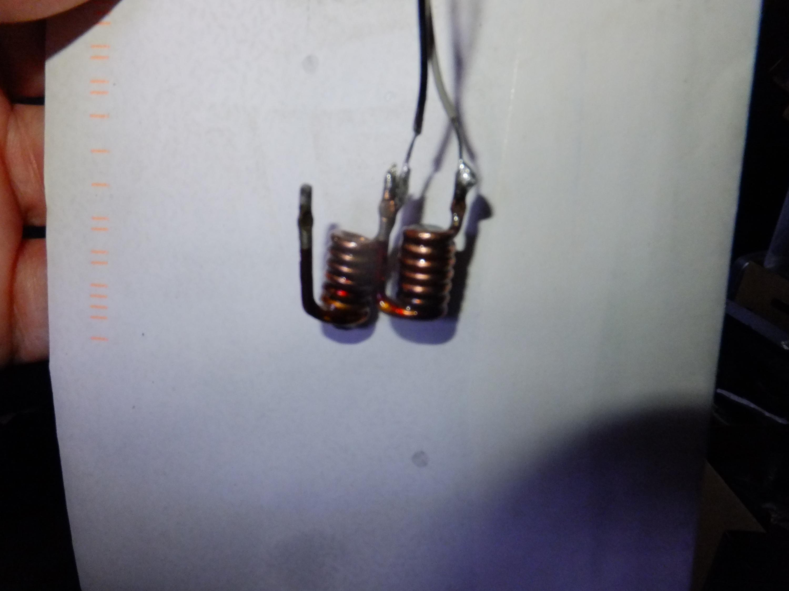

                                      Well I decided to repair the inductor coils. They got hot and burnt so I cleaned all the insulated coating off and resprayed them with Rustoleum acrylic spray (Clear Coat). Then I placed them them back on the board and also put a cooling pad under the board to the frame. And I added a cooling fan.
                                      The TV still has a problem, no power going to the backlights so I have to investigate the problem further.

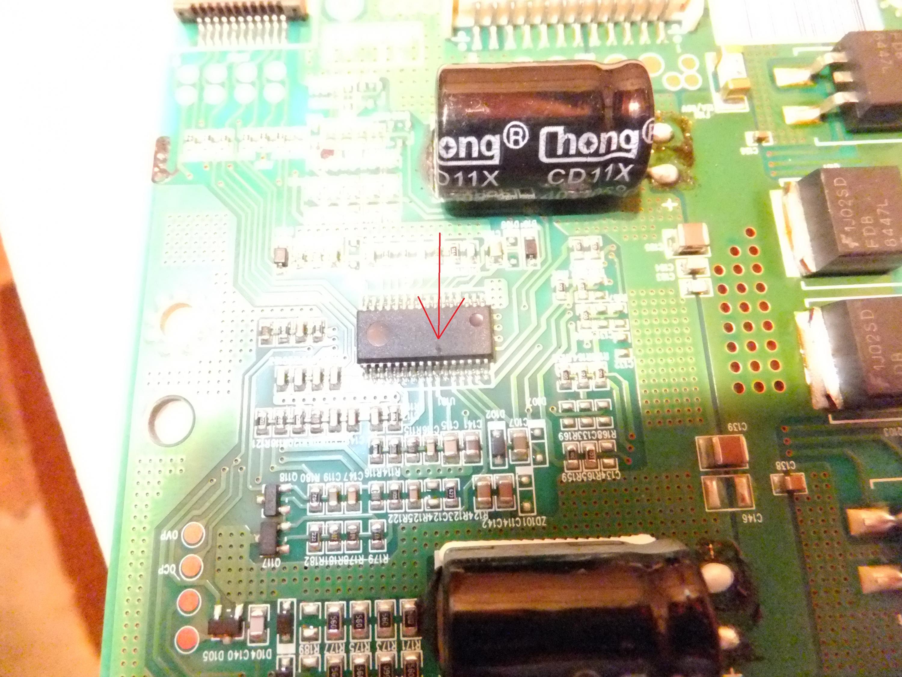

                                        Well here is an update. I decided to work on this TV again today because I got another parts TV in with a good Power board. Switched out the power board and I still had the same problem so I decided to look further into the TV.
                                        Turns out I did a good job repairing the Power Supply. I double checked the inverter boards for shorts and blown fuses but couldn't find any and I also checked the fuse on the T-Con board. I checked the main board and all seemed good. After all this I thought maybe the ICs on the inverter boards. So I looked up the datasheet and found pins 1 & 11 to be ground. Checked the Master Inverter and no shorts. Checked the Slave and I found a short on the IC and after looking under my magnifier I found a bubble in the plastic right where the short was. Just so happens I ordered 50PCs (BD9897FS) 6 days ago from China. Can't wait for them to get here because I have 3 TVs that need at least 1 BD9897FS. I will do a follow up after the parts come in.
                                        Here is a picture of the bad IC, as you can see it is barley noticeable.

                                          Yep, that is the typical failure mode, none of the four Power MOSFETS are shorted out?
                                          BTW, the Ferrite slug can be damaged by extreme heat.
