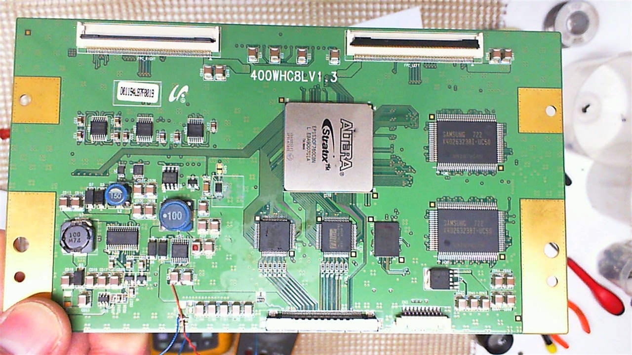

    400WHC8LV1.3 TCON schematic help needed

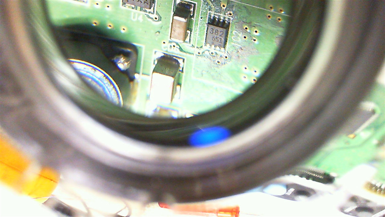

    What is IC2. It's a US8 package and reads 382.
    It's connected to the positive charge pump output of the TPS65160. This charge pump however is inactive as well as the boost circuit because EN2 is LOW.
    The EN2 also goes near this chip and there is a point where it says TCON_RDY. Could be some kind of supervisor chip? It's heatsinked though via a rubber pad, maybe a linear regulator?
    I don't get VGMA voltages on this board, not even sure where they should come from, it's a multilayer board, there are 3 chips reading i7514, not sure what those are either.

    The i7514HS seem to be 4x Opamps.
