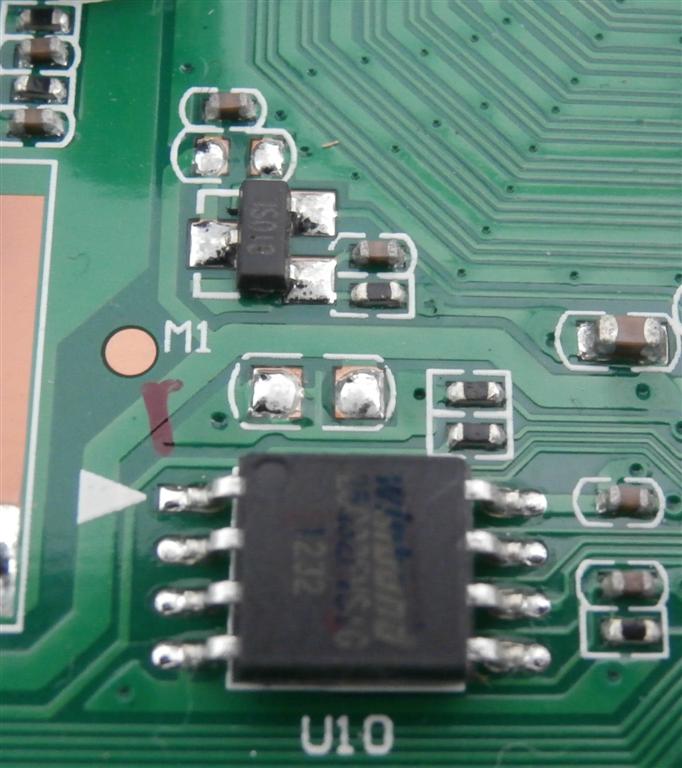

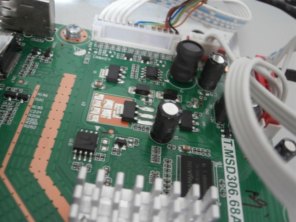

    This had the fault of getting stuck on the "Do not power off" "SCAN" loop each time the tv was turned on.
    I was all set for replacing a corrupt eeprom after reading various posts here and via google. So i had the tv apart to write down the board numbers and to give it a good visual check over.
    Everything looked fine. Anyway while i had it apart i thought i would give the eeproms and the SMD components around them a minute or two blast with my heat gun.
    I remembered that years ago this fixed an eeprom issue on a cable tv STB. ( stuck on TUNE )
    Its been two days now and the tv starts up every time as it should. Everything else with the tv works as it should also.
    So, worth a try for a quick fix before you order a new eeprom.

    Won't be permanent. Flash memory is affected by heat, what's going on here is they use cheap flash memory with poor data retention. It will just die in a few weeks.

        It's not an eeprom, it's an SPI serial flash which although also a memory device operates differently. It stores the software for the TV's operation. When it gets corrupted the TV software misbehaves. Heating it up is hiding the corruption, which might only be on a few single bits.

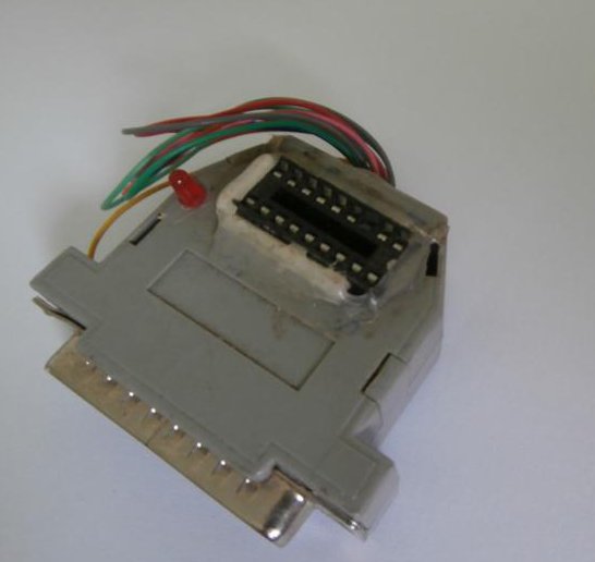

              About the SPI flash programmer. I have a few old (very) programmers somewhere.
              I have found this LPT thing, iam sure i used this to read and write eeproms a million years ago

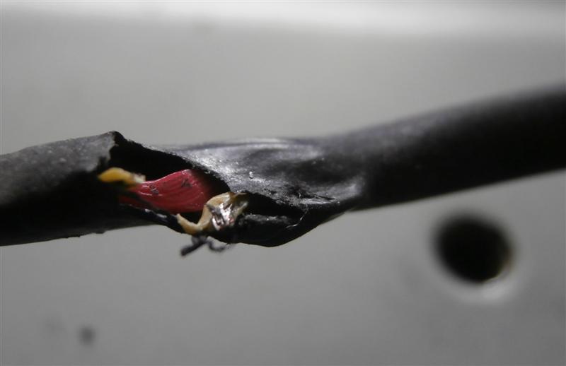

                  Just having another look at this today.
                  I think this might have something to do with the spooky goings on with the source menu.
                  The wires from the Buttons PCB. It was laying across a screw hole when i opened it up.
                  My fault i think
                  • SteveNielsen
                    Retired Tech
                    • Jun 2012
                    • 2327
                    Re: Do Not Power Off - SCAN loop (quick fix)
                    Had it been worked on prior to the initial problem?
                    • Lapwing
                      • Feb 2015
                      • 40
                      Ok...... it was my fault
                      The quick fix is still fixed though

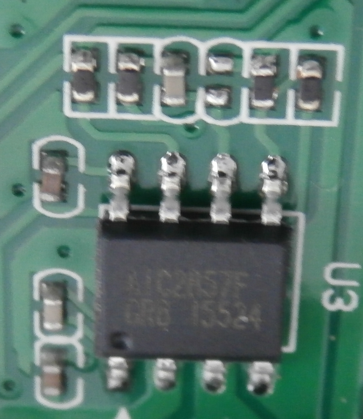

                                Originally posted by 4cc3ss
                                i resolved the issue by applying 470uf 16v cap across the eeprom Vcc and Vss, up to now
                                Hi have you got a picture ? Cant find datasheet to find out what legs are Vcc and Vss ? Its a 32 inch Logik i have with same issue.

                                  Here you go:
                                  It's a standard pinout for all SPI EEPROM chips. Vss = ground, pin 4, VCC, usually 3.3v but there are some 1.8v ones, is pin 8.

                                    So 470uf 16v cap across Vss to Gnd ? Im guessing negative leg goes to ground ?

                                        Vcc to GND. And yes negative of cap goes to ground, because VCC is a positive voltage.
