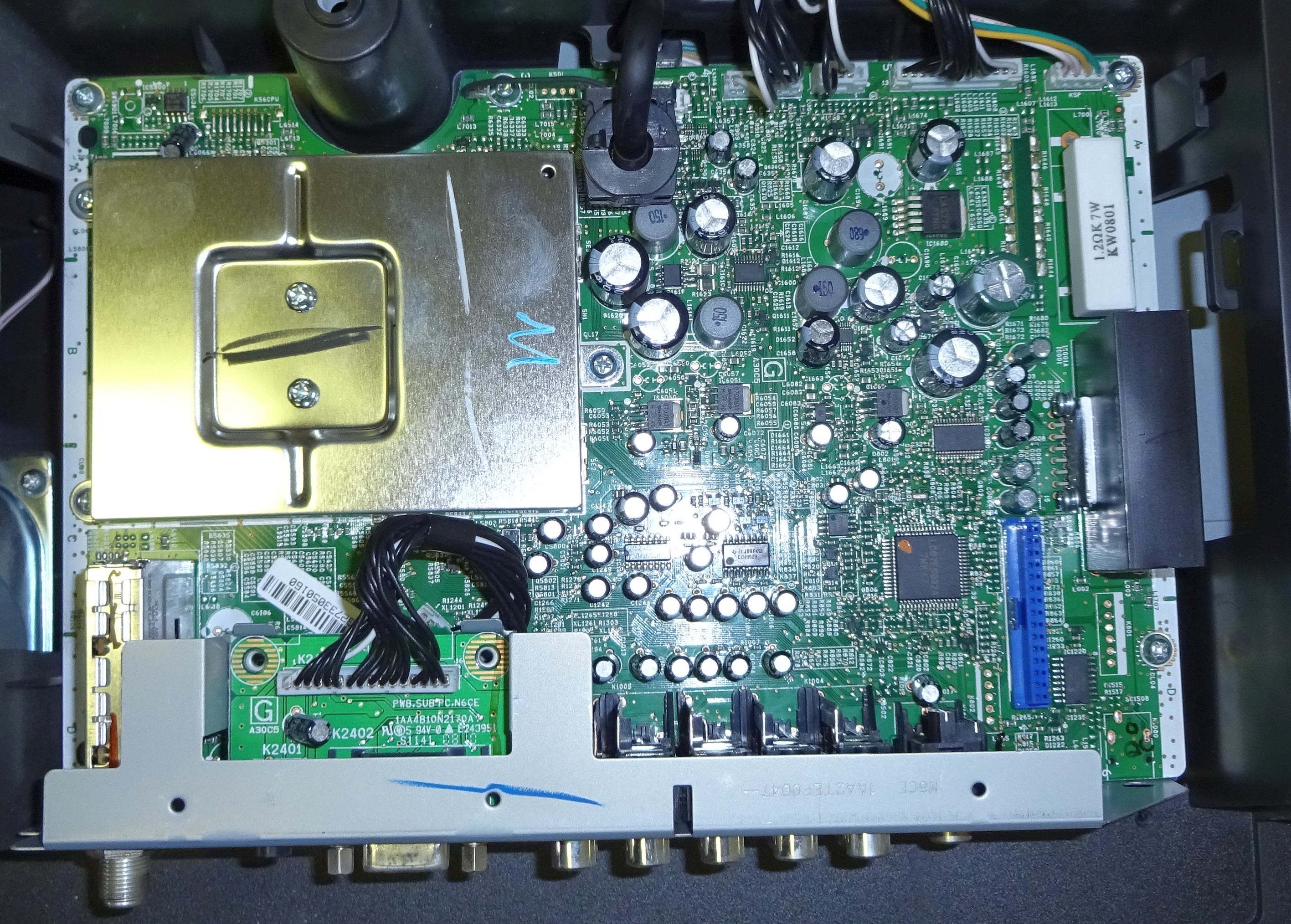

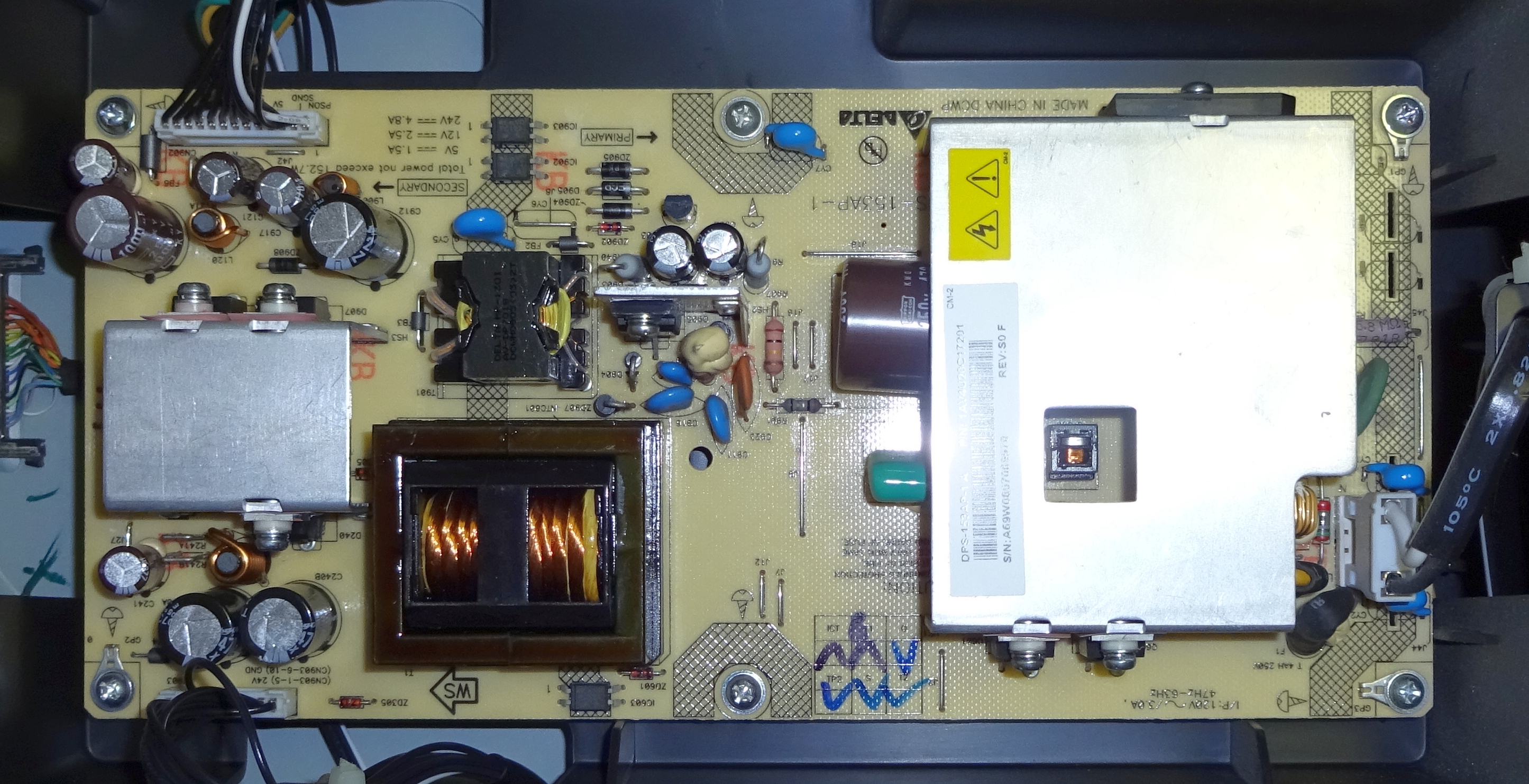

    I have a Sony DP26648 that works with the remote and power button on the side and turns on but only the backlight. I don't get any video or the menu or vol up/down graphic just the backlight only. Has anyone run into this?
    Re: Sanyo DP26648 Only Backlight
    Replace ribbon cable connecting panel to the t-con board # n6ce ffc. Common problem with this set.
      Is there anyplace to get new ones? I can't located any used.
