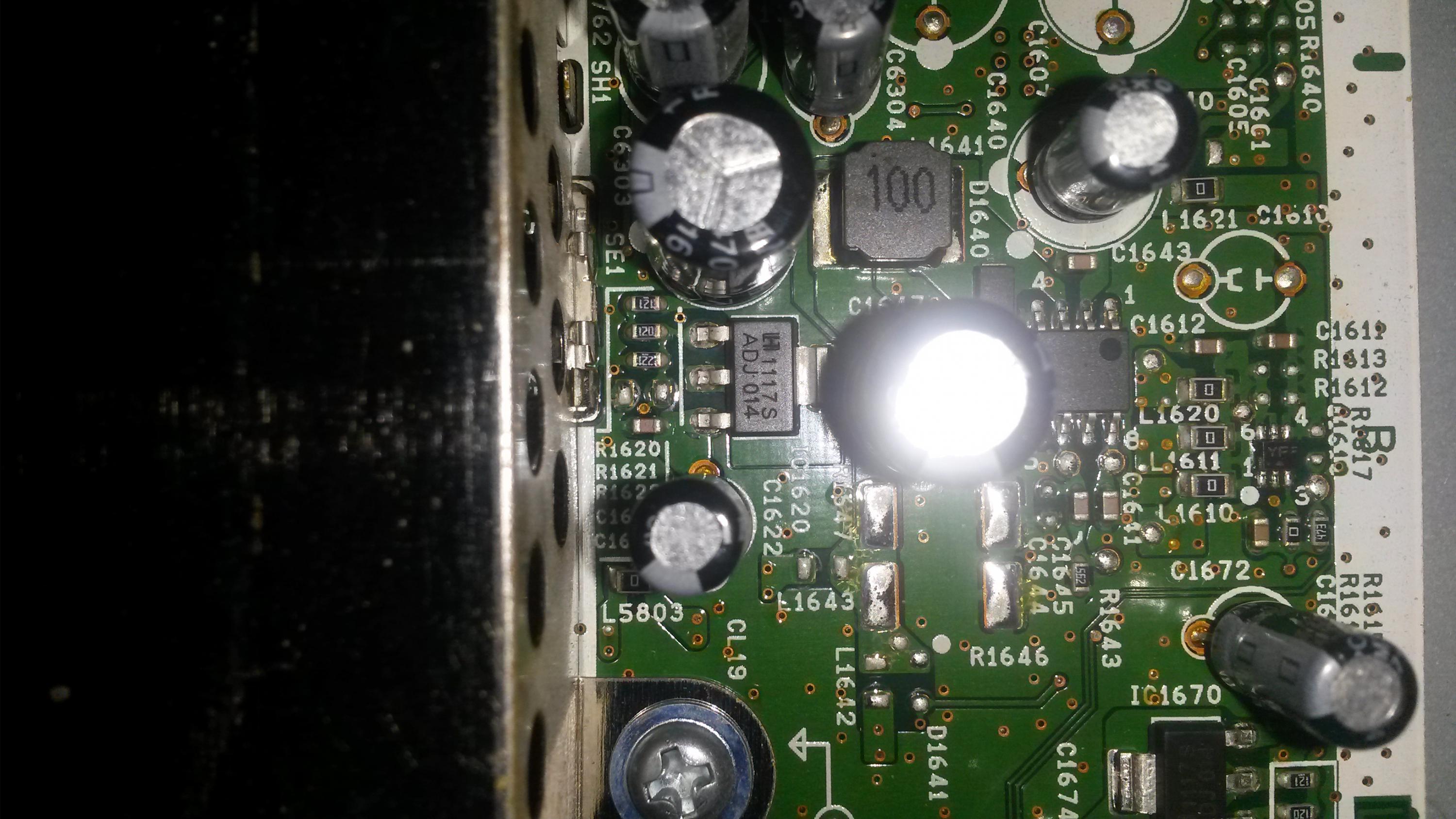

    Hi, this TV when turned on the green light comes on then after a second goes back off.
    No picture, no back light, no sound. Dead

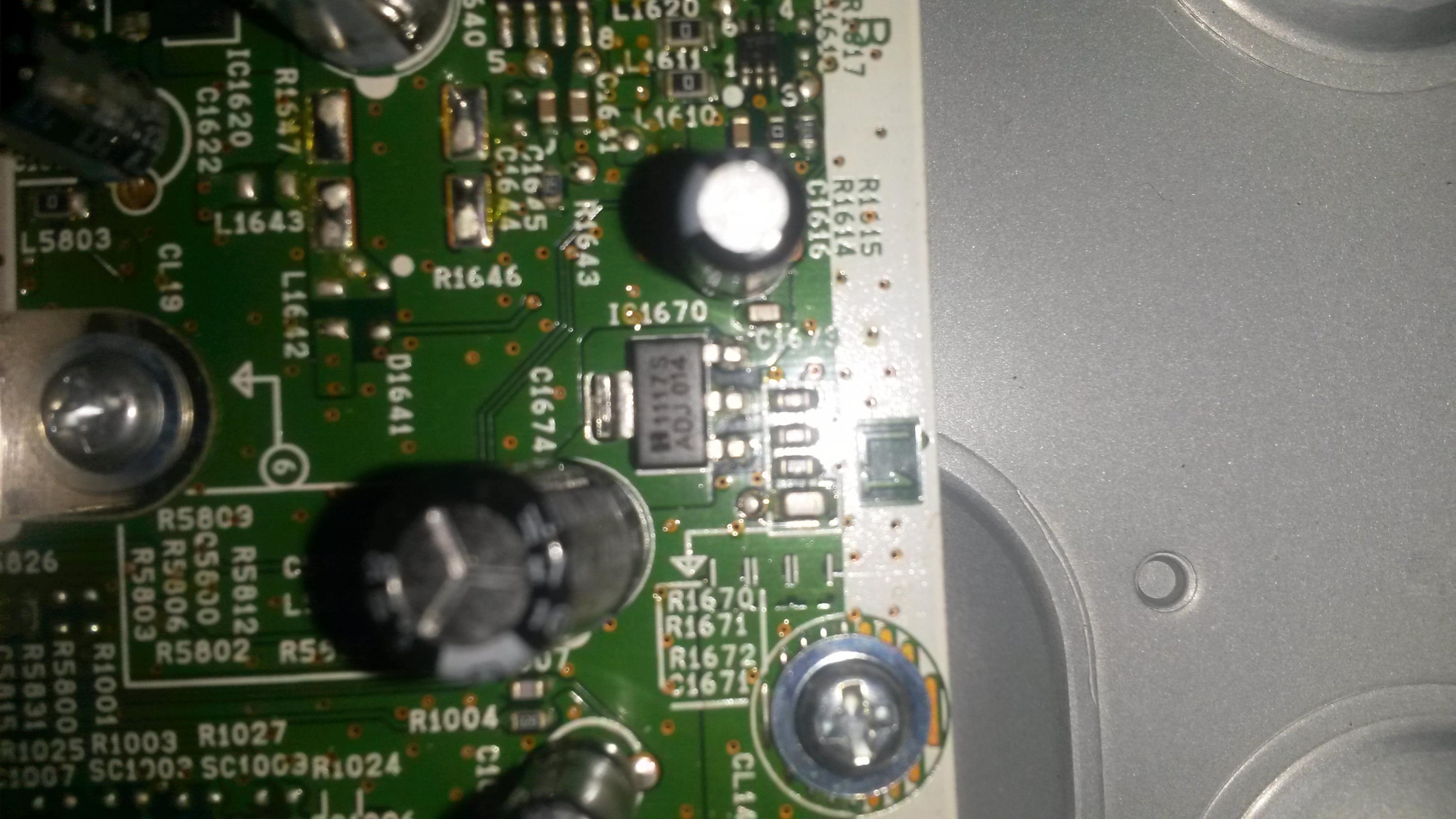

    I can't see any bad caps so I checked the voltage on the only 2 regulators it has.
    They are both 1117S then have ADJ 014 beneath the 1117s..
    Stub north, pins left to right.
    1st;
    pin 1 7.83
    pin 2 9.09
    pin 3 12.20
    2nd;
    pin 1 0.04
    pin 2 0.07
    pin 3 0.07
    Any help would be appreciated.
    Thanks.

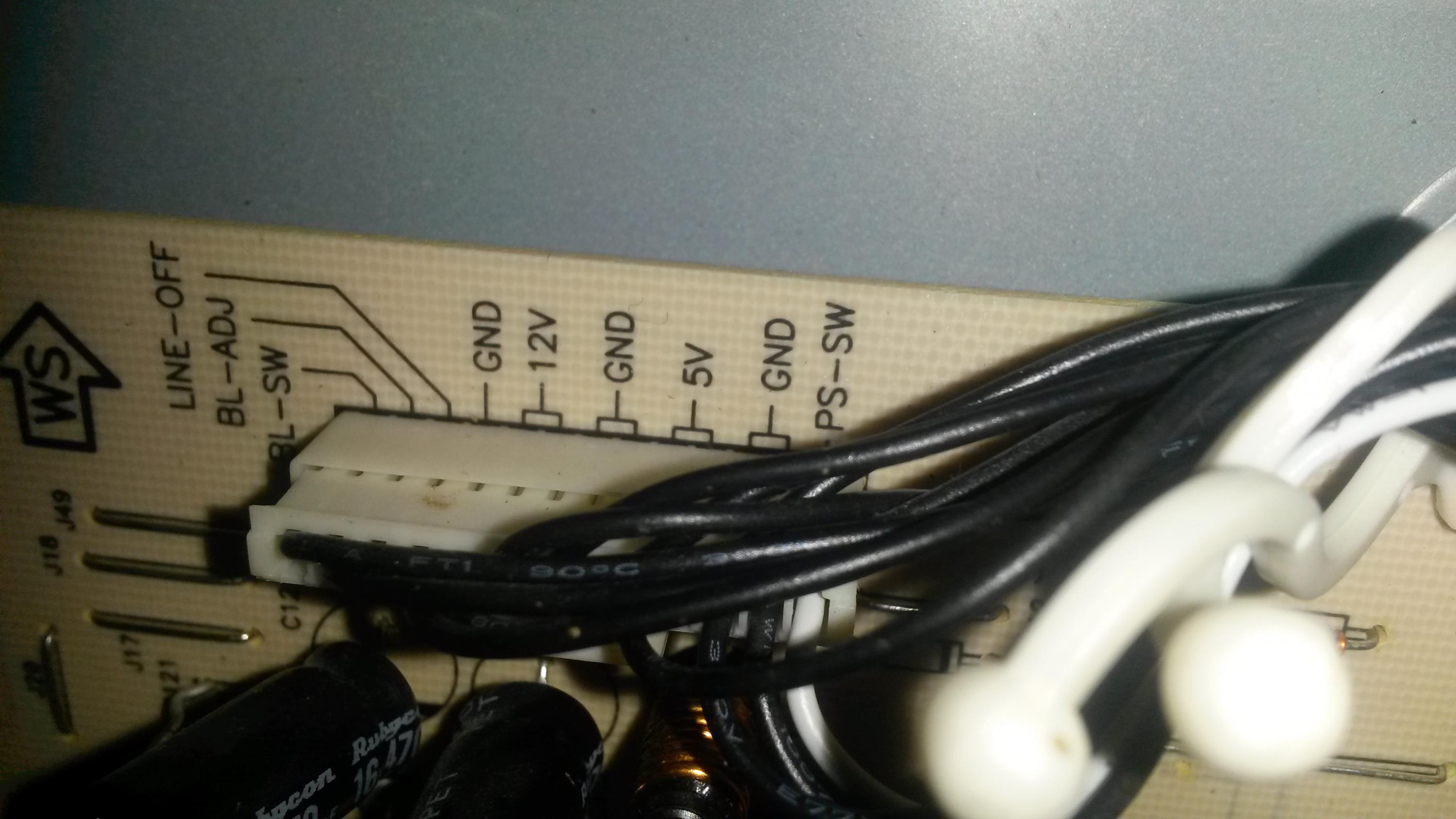

      What DCV do you get on those pins when TV is OFF and when power switch is activated?
      "2nd;
      pin 1 0.04
      pin 2 0.07
      pin 3 0.07"

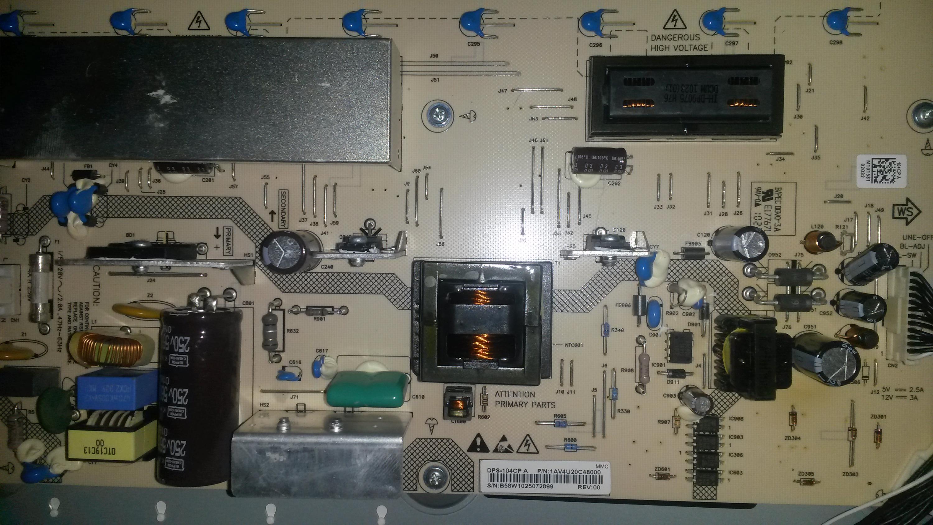

      No input = No output which can be due to the Input is fed from switched power supply section when PS-ON is applied to the power supply board.

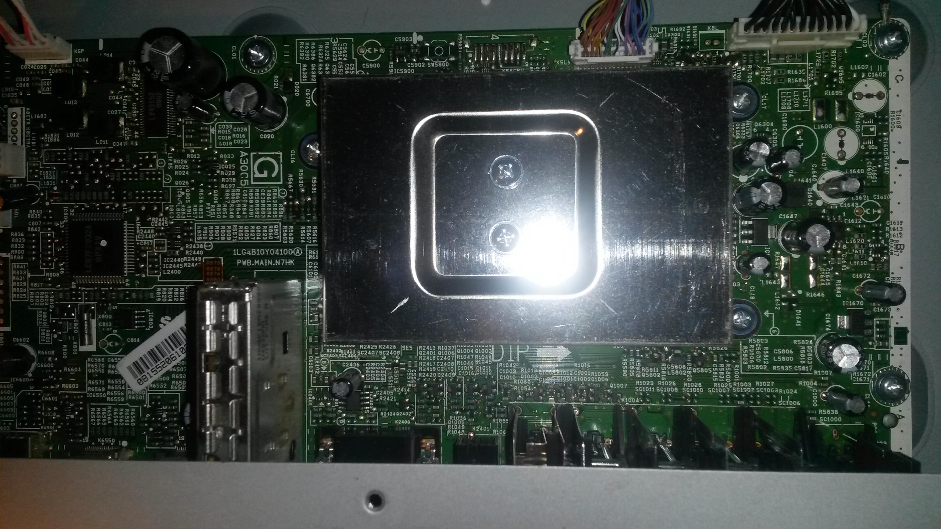

      We also need the pictures of the whole back side of the TV so we can see how all the board are connected.
