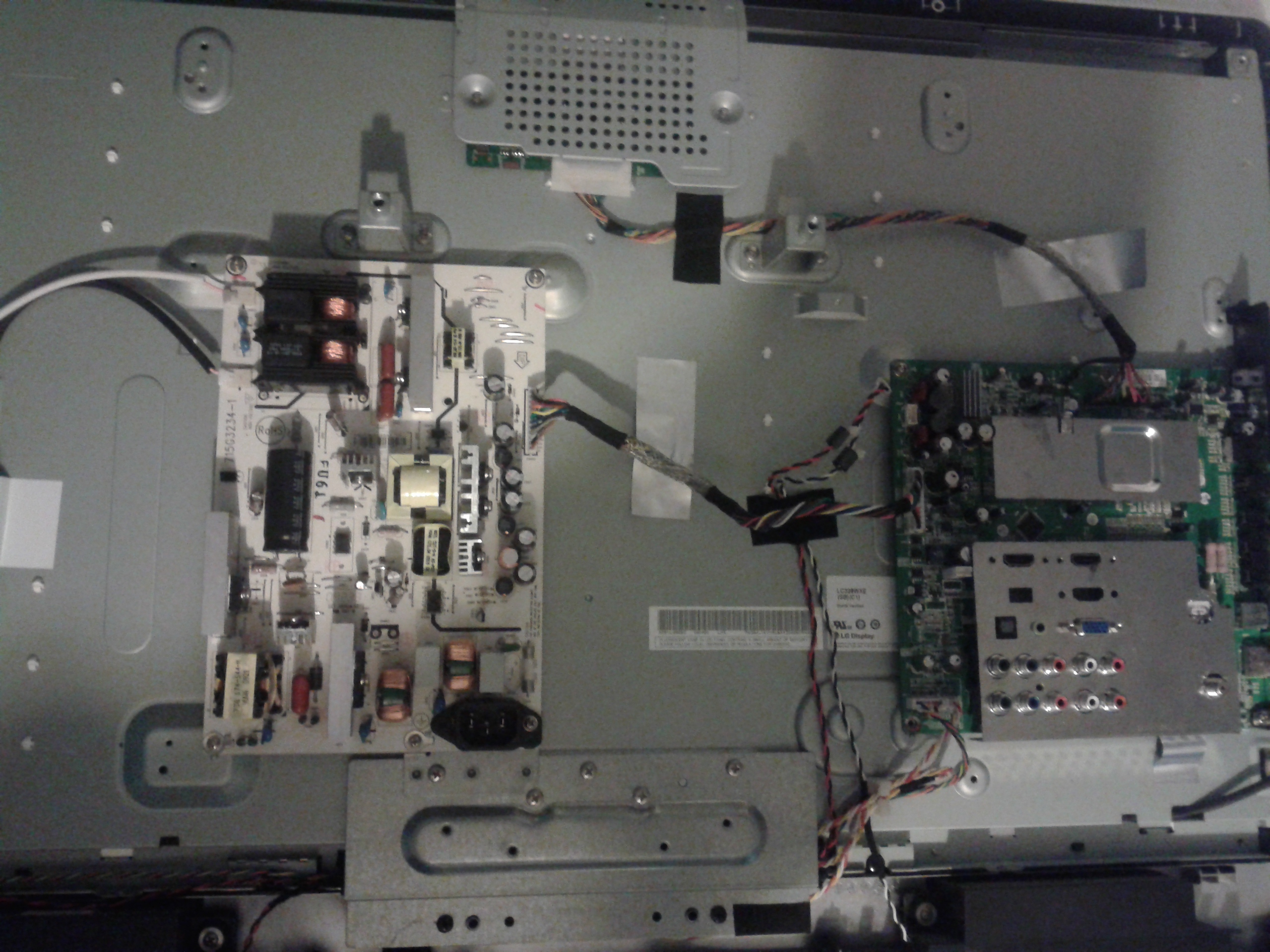

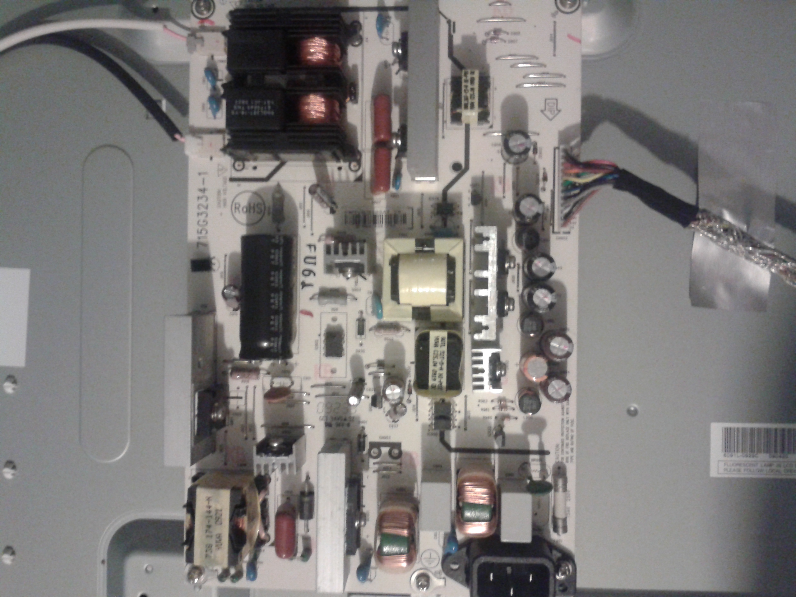

    Hello all,
    I'm having trouble tracking down the problem with this set. As stated in the title, I can't get it past an amber light.
    Power board has 5v standby, but nothing happens when power switch is pressed. I measured the voltage running to the power switch from the main board. The yellow wire in the power switch connector picture reads ~230mv and drops to ~50mv when I hold the button in.
    When I jump 3v to PS_ON, I get: 24v and 12v on the power board.
    I noticed there is a regulator at u708 that has 5v coming in and about 230mv going out. Seems to be the problem, but can't find the part number. ADI911 is marked on the top.
    Thanks for any help!

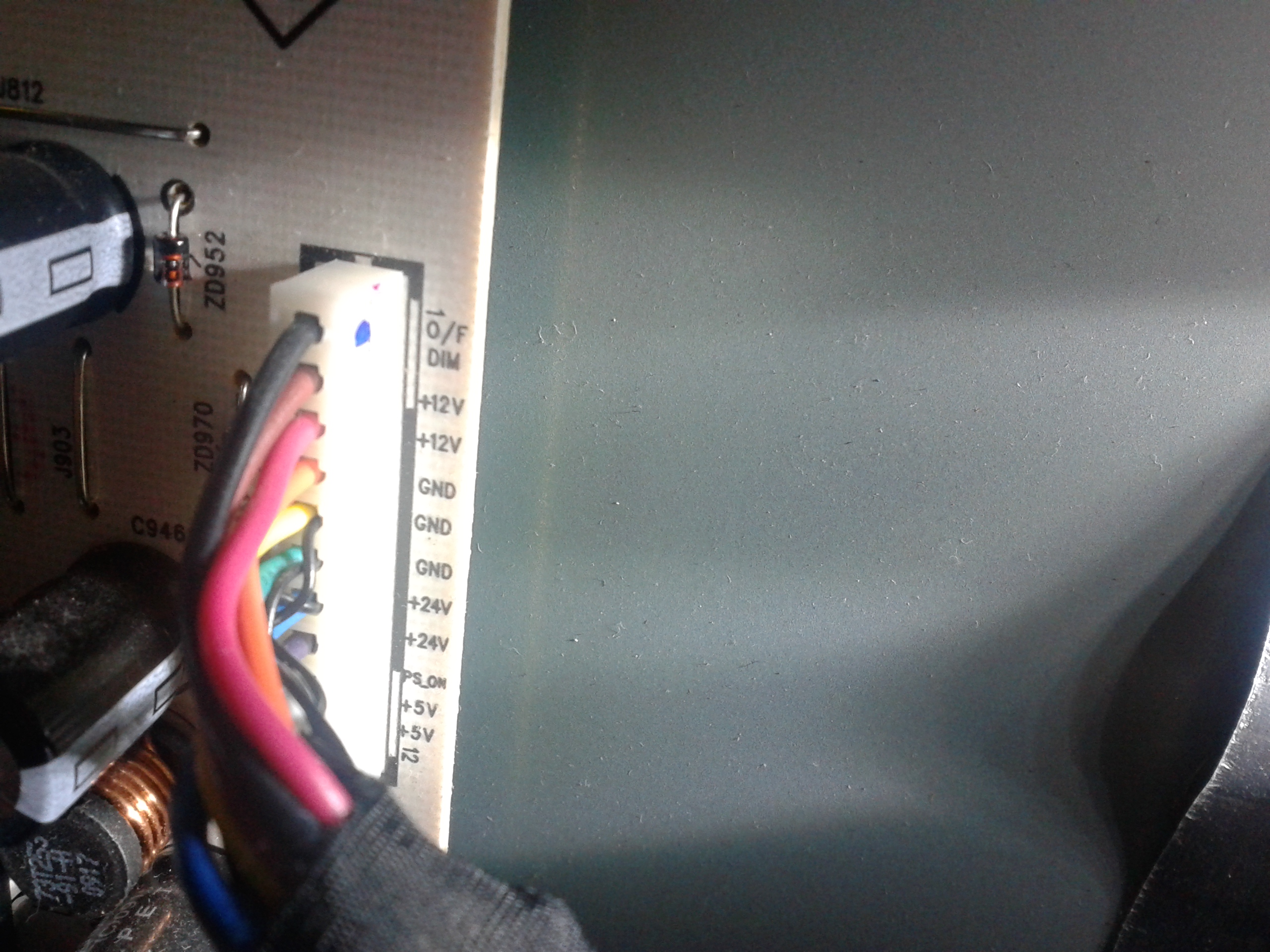

    Re: Vizio VA320E amber light won't go white
    Could do with better images, Can you get us a closer picture of the connector on the PSU that goes to main so we can read the voltage legend.
    • jakeklem
      • Feb 2015
      • 42
      Sure thing. Lets see if this is big enough to read.

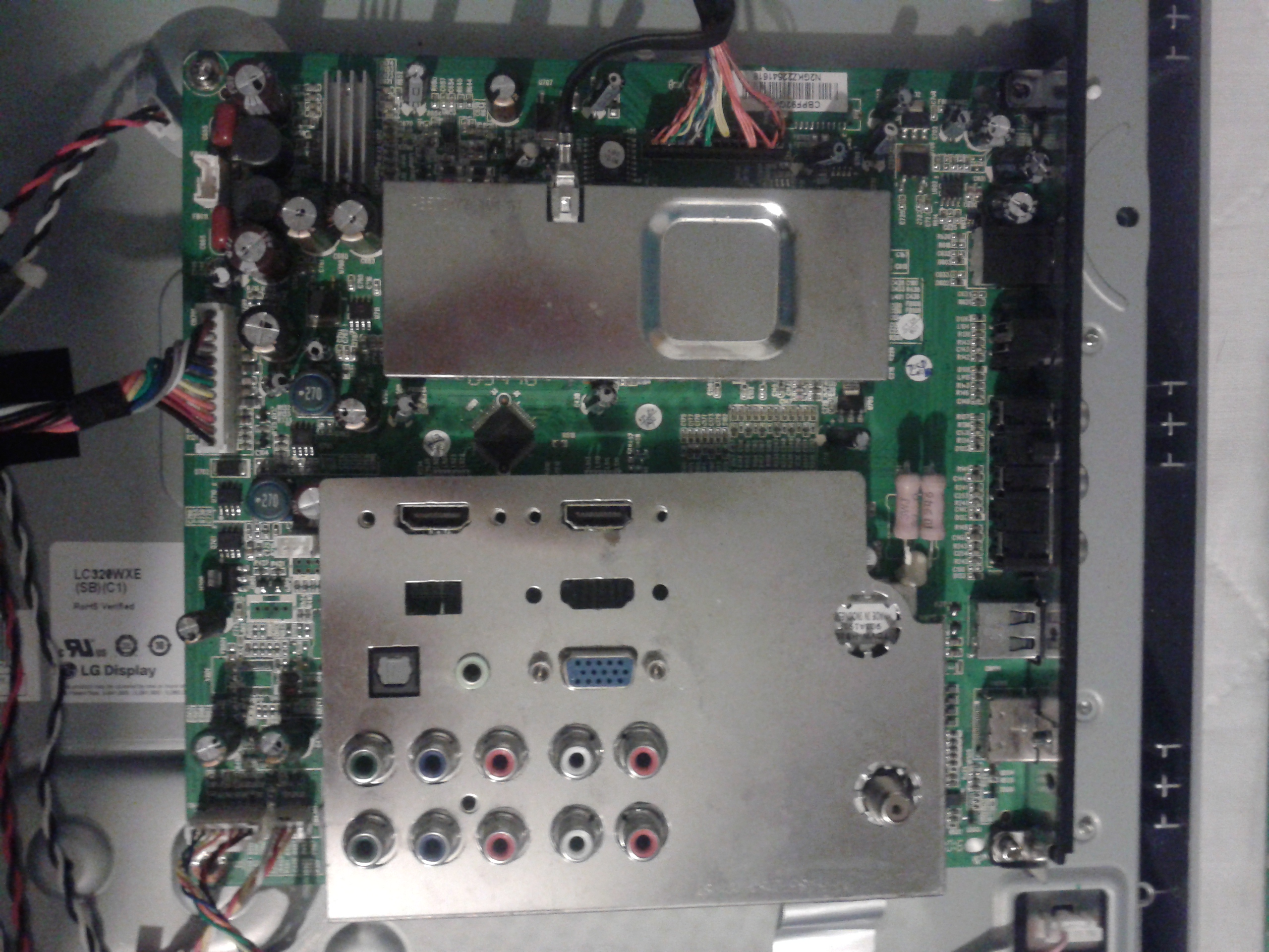

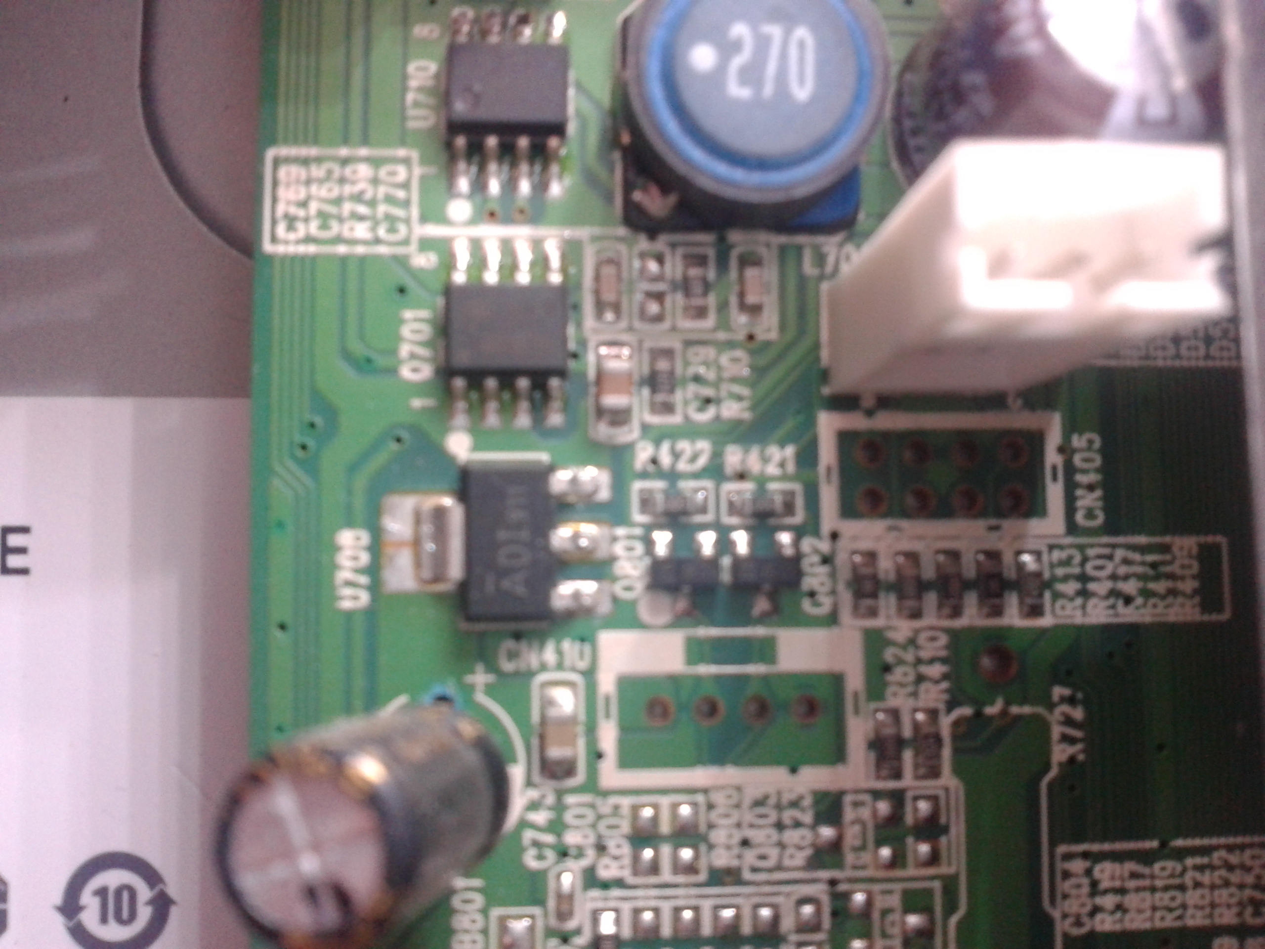

        Can we see good close up of U708 so I see if it is fixed or adjustable or it is something else?
        • jakeklem
          • Feb 2015
          • 42
          This would be adjustable, right? Sorry for the blurry pic, it's as good as my phone can do. If need be I can use a microscope to get a better one.
          Also, wanted to say thank you Budm, as I've seen some of your posts around the net and they really helped me get started in doing LCD repairs.
            Hmm, Looking at the picture with the tab to the left, is that positive leg of small electrolytics cap connected to the big tab?
            Is the bottom pin connected to ground (negative leg of that same electrolytic cap)?
            If it is regulator, it will be a fixed regulator because it does not have resistor network connected to the bottom pin.
            Also check the resistance between tab and GND to see if it also show low resistance.
              Yes, the tab is connected to + of the cap.
              Bottom pin doesn't look like it's directly connected to negative leg, but it's hard to me to tell if it's in the same circuit with other components in between. I can provide a close up there if that would help.
              Resistance between Tab and all pins show ~ 8.75 Mohms and slowly began to drop while reading.
                I need Tab and GND (which should be the negative leg of that cap), what I am trying to find out if the output tab is being loaded down by very low resistance or not.

                  Oh I see. Looks like 400 ohms from tab to gnd on the cap.
                    OK, the resistance is not low enough to cause problem.
                    So we need to find out what the Voltage output of this IC should be.
                    I have no luck finding anything by those numbers.

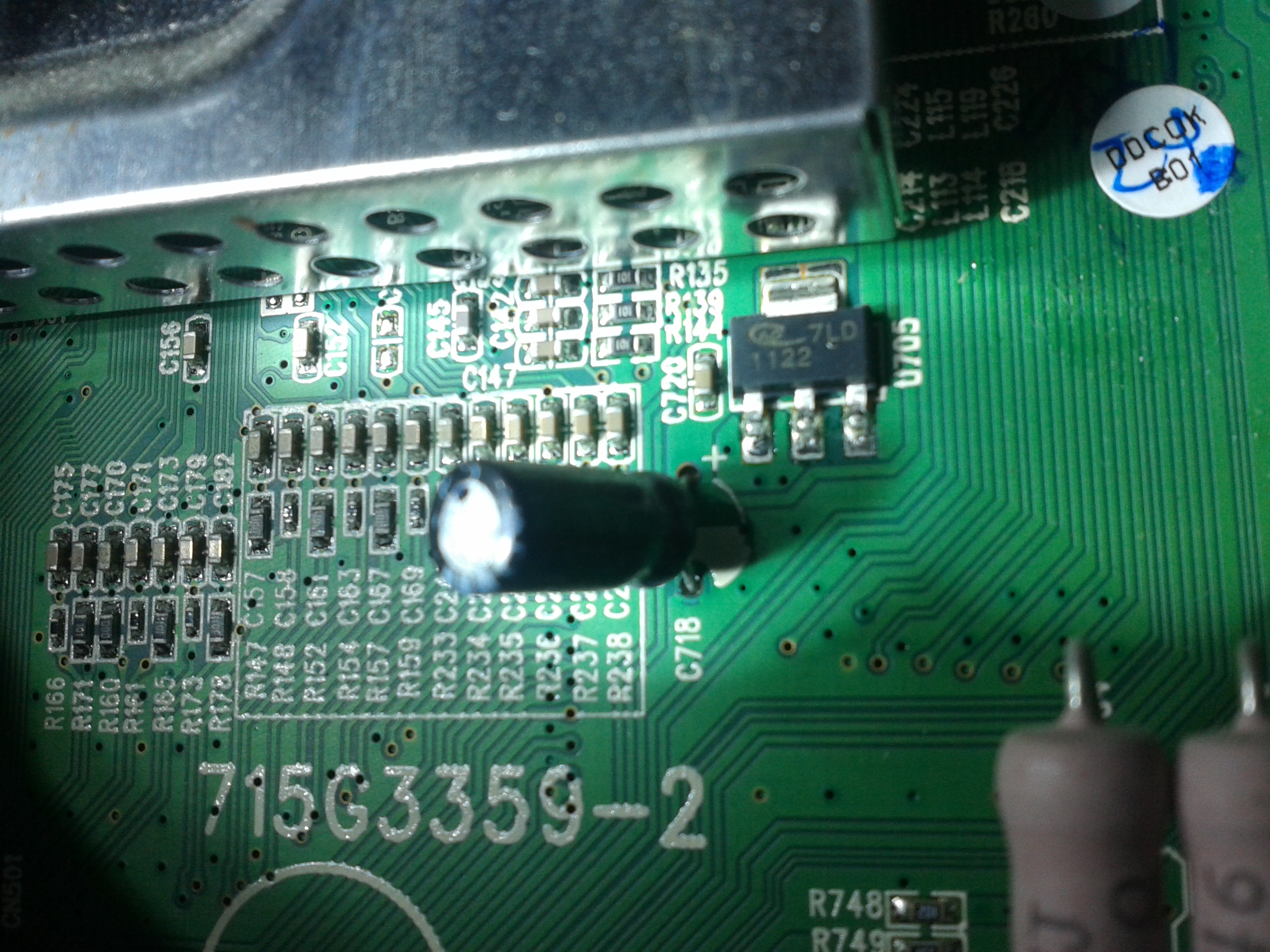

                        Did a little more poking around tonight and found another regulator that seems odd. Markings on it are 7LD 1122.
                        Readings with PS_ON jumped 3v
                        in: .5v
                        out: .4mv
                        tab: .4mv
                        Datasheet
                        Any thoughts?
                          0.5V in put is way too low for it to work, the minimum output Voltage for these LDO regulator is about 1.20V so the input has to be at least 2.5V for it to work.

                            After messing with this thing a little more, I found that the output voltage for the first regulator at U708 had a 3.2v output. I'm not sure what I did to make it show that voltage, but it only happened in one instance of plugging in/ unplugging the set.
                            Is it possible this regulator is still good? Could something else be causing the fault?
                              It is going to be tough without the diagram to find out what circuit feeds the input Voltage to this regulator. It can be bad connections, etc.

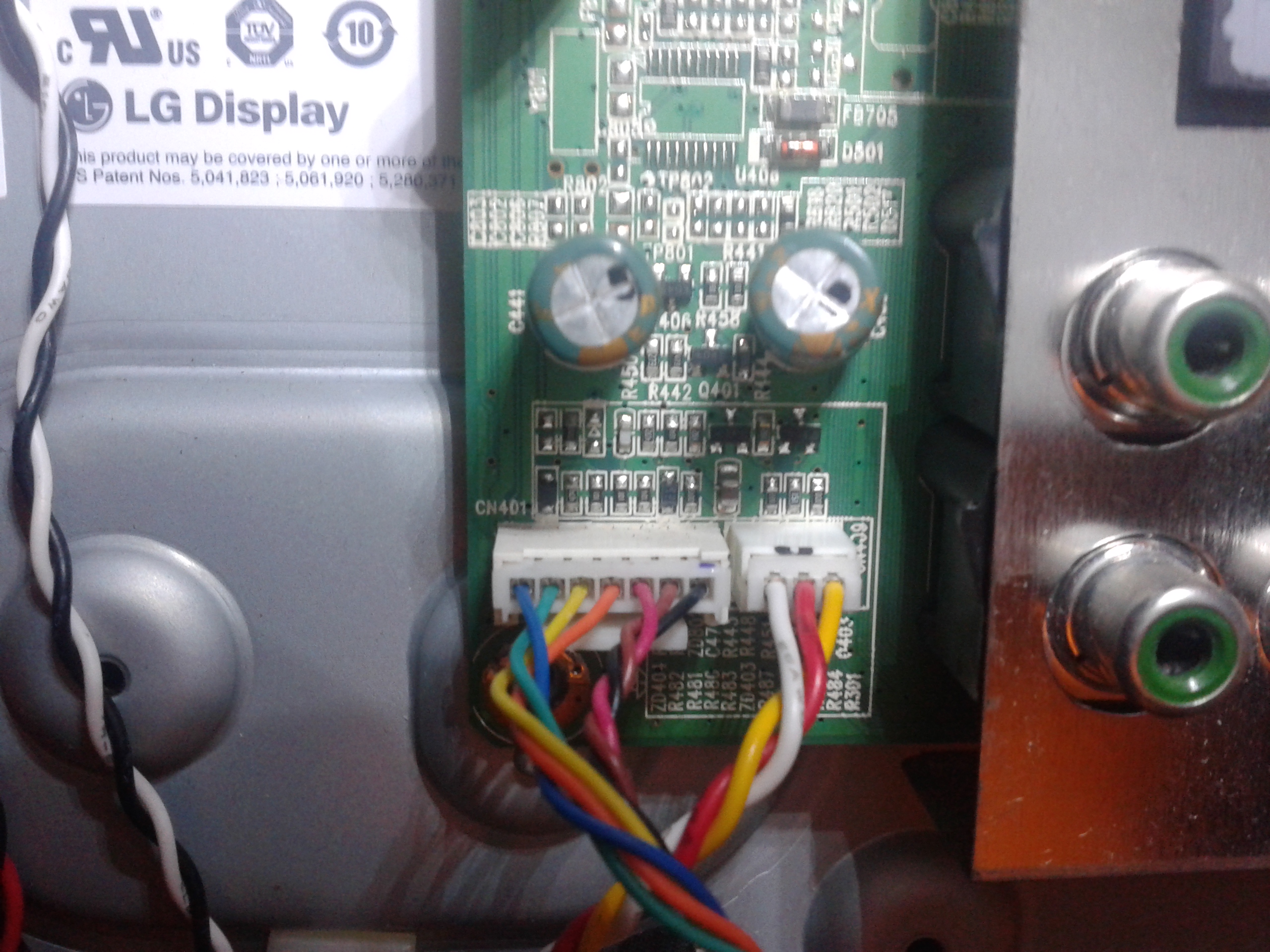

                                  In post 1 "The yellow wire in the power switch connector picture reads ~230mv and drops to ~50mv when I hold the button in."
                                  What do you get on the pin of the main board if the switch assembly is not connected?
                                  • jakeklem
                                    • Feb 2015
                                    • 42
                                    AHa! You're on to something bud. With the connector off, the pin reads 3.2v. The regulator in question also measured 3.2v. So is this a shorted switch or the circuit board the switch is attached to?

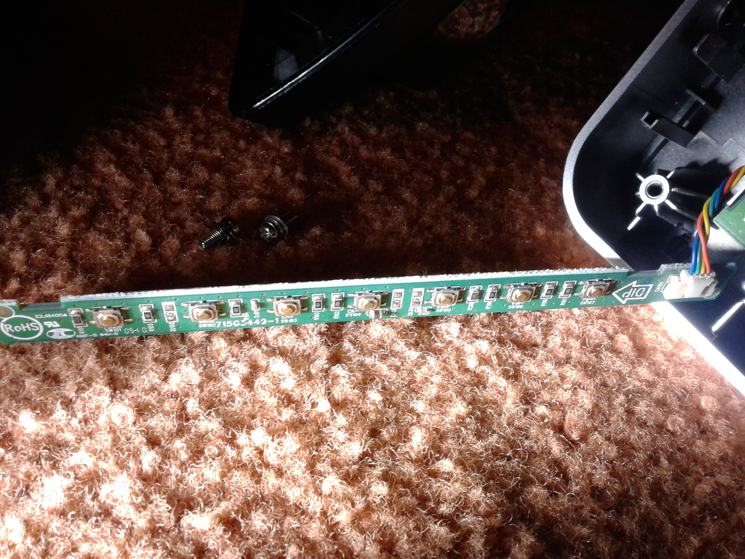

                                      Can you show the pictures of this board? Is it switch assembly and IR combo?
                                      • jakeklem
                                        • Feb 2015
                                        • 42
                                        See attached. It's just the switch assembly. IR is separate.
                                        Do you want a close up of any portion of the board?
