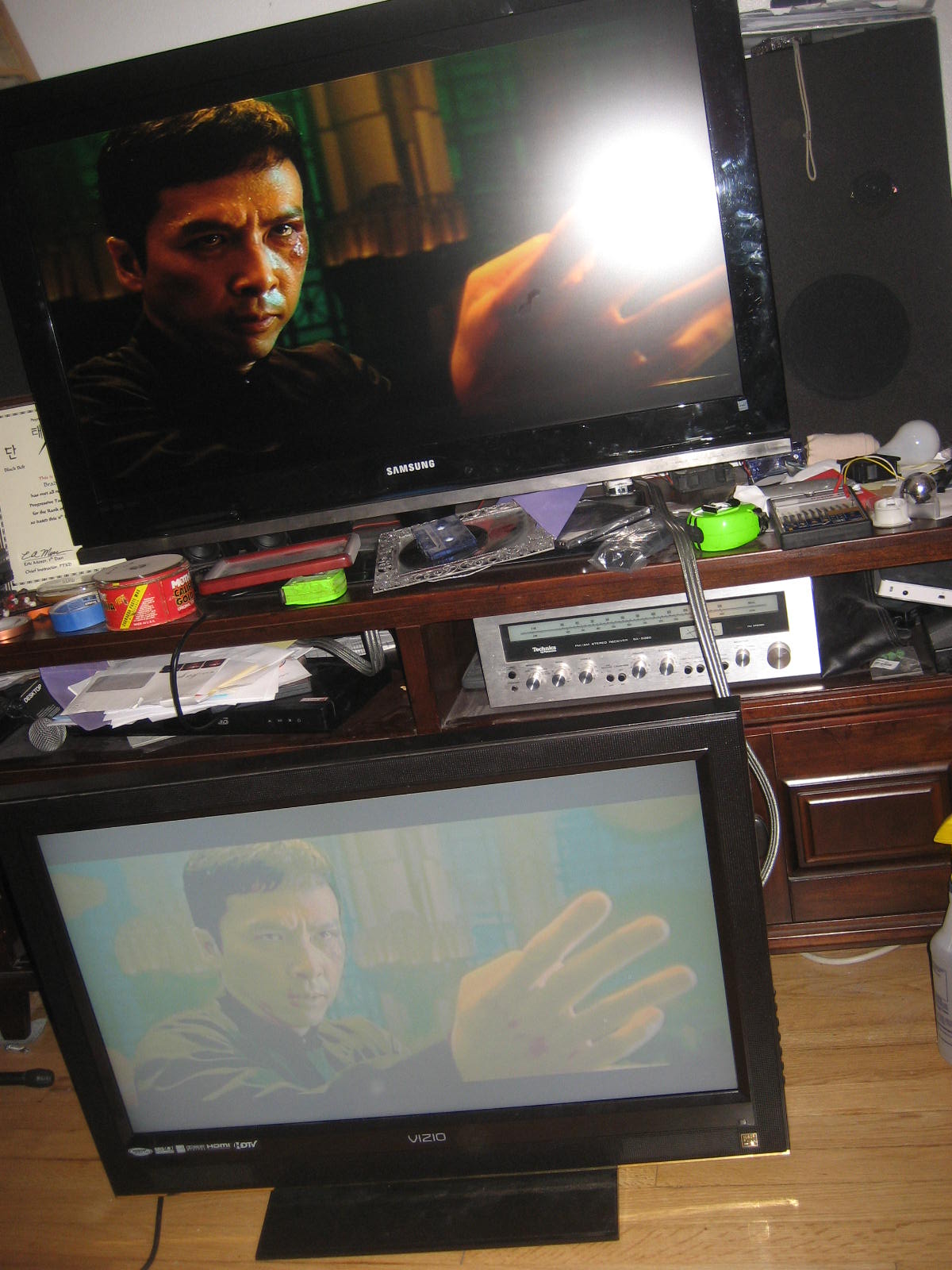

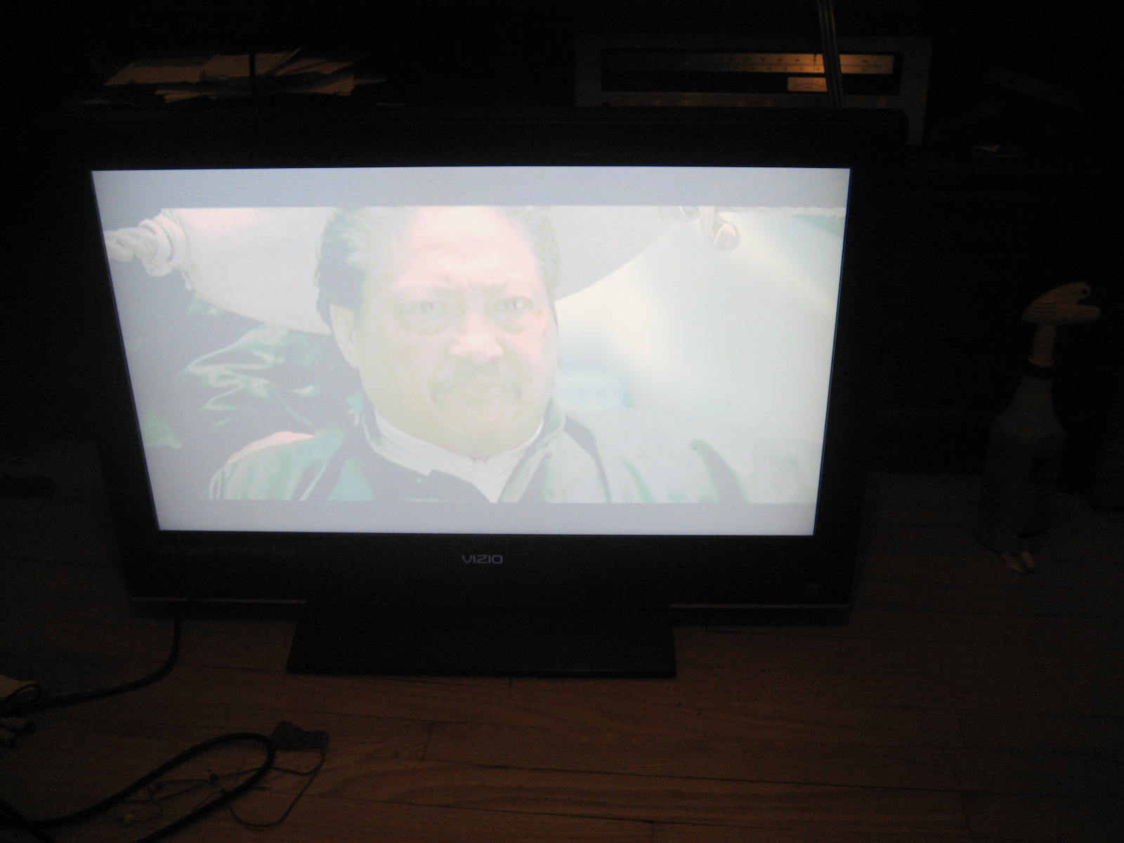

    Just picked up this VOJ320F1A today, in hopes of fixing it and replacing my mom's 20 year old tube set. It powers on fine, sound is good, but the picture is , for lack of a better description, washed out. I haven't opened it up yet, but was hoping somebody point me the right direction to look towards for when I do tomorrow.
    Thanks..

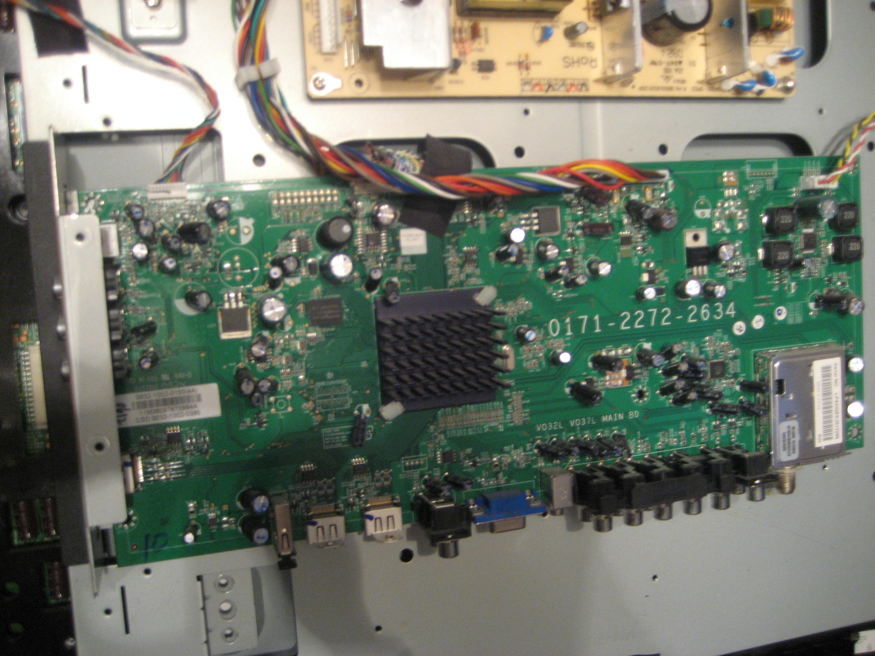

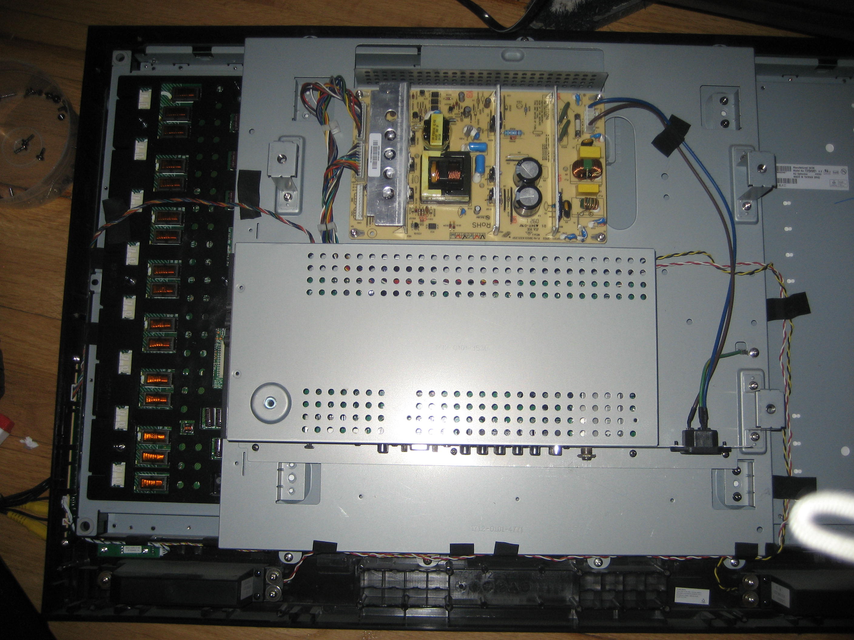

      There's no visible t-con board on the tv. The main board is under the metal shroud, and there is a connector with several wires running underneath it, into the framework. Do I need to dig deeper? And if I pull it further apart how do I test it..in pieces?

          The T-CON is under the big metal plate, you need to remove the metal shield for the main board first so you can disconnect the LVDS cable to the T-CON otherwise you will rip up the LVDS cable when you lift up that metal plate assembly. This chassis in not made to be repair because you cannot get to the test points on the T-CON when you gave all the boards connected together.
          http://www.shopjimmy.com/catalogsear...t/?q=VOJ320F1A
          There are more one maker of the LCD panels (looks like 4 panels) for this model, if it uses AUO T-CON, then it will be likely to have have bad AS15 Gamma cip.
