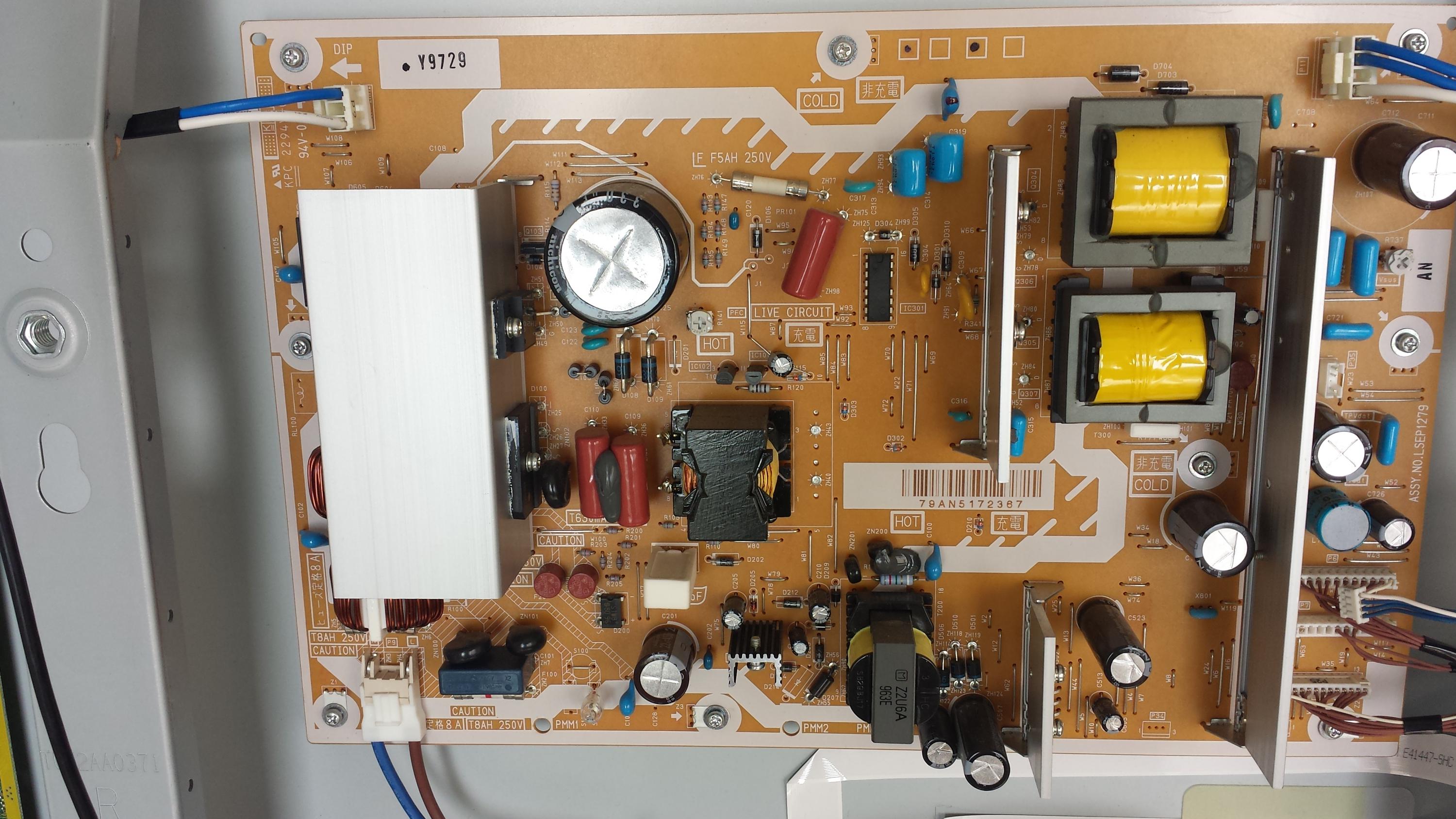

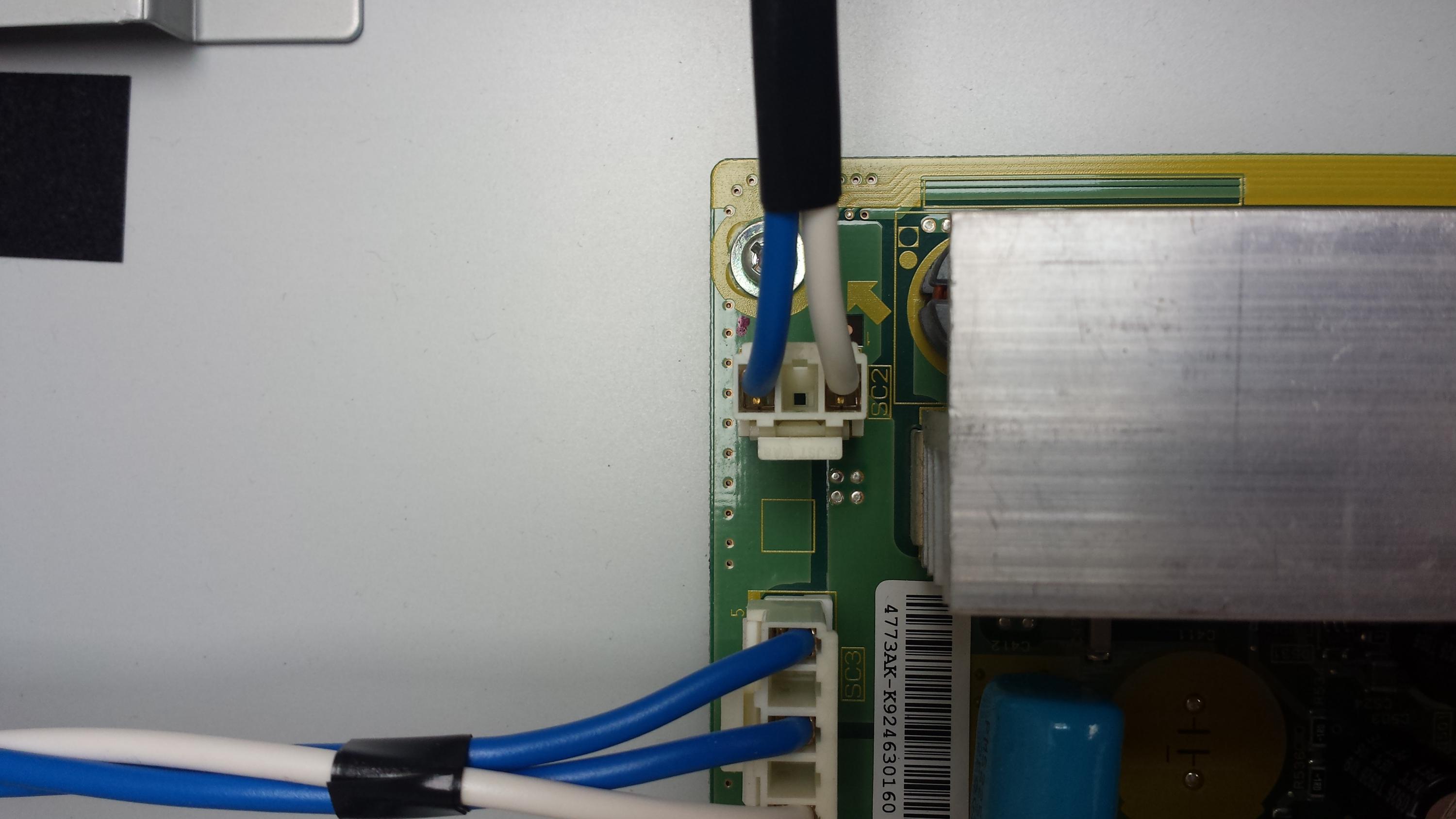

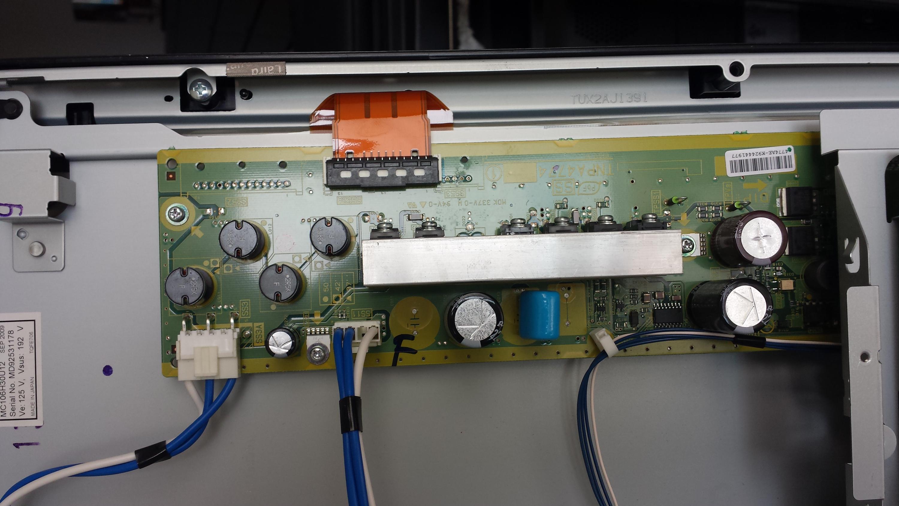

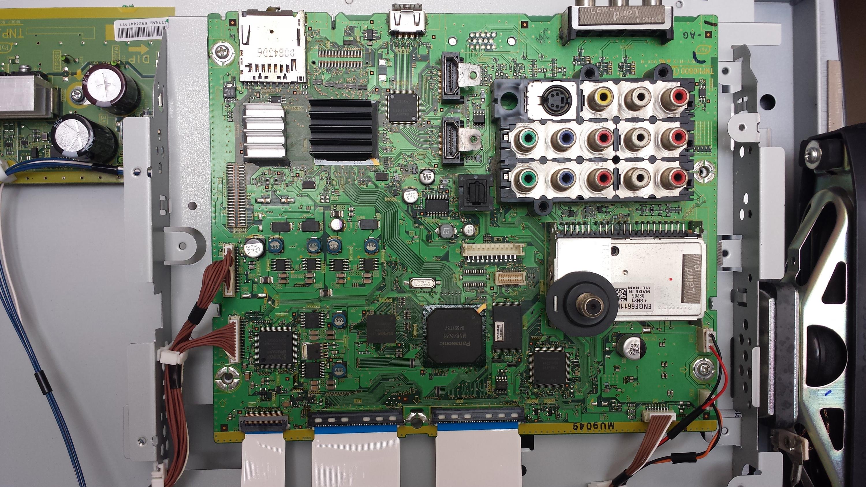

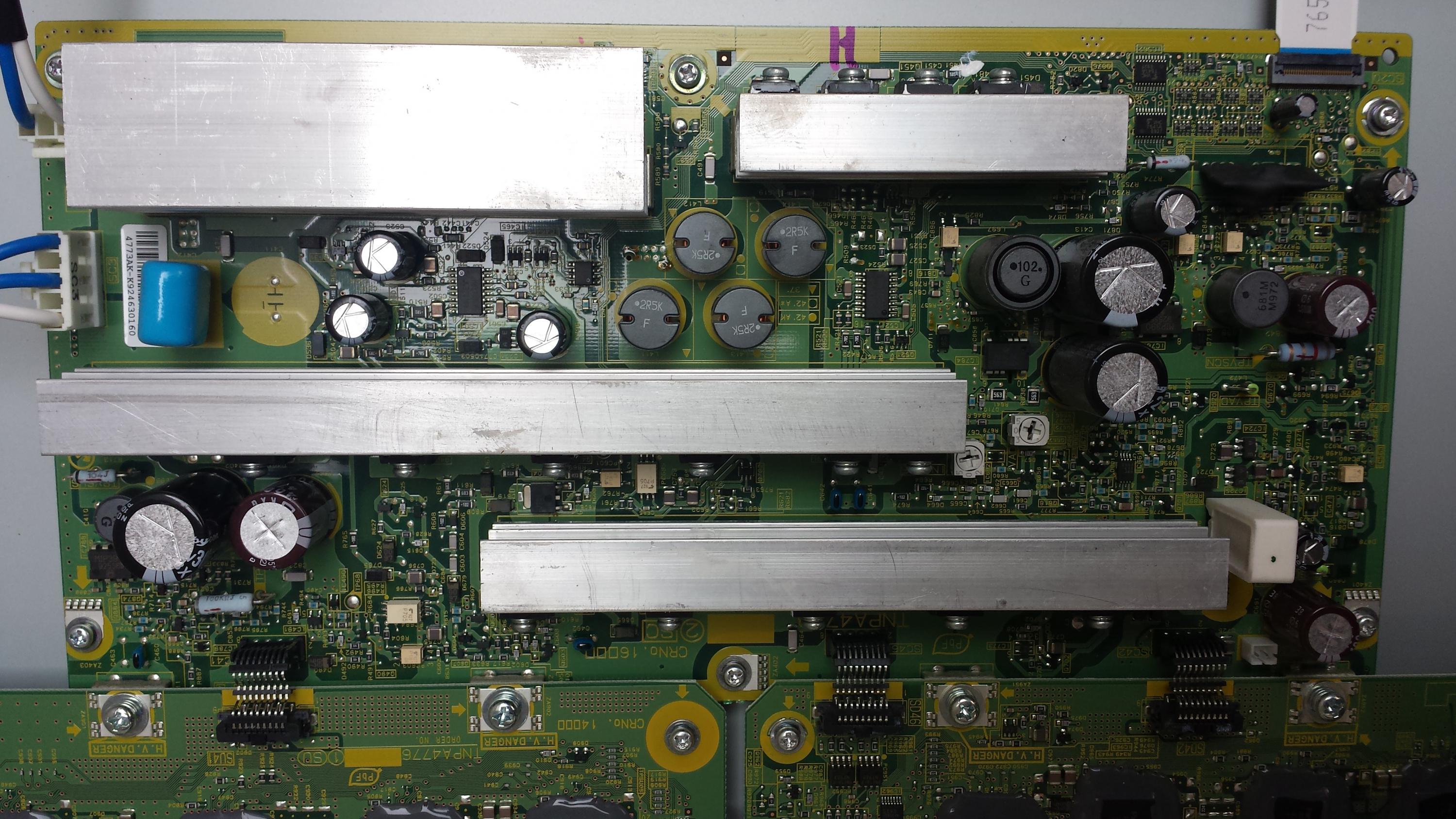

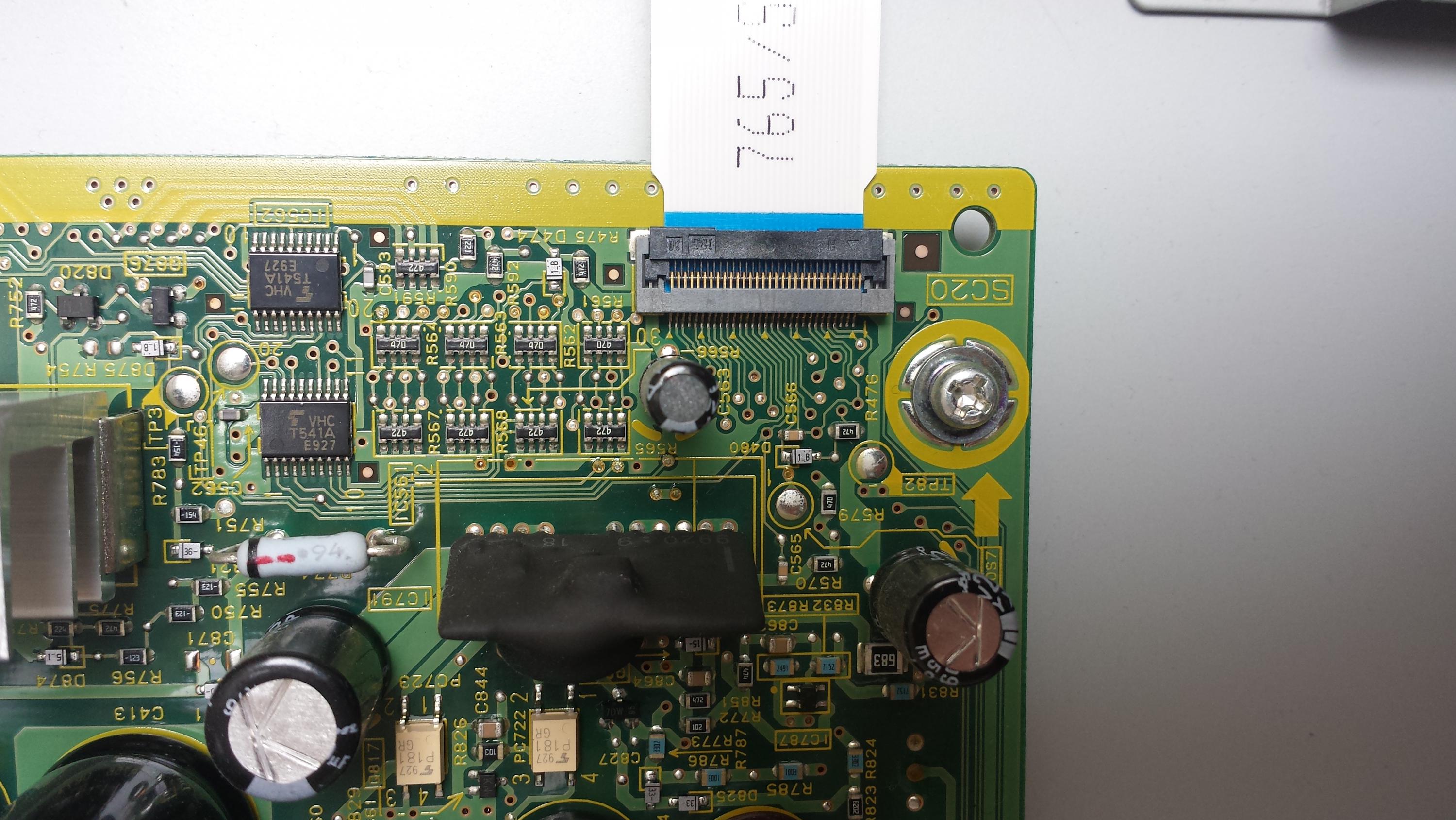

    This TV come to me with a 9 times blinking red light.
    I replaced A Board and after that TV show a solid red light.
    Vs, Va and 15v ok (no short circuit)
    I made all this variants in order to determine the defective board
    Case 1:
    SC20, C10, SC2 and SS11 disconnected: Red light blink 6 times.
    Case 2:
    SC20 disconnected: Red light blink 6 times.
    Case 3:
    SC20 and C10 disconnected: Red light blink 6 times.
    Case 4:
    SC20, C10 and SC2 disconnected: Red light blink 8 times.

    Pictures

          Ok so the reason I asked was I just worked on a TC-p42x3, I spotted your panel sticker and see its a different panel(2009) and the boards are different but perhaps I could apply what i learned to help you since the locked red led seems key.
          Basically we started with the set powered of and unplugged, by disconnecting the cable from p board to sn and checking sn for short.

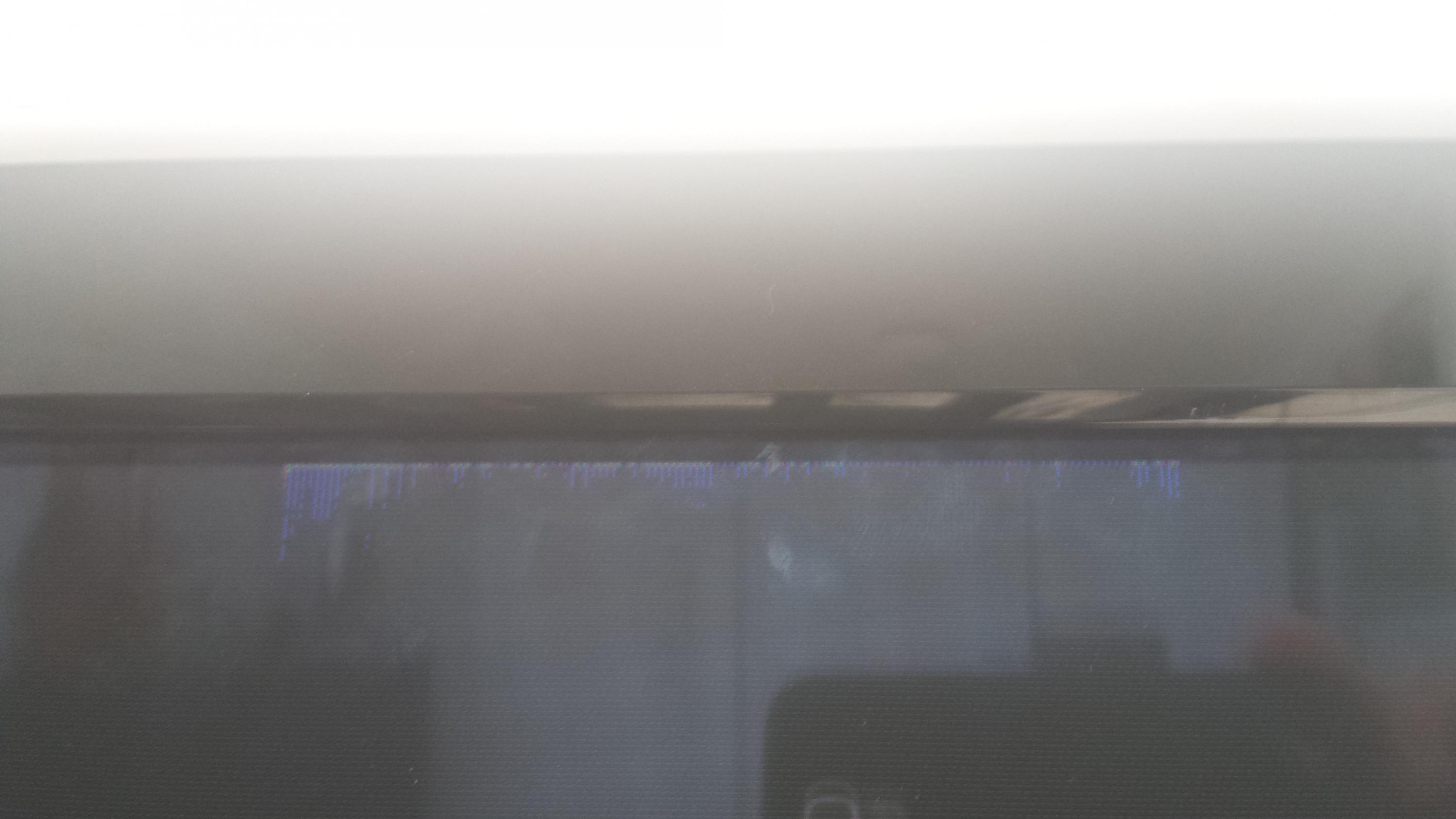

            Re: Tc-42px14
            There are not short between the boards and the Power Board.

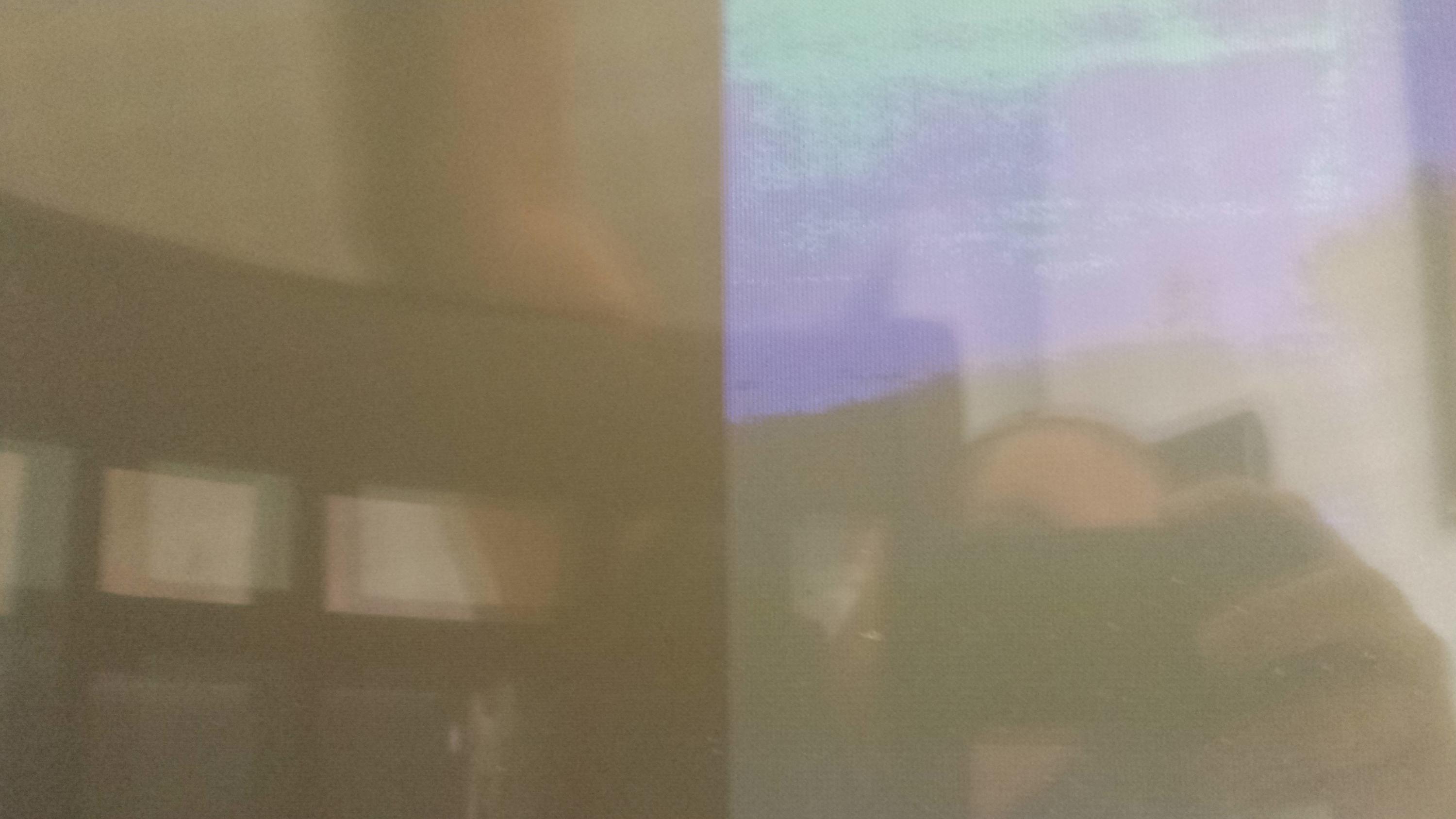

            Actually I disconnected the C1 board and the panel the result was half of the screen with image as I show on the picture
                So with c1 connected you have no picture?

                    Neither am I, if you were to disconnect C1, that is exactly what you would expect to see, I believe.

                      Yes, you right and I think that the panel is ok.
                      But I can't determine the defective board.
                      There are not short circuit.
