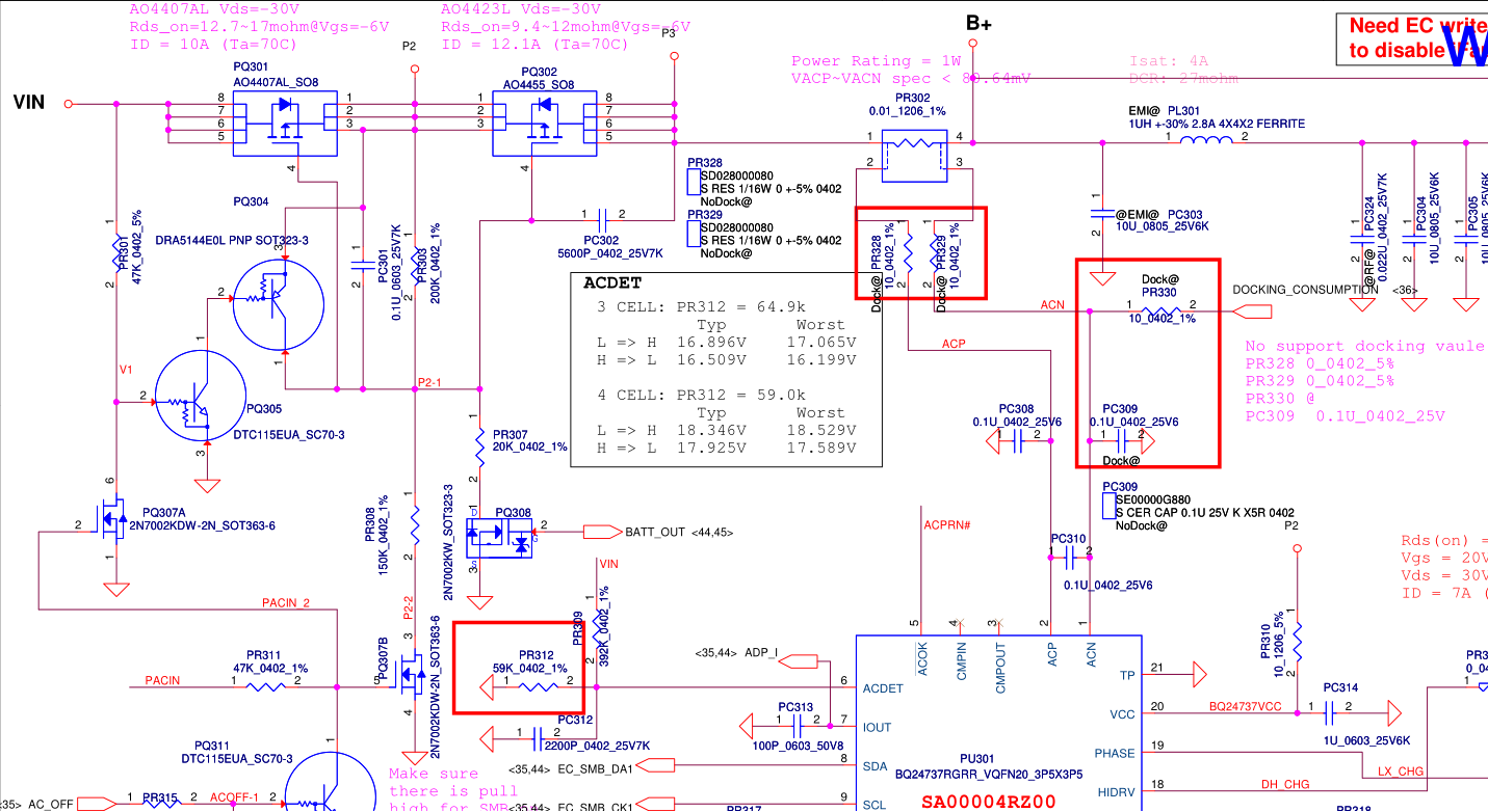

New laptop to troubleshoot.
It power on , fan spin , no image, no light on caps lock.
Power light is blinking orange .(not an error blink) just orange blinking.
You press power button again , again it powers up fan spin ,and then cuts off.
What i tried?
Removed everything only board, and external monitor left on , and powered with bridge to the power button (in case it was the problem)
Tried reset RAM ,new RAM , re-flashed bios dump ,from thread that i found here again all the time the same behaviour. With any kind of bios dump it keeps the same thing.
Checked the DC-IN Mosfets for strange behaviour ,again all pins 20v and 1 to both 8,7volt
I will upload the original bios dump , which was triple veriried
No liquid, no damage , it's in perfect condition , it just went to "sudden" death.
