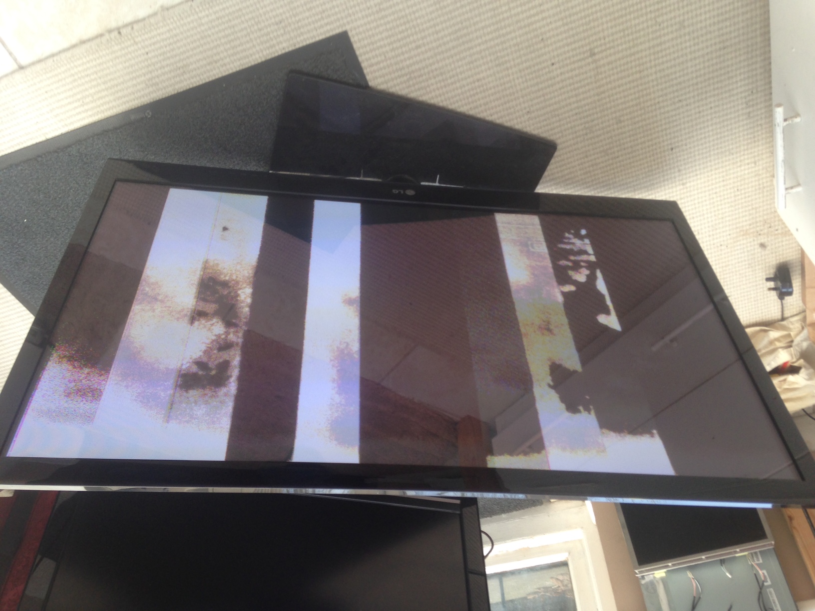

              Have swapped the power board and now have the screen lit up but large BANDS running from top to bottom. Will post picture later.

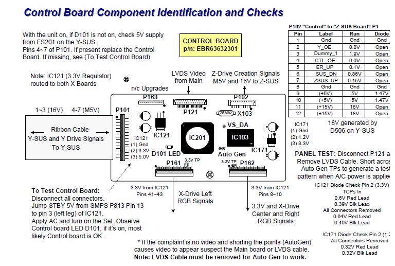

                Re: LG 42PJ550,control board test patterns
                test patterns

                  Am trying to load some picture of what I am getting on the screen. This fault occurred when I tried to monitor the Va and VS monitor points which are close together which I ended up shorting. and this is the picture I now have.
