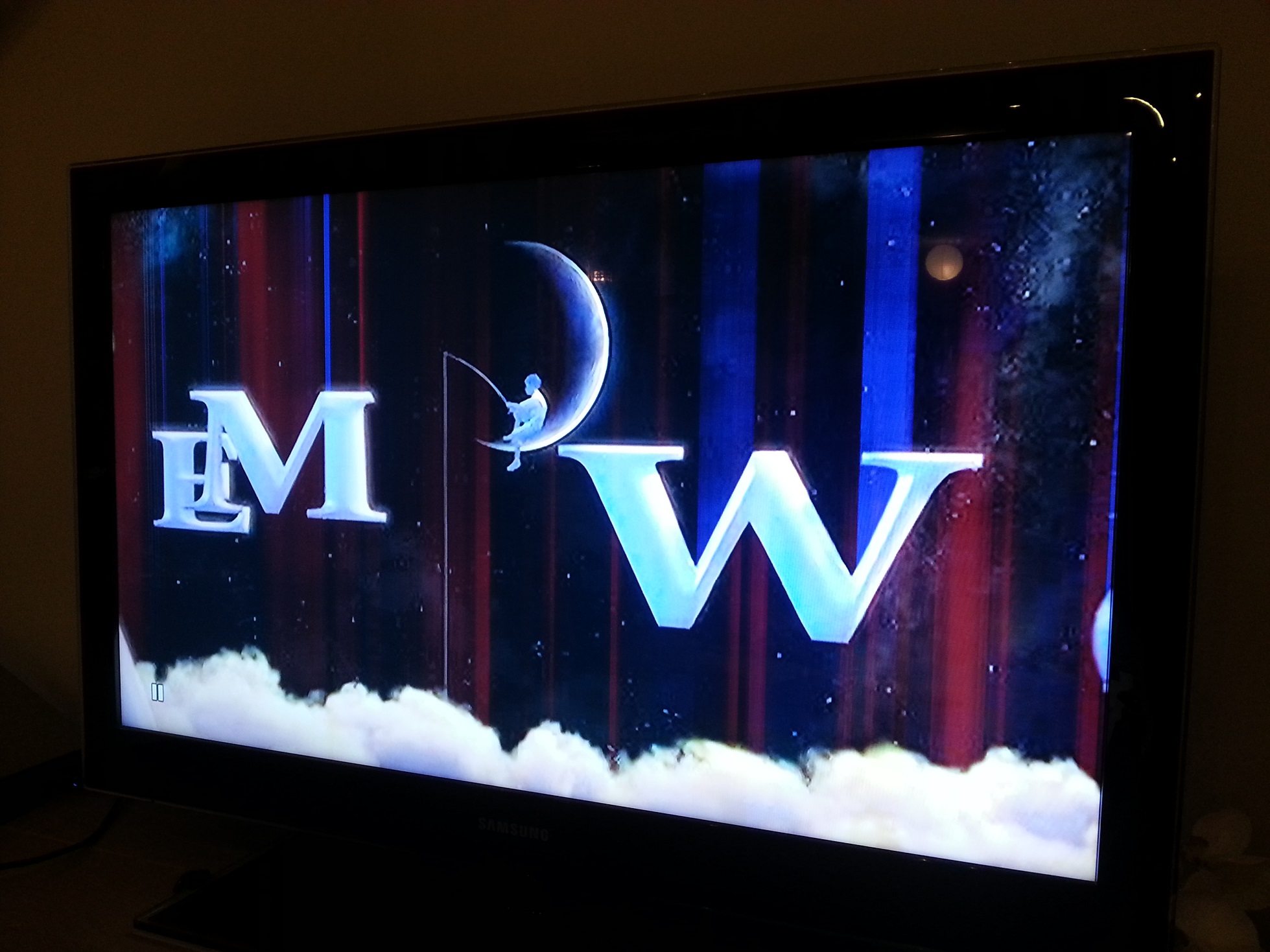

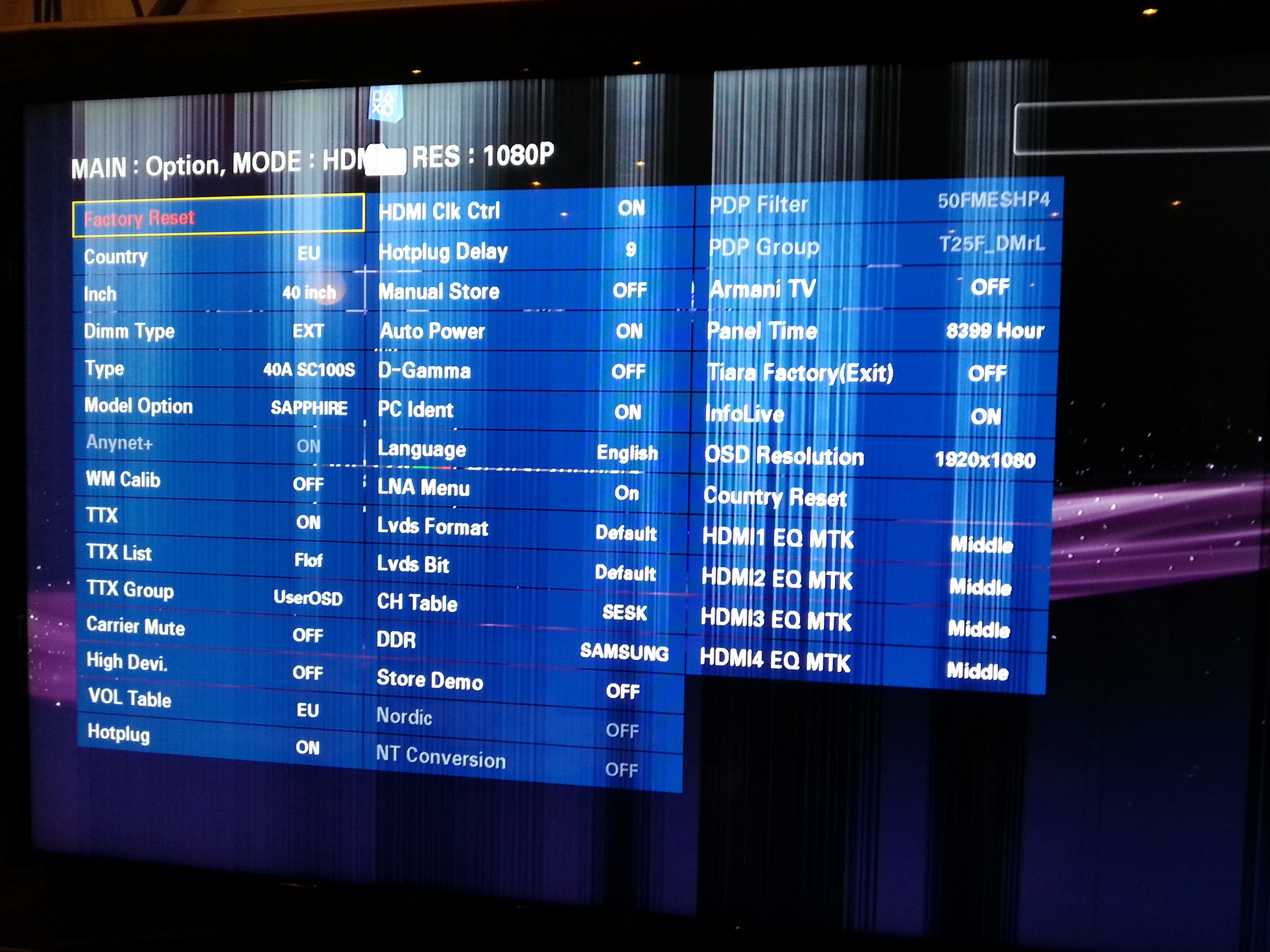

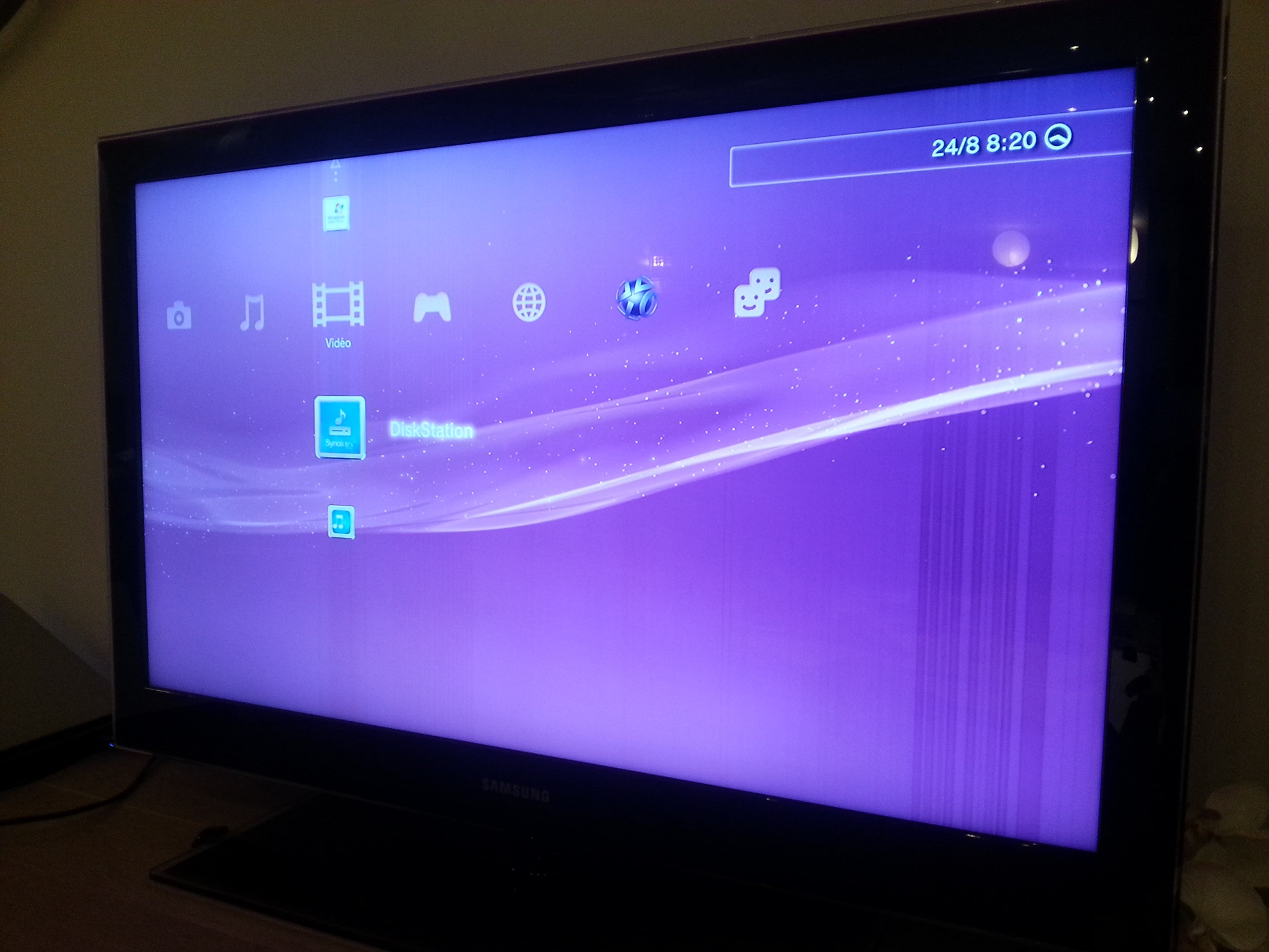

    As you can see on pictures, vertical moving lines are displayed since last week-end on our Samsung TV set, under and above white/bright areas (on every source : HDMI1-4, internal Tuner, etc...)
    It never had a problem before, and it occured suddenly, with no physical shock, no electric shock (plugged on UPS), no excessive heat (it's winter, room temp is about 20°C).
    I had no luck googling for this particular issue, but found a workaround on Youtube.
    A guy named HammerToof "kind of" fixed it by entering Service Menu and lowering Sub-contrast setting.
    I did it, and made the lines disappear at about 50 (the factory setting was 140).
    But now, I'm looking for a serious fix...
    So, I took off the back panel, cleaned dust, checked all connections (even if I don't think it's tab relative because lines are "following" bright pixels) without any result.

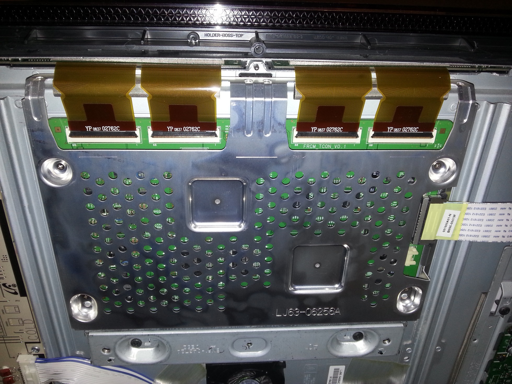

    If I correctly understand how all that stuff works, a T-con board problem would affect the whole screen.
    As my issue is "image related" (lines follow bright areas), I should have a look at LVDS ?
    I will attach pictures of backside tonight, light was awful yesterday evening when I disassembled the back cover.

    Posting pictures of the back of your tv showing the boards with clear pictures may help you more with fixing your problem

        I believe this to be a panel fault, but I've never figured out the cause. I have an LE40A656 with nearly the same symptoms in the corner of my room for too long.

            I found lowering user menu contrast to fix mine, except on user menus. But, not a permanent fix, still "in the pile" so to speak, will probably strip it down for bits soon.

                It's strange, my parents reported same fault (suddenly there were lines) - I fixed the TV with bad caps, and gave it to them. Worked for 2 years then the panel goes, typical Samsung. (About 6 years old total.)

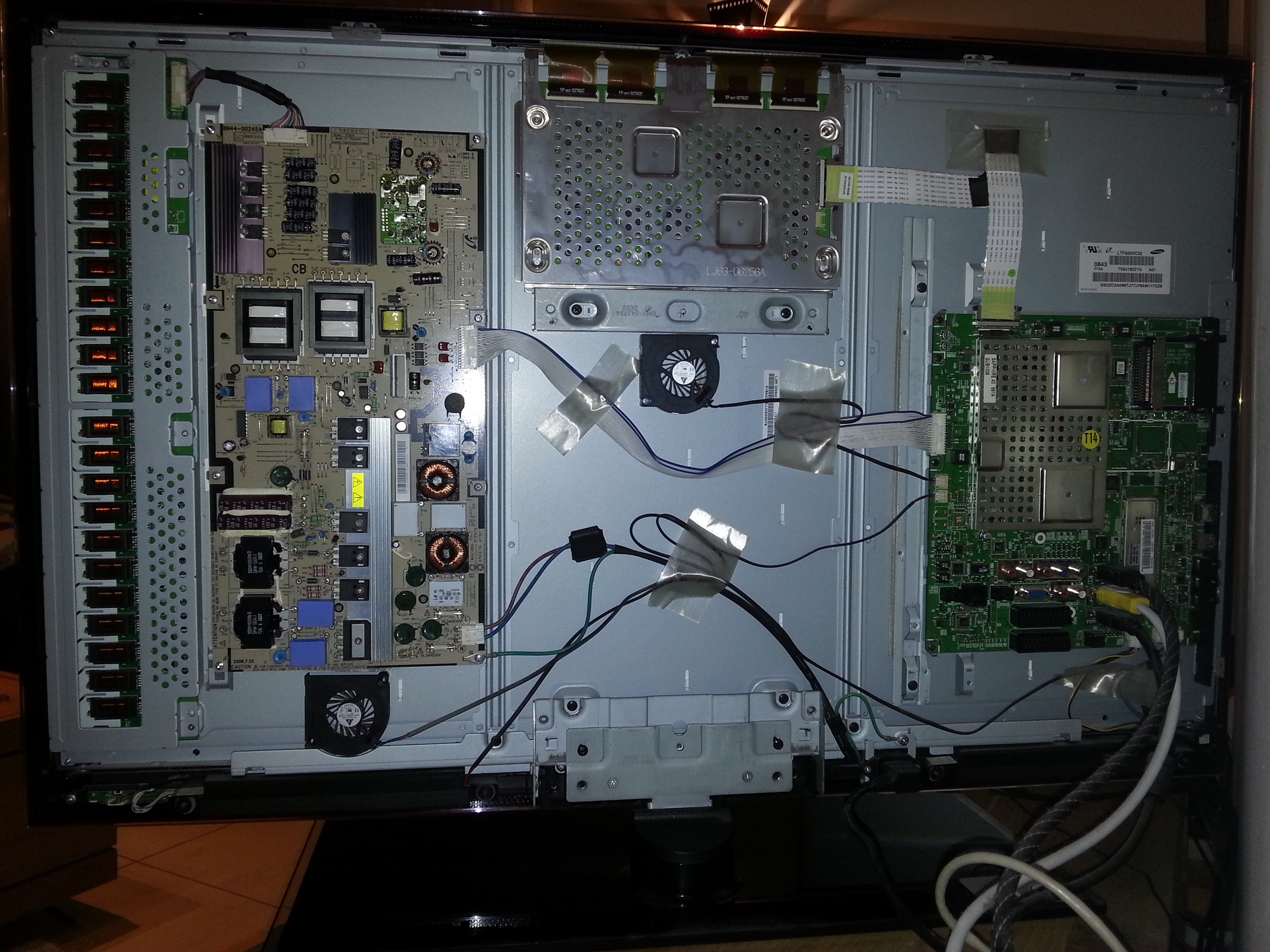

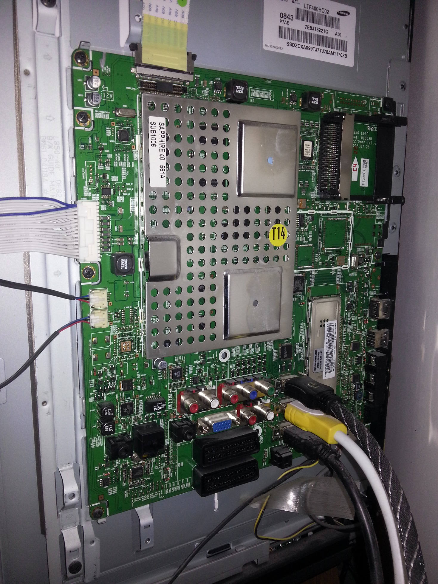

                  Here are some pictures of back side.

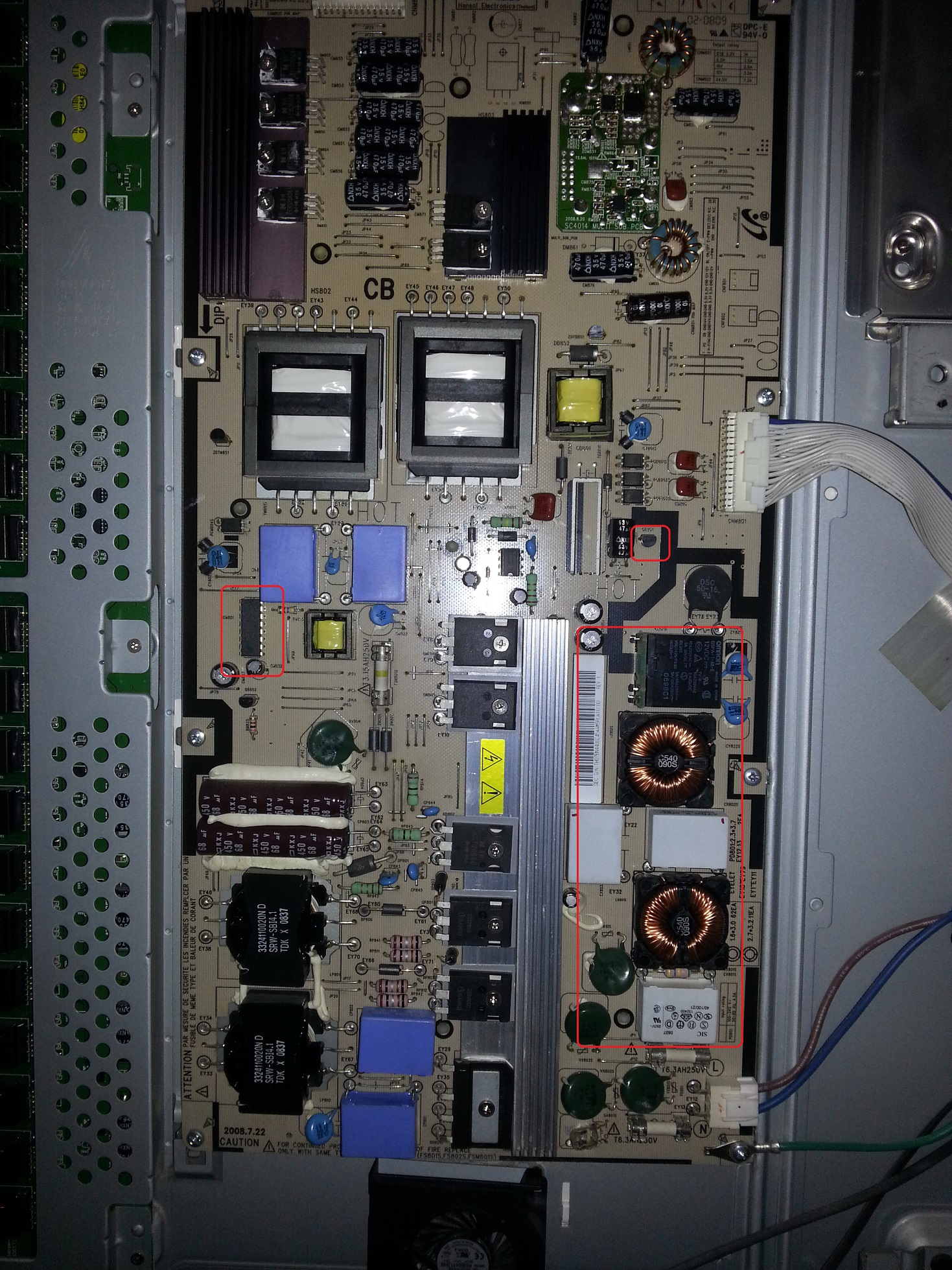

                  I checked temperature on boards with an infrared thermometer.
                  Almost everything is between 22°C and 30°C after half an hour, except a DIP16 and a transistor on Power Supply board (in the red rectangles) who reach quickly 40°C but don't get hotter.
                  There is also a noisy stuff in the big red rectangle on Power Supply picture.
                  I can't say if it's the black relay, one of the coils, or one of the white blocks, but it produces a low frequency electrical noise permanently (even if TV is switched off).
                  I'm afraid this won't help, but that is all I can share for the moment...
                  Thank you for reading.

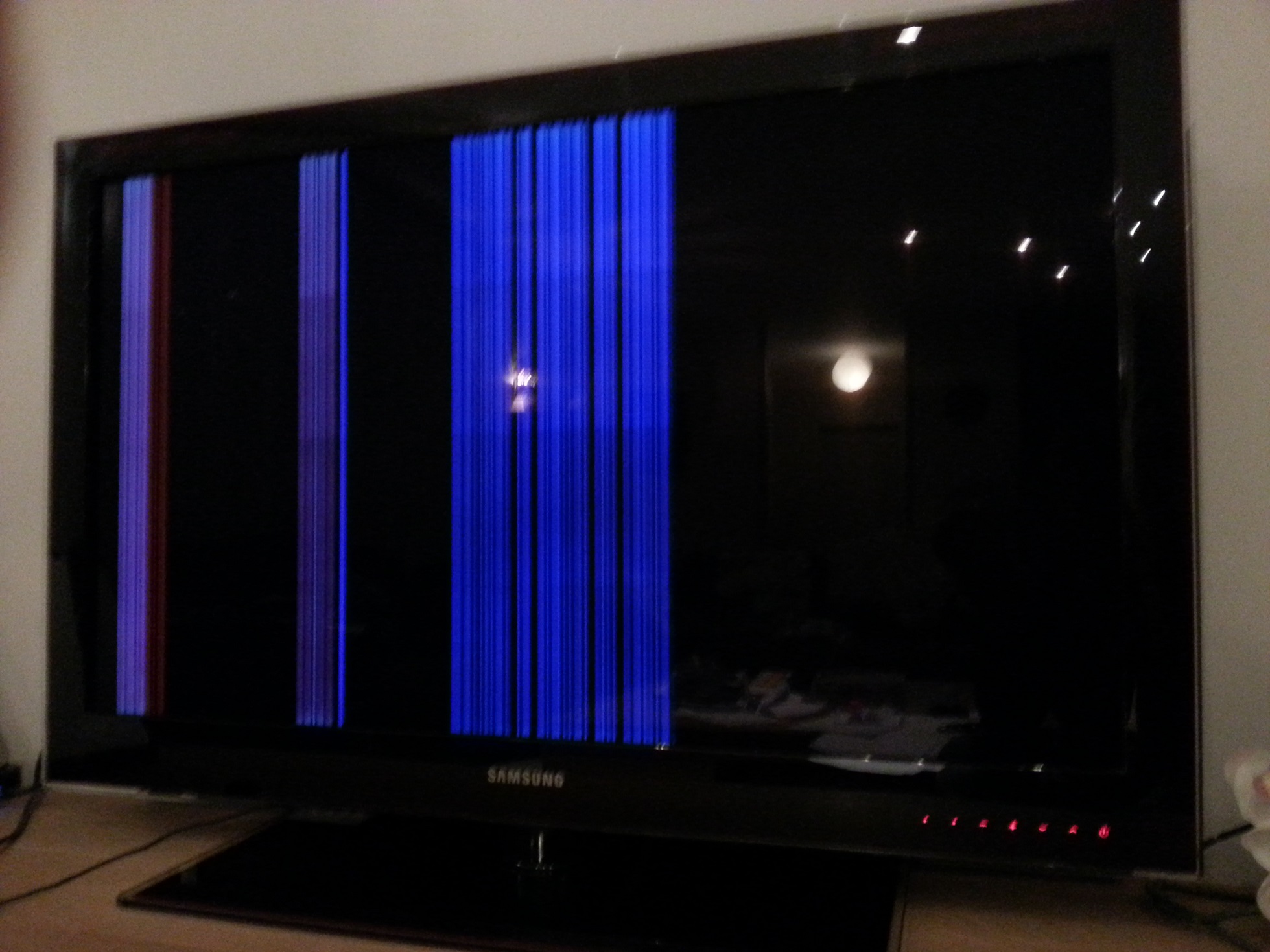

                    Re: Samsung LE40A856 vertical color lines issue | New symptom at startup !
                    New symptom since this week-end : a strange screen at startup.
                    And after a few seconds (heating ?) of this "8 bits barcode" artwork, the picture is correctly displayed.
                    It seems to me that a component is going to die...
                    Does this new symptom helps in my issue's diagnosis ?
                    Also, I have to correct myself about temperatures : some pieces of electronics run quite hot (60°C) when displaying dynamic/moving pictures for one hour or more.
                    These parts set on the long board in the left part : I think it's backlight related.
                      Re: Samsung LE40A856 vertical (image relative) color lines issue
                      That looks even more like a bad panel, unfortunately! Mine isn't doing that yet though.
                        Been there a few times with very similar, if not the same issues, definitely with Tom66 on a bad panel so time to part it out I think.
