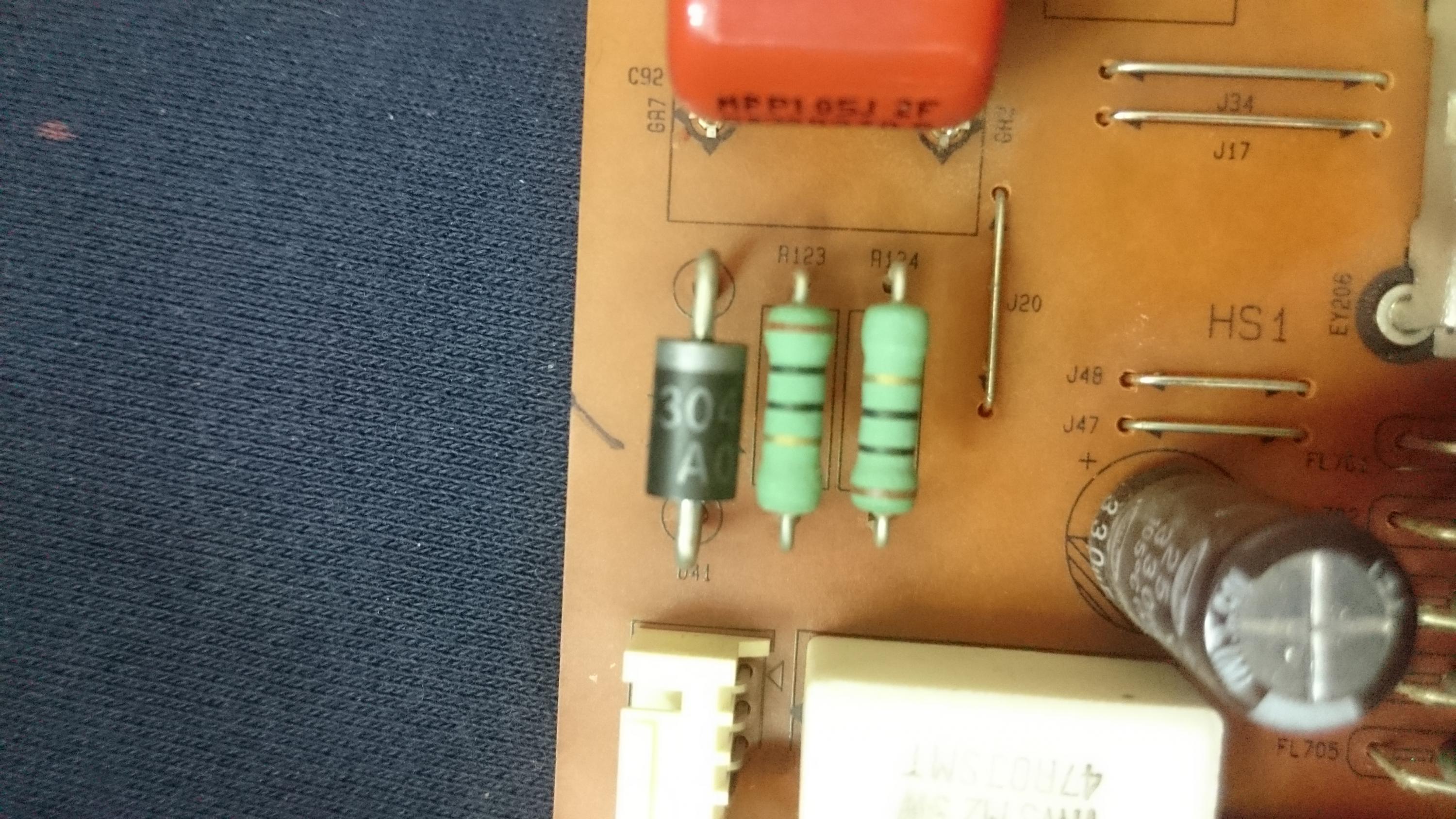

              Hi. I have the clicking noise from the same TV. Ysys board was shorting, replaced 2x30f124 and ysys now OK. The problem is on my zsys board the diode D41 is showing short when on board and ok when desoldered. Any one can help?thanks

                  Resolder coils on Zsus the diode is fine as its connected with the resistors which have a low enough ohms across them to show up as S/C.

                    Re: 42PJ350 click noise
                    Hi. Resoldered coils, is still clicking. When trying to power up voltage goes up and then it clicks and voltages back down. With xsus disconected from controler board every voltage stays normal
                      Just recently repaired one of these the xsus was faulty but upon fixing it had also blew the Ysus just an idea
                        Yes when the coils for the erc on the Zsus fail they can kill the fets (normally 30f128 pn) on the ysus.
                          Yes I have another 30j124 mosfet gone bad on ysys,will replace that and will update. Thanks for ur help. Best forum
