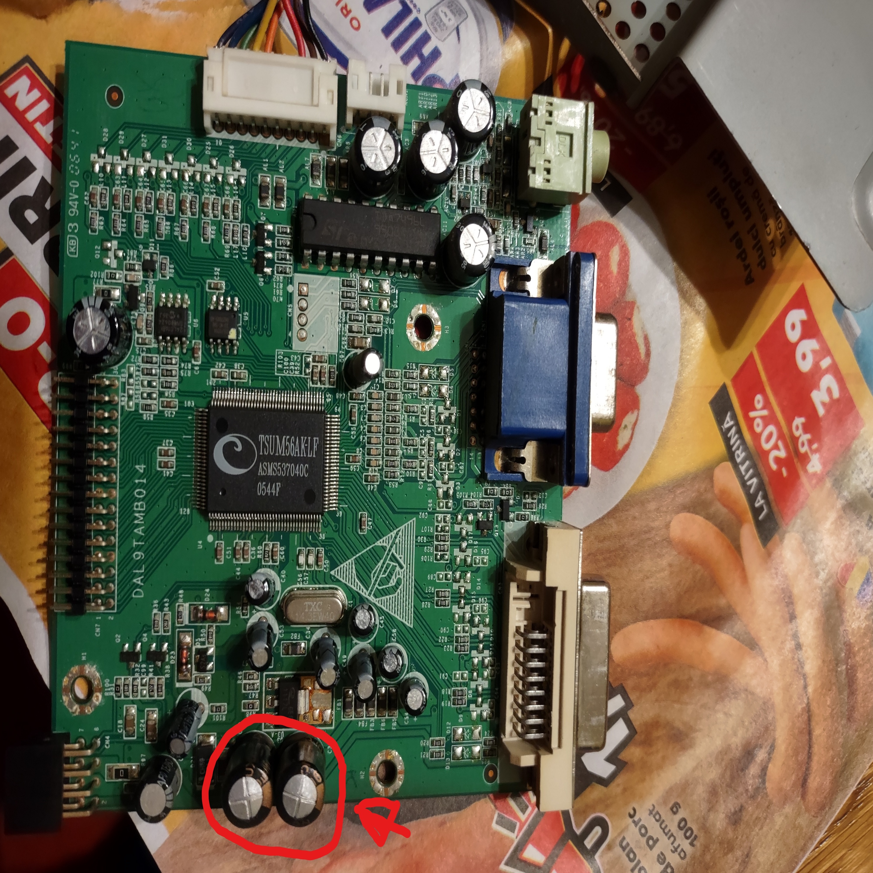

    Hello, guys i need some help, i have an old fujitsu siemens LCD monitor, and is making weird noise when is changing resolution or in standby mode.

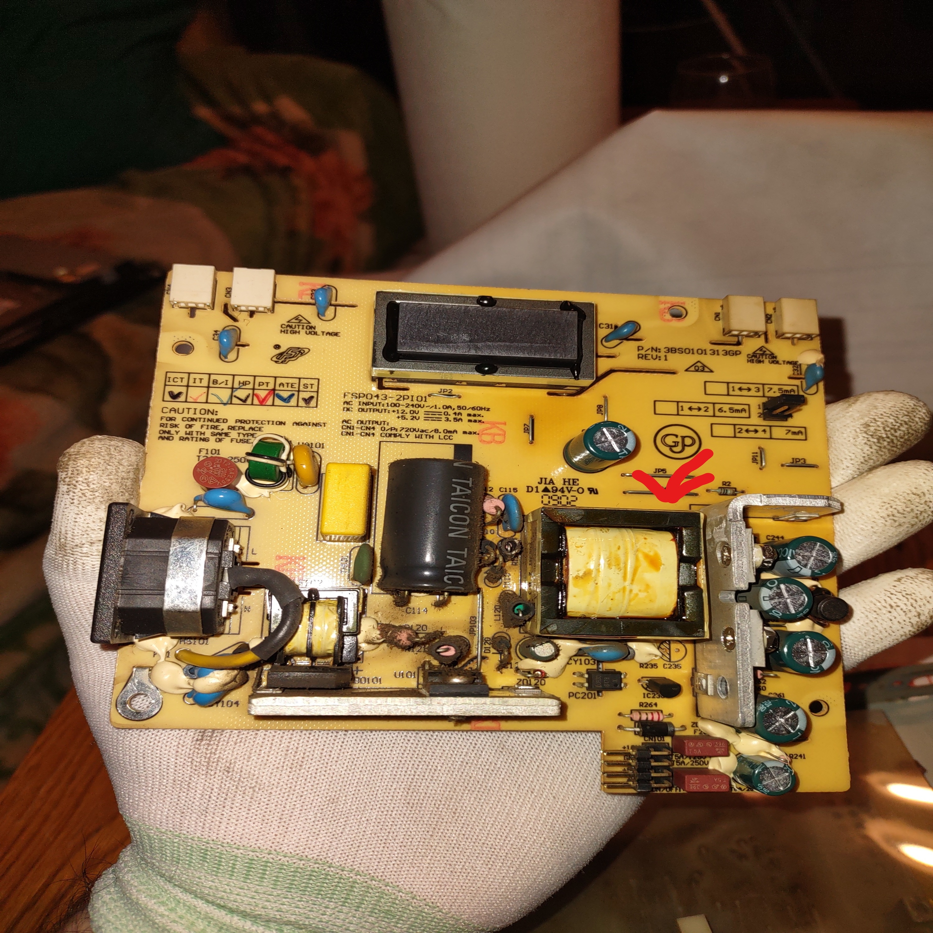

    I open it up, to see if it is any hardware damage, but i only see 2 capacitors bulging on the logic board, i'll probably change them. On the power supply circuit board, only one thing caught my attention, the transformer seems to have leaked something out of it and the mess around it. Do you think there may be a problem here?

    The transformer looks OK, just the varnish it's been dipped in.
    I'd recap the power supply too.
    And as much of the signal board- those can be difficult to remove, but tinning their leads with good leaded solder can make removal easier.

      Don’t worry about that transformer, it came out of the factory like that.

        When the power supply caps croak, it stresses the ones on the logic board.
        Just recap the PSU and those logic board caps.

            I managed to change the capacitors from the power supply board and from the logic board, and the weird noise is gone, but it was a pain in the ass, mostly because i have a cheap soldering iron from China, and it won't properly heat to melt the solder.
