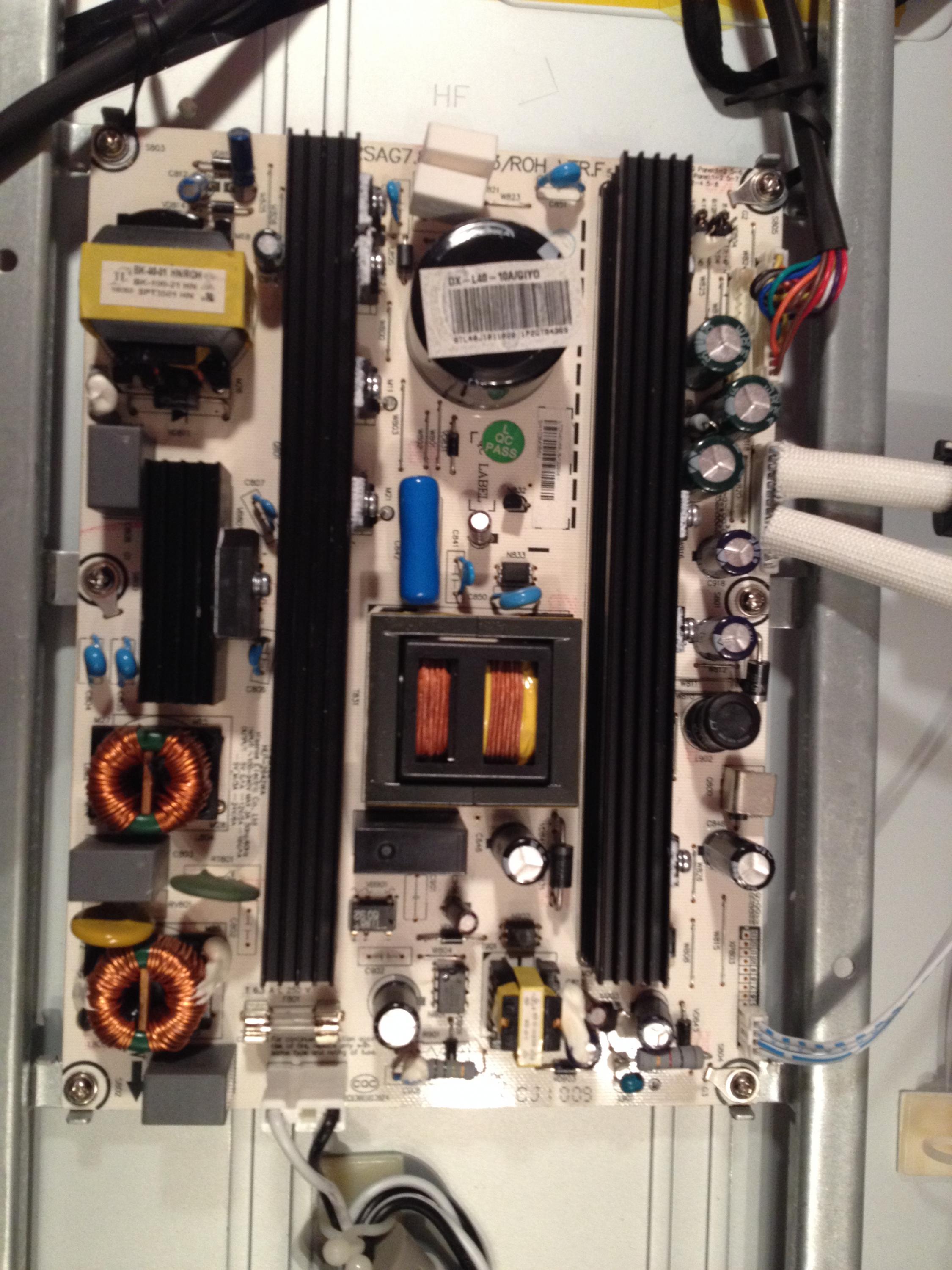

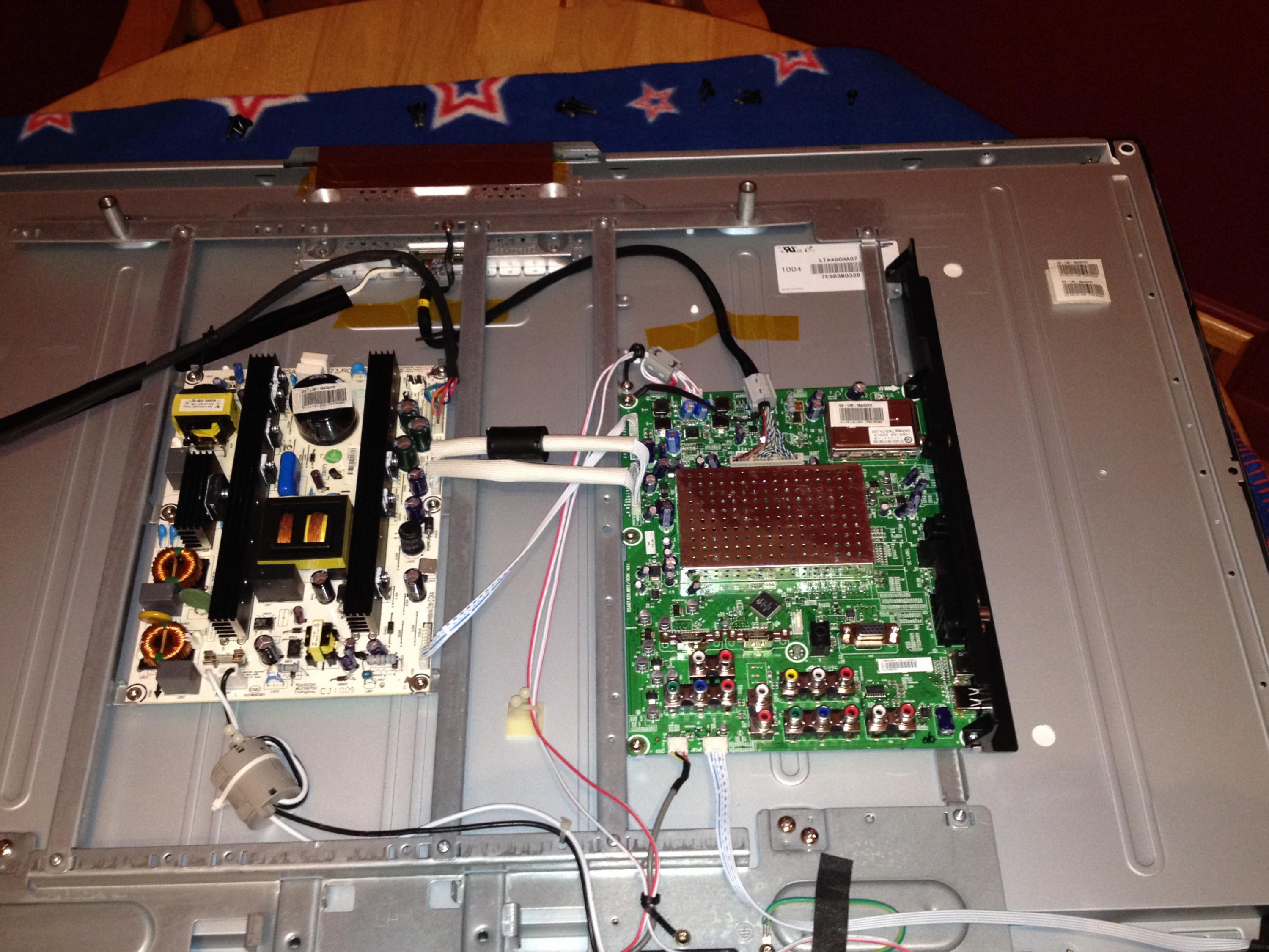

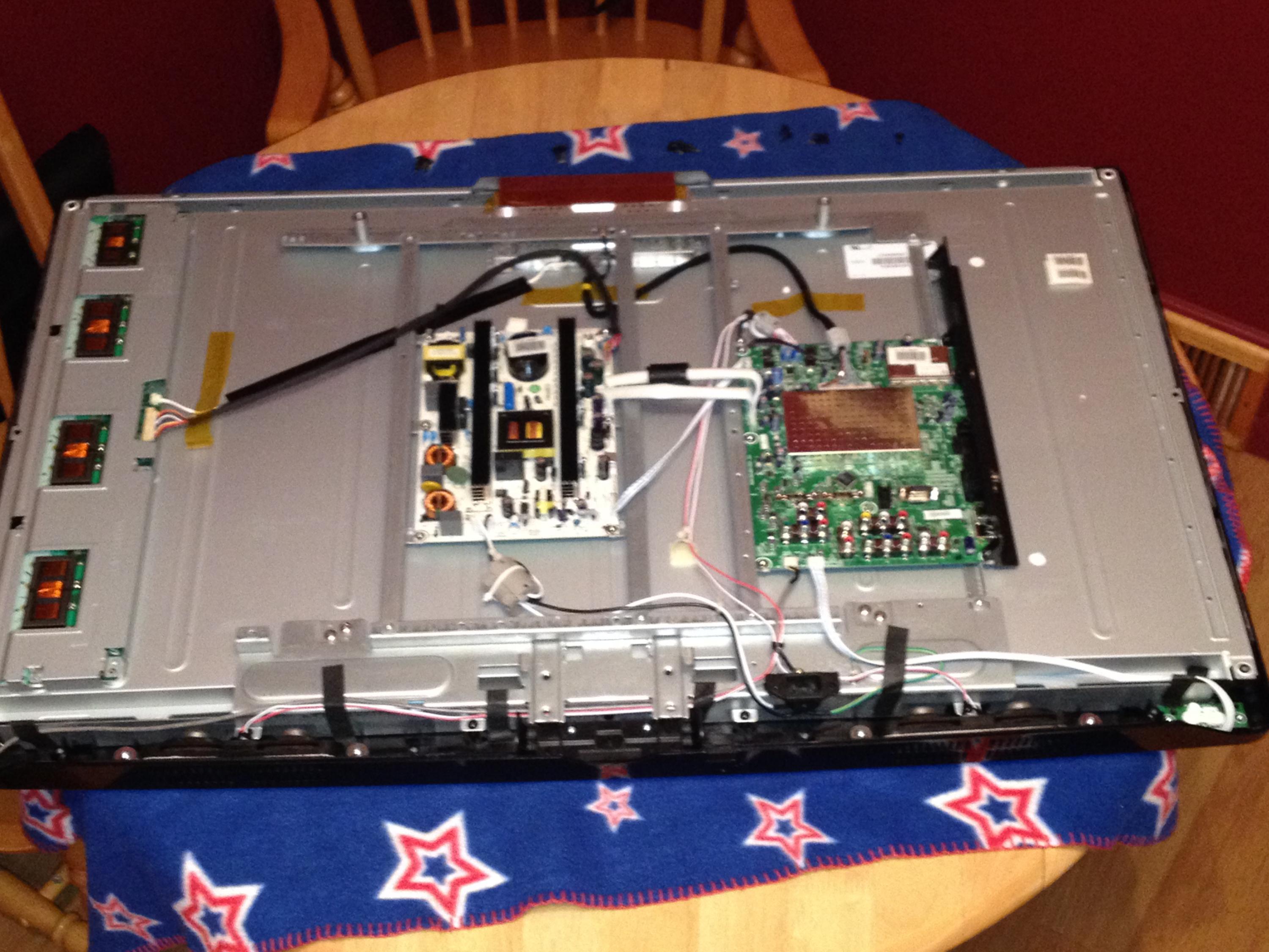

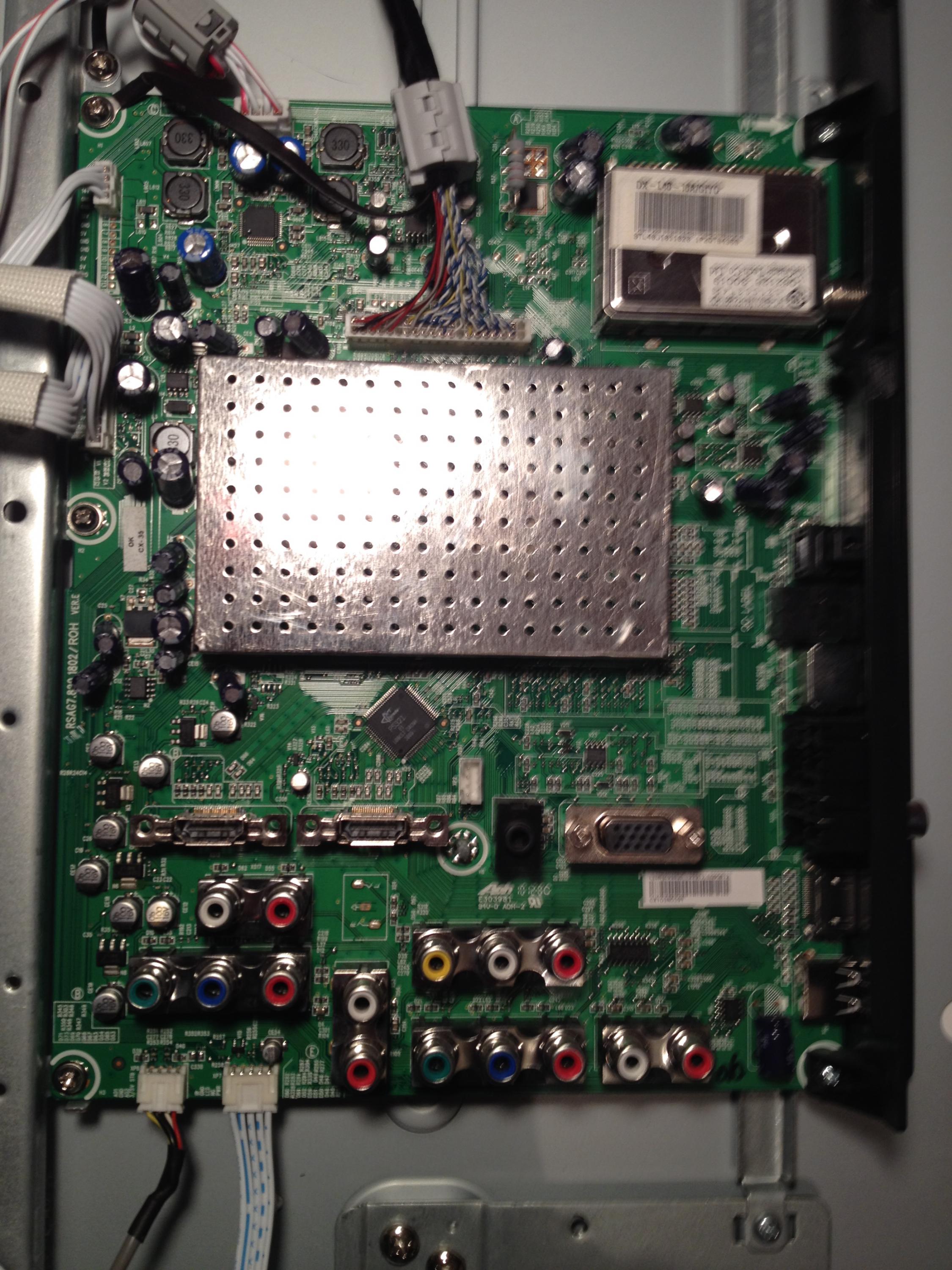

    Here's the pics that I took.

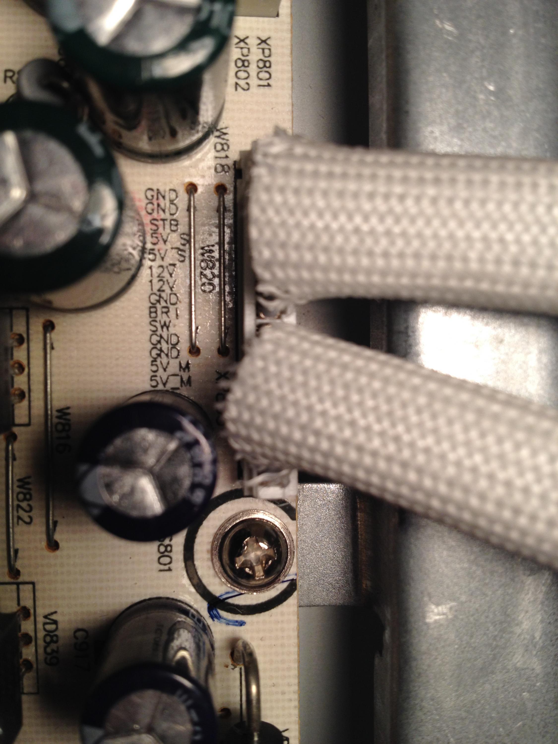

    Here's the results of trying the resistors.
    GND 0
    GND 0
    STB 5.3
    5V S 9.8
    5V S 9.8
    12V 0
    12V 0
    GND 0
    BR1 0
    SW 0
    GND 0
    GND 0
    5V_M 0
    5V_M 0

      You should verify your meter and meter batteries, 9.8VDC on the 5Vstandby is not right.
      Notes: STB pin = PS_ON

                  I feel stupid because I did have my meter in VAC. Here's the new results. I don't think my meter it quite calibrated correctly yet but I'm sure it's better than it was.
                  GND 0
                  GND 0
                  STB 2.48
                  5V S 4.28
                  5V S 4.28
                  12V slow drop to 0.01
                  GND 0
                  BR1 slow drop to 0.01
                  SW slow drop to 0.01
                  GND 0
                  GND 0
                  5V_M slow drop to 0.01

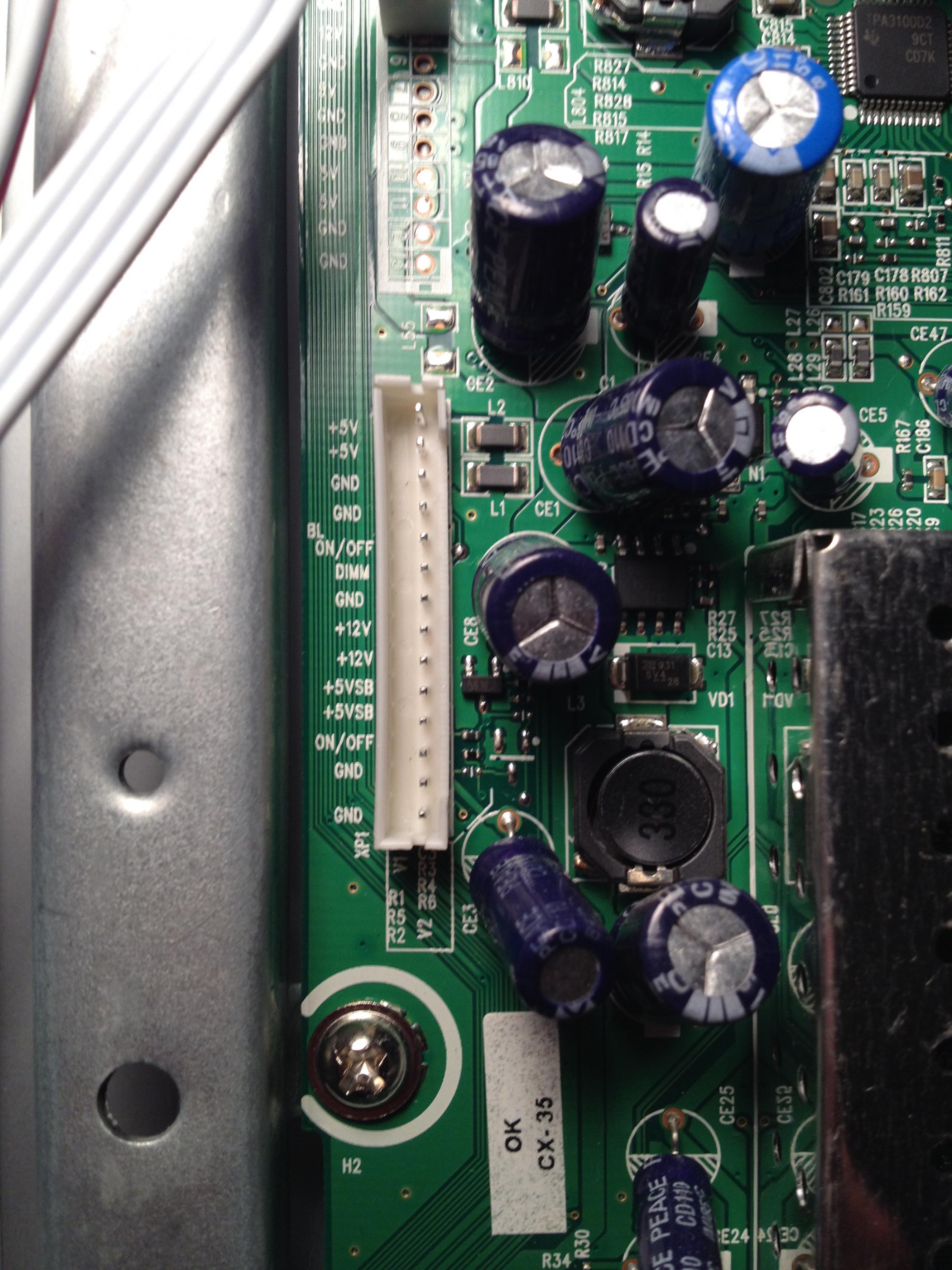

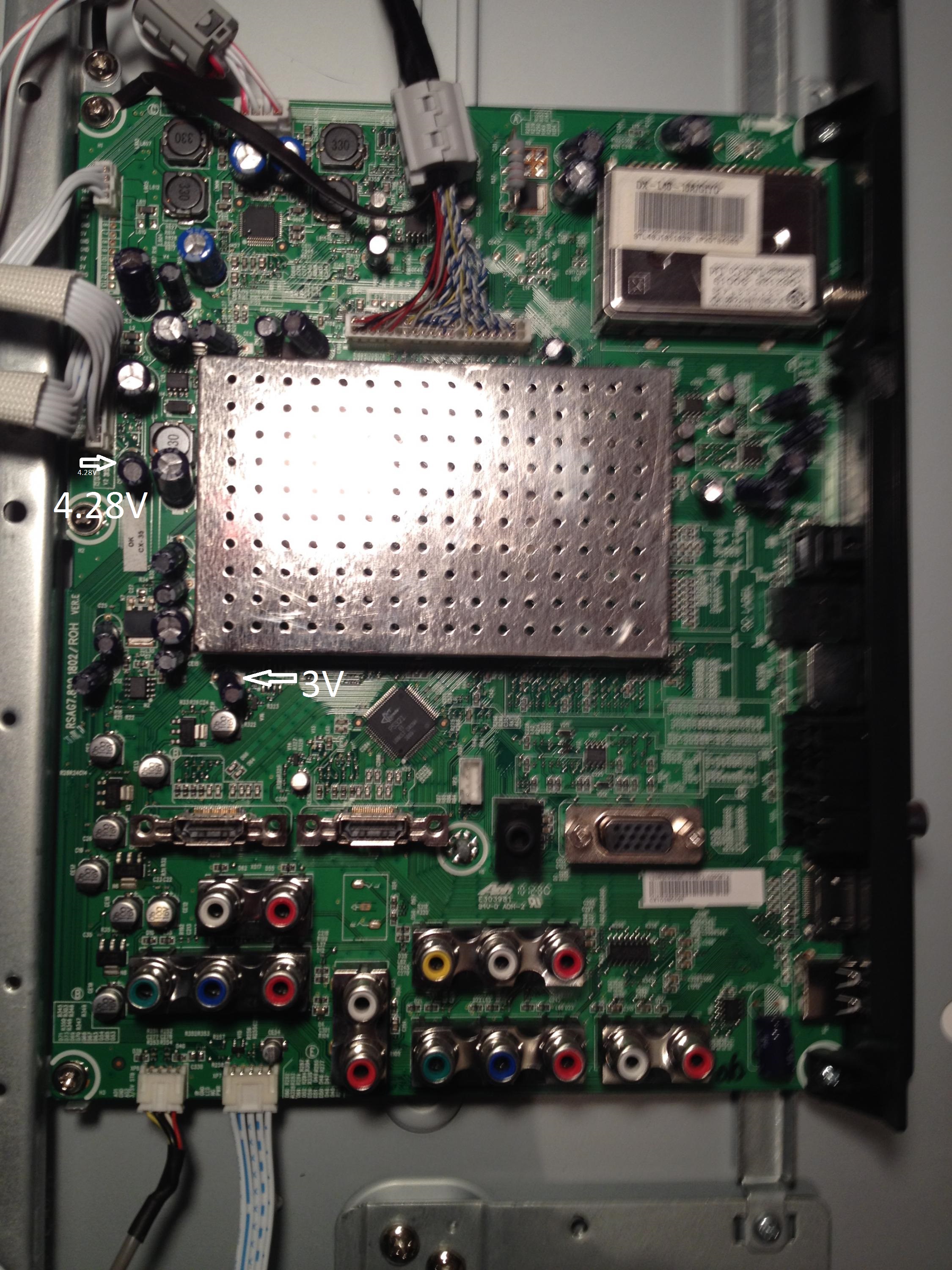

                  I found some readings on the main board but I'm thinking there's a cap that might be bad in there.

                    Since you made the adjustment to the meter so now it is no longer correct. I would get another meter first since wrong reading will cause lots of wrong diagnostic of the problems.
                    4.28V for 5VSTBY is too low for the circuit to function properly, but since we do not know if the your meter is correct or not at this point it will not be good to go further until you have good meter.

                          I recalibrated my meter with a known good one and here's the results.
                          GND 0
                          GND 0
                          STB 2.8
                          5V S 4.84
                          5V S 4.84
                          GND 0
                          GND 0
                          GND 0

                            Hmm... It's like the power supply turns itself off. 5V STBY going out, PSon coming back, tries to fire up, but then shuts down. Dang. This test is done with the main board installed, no resistors?

                              Correct. Boards in and connected, no resistor.

                                O.k. in post 32 you say for example: 5V_M slow drop to 0.01
                                What is the highest voltage reached on the 12v and 5v m?

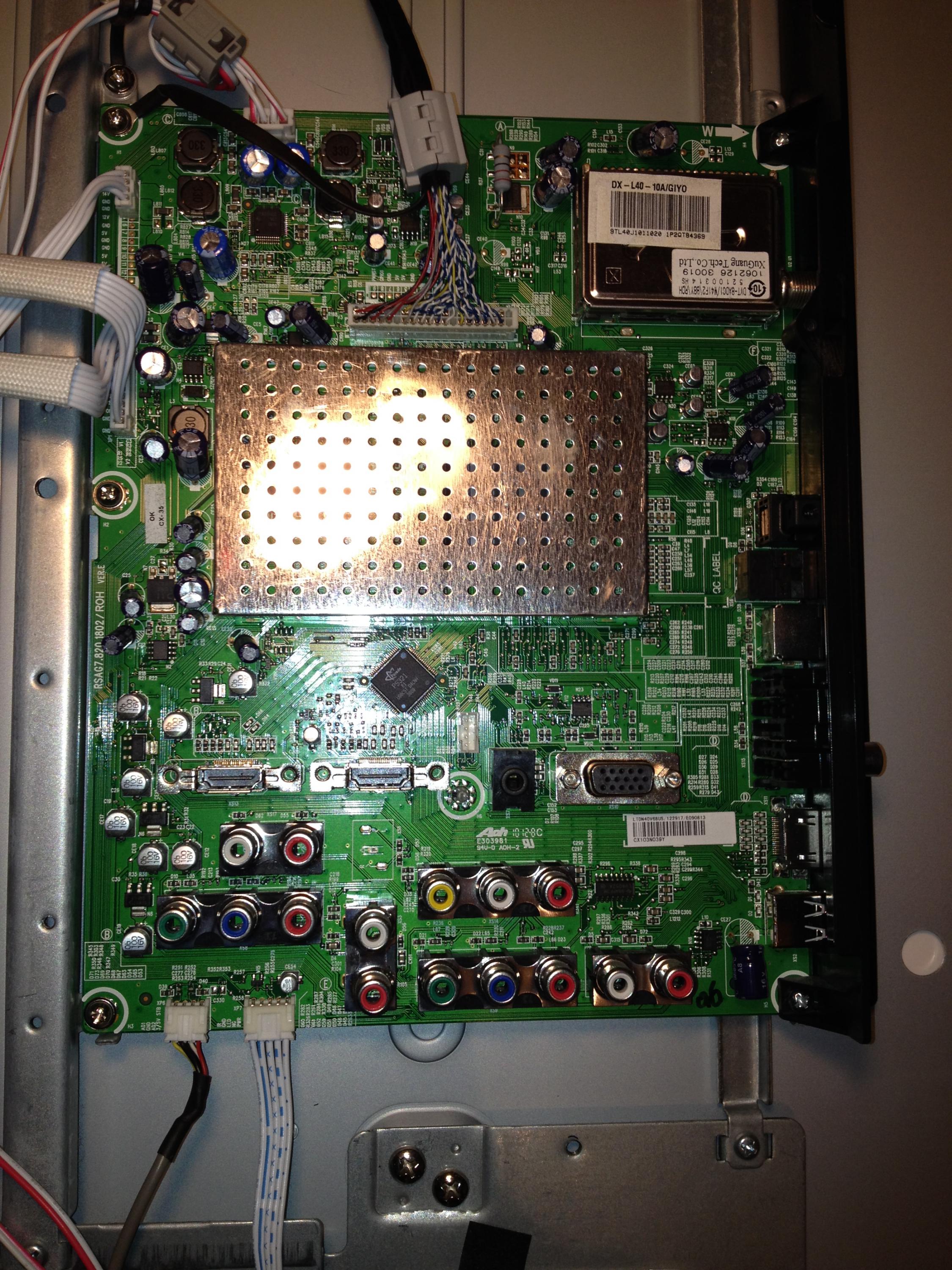

                                Can you leave the board in, unplug the main board and force it on again? Redo all the measurments?
                                Maybe heat has something to do with it?

                                  I'll try that tonight. I do know that the voltage starts dropping immediately after plugging in.

                                      Should I be trying to unscrew the main board and take readings while its powered up from underneath?

                                        If you want you can always solder some wire on these hard to get at places. Just remember to be carful with these open wires, you may not want them to short out on something.

                                          Did you try to heat up the main board where I circled in red. There is a bad cap there. Just pin point it. Good practice.
