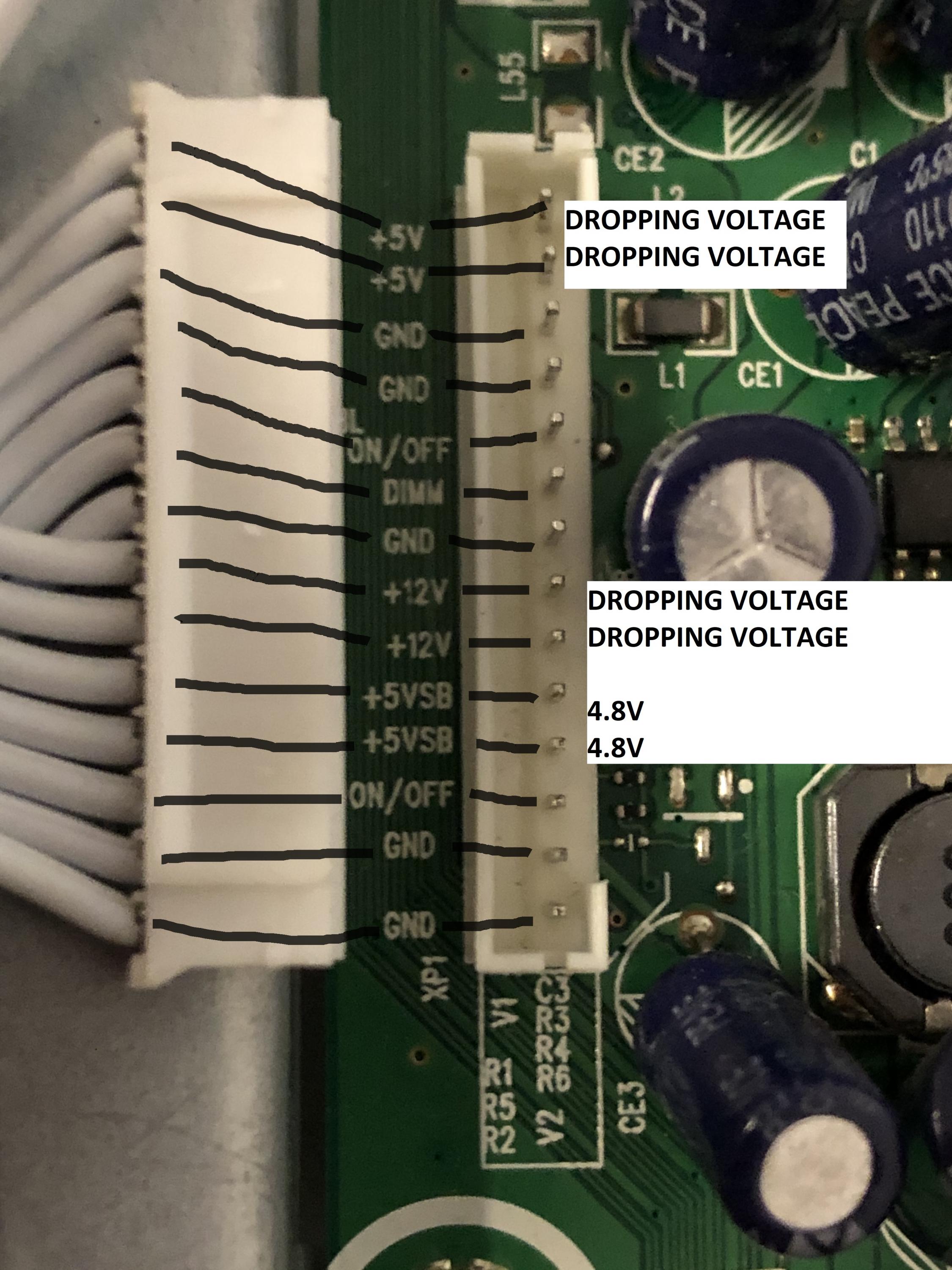

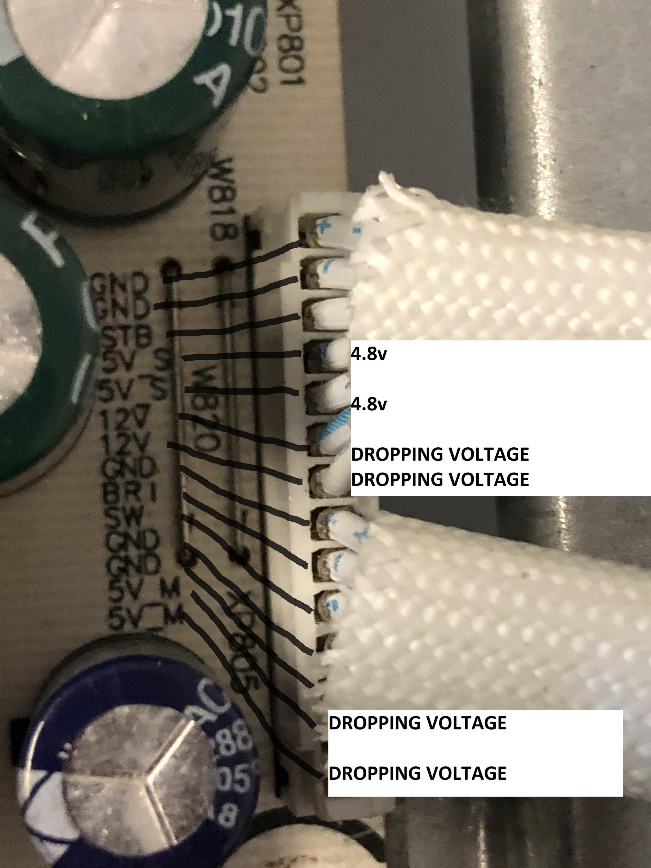

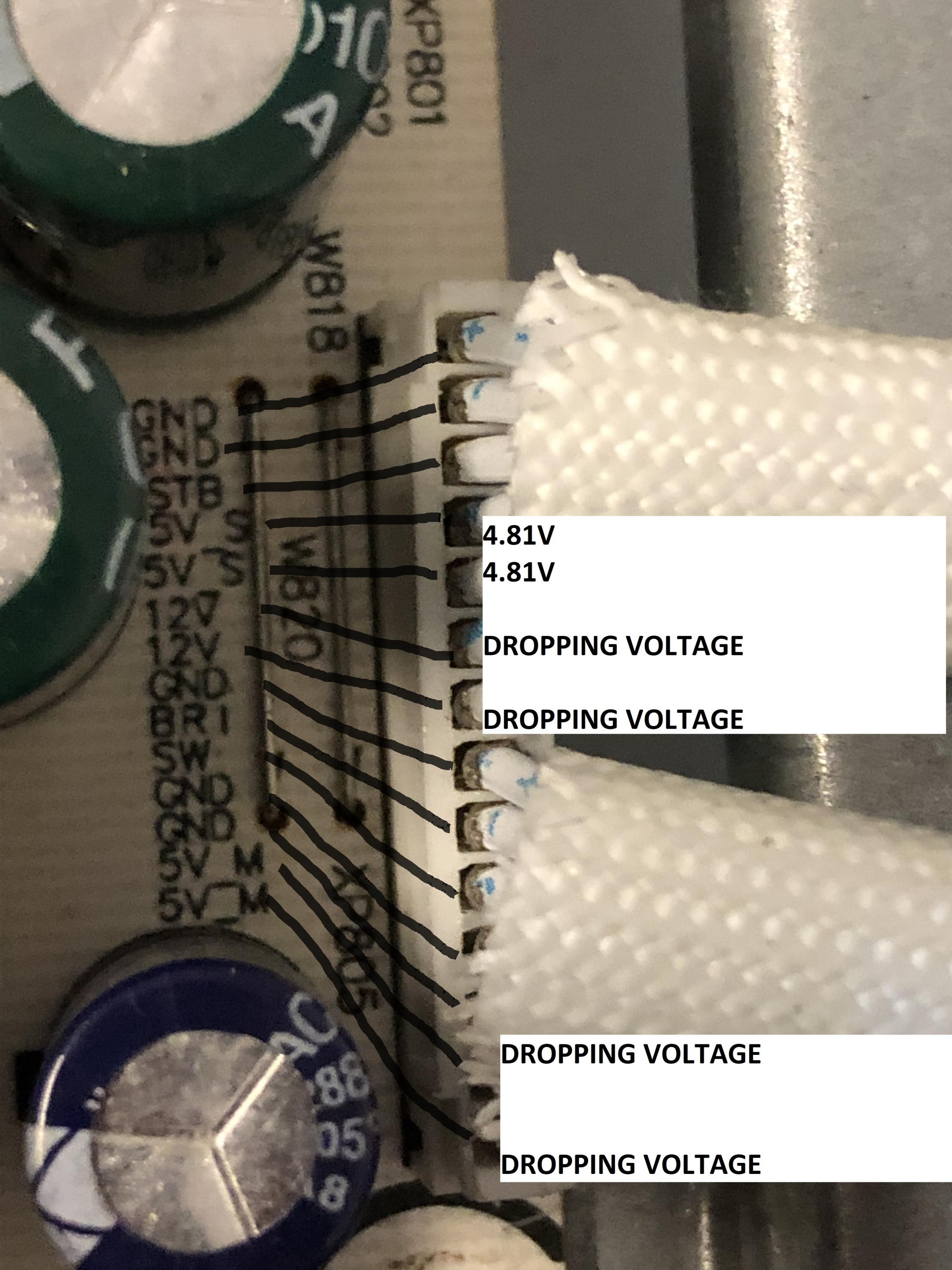

        Re: Dynex DX-L40-10A Won't turn on.
        Originally posted by Funda
        Here's the results of the forced on state.
        GND 0
        GND 0
        STB 2.8
        5V S 4.84
        5V S 4.84
        12V slow drop to 0.01
        GND 0
        BR1 slow drop to 0.01
        SW slow drop to 0.01
        GND 0
        GND 0
        5V_M slow drop to 0.01
        The 12v starts out around 7.9 and then drops. The 5v_m starts out around 4.8 and drops
        This is the first time it's been powered on in days and this time plugging it in with the resistors in there were a lot of speaker pops which at the same time resulted in the readings for the dropping voltages to spike up and fall with each pop.
        I wasn't able to reproduce this effect.
        I would disconnect the cable to the inverter board and see if the 5VM, 12V, 16V, 24V will stay on.
        The 5VM, 12V, 16V, and 24V power supplies (produced by the transformer T831) are switched on by the STB (PS-ON).
        So it is either the main power supply kicks into shutdown due to over load or the PFC Voltage drops down.

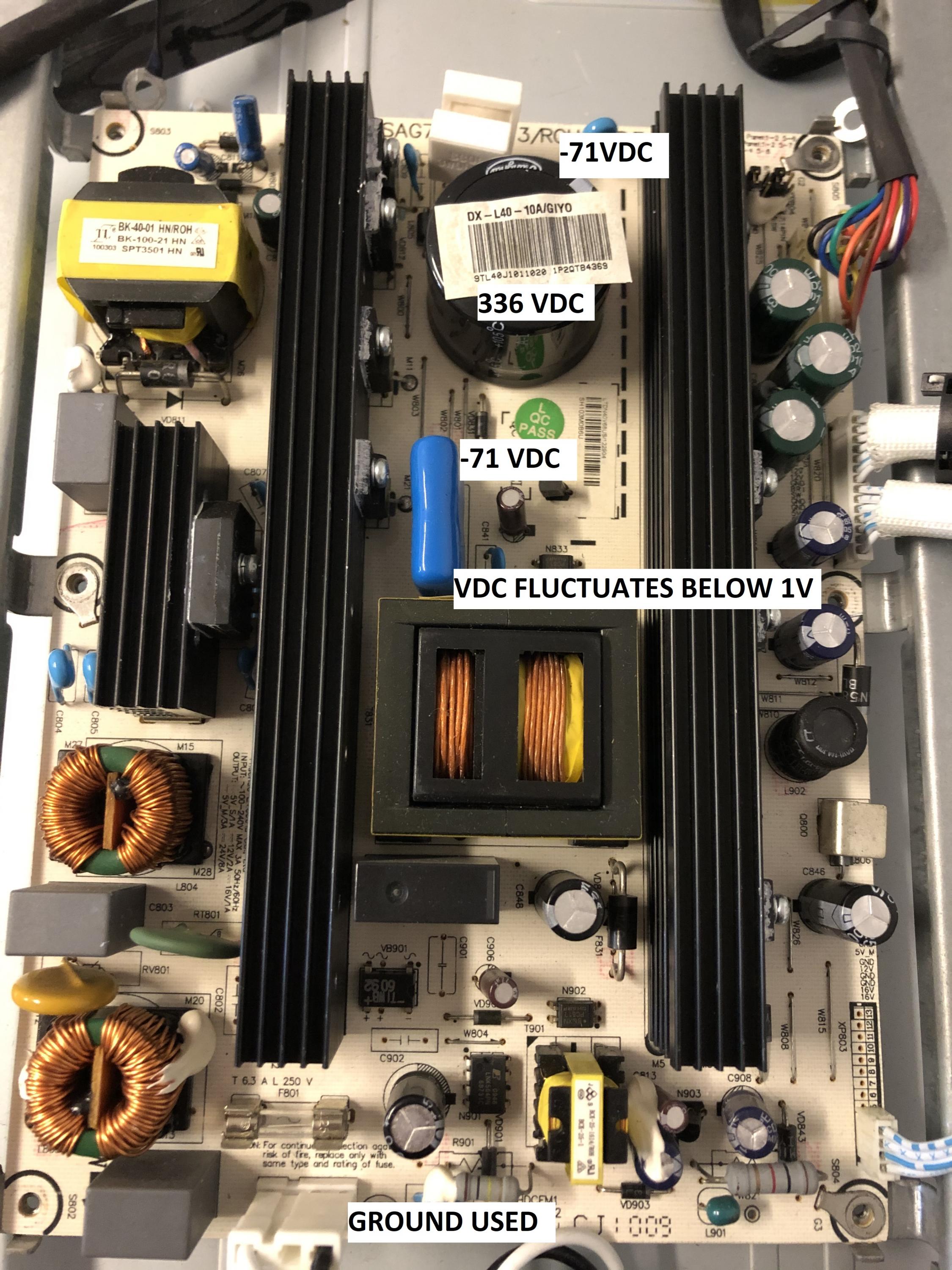

                  #68
                  Do you have anything to check capacitance with? May be worth a try looking at that big blue cap C842. Resistors you can check with the power supply disconnected and your DMM in Ohm mode. If any thing gives you something weird, it is always wise to lift a leg or take the component out of circuit and check it with the DMM.
                  And we still need to see how much DC voltage is on the big black filter cap.
                  I don't think my meter can measure capacitance.
                  I checked that resistor I thought was bad and it's reading 1k like it's banding identifies.
                  I rechecked VDC on the filter cap and it's reading 336 VDC on one side and -71 on the other using incoming power plug ground and still reads 411 across the pins.
                  I checked C842 and put that in the pic as well.

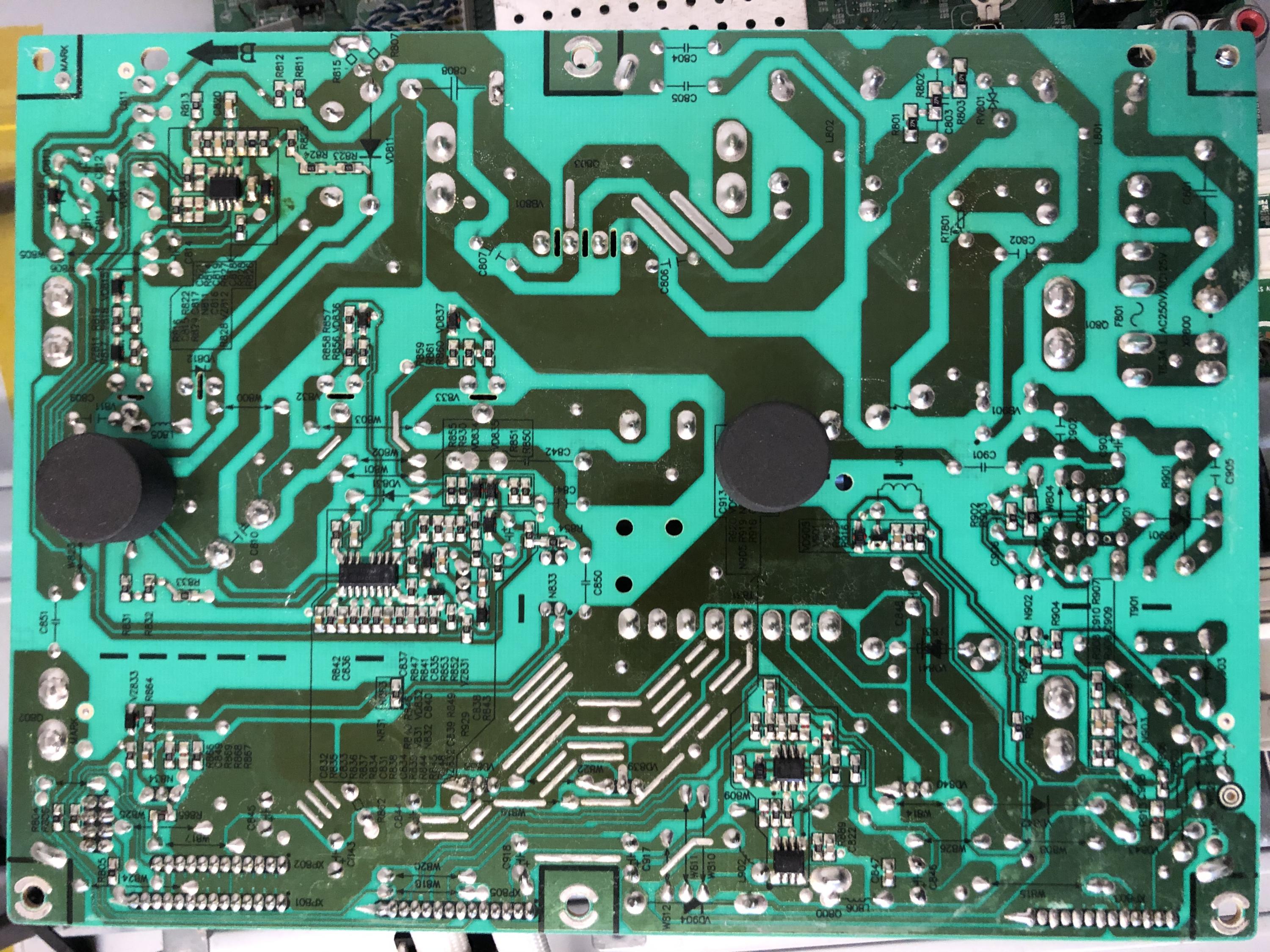

                    #69
                    Here's the back of the PS board. The pic I uploaded isn't turned to the side.

                      #70
                      When ever you check voltages in the primary (hot side) you need to use hot ground, in this case the large capacitor, negative leg. So measure the voltage on C810 ACROSS it not from chassis ground.
                      to turn on the power supply board, the cable between the power supply and main needs to be disconnected, Then connect a 1k resistor between 5V_S and STB, this should turn ON the power supply. Check if you get 12V
