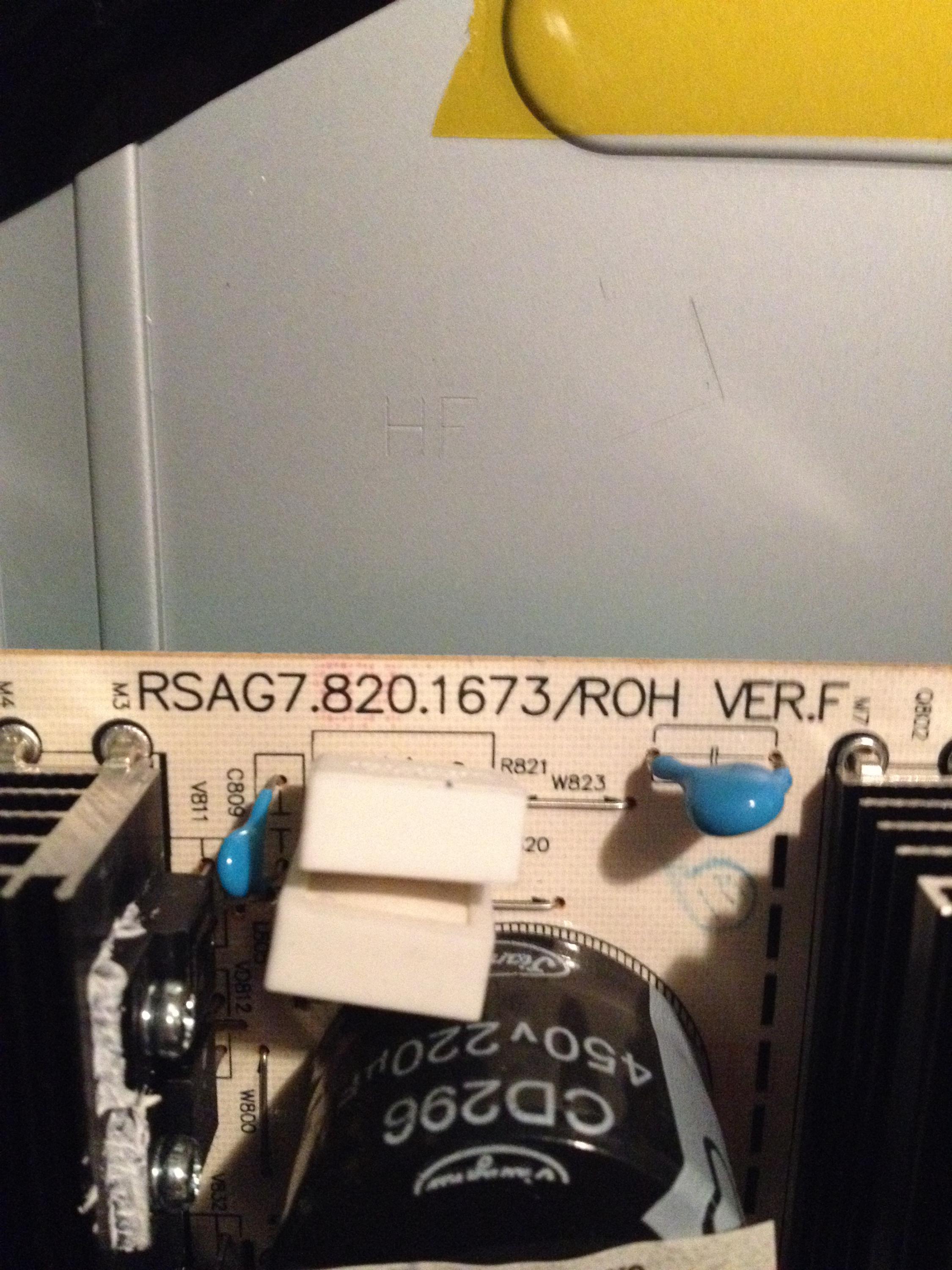

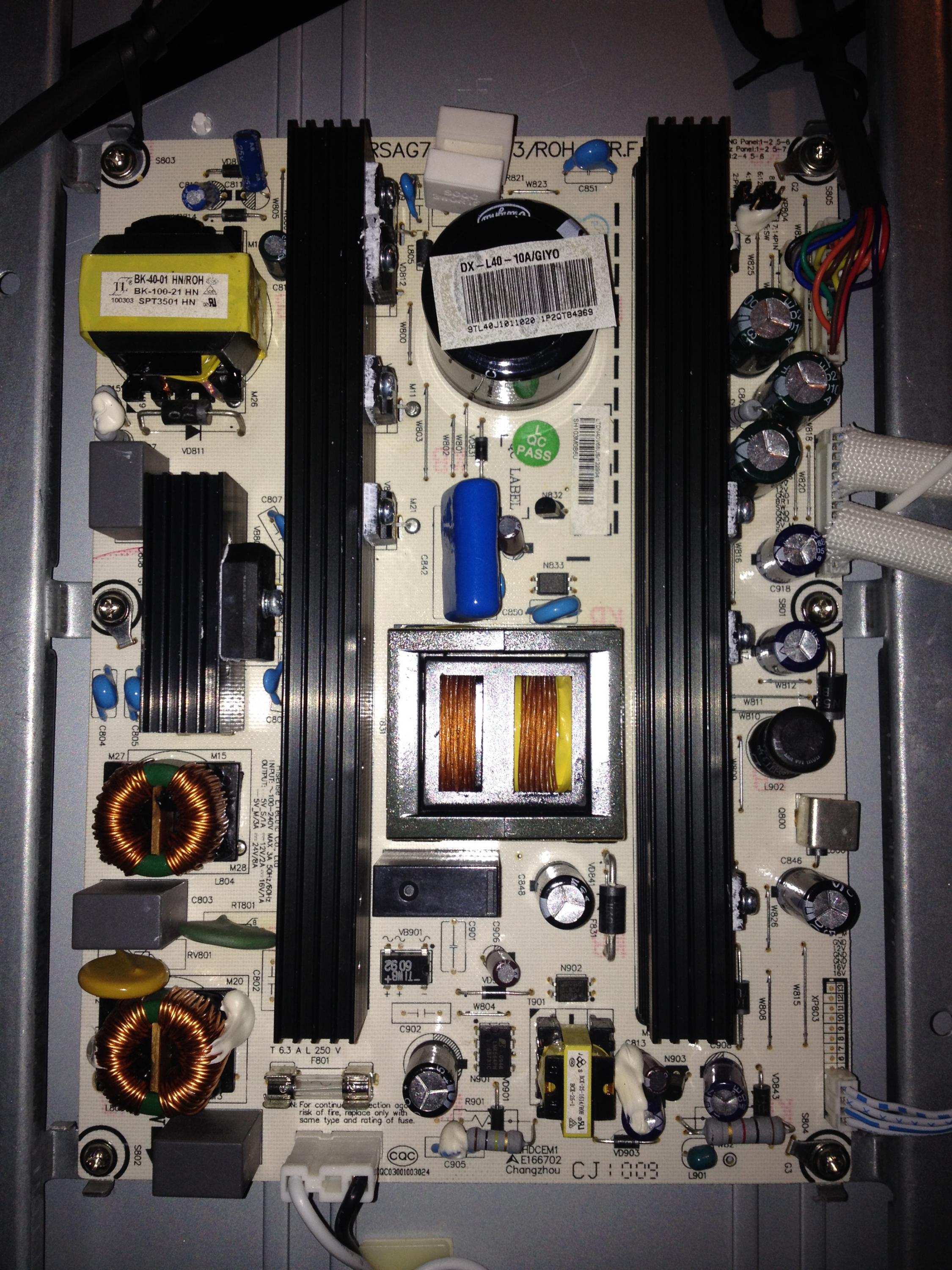

    Hello all. I am in need of your help. I picked up a free tv from work because it was being replaced, it won't turn on, and I can't find the cause of the problem.
    I hear a click when I plug it in but the red stand by light comes on and neither the remote or the touch pad will turn the set on or change the light to blue. I don't hear any other sounds from the circuitry when trying to power it up but in the dozen or so times I've plugged/unplugged it it's made sounds from the speakers a couple of times.
    I took a few voltage readings and there does seem to be something wrong to me. On the PS board the connector going to the main board is supposed to have 12v on at least 2 of those pins. I'm reading 9.8 on both pins labeled 12v.
    I don't really see any obvious damage but on the underside of the PS board there's some oily residue in one small area, like the part on the other side got too hot and cooked that spot, but nothing looks fried per say. That spot is in the first pic under the yellow banded piece in the upper left corner.
    I'm not sure what to check next and could use some guidance.

    Need better pics with pinout from the PS connector going to the main board. Basically you can unplug this connector and force the power supply on with a 1k Ohm resistor between PSon and STBY voltage (5v), BLon (back light) and 5V. That should turn on the power supply rails and the backlight should be on. Then measure voltages again.
    I think your case is a main board problem.

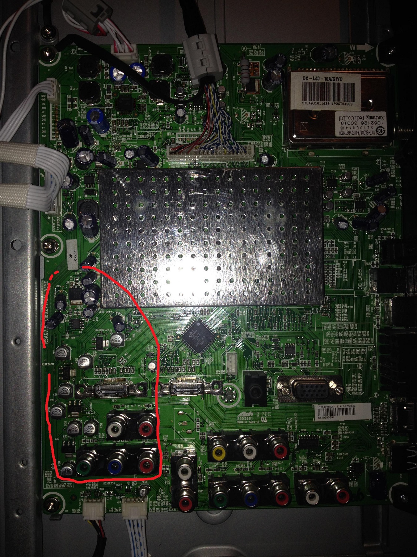

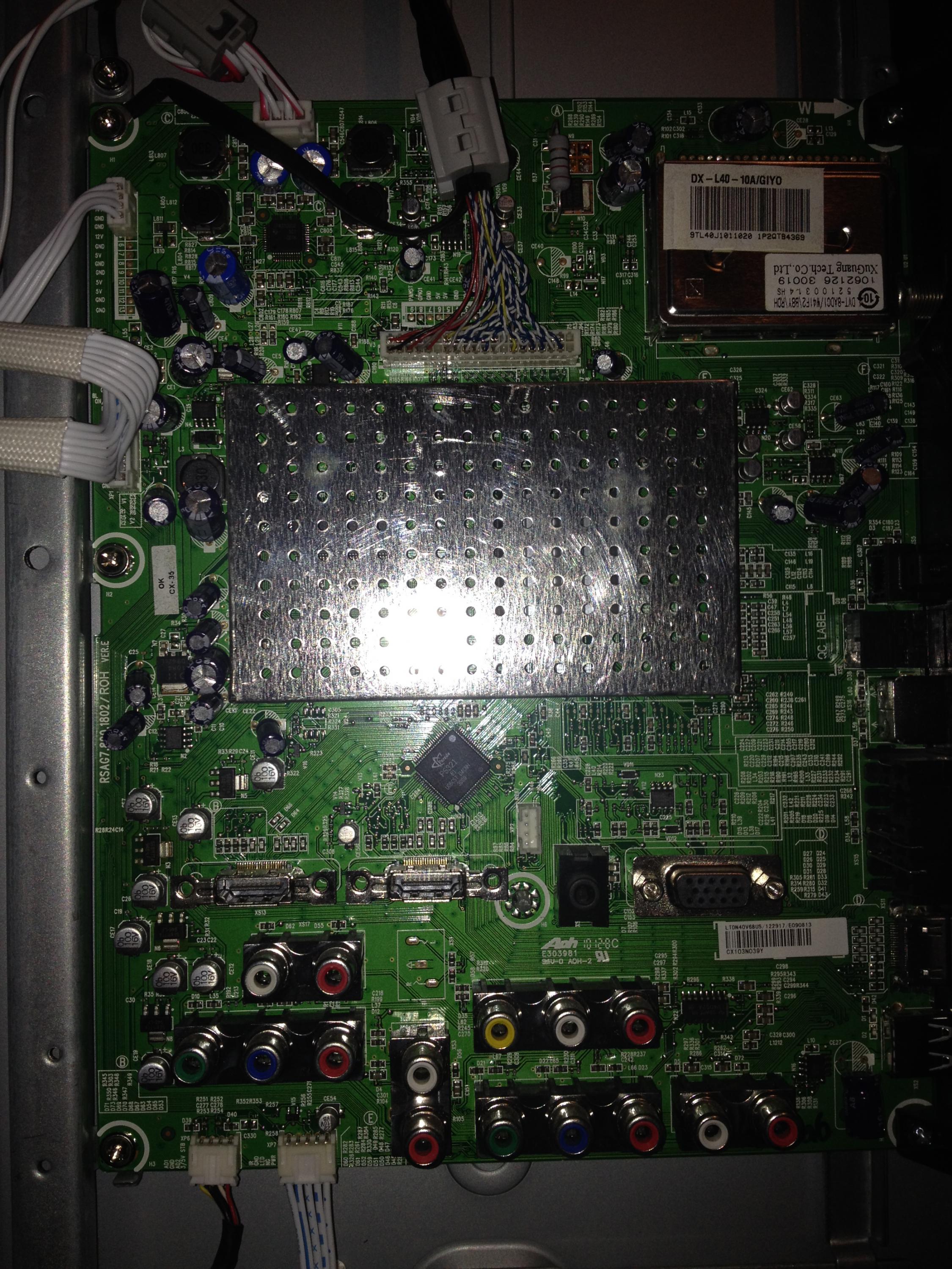

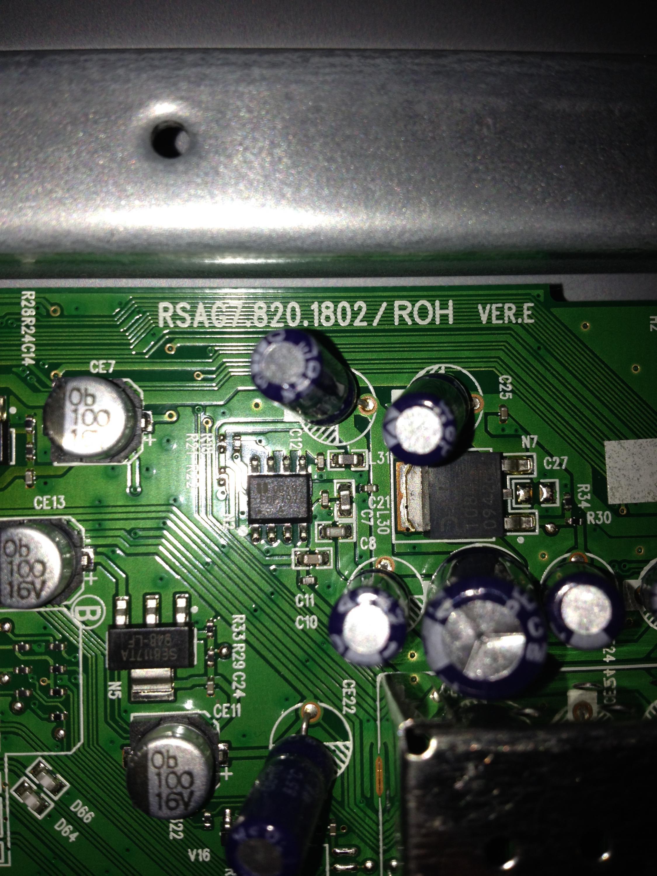

        I had the same problem same set. Try to heat up the lower left of the main board.
          Re: Dynex DX-L40-10A Won't turn on.
          Pictures of the whole backside of the TV?

                    Just tried doing the resistor trick and I do hear the click noise as if the boards were hooked together but there's no backlight and it doesn't come on still.
                    One thing to ask tho did I need to leave the cable plugged or unplugged. I tried it unplugged.
                    I was also using 1/2W resistors
                      Unplugged from main.
                      You are tricking the PSU into thinking the mainboard is causing load on the connections thus initiating them.
                      Did you test voltages again? If so readings?
                      Also picture of the connector from PSU to main so we can see the voltage legends

                        With the resistors in I am getting 5.3v at pin STB and still pulling 9.8v at both 5V S pins. All the rest read 0. That's on the PS board.

                          PS board pinout
                          GND
                          GND
                          STB
                          5V S
                          5V S
                          12V
                          12V
                          GND
                          BR1? BRL?
                          SW
                          GND
                          GND
                          5V M
                          5V M

                            So you are saying that you unplugged the main board from the power supply and forced the power supply on and you are still getting 9.8v where you should get 12v?

                                Yes still getting 9.8 on the pins 3,4&5 down from the top. That would be the 5v pins on the PS board. If u want readings from the main board I'll have to do that tomorrow. Already closed it up for tonight.
