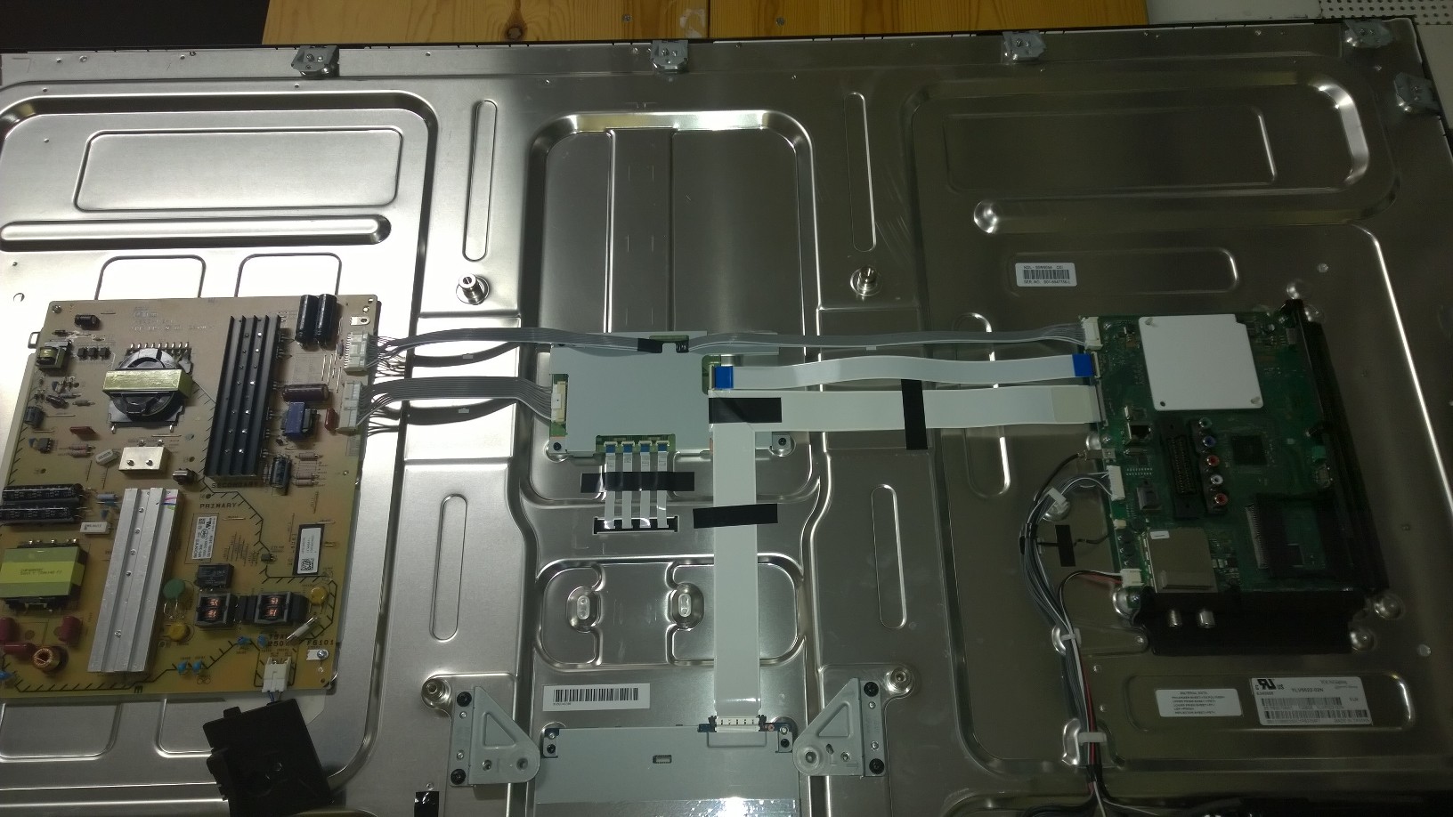

    Tried to find the meaning of those three blinks. Cannot locate any tech docs for this model.
    It's a Sony KDL-55W905A blinks in a sequence of three blinks and pause.

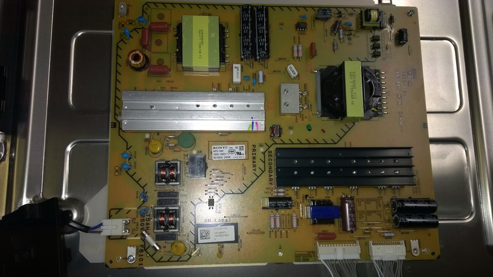

    PSU "seems" to generate the correct voltages, the most obvious are there though.
    Two pics attached.
    Any advice is appreciated!
    Re: Sony KDL-55W905A blink code

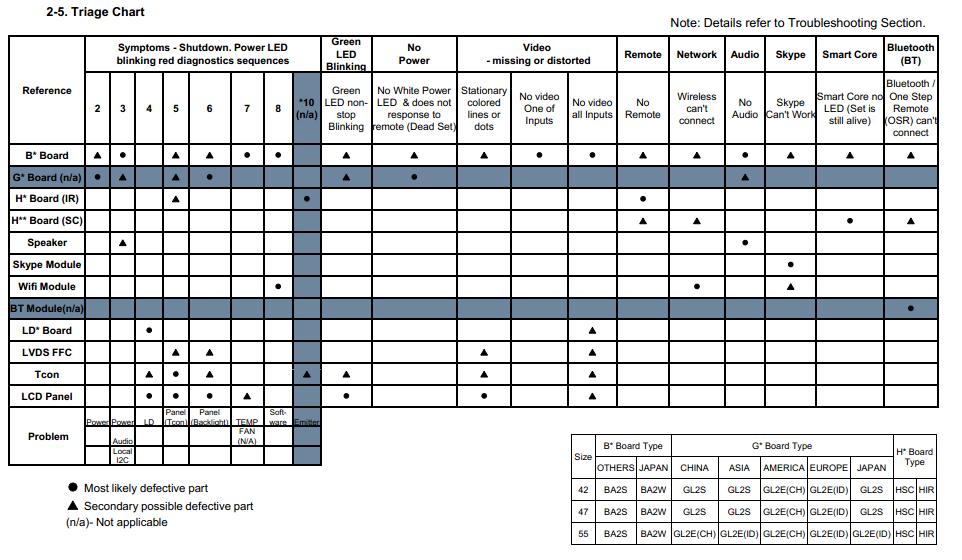

    Pls. post clear photo both side of each pcb.
    check with this chart, if you have same board.

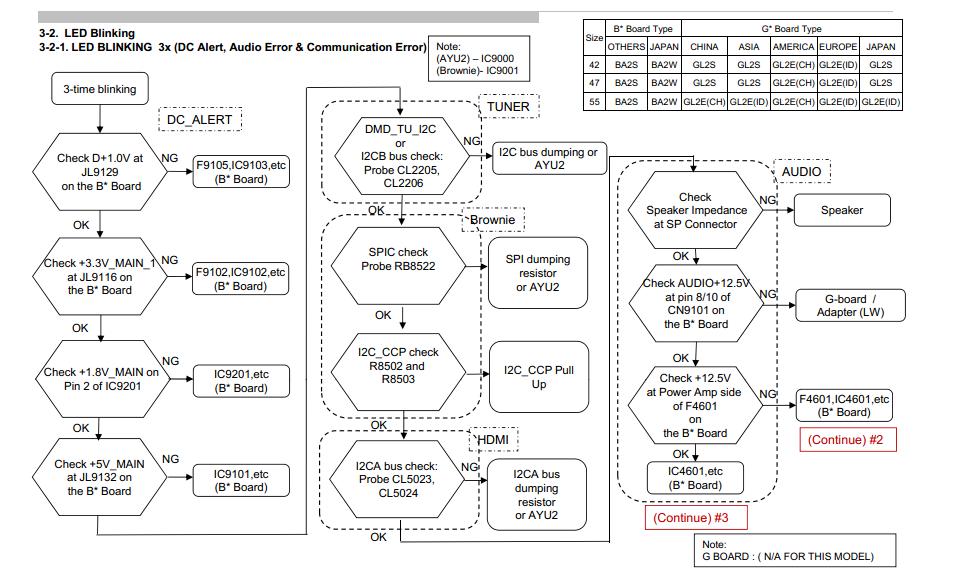

        some more, could be an audio issue. 3 BLINKS
        The first thing to check when a 3X blink protection mode occurs is the physical condition of the speakers and speaker connections. The speakers should measure 8 ohms. Shorted speakers or connections can cause a 3X blink protection mode.
        If the speakers and connections check okay, then the defective component is on the main board. Either an open F4200, defective DC regulator or defective audio amplifier will cause a 3X blink protection mode which would require replacing the main board.
        A defect on the Power Supply Board may also cause a 3X blink protection mode and shut-off. Check the AU12V level at CN6704/pin 14. If 0V is measure before shut-off the power supply board needs to be replaced.

              This guide points towards a defective mainboard.

                        According to Anmol's troubleshooting chart (post #2) a blinking green led is most likely defective LCD panel.....
