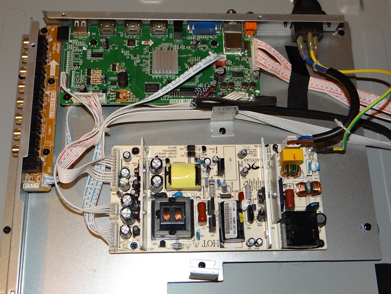

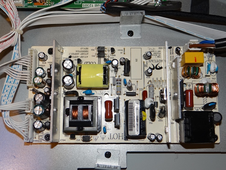

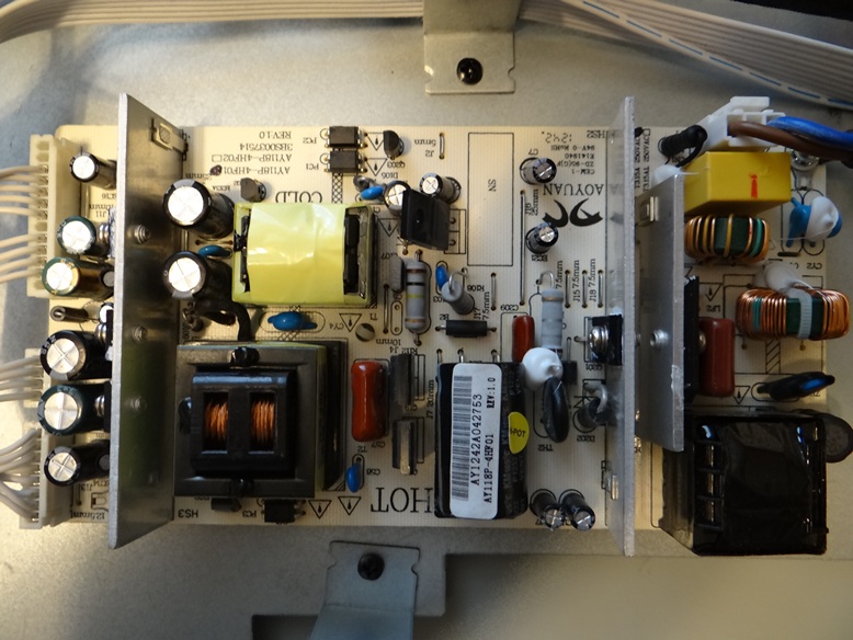

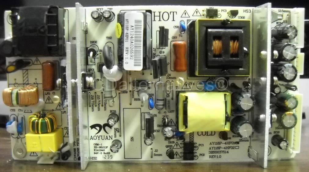

      Re: Sceptre X322BV-HD*XVNO5 blue light only
      is this the powersupply?
      • jumpingjoeusa
        • Feb 2015
        • 11
        yes that is the one. also I am not getting continuity from the ground at the plug in to the grounds at the connectors on the power supply.

        • jumpingjoeusa
          • Feb 2015
          • 11

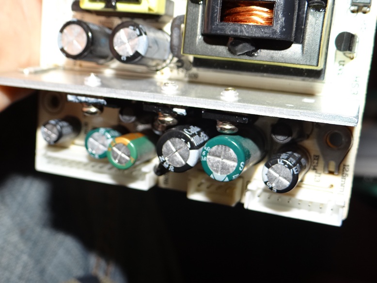

          Any ideas of the list of caps I need to replace and which ones.
          • jumpingjoeusa
            • Feb 2015
            • 11
            Sceptre TV X322BV-HD*XVNO5
            AY118P-4HF01 (REV 1)
            power supply

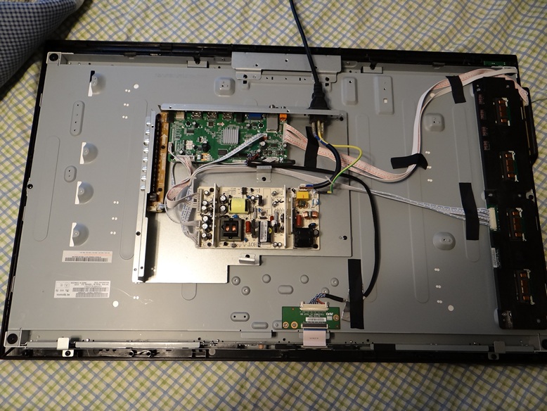

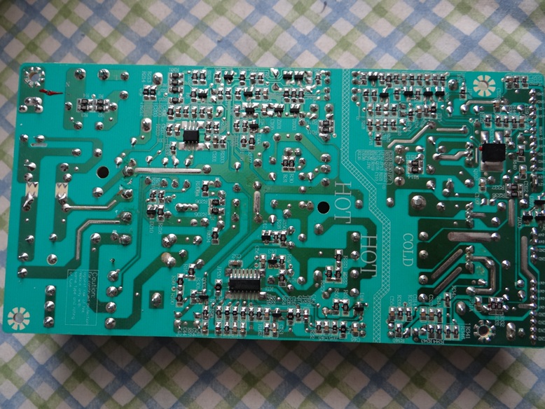

              read the stickies, first posts in the list, and throw up some good clear pics. of each board and one of all of m so people can see how theyr all connected.
                I am having some trouble getting the pics posted here and am going to a faster connection location.
                      Originally posted by jumpingjoeusa
                      Sorry I have never posted before it is true that there was a vage earlier post that did not provide thr information needed. Thanks for pointed out the other thread response and its true I need to test on dc not ac will post more in the next day or 2 as I am out of town. I hope the pics post ok as I am new to thumb nails also.
                      Thank you
                      "KM" caps seem to be the worst for being bad while not visibly bad!
                      Replace them on sight!
                          yep, recap is a good place to start, can't test caps accurately without esr meter, replace then you can at least move on with testing without having to wonder if theyr good or bad.

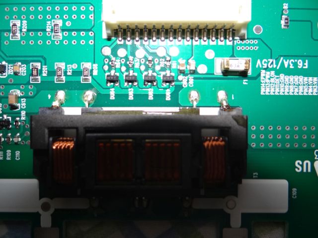

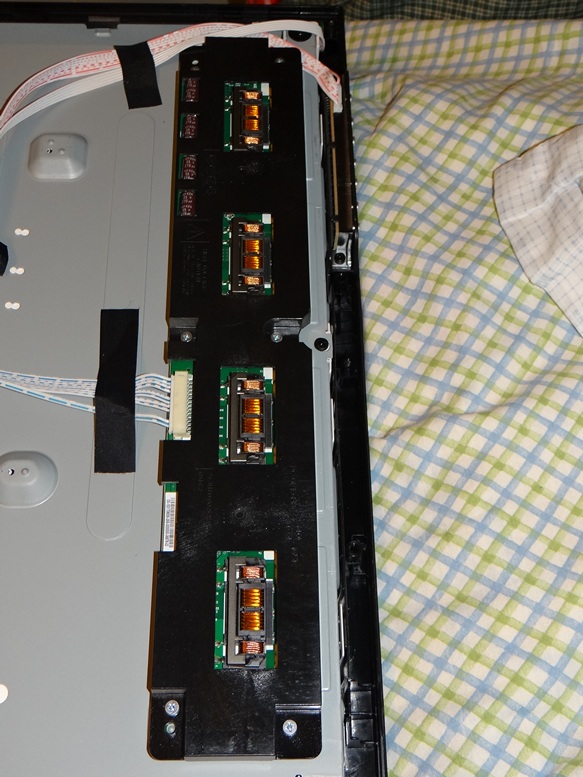

                            I think you need to give us the valid voltage readings first since what you have shown on post 4 are way off.
                            • jumpingjoeusa
                              • Feb 2015
                              • 11
                              Yes sorry about that. I have corrected that in a few posts up.
                                It better to post right in the page like you did on post 4.
                                The power supply is working from what I see in the spread sheet.

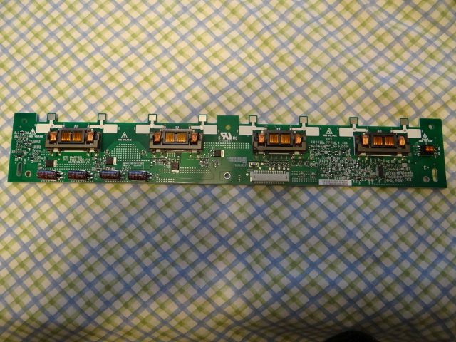

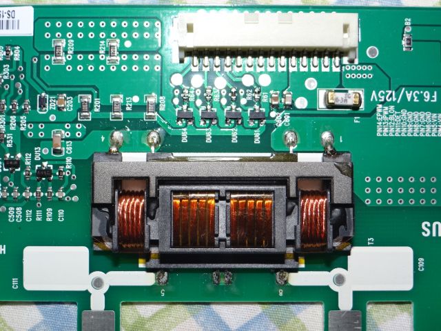

                                So you need to remove that black insulator sheet off the inverter board and give use good clear pictures of the inverter board, especially around the connector that goes back to the power supply board.
                                We need to see if it has any blown fuses on the inverter board.
                                • jumpingjoeusa
                                  • Feb 2015
                                  • 11
                                  I hope this what you requested.. This the inverter board. I thought this lit the screen. I have and still a little ill. Let me know if the pics are right

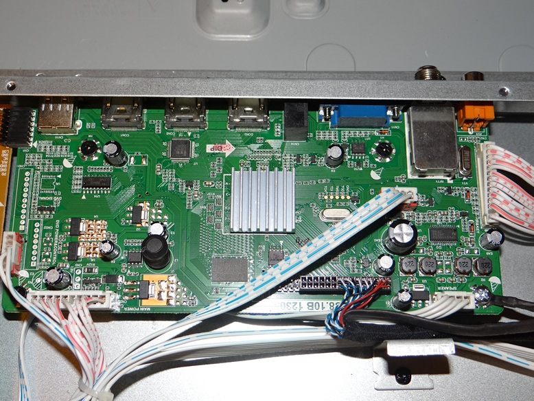

                                  • jackfishbay
                                    • Apr 2014
                                    • 12
                                    • canada
                                    go here https://www.badcaps.net/forum/showth...ght=blue+light
                                    same problem...its the chip

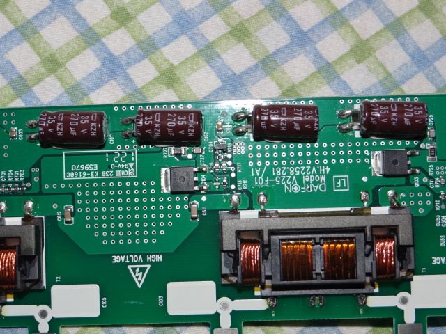

                                    • weinernation101
                                      • Oct 2015
                                      • 4
                                      • US

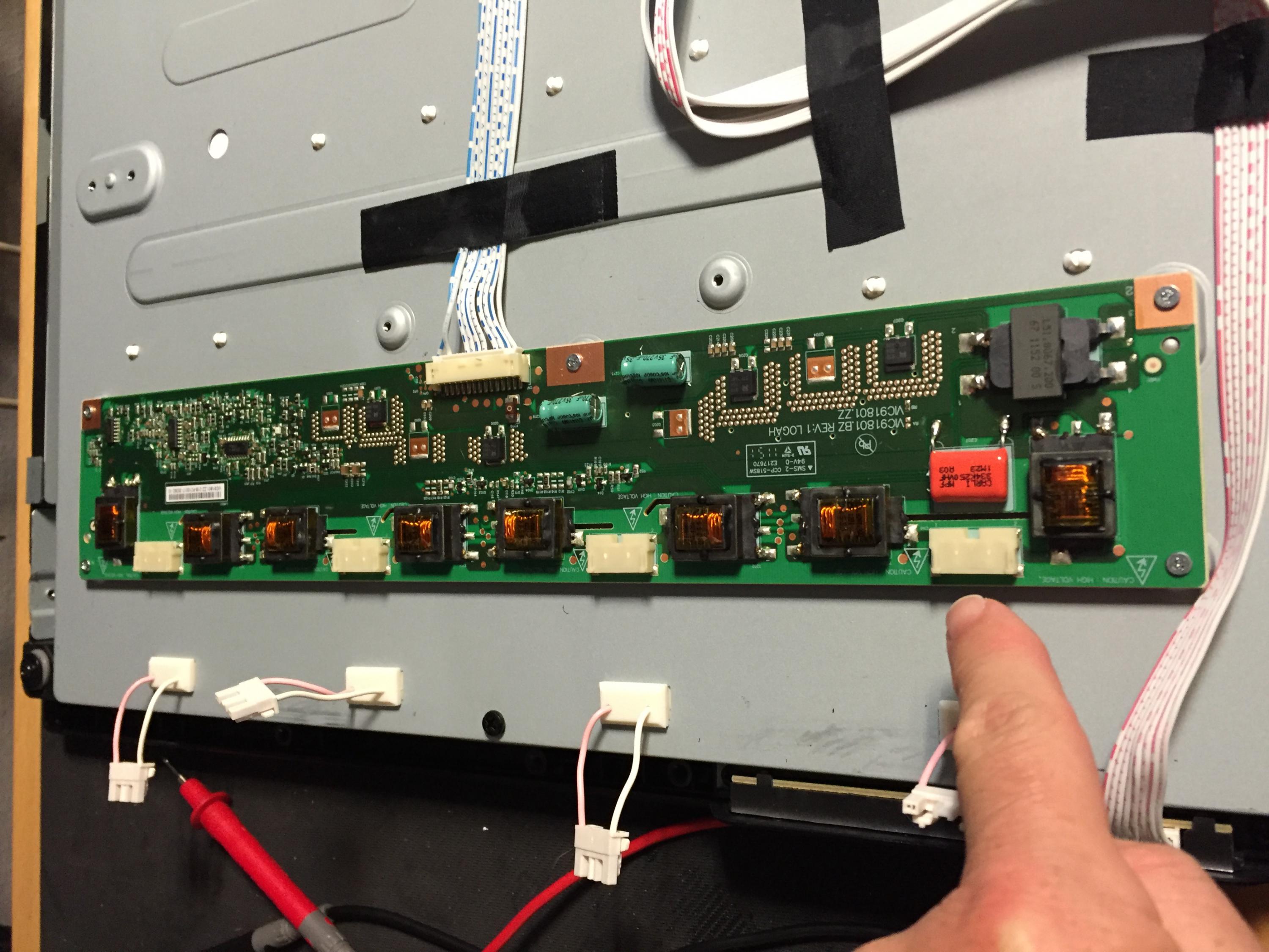

                                      My voltage reading coming out of the T.RSC8.10B 12305 board going into the TV BACKLIGHT INVERTER BOARD - VIC91801.BZ seems to be good. My question is "what should my voltage be coming out of the VIC91801.BZ board (see pictured) pink & white wires?
                                      • Agent24
                                        I see dead caps
                                        • Oct 2007
                                        • 5091
                                        • New Zealand
                                        Those are the lamp outputs - they probably run at least 1.5kV, with about 3kV start voltage! Unless you have a meter capable of measuring at least 5kV I wouldn't even try.
                                        The lamps themselves are the best way to test if the inverter is functioning.
