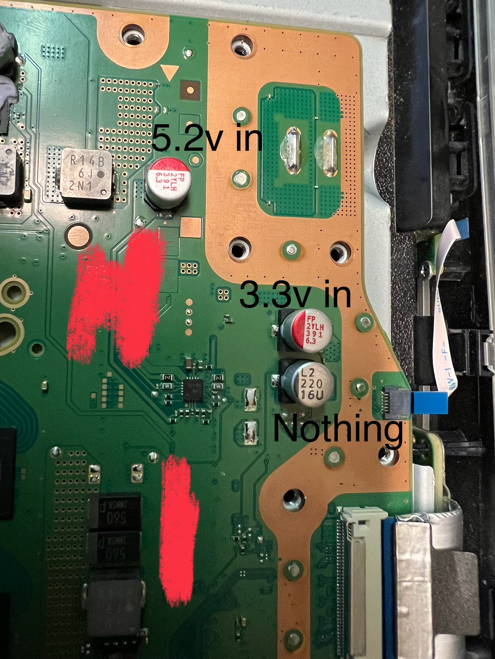

    PS5 EDM-033 Blue Light 2 Sec then Powers Off
    Hi, I am waiting for my uart tool so I can grab an error code and narrow down where my issue is, but I decided to measure capacitors and fuses to insure everything was okay.
    The PS5 turns on with a blue light and a beep for 1-2 seconds then turns off. I noticed a grey capacitor measures no voltage on standby or input power. Does this indicate a problem with the capacitor or something down on the line? I’m getting 3.3v on input with the red cap next to the grey one, and 5.2v on input with the red cap further away from the grey cap.
    Thank you for any input on this, I just have a multimeter right now but appreciate any insight.
  • LaPCon_IT
    • Sep 2022
    • 80
    • Malta
    Did you check HDMI port and encoder IC?
