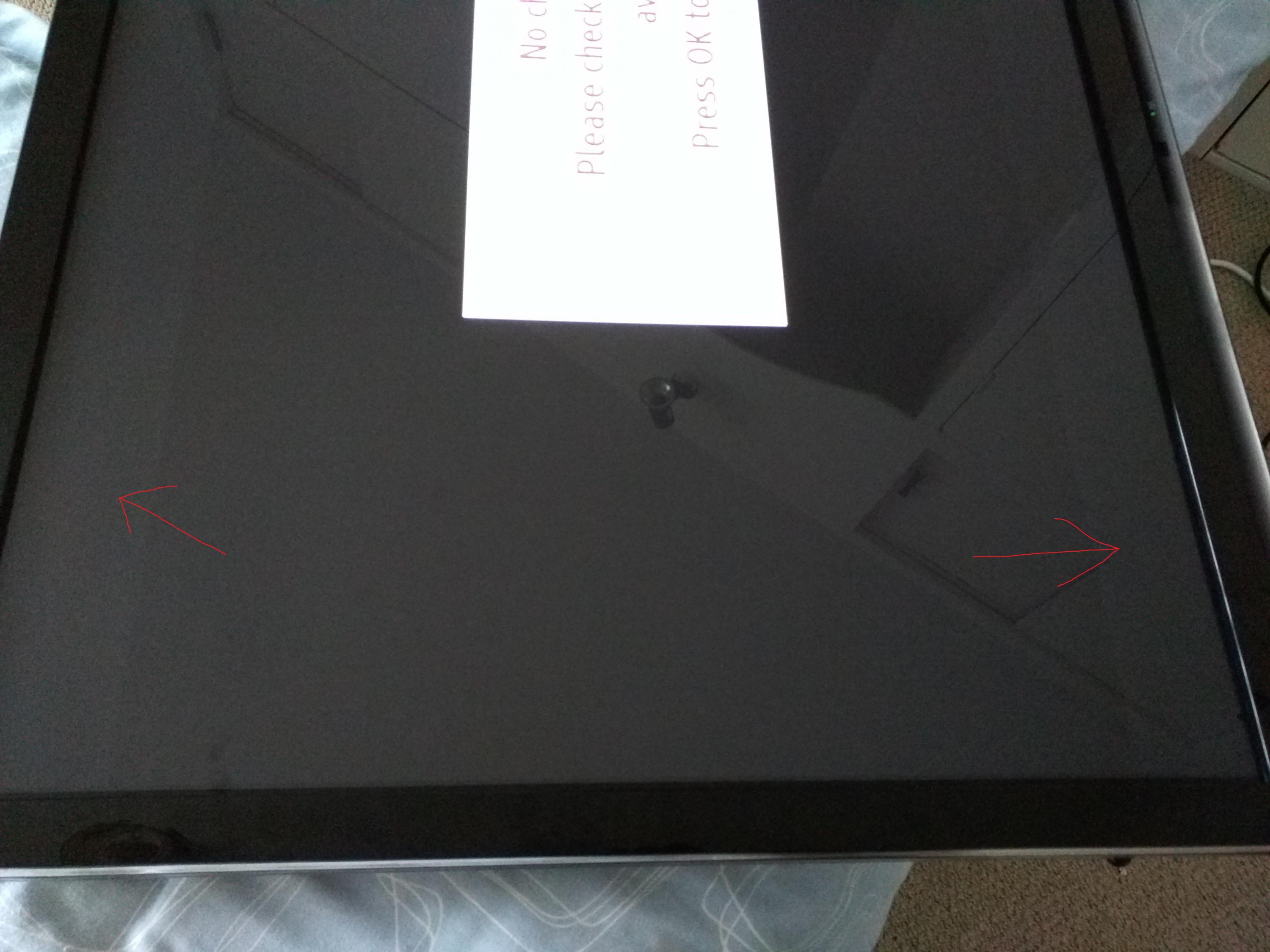

    hi all
    I finally managed to fix this Panasonic plasma , in the end A board was shorted and keep burning PSU, after two 2 PSS boards and one A board, i managed to start TV.
    before I connected new A board and PSS Board , I checked also SN board and C1 and C2 boards, i disconnected all ribbons, after visual check I connected back, tv started normal, I had few horizontal black lines but I reseated all ribbons cables and black lines are gone but something else is there - two thick (brighter than rest of screen) horizontal lines on top and on the bottom, please see picture attached.
    anyone knows what's going on, is there setting to be changed in service mode after changing A board ???

    Re: Panasonic Plasma TX-P50XT50B strange horizontal two lines
    have you run a picture through it yet? looks like after image, i think if you use the Tv normally the picture will be fine or go into serv menu and use aging to generate test patterns like full white or scrolling white bar.
    A board blowing the PSS, that's interesting.
      I connected laptop through HDMI and if you look very carefully you can see different colours in this part of screen, but from close distance.
      I went through two PSS boards and I just recalled what tom66 said in other thread that A board can cause problem so I decided to buy A board , but once I connected new A board the old PSS didn't work anymore , bought another one and TV started
        Yep looks like burn-in likely from improper aspect ratio setting.
              Originally posted by Damtom
              @mmartell I tried different aspect ratio .
              That is not what I mean. The previous owner (whom I assume is not you?) looks to have watched program material with black bars at the top and bottom of the screen for an extended period of time causing what you are seeing now. You can only hope it is retention which will go away eventually because burn will not.
                @mmartell so screen itself ??
                Another picture attached

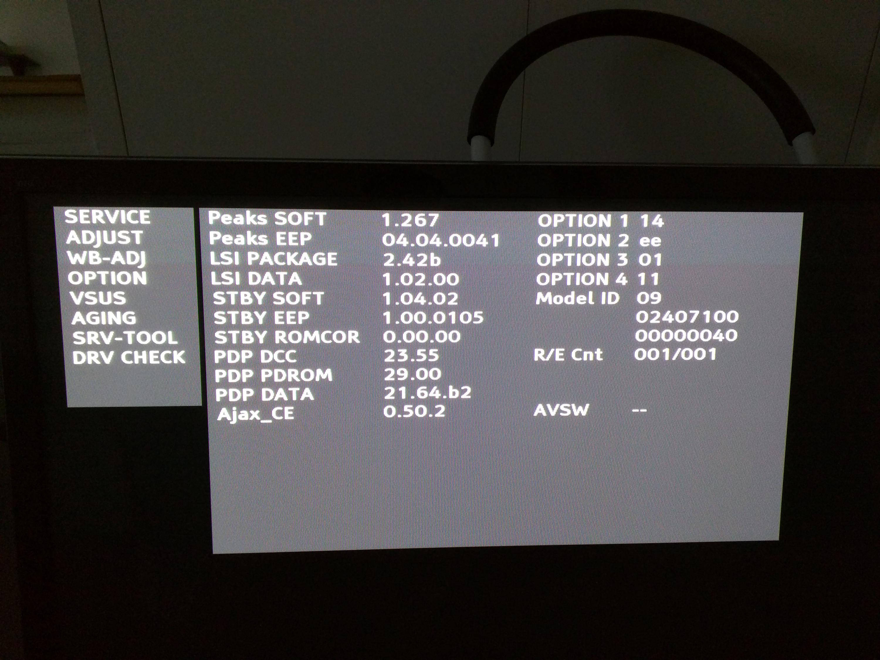

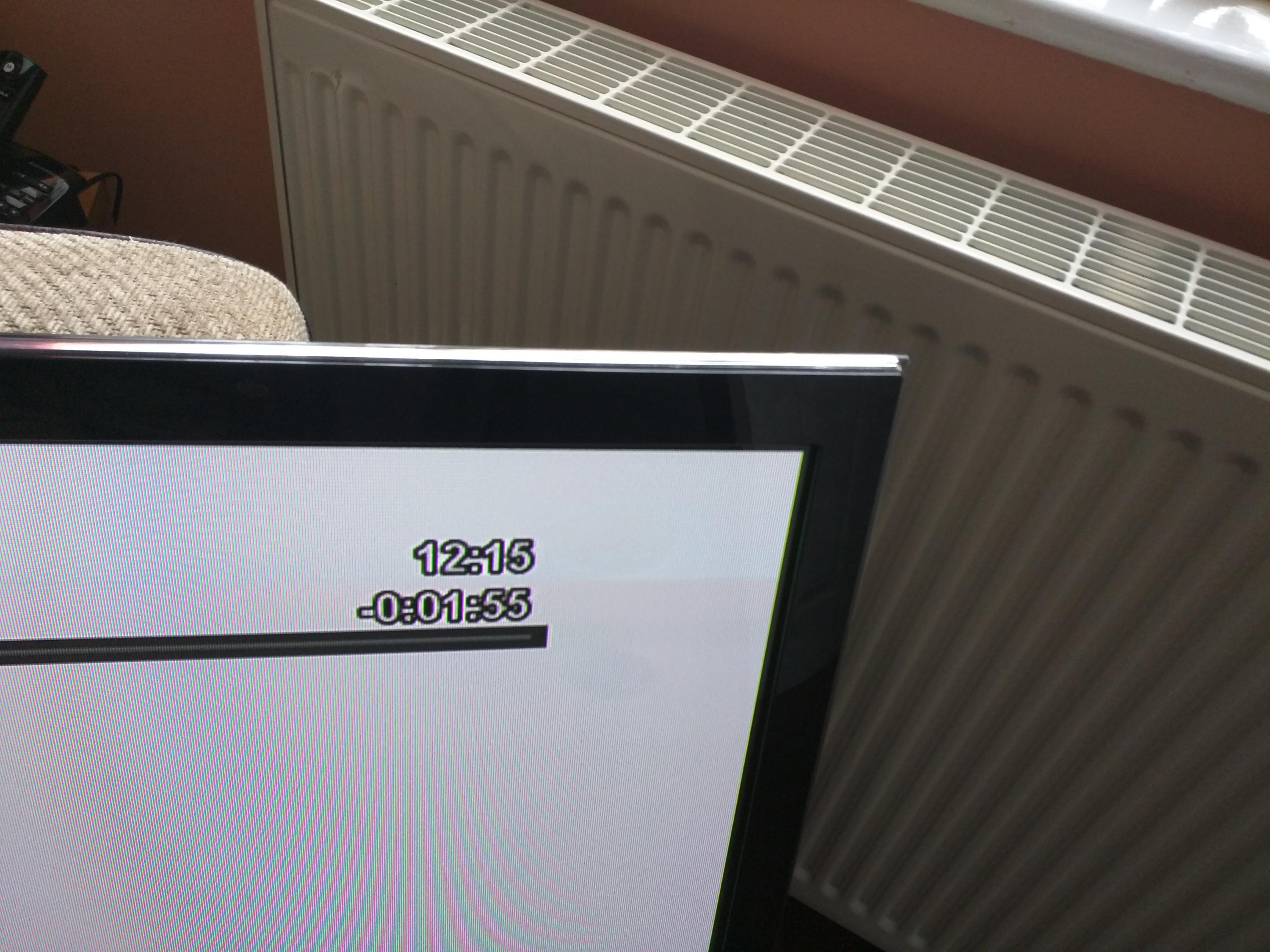

                            • Damtom
                              • Dec 2014
                              • 57
                              If I put white screen on whole screen I can see TV stations logos.
                              This TV hasn't been used for 3 months, so can we honestly say this is not image retention but a burn-in ???

                                it would be interesting to go into serv mode, then serv tool and bring up hrs on use for the TV. It may have been used commercially on the one channel 24/7?
                                  Retention usually only fades when the set is in use, when off it does not fade. I had my Kuro off for over 2 months and it had IR from Windows desktop, the Kuros are pretty good for IR so it faded within a few minutes use.
                                  As for your fault, TBH it looks more like burn in but I'd run it for a few days and see. Sometimes increasing Vsus will hide burn in artefacts.
                                    This TV was used by my friends. Which option in service menu state used time ??
                                    • tw2005
                                      • Oct 2011
                                      • 6458
                                      press 1 to scrool through until srv-tool comes up, hit ok to enter , then use arrows to highlight bottom right box opposite to ptct , then hold mute button on remote until it populates info

                                        just realised, you've replaced the A board, so all we'll see is whatever the TV it came out of
