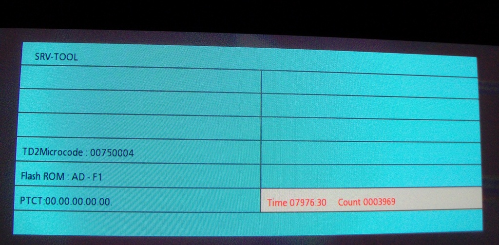

                              I have this screen but no time and count on it

                                Re: Panasonic Plasma TX-P50XT50B strange horizontal two lines
                                then have you tried using up,down,left ,right arrows to highlight that field and hold mute?

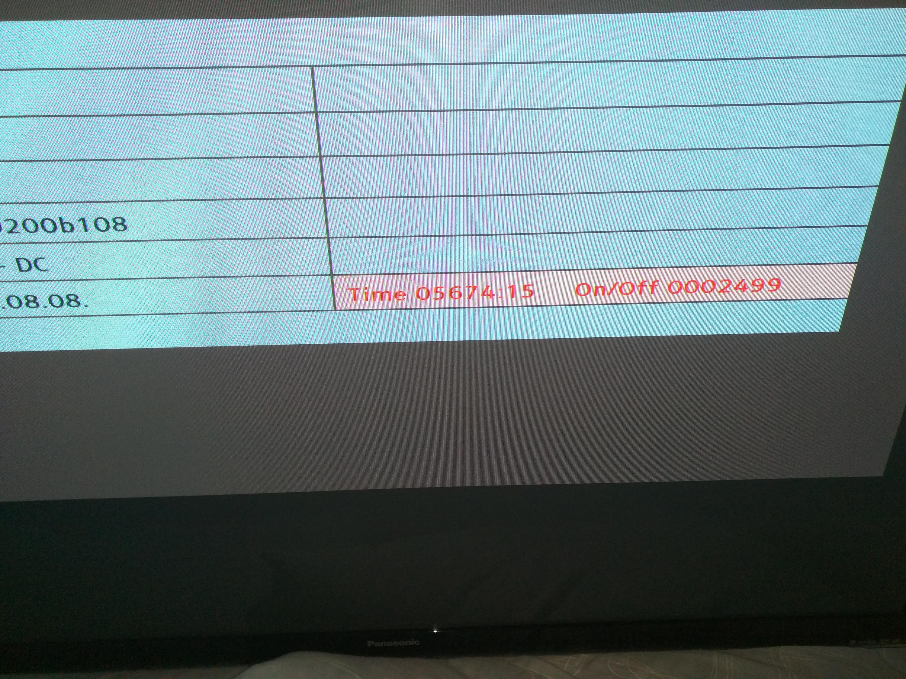

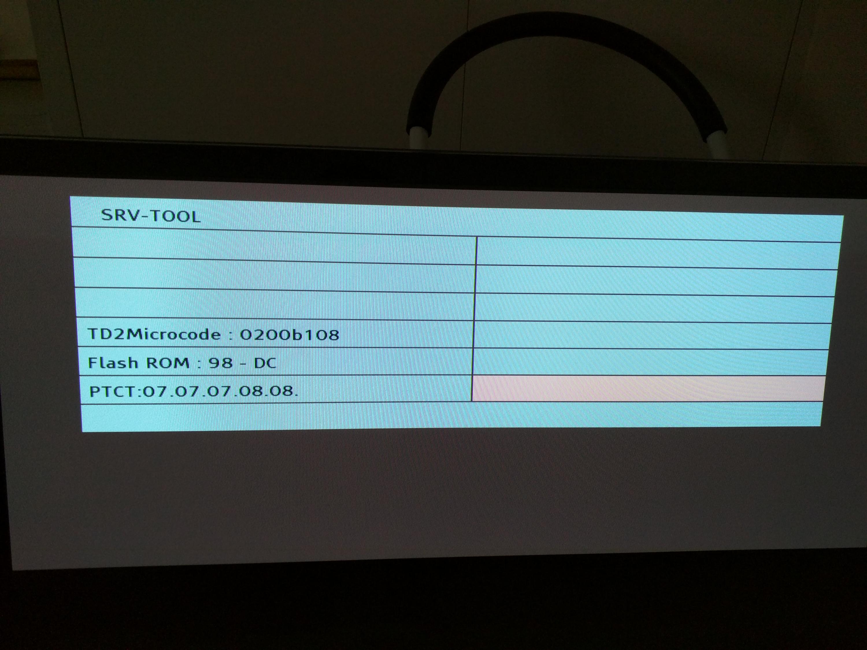

                                    Mute doesn't work , any other ideas ?
                                      #38
                                      no, without the exact manual. everything i've read it's mute but maybe it's different on this one or this region. usually just hold mute for more than 3 secs and it populates,
