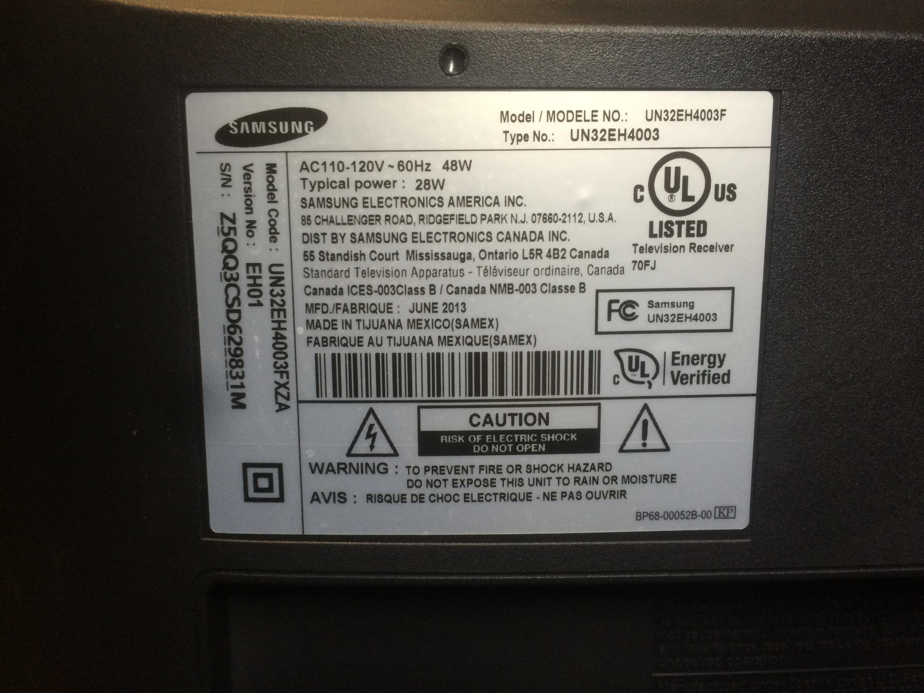

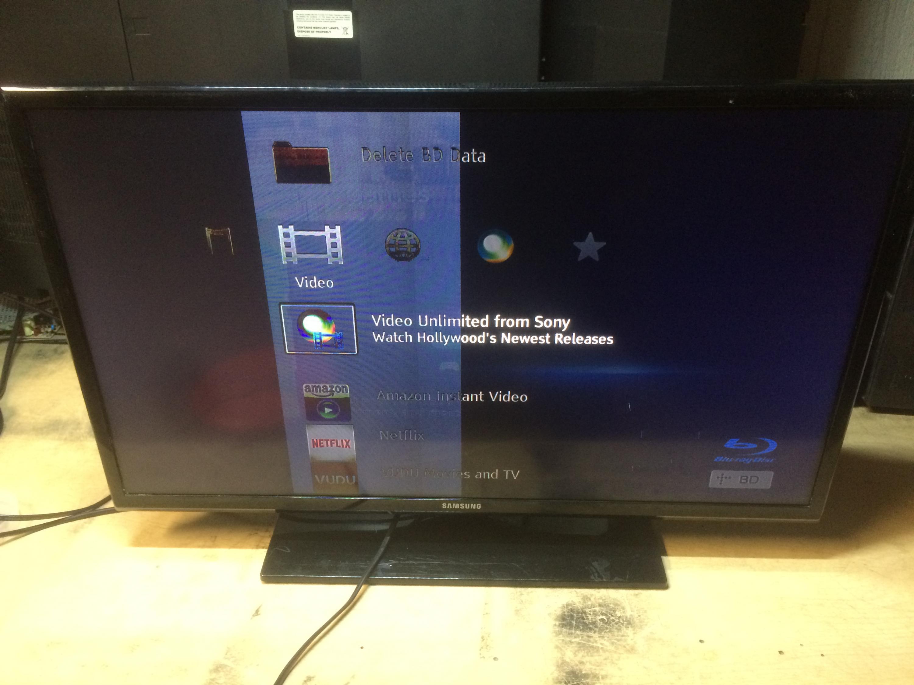

Not sure how to explain this so I uploaded pictures. Can anyone help? What could the issue be?
Samsung UN32EH4003F Video Issue. Please help.
Re: Samsung UN32EH4003F Video Issue. Please help.
need more info. on symptoms, can't tell from those pics. -

hard to tell, I see the model number, but who knows what it is ummmm led, lcd, plasma???????????Comment

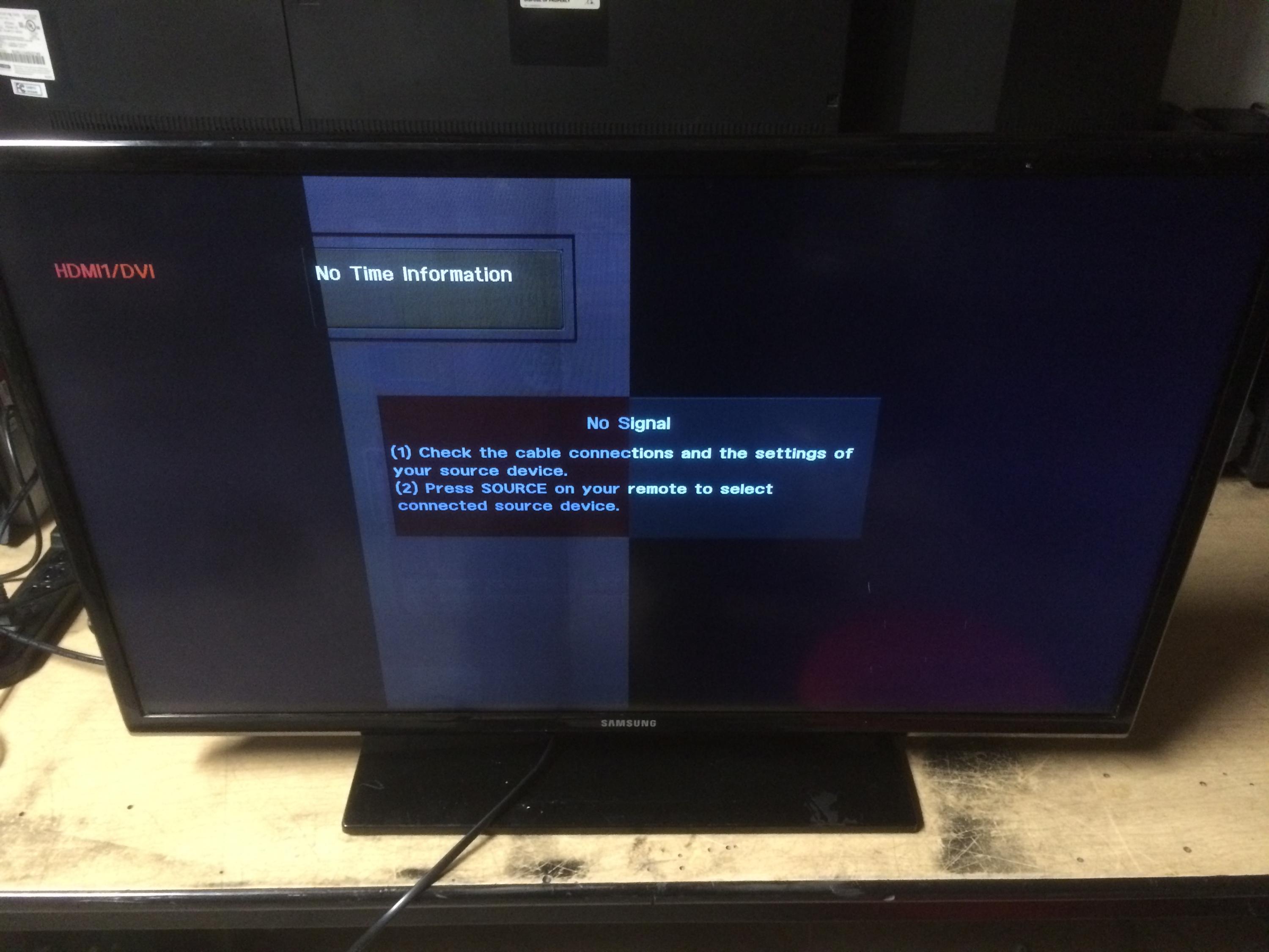

Here is another picture with out the DVD player on. The issue is of course the center line or some what center. You can see it run up an down. The TV is an LED

UPDATE: The TV does not have that discolored line in it when I unplug the main board. It lights up good and even all the way across the screen. Should I assume that the Main board is bad instead of the panel itself?Comment
not sure, heres a question, can you check these led panels by twisting the panel like the lcd panels?, if so could try that and see if anything changes on display, with all boards hooked up.Comment
