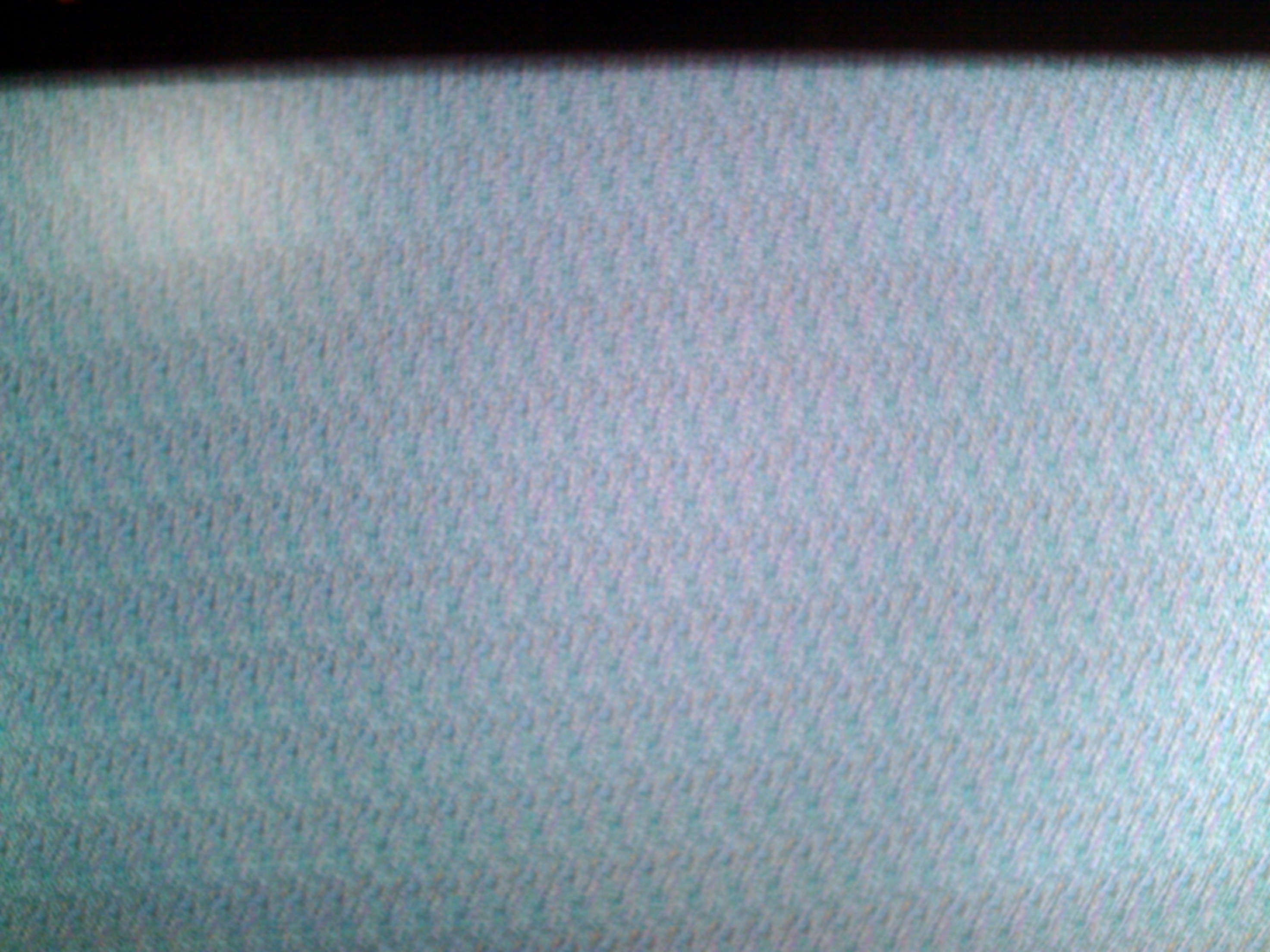

        thanks CapLeaker, when I click source the snow changes a little, it makes me think it's responding to the remote, but the snow is so dense, can't make out any image that might be there.

          there shouldn't be any snow on the AV or HDMI. Can you upload a pic?

            ok I'll put up pic, its snow, I cant tell what the source is because of the heavy snow, but the snow changes a little, with remote clicks, its snow on everything I try with remote or panel buttons.

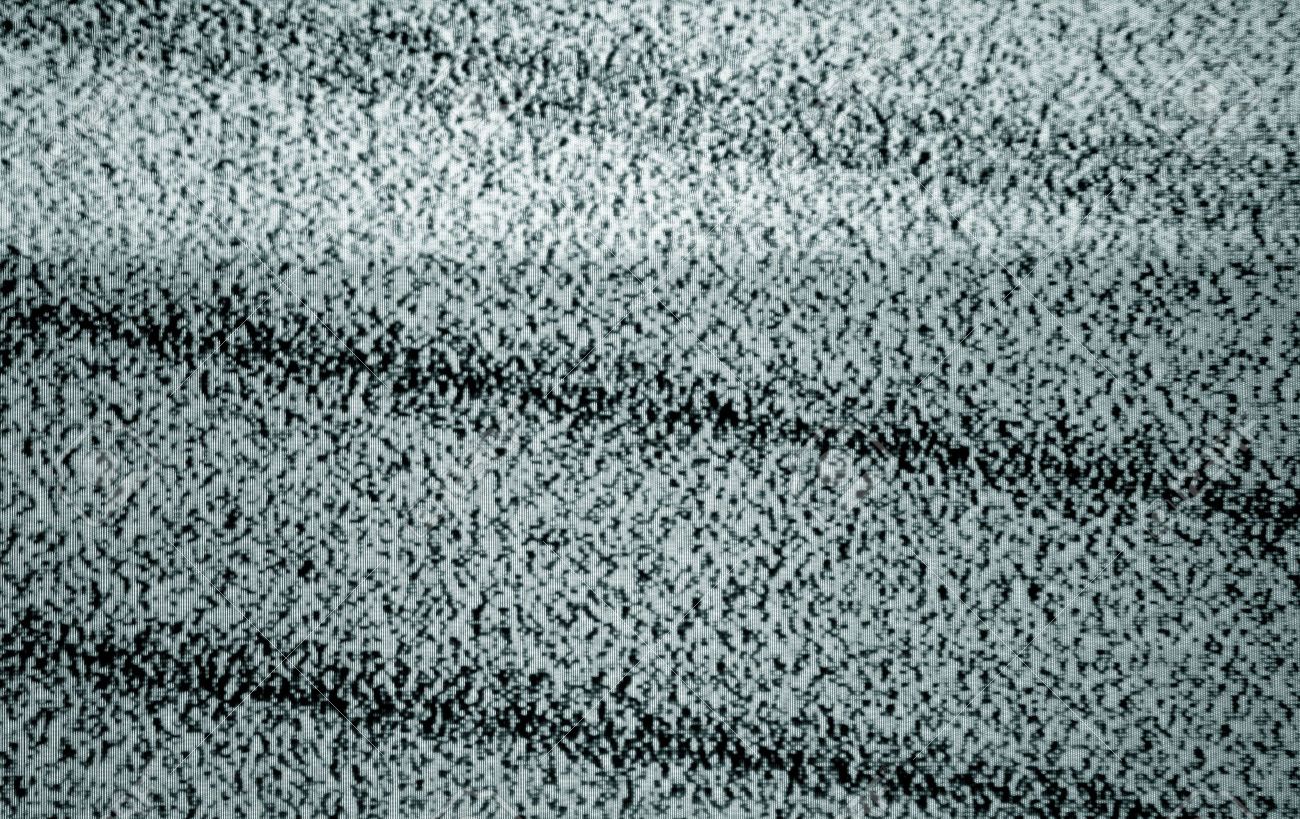

              snow is usually the rf input.

                Re: odd IC test reading, have 8 ics on bottom and 3 on top of board all give odd read

                    rf is the tuner where the coax goes on to. Analog produced snow and that is what I thought you meant. Anyway... your pics show some weird combo of snow and it looks like the OSD is trying to display something, but it can't. If you have a oscilloscope, you could check all these little caps for DC ripple. Little ripple who cares, but big ripple creates a problem. If that doesn't yield nothing I would point at that big main chip first or a different IC between it and the LVDS output. But just changing IC's isn't efficient, if you haven't got clean power coming from the SMD caps. Didn't I see a new board for $20 at SJ?

                        That isn't rf snow. 2nd attached pic is an example of rf snow.
