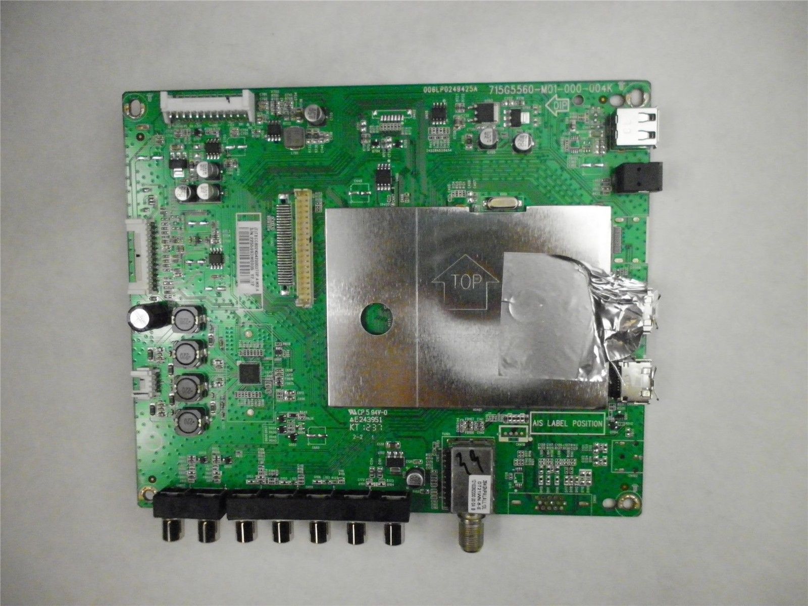

    I have this Vizio 39" lcd , When the power button is pressed the power led lights but thats about it, looks like the eeprom could be corrupt. Power supply is working fine.
    The main board is a 705TXCSM046 It uses a Winbond 25Q64FVSIG eeprom.
    Does anyone have a copy of this eeprom?
    and has anyone used a MX25L6406E as a replacement/Sub, It looks like it should work.

      It was the flash that was bad, programming and replacing it repaired the tv.

            First I tried programming a chip from a different model vizio_e371e I found here, and as expected it did'nt work, would not even turn on the power led. I then read the original chip, and programmed a new one, installed it and the tv worked, so maybe having the different model chip installed did something or maybe the original chip had a problem. I don't know. Everything seems to be working fine now, but I know these Vizios can act wierd sometimes.
            I know one other thing and that is after programing the new flash, installing it in the tv, removing it and reading it, there is a slight difference in the 2 files, so the tv does write to part of it, I believe most of the tv settings are stored in the other eeprom (u408) on the board
