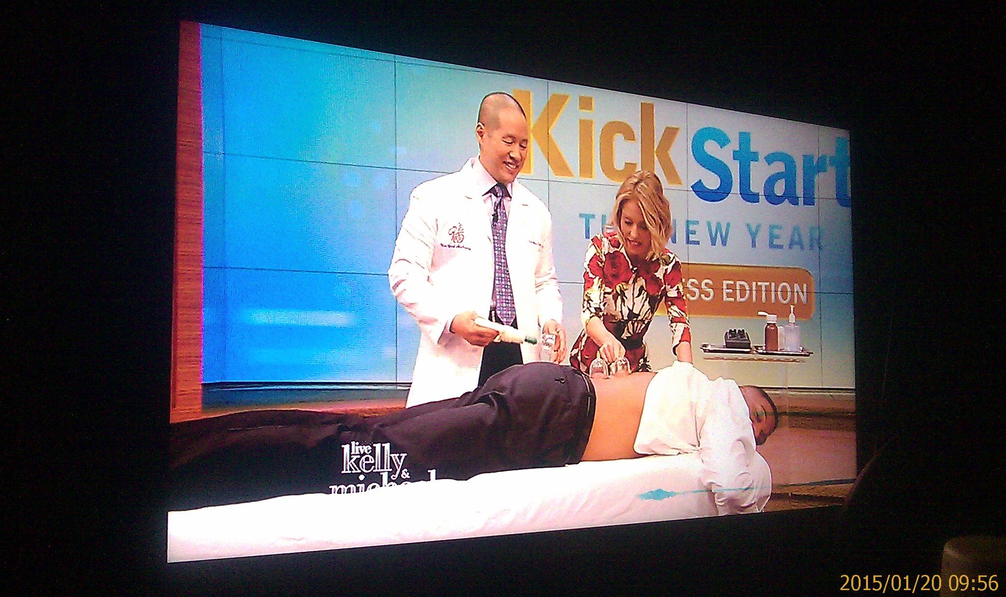

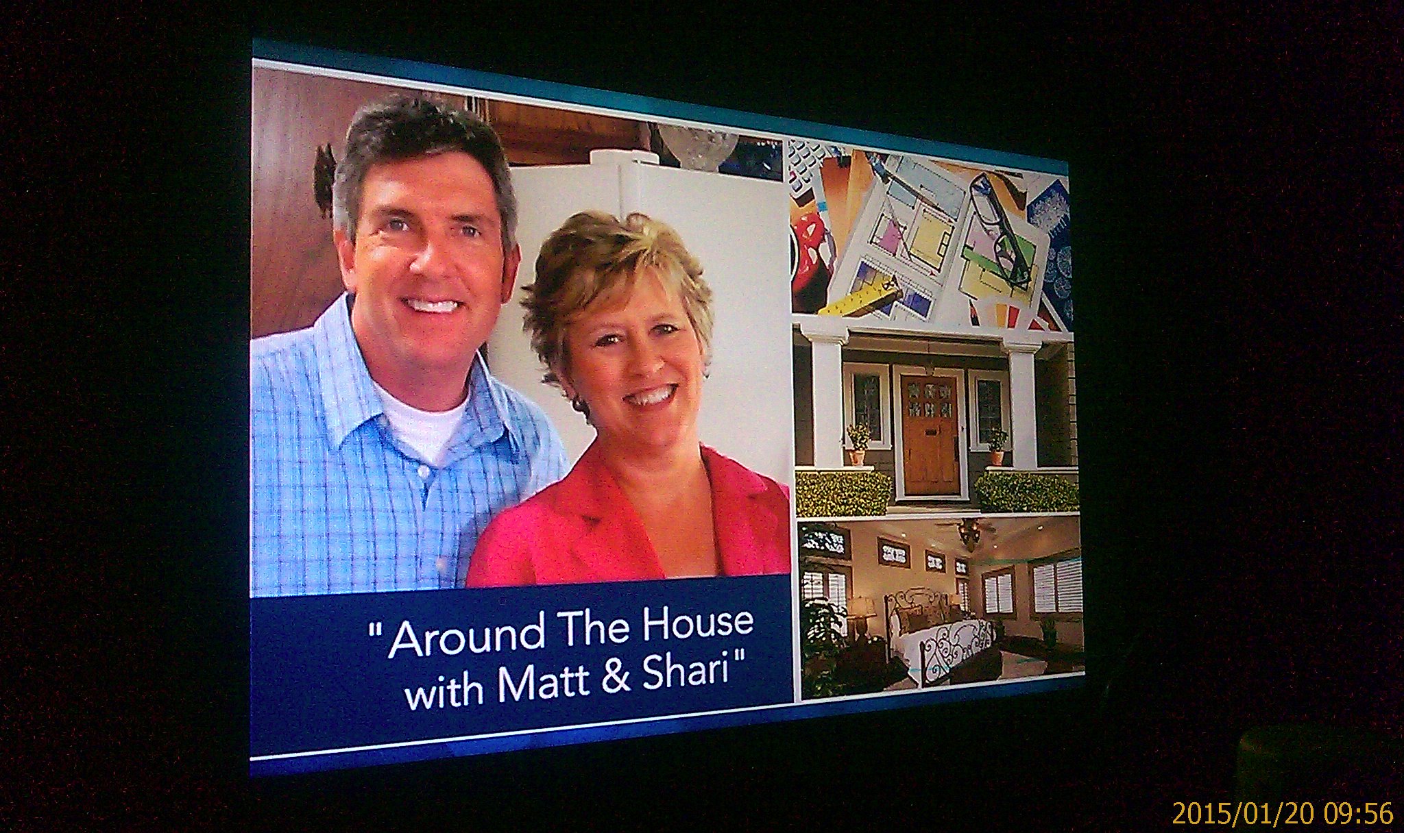

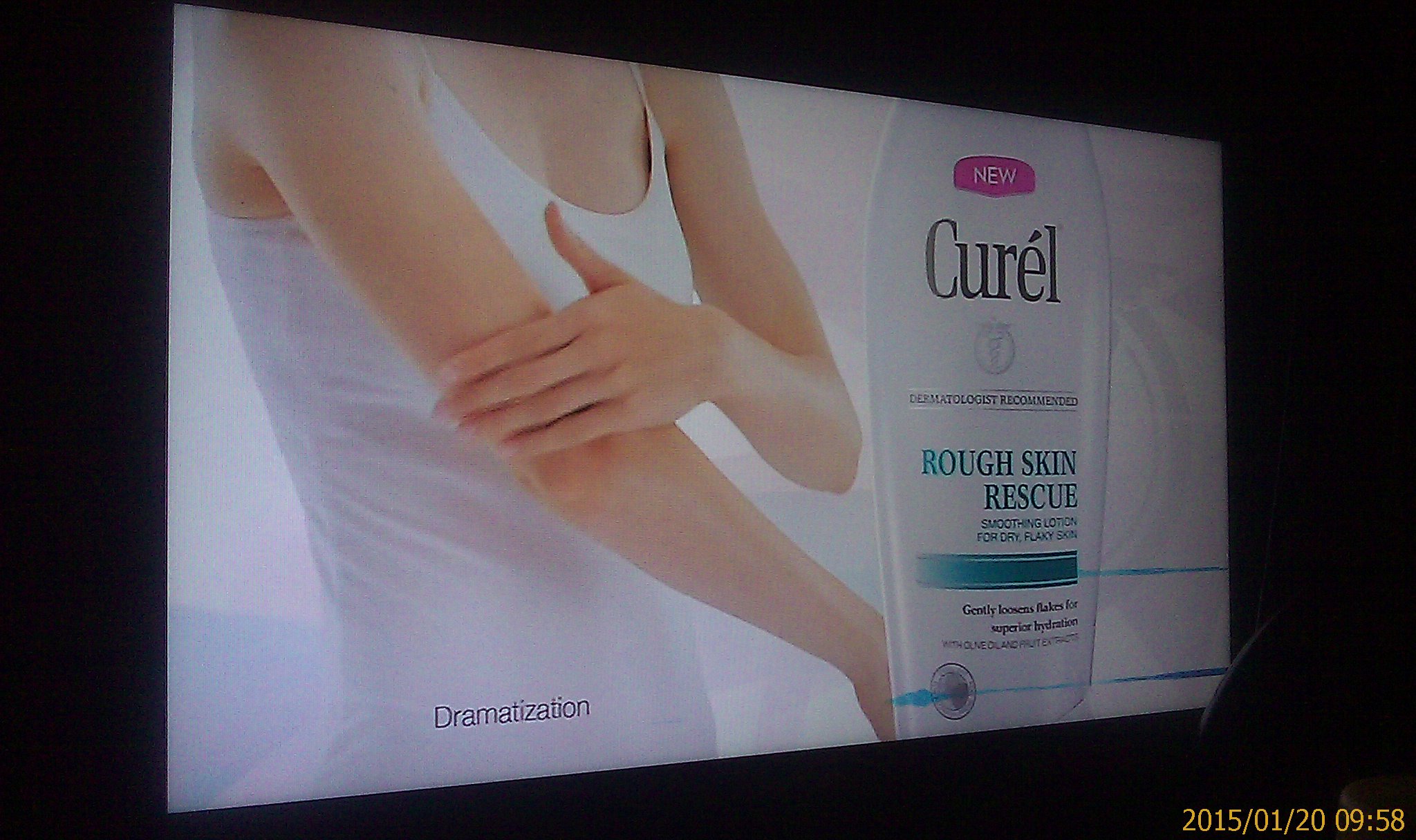

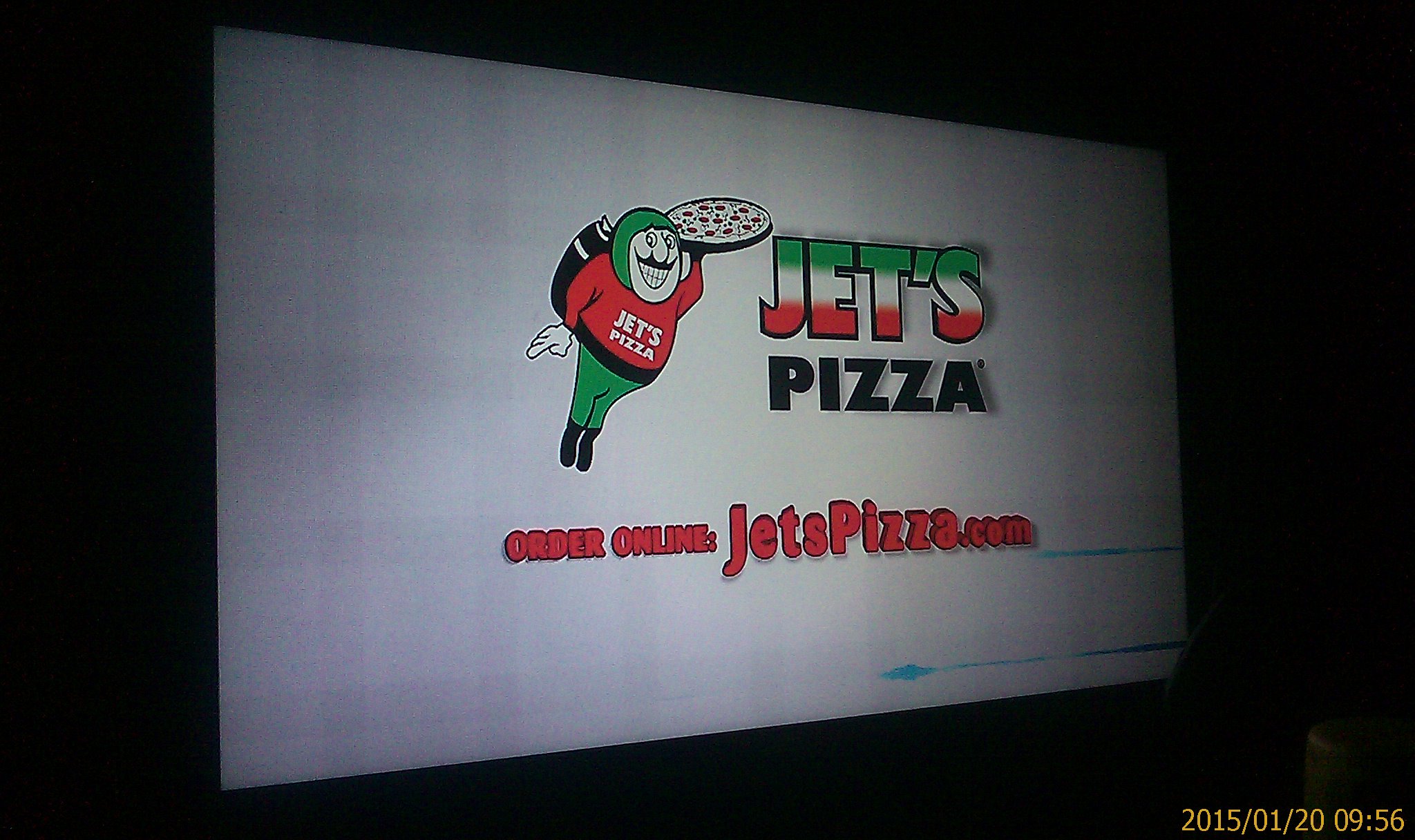

          hey budm i do have one more question about my samsung tv...its not a big deal to me but the display seems to have a glitch in it.....doesnt bother me but see photos..you can see blue colored blotches that are permanent and on the screen all the time.....when watching tv i really dont notice them much..only on white or light scenes.....see photos......any ideas what this is??
          i have never seen it before

                                  no the blue blotches were not gone after i fixed the backlight issue as the blotches seems to be lcd panel issue.....so i guess even though the tv is scrap now ..it would have been hard to sell with the blotches...its prob worth more in parts now as all the boards work great.........
