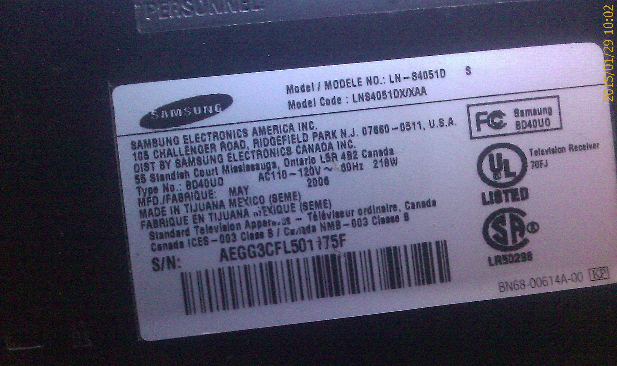

    Model lns4051dx/xaa

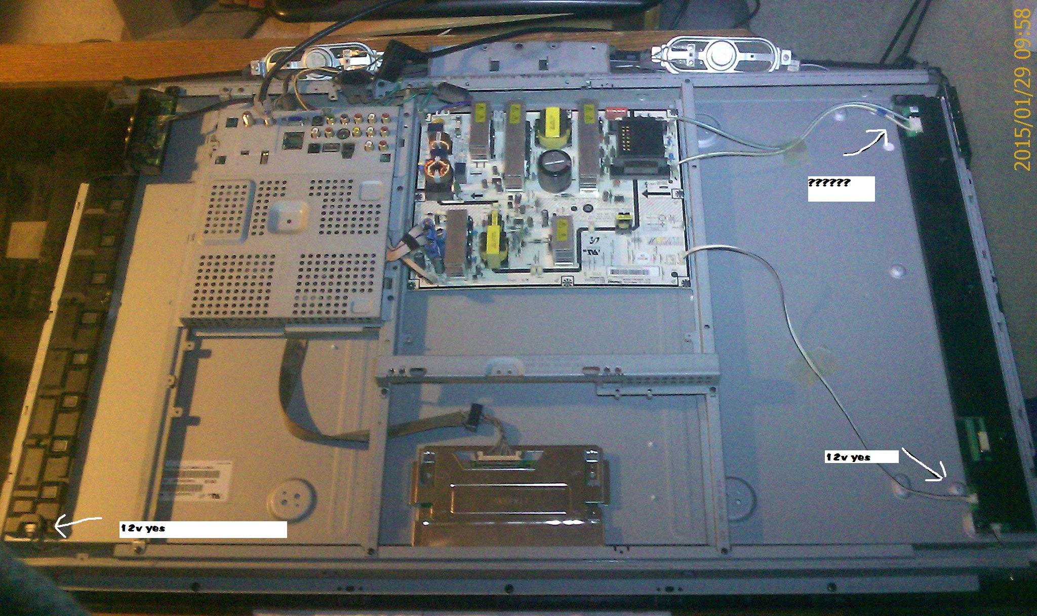

    I have tested the output voltages on the cables from ps and they all check good...there seems to be 2 inverter boards and i get 12v going to both from the lower power cable....but there is a transformer with 2 wires going to top of i assume the master inverter and not sure how to check for voltages there...nothing marked...one wire is blue and one is white....its marked with ????? On photo
    any ideas what the problem could be? Inverter bad? Backlight bad?..if it is a bad inverter how can i tell if its master or slave inverter..

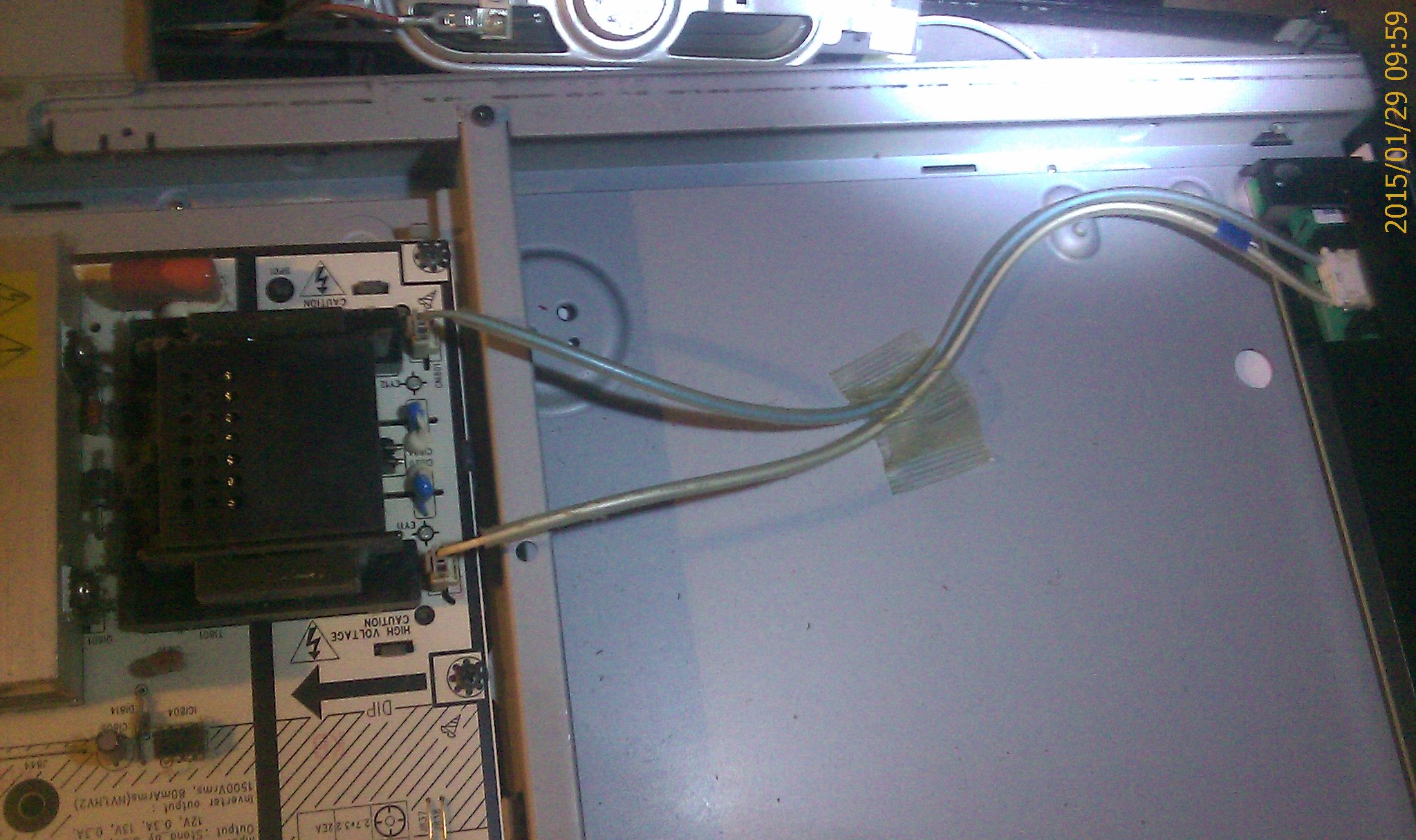

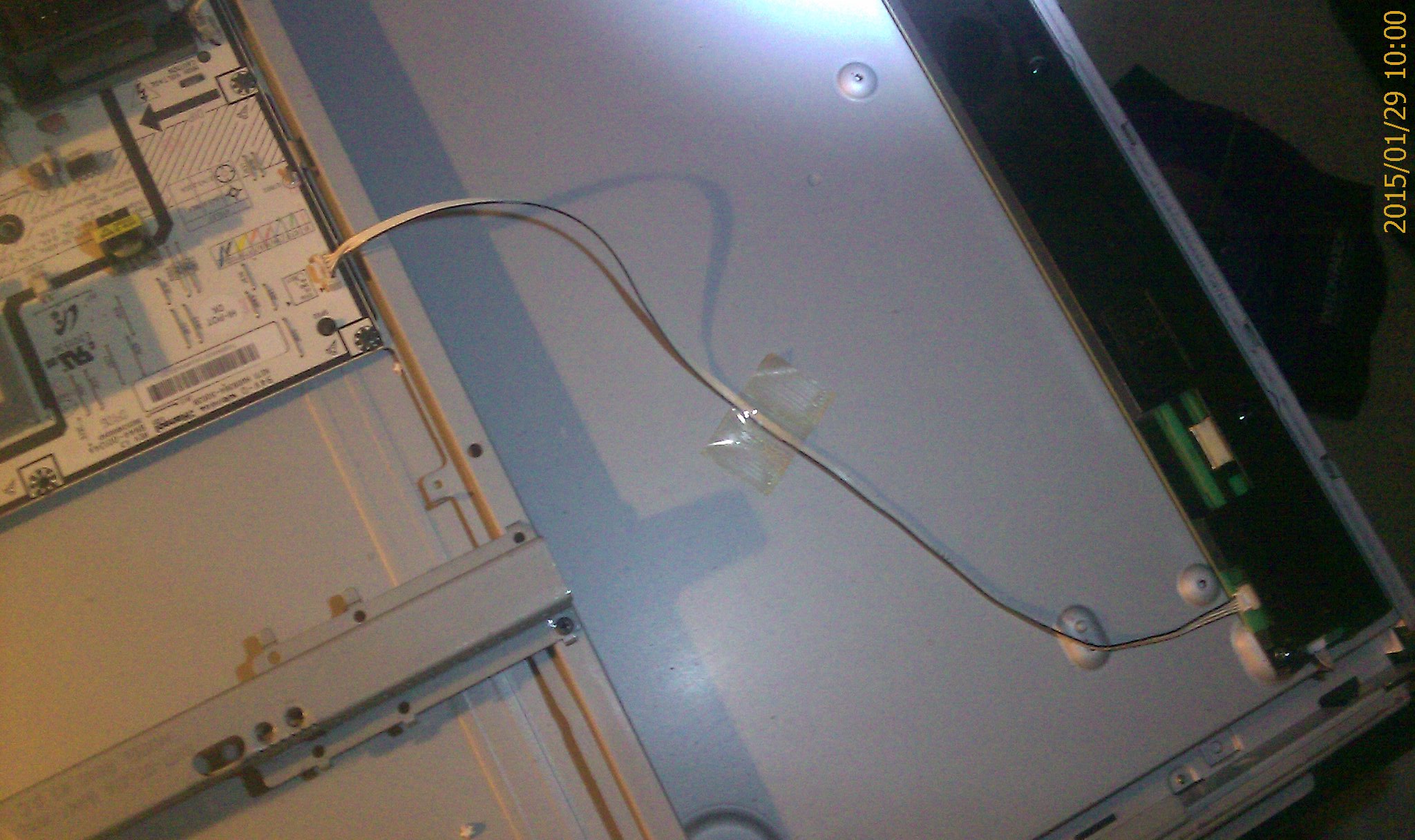

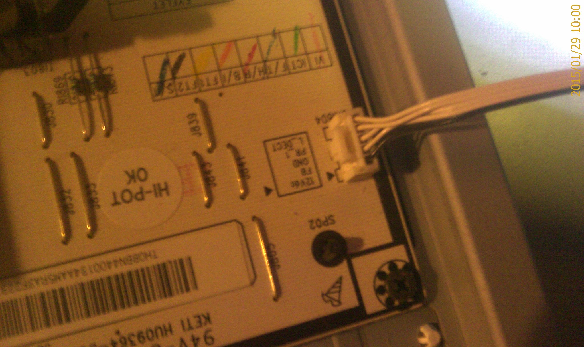

    Here are photos

      forgot to mention when the backlight does go off i get good voltages coming from ps.....just not sure how to check the blue and white wires from what appears to be a transformer on ps to master inverter.........

          Re: Samsung 40inch lcd tv backlight goes off sound good
          yes.....but shouldnt i be able to test the output power via the blue white wires coming out of transformer going to master inverter?
              nope there is nothing on the board at all...just the blue and white wire coming out from trans going to master inverter.....
                ok well maybe someone can answer this..what is the purpose of two power lines going to inverter...the 12v on bottom and the wires coming from trans on top?
                      see the other wire going to the inverter? it should say 12 v on legend, you can check that.
                          yes if you read my post and look at my pic it says i got 12v from that cable
                              i get good voltages on all wires from power supply other than not checking the wires coming from large transformer

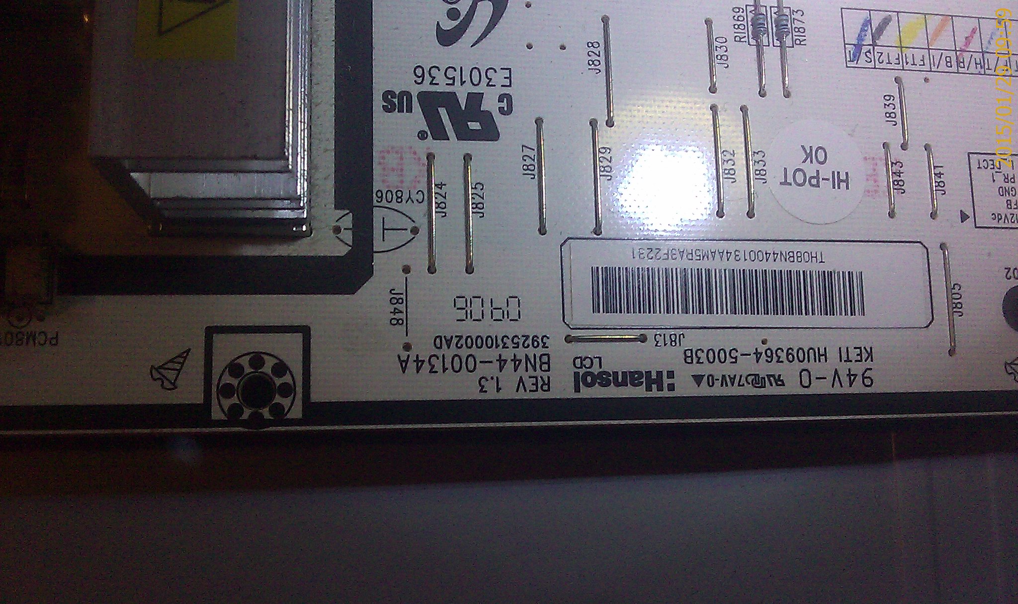

                                Those two long boards connected to the lamps are the Balancer boards, the 12V is normal, bad< = 10VDC.
                                Try disconnecting the cable between the main board and the power supply/inverter board combo and see if the backlights will come on and stays on the minute you plug the power cord into the outets.
                                Do not touch or try to measure the high voltage from the power supply/inverter board high voltage out put or you will blow up your meter.
                                What is the P/N of that power supply/inverter board? BN44-??????
                                    mine is bn44-00134a.

                                        the pn is in one of my photos.posted ill check now..
