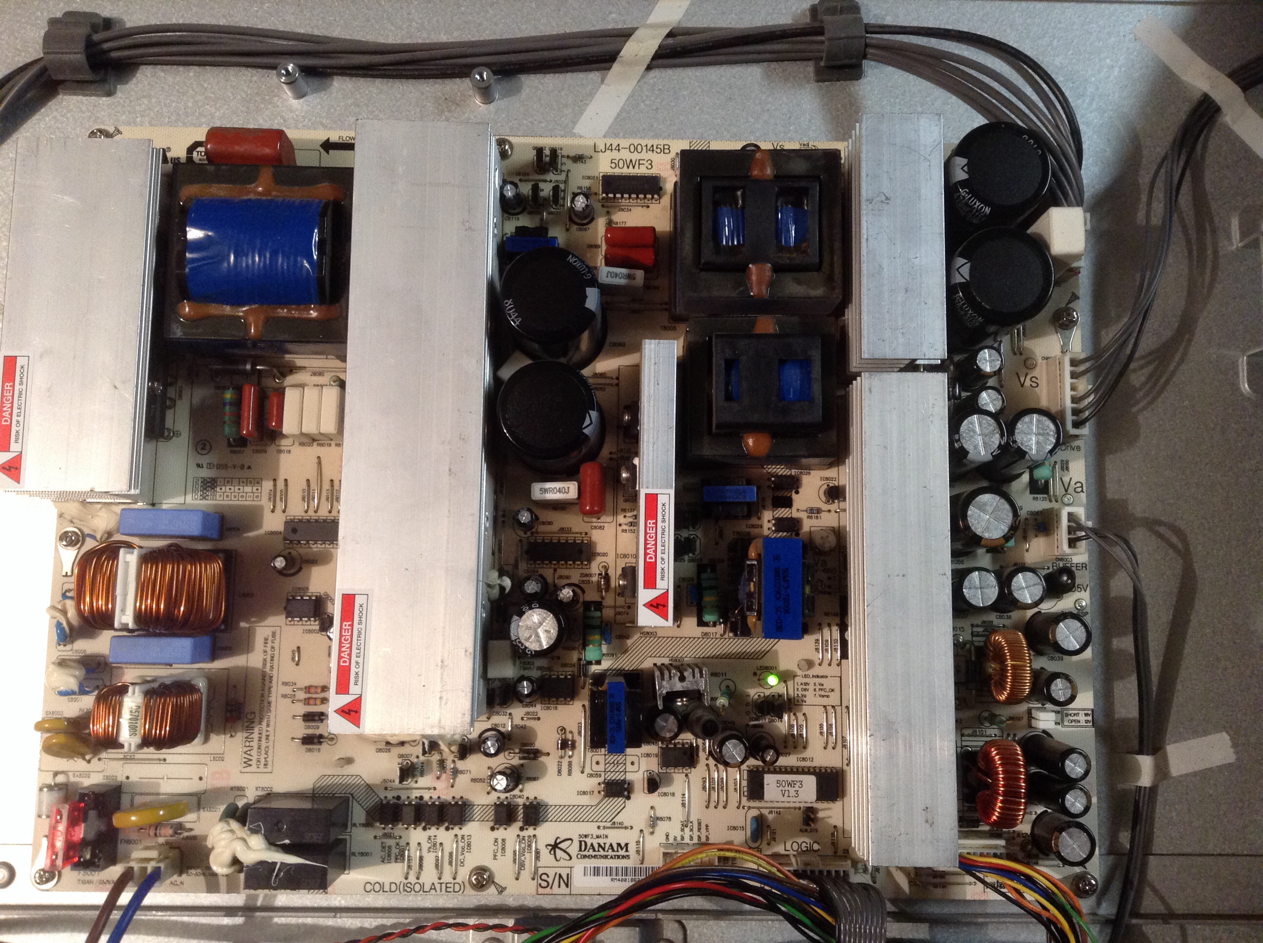

    I have the above listed TV and it is blowing the fuse that is right next to the power coming in on the power board. There are 12 47uf 50v capacitors that are bulging. I suspect that is the problem but I am new at this and don't want to put power to the board after I replace them and destroy the work I have put into it. Is there something else I can do. Thanks Mark

              I replaced the 12 caps and plugged it into a dim bulb tester and the power relay kept clicking on and off (bulb blinked with the relay). I had a 40 watt bulb on it. I unpluged the connectors from the power board and the one that made the relay stop clicking was the bord that has the a/v hook-ups. There is still no dc voltage. But has AC throughout the hot side. Something is shorted I'm assuming that's why the bulb was blinking. The board P/N is. LJ44-00145B. 50WF3. I'm working on pics. Thanks Mark

                  https://www.badcaps.net/forum/attach...1&d=1422928351
                  Pic of power supply

                    Re: Insignia NS PDP50HD 09 blowing fuse
                    Originally posted by Rotorcraft230
                    If I plug I the power board out if the tv it turns on. But has no voltage on the dc side. Can I assume it may be associated with the standby circut?
                    Huh? Whuuuuuuuuuuuuuuuuut?
                    There is a dead short on the primary side with fuse blown. Nothing will work on the secondary's as long as the primary has a short. So... you got to the bridge rectifiers and checked them. So check the rest in the primary for shorts.
                    If you lets say just change the bridge rectifier and "missed" a shorted mosfet, the whole thing will blow again.
