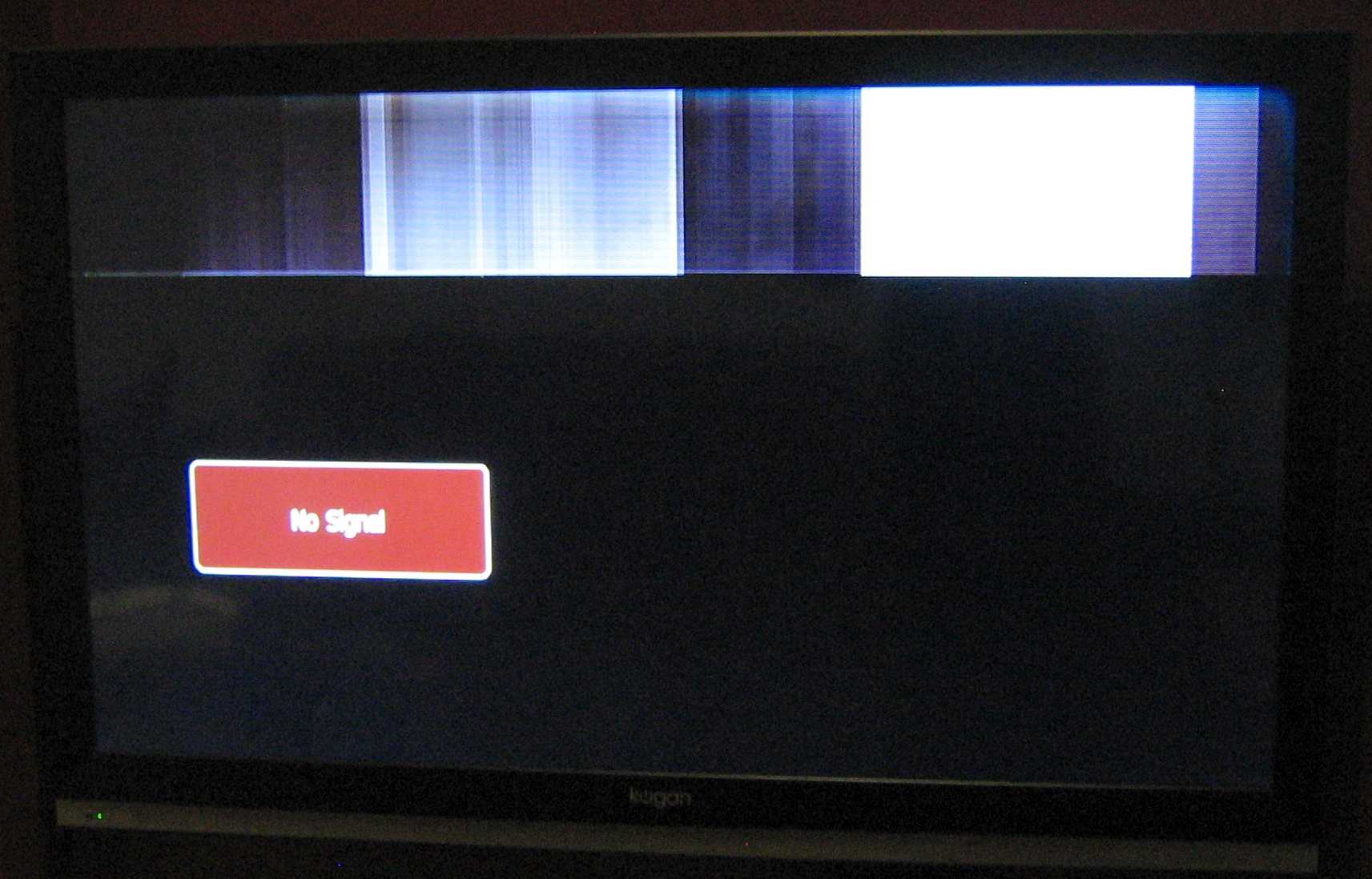

    Kogan KALED463D1ZA
    TV is about 18 months old and is actually my own! Curses!
    Last night it began to throw up the attached distortion on any video image. What look like white raster lines. There's also other artifacts in the white bar that gets overlaid on top of the regular image (which on program material is still quite visible). For example the floating 'No signal' bar can also be seen coming through in the distorted area.
    I'm thinking T-Con (if it has a separate one). Before I pull the back off, what do others reckon?

    I reckon you should upload a picture. Sounding like panel if it's the same KALED463D1ZA POS I have stripped down.
    I guess we're talking lot of white lines, panel bleeding and slow to refresh/
    It's a Samsung panel and I have not wasted money on it as from what I read there appears to be a lot of 46" Samsungs with dead panels.

        Have uploaded image now. (For some reason I had to go to another computer to do so.) Other than the lines at the top of the image all other seems OK. The proper picture is still there and working OK. That's why I'm wondering about the T-Con? And if they are Samsung panels then hopefully I can source a T-Con for it.

                      I think I read on lcd if the fault moves its more likely the tcon, if its stationary it could be panel fault, but tab bond faults may also move.
                        Re: Kogan KALED463D1ZA
                        That looks like bad panel too me, bad TFT drive ICs on the flexible PCB.

                          Budm; We are dealing with two TVs of almost identical models. My fault is the original post. Then TW2005 has one with the considerably more deformed images. When you suggested bad panel, are you referring to both TVs or just his?
                          We are going to swap T-Con boards and see if we get different results (provided the boards are compatible).

                              Actually I think they both have the same issue, just that the OP TV has not deteriorated to the same extent as mine but those white lines/bars he has is exactly what mine is doing.
                              As that no signal lands the vertical just starts going white the same width as the no signal image and the images becomes opaque, then when it moves again the same starts to happen and the previous white band very slowly bleeds off.
                              the very bottom 1-1.5 inches of my panel still displays normal

                                OK. Opened her up tonight. The panel number is Samsung LTA460HQ12 and the T-Con is SD120PBMB4C6LV0.0
                                The white distortion band has doubled in height, now taking up almost half the screen. My son informs me that he started the TV a few days OK and it wasn't there, and then it was, so it does sound intermittent.
                                Am going to swap T-Con boards with TW2005 to see if we get any different results.

                                  Well, we have exchanged boards with no change in behaviour, therefore we assume it is the panel that has failed. Budm suggests TFT drivers on the flexible board. Anyone know if that is a part that is sold as a separate item? It would seem that if one could obtain a secondhand part from a broken panel it would be the way to go.
                                    The TFT driver ICs are on the flexible PCB which is part of the LCD glass panel assembly, so there is nothing you can do but replace the whole LCD panel.

                                        Well, surprise surprise (as Gomer Pyle would have said). The TV was only 18 months old and Kogan have agreed to ship it back and will probably offer an exchange. They are a rebadger of technology that is having a lot of success here in Oz, although my experience with their products is fairly ordinary.
                                        Anyway, I'm sure they'll offer me an exchange from their current range. They no longer have a 46 inch TV but they are about to ship a 50 inch TV. The specs say it uses an Innolux Panel, but I suspect that might actually mean that it's a re-badged Innolux TV. Anyone know the reputation of this brand?
