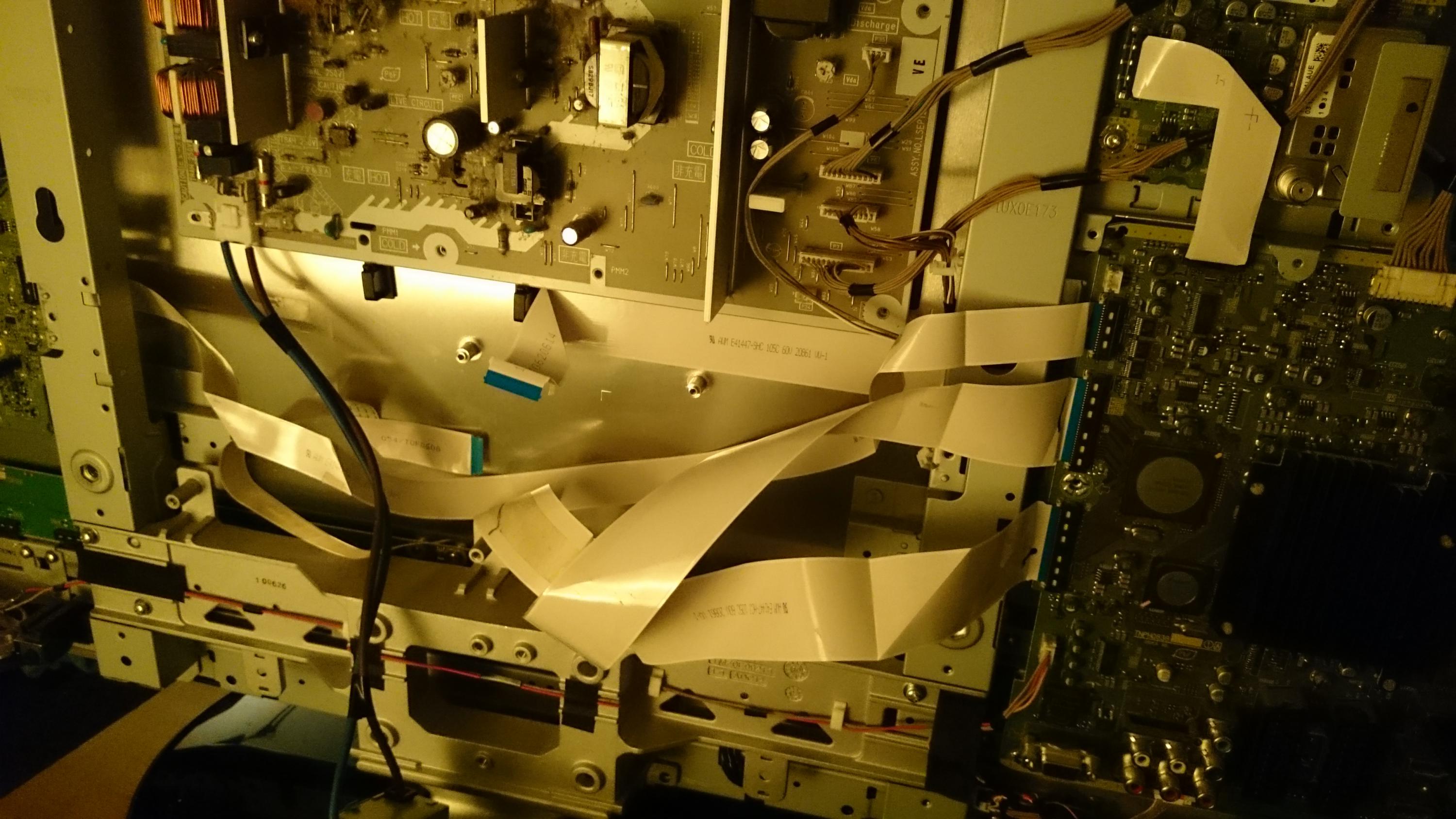

      Re: Panasonic TX-P42GT20E 3D , does not turn on!
      Ok i installed the fans and the V20E is now working perfectly inside the GT20E chassis. Now i need to wait for the D board to arrive to test the GT20 mainboard if its short or not.
      Can i test the mainboard for voltages?

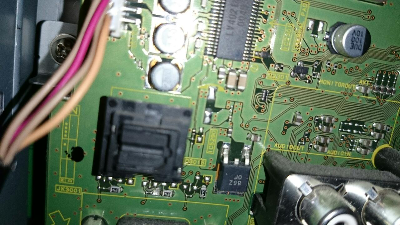

        I asked the owner of the TV what was connected and he said the tv was connected via hdmi to a hd receiver. The hd receiver was also toast....
        Does this help for fault finding?
          #44
          It points to power surge damage... Probably a lot more than that one IC damaged unfortunately...

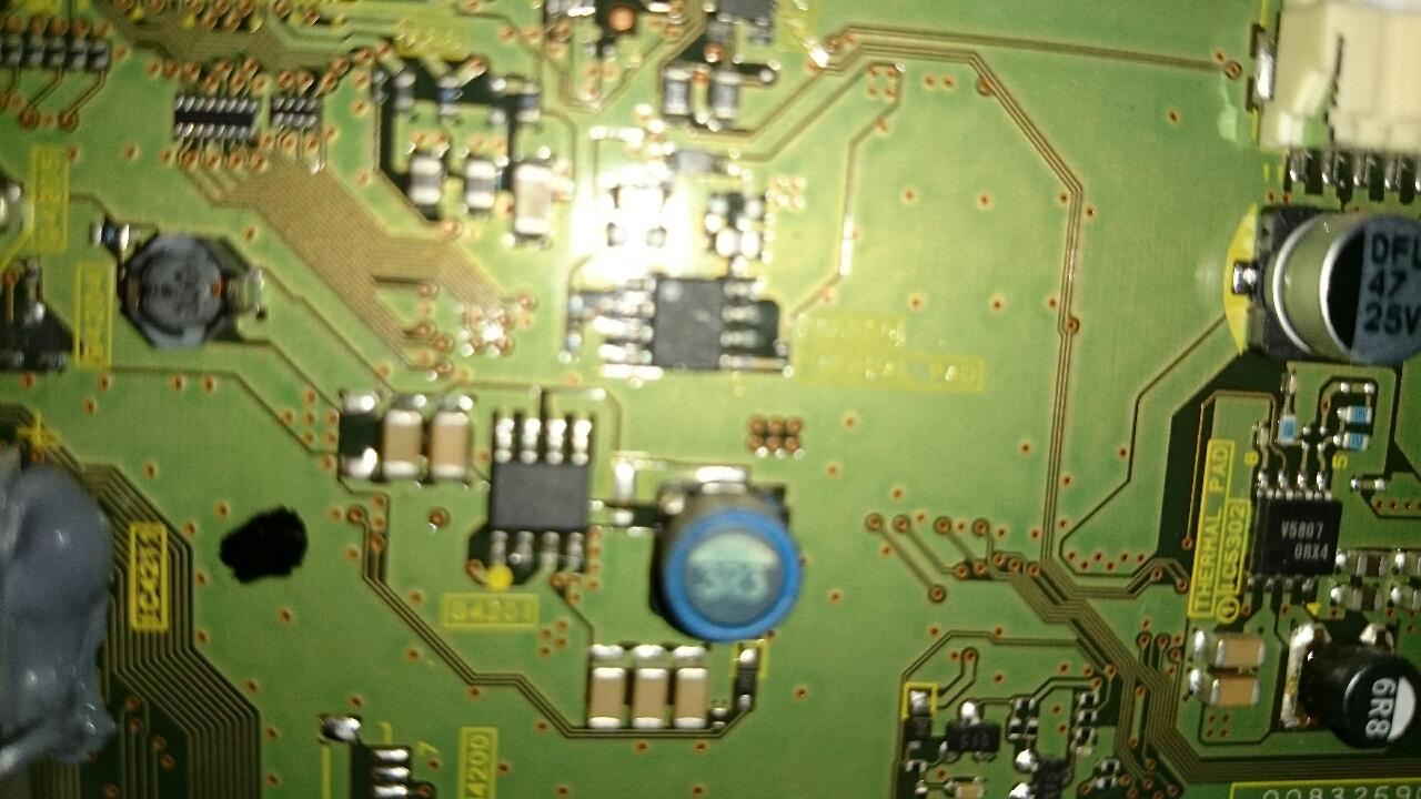

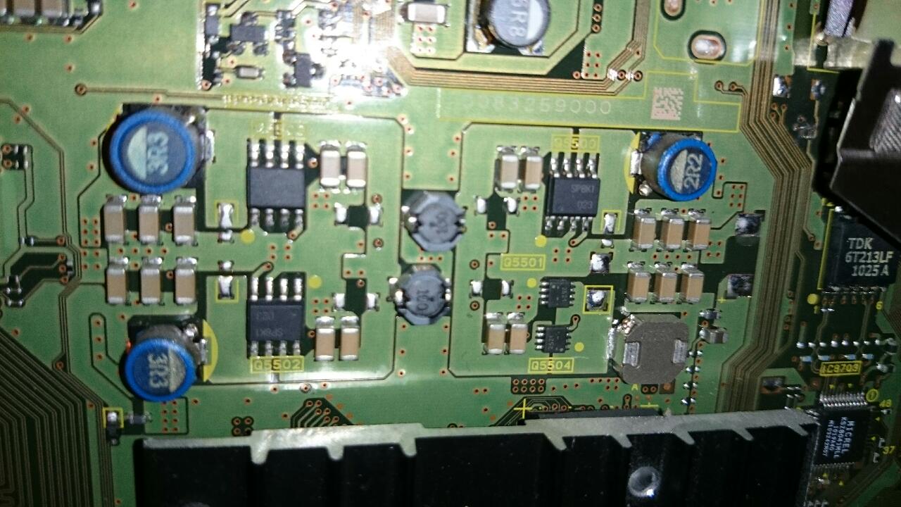

                          Yes of course , thats whats i thought also but i tried something…. ( Not giving up yet ).
                          With so much current going through a main board i would say that a lot of components would be bad…right?
                          As i have the main board from the V20E installed and its running perfectly i thought i measured some voltages on regulators/caps and most of the voltages i measure are 15V / 9V / 5v / 6v / 1v / 1.8v etc ( on different ic's , voltage regulators , small capacitors ).
                          I then placed the "faulty" main board back into the set with the LVDS cable not connected to the main board. I turn on the TV and i get the following readings , before it clicks again due to the lvds cable not being connected.
                          IC5290 : 9v / 15v ( same on V20E )
                          Q5502 : bottom row = 1.5v 1.5v 15v , 15v ( forgot top row… doh! )
                          Q5500 : 10v , 15v , 6v , 0v, - 1.9v , 8v , 1.3v , 0.7v
                          Q5303 : 1.8 , 1.2 , 1.2 , 0.7 v ( again did not write down bottom row ).
                          Q4251 : top row -> 15v , 15v , 1v , 1v
                          bottom row 1v , 1.3v , 0v , 4.5v
                          There is a similar ic above Q4251 and reads 5v 6v 6v 0.8v , 0v 0v 0v 0v. ( not in this order ).
                          There are a lot of small caps on the board that read 15V when i power the tv on.
                          I don't have a service manual for this tv but maybe someone can tell me if these voltages look ok?

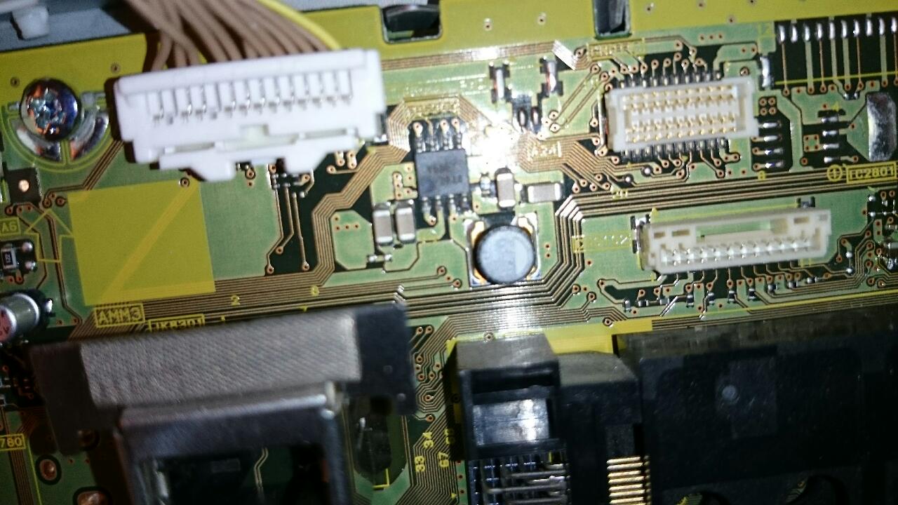

                              I would read through the training guide and follow the start process and confirm what voltages. and signs there are like relay clicks, red led at the optical jack etc. It may be that the voltages are present but one of those main ICs is fried.
                              never found Q4251, but 15v in and 9v out at IC5290 is correct and interesting since the F15v is part of the startup voltages needed.
