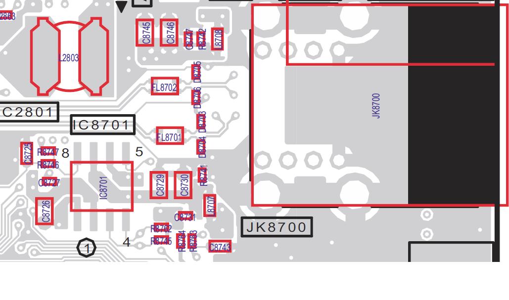

      Re: Panasonic TX-P42GT20E 3D , does not turn on!
      Hope this is the same board TNPH0898
      actually I have 2 shots of the board print, i had the wrong spot.

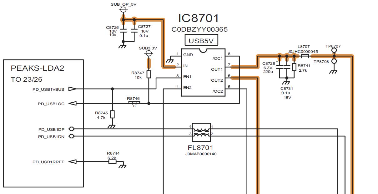

        something a little random, is ic8701 near the burnt area? 8 pin device.
        can you measure resistance between pins 1-2,1-5, 1-8
        was anything connected in that port when the lightning hit?

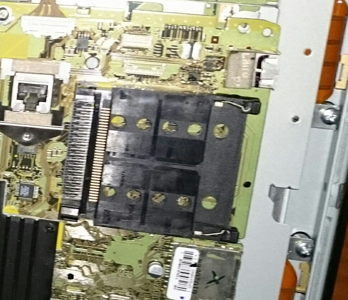

              This is the best that i can do atm.
              Its 11.30 in the morning and im.working till 5....
              The blown part is on the right side next to the usb.
                Its also a 8 legged component
                  You saying the blown part is the 8 pin device? Time zones make it hard, be 1230am when you finish and if you stay up til 10pm that's 530am here.
                  I'm looking at that IC because it has 5 and 3.3v going to it and is used for the USb so if that is shorted that would stop the A board from running or at least suspect.
                  A couple of guys have ressurected their A boards from lightning via the HDMI ports which took out some devices and shorted the 3.3v I think, so that's a theory anyway. I'm sure you can live without USB if that's all that's doing it.
                  It's a nice challenge anyway to see if it can be brought back from the dead

                    #29
                    Yes the 8 pin device on the picture is blown. On the picture you can see 2 components with 8 legged pins. One on the left and on the right. Im talking about the device above the black card reader.
                    I took the same device from the V20E mainboard but still same issue! Also the V20E mainboard without the blown device works perfectly so it probably is just for the USB only......

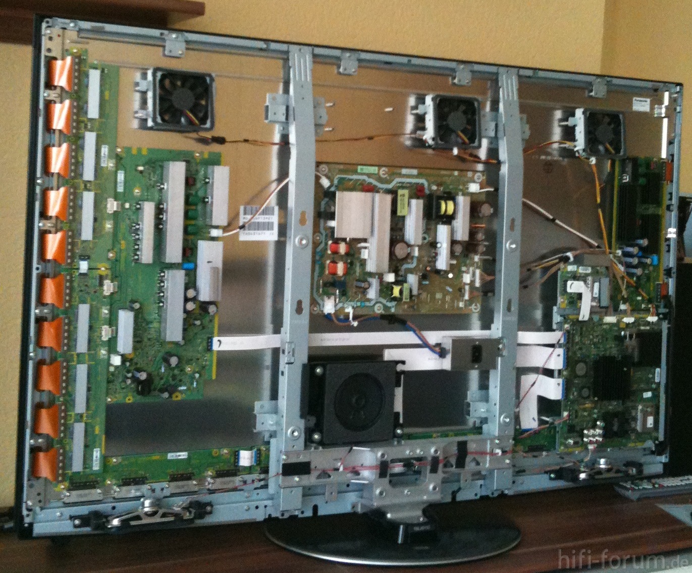

                        Are you 100% sure that the V20E has fans?

                          #32
                          The R8747 from the V20E mainboard is also gone. ( Happened when i removed the IC ).
                          So just to make sure you understand ( My english is not the best ).
                          The mainboard from V20E without the R8747 & IC8701 works perfectly.
                          Im still thinking its the D board as you said it can also turn on the tv.

                            #33
                            Aah dont worry about the timezone , im not in a hurry! Im already glad that your helping me out.
                            If you have any suggestions to fix the mainboard just let me know! Ordered the D board from the UK so it will take 2/3 days..... ( was only 25 euro's ).
                            Fairly sure. the V20A (Australia) V20Z(new Zealand) G20,G25 (USA) do not but I have this memory the V20e does as i think someone else used a different board to fix theirs and had 11 blink issue no fans, may have been Hombre?
                            i'll check it out
                            • tw2005
                              • Oct 2011
                              • 6458
                              #34
                              The mainboard from V20E without the R8747 & IC8701 works perfectly. It would because that part is not monitored for failure except if a voltage was shorted
                              Well , I admire the fact you're backing yourself, but i can't agree.
                              When you plug in, do relays click, front LED on for standby? If not the A board is toast. You have a fried IC on that A board, it's like a smoking gun and most likely lightning came through the antenna system.
                              It's happened to me but just lost a HDMI luckily because the antenna came via a set top box then the box via HDMI, other wise i dare say my A board would have cooked too.

                                Oh , which V20E (size) is that board from?
                                • tw2005
                                  • Oct 2011
                                  • 6458
                                  #36
                                  It was STANISLAV, trying to fix a 50G20E, used 50V20B mainboard and pretty sure the main from the V20B and V20E are the same. He ran into the 11 blinks and if you read that post I'm pretty he came up with a workaround if you decide to permanently make this a 2D TV

                                      Mine is a 42" but i remember it has indeed the same layout when i took it apart for parts! Will try to power it up with fans , see if it stays on. Im not going to make it a 2D tv , i want to have it as a 3D.

                                        Best to give us a nice clear photo of each mainboard. so you're saying the V20e was a 42" no fans? kind of weird then for it to throw 11 blinks. Anyway, this is all making me very weary.

                                          No at first i thought it had no fans , but after you showed me the picture im 100% sure it has fans! Will connect them tonight and make some clear pictures!
