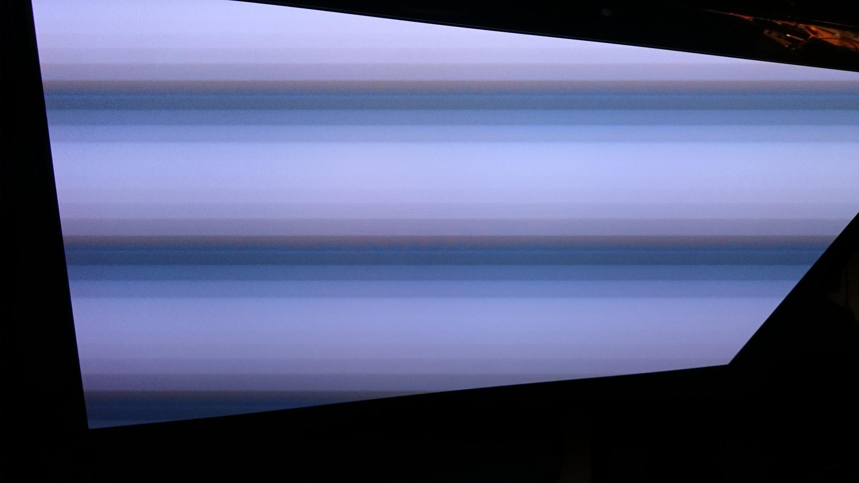

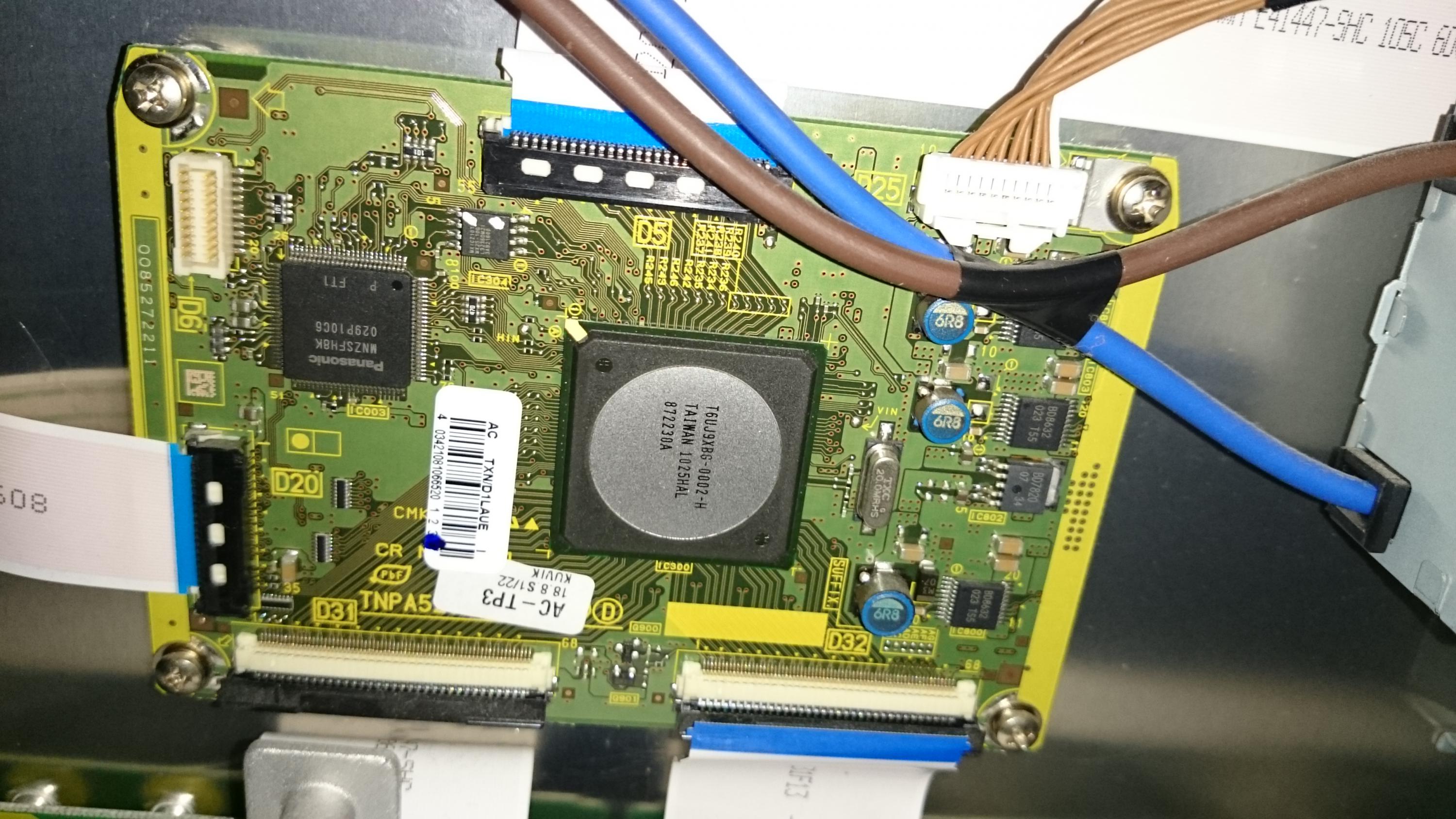

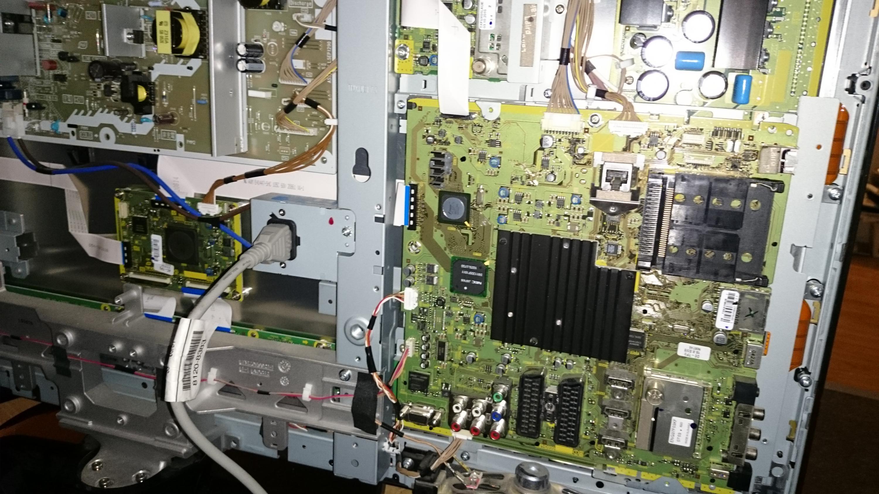

    Re: Panasonic TX-P42GT20E 3D , does not turn on!
    Here are the pictures! The screen looks like it has stripes , thats because of the camera! Screen is white.

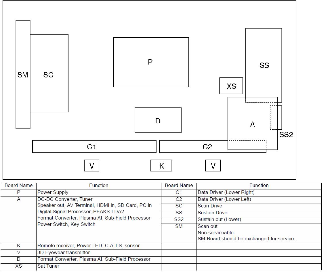

                    Just so there's no confusion, this is the board layout

                        No, I'm thinking A-board, that's where the blown IC is , yes? the D board controls the panel so my line of thinking is because you've isolated it from the A board then it automatically is turning the panel on.
                        A board is dead.
                        there is a 3D training guide although for the 50" however principle of operation is the same. When the LVDS ribbon is removed the TV is meant to turn on, white screen.
                        So that confirms all else is good, it's not the D board that is faulty
                        Yes it's a strange one with the 42" having the same panel for 2D & 3D. definitely not the case with the larger panel. So it does make sense to convert to 2D if all you want is a Tv that works.
                        Would be interesting to fault find the original A board, any pictures of that burnt IC.
                        "Method To Turn On the Panel Drive Circuit Only (A Board is Isolated)
                        It's possible to have the “Panel Drive Section” running with the “Signal Processing Section” (A board)
                        disconnected.
                        By separating the 2 sections, it could be determined if the symptom on the TV is created by the A
                        board or one of the boards on the Panel Drive Section.
                        Note: Disconnecting D3/A32 and D5/A31 allows the TV to turn on by itself with a white screen after
                        it is plugged in to the AC line. This procedure does not disable the A board.

                                      Not sure if its a diode or ic , it does have that part number on it. Its viscible on the mainboard picture , in the upper right corner.
