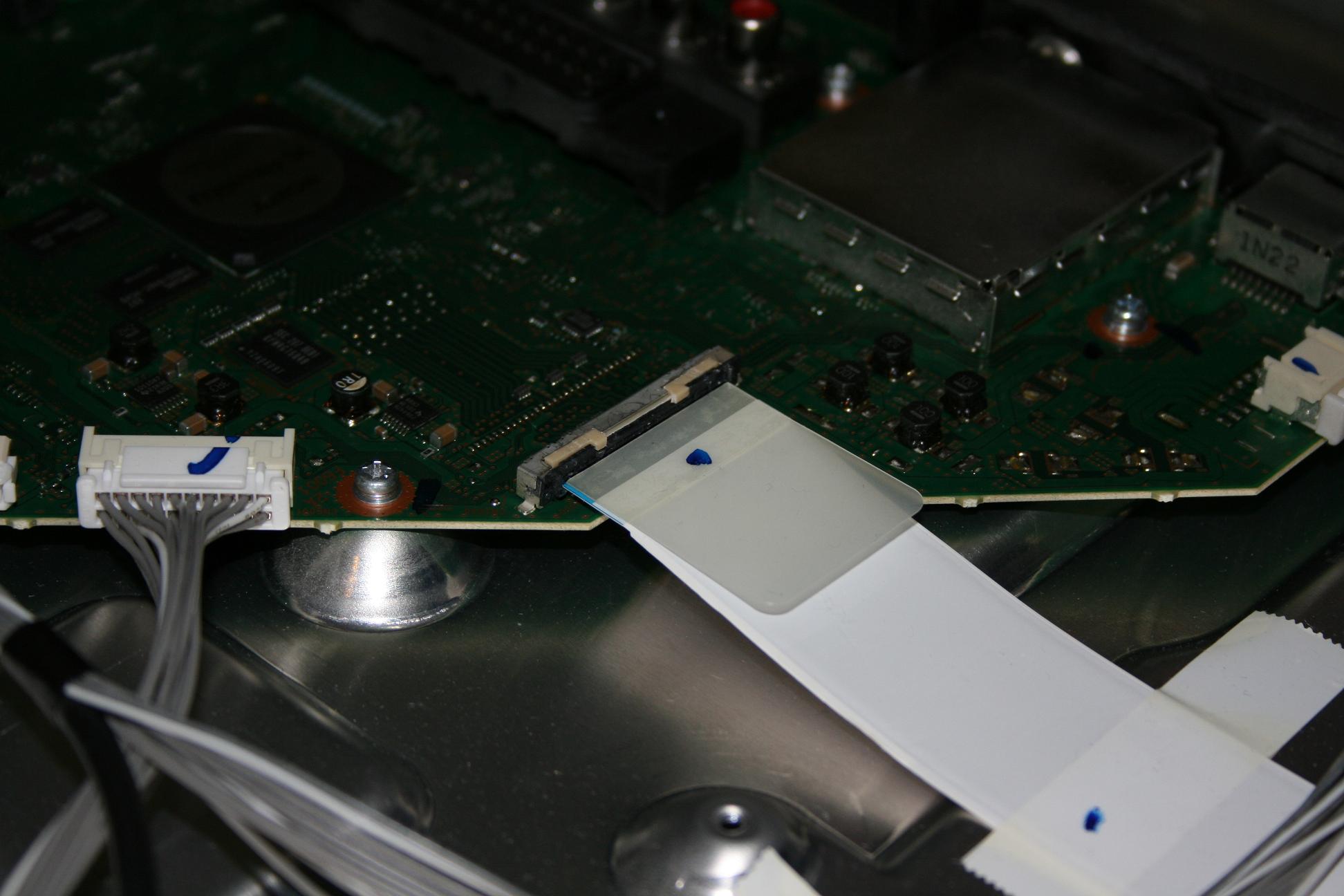

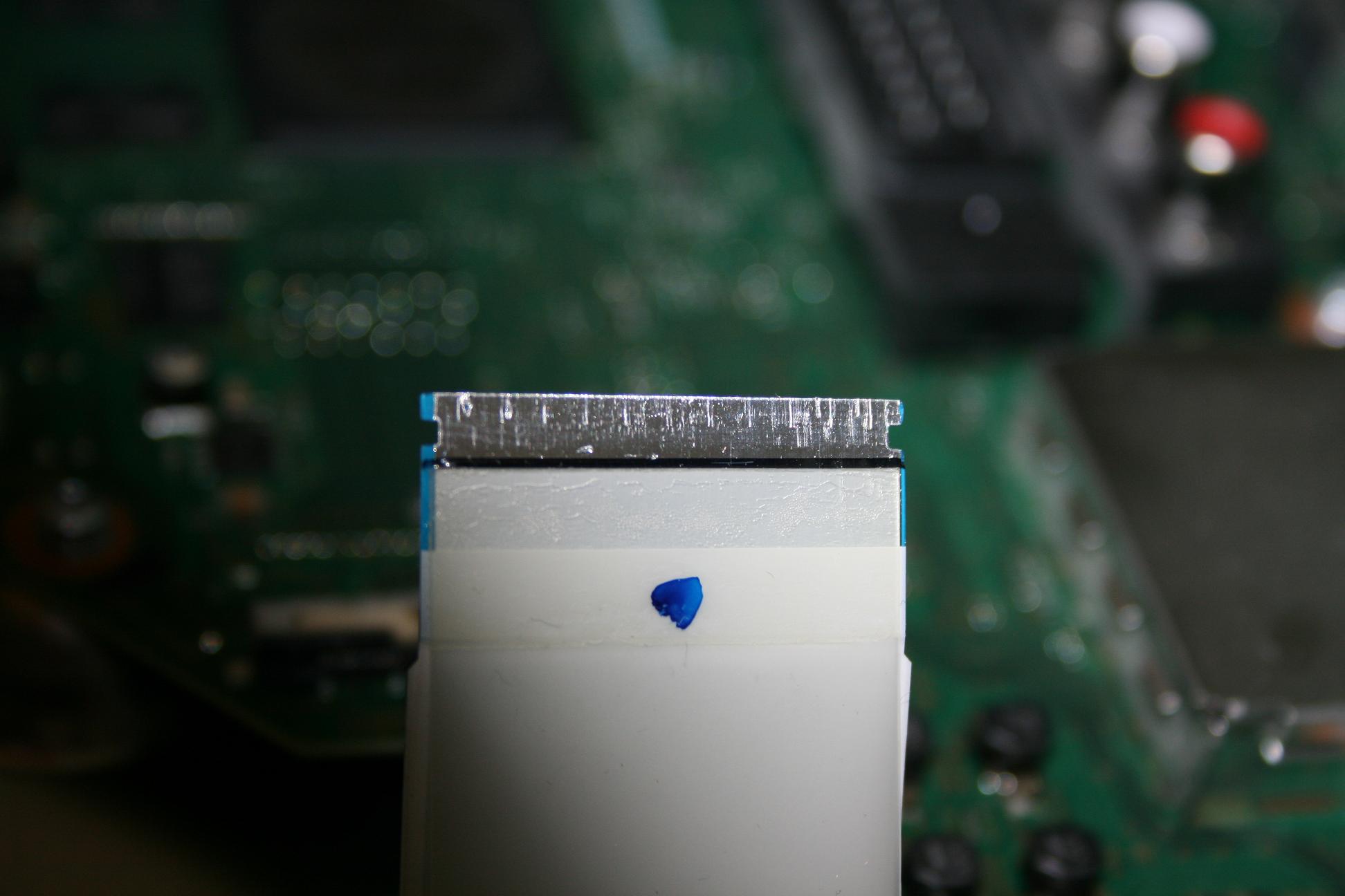

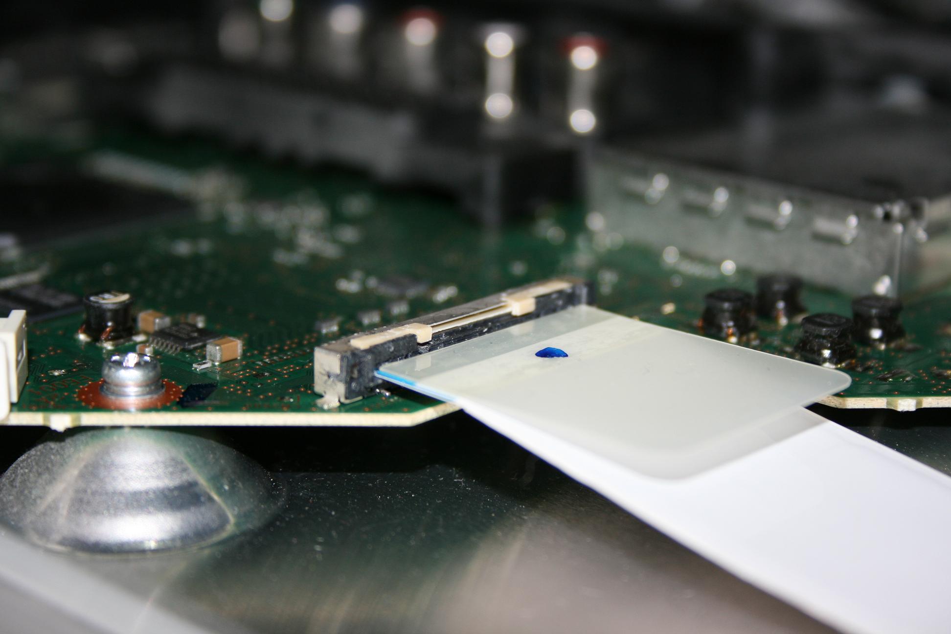

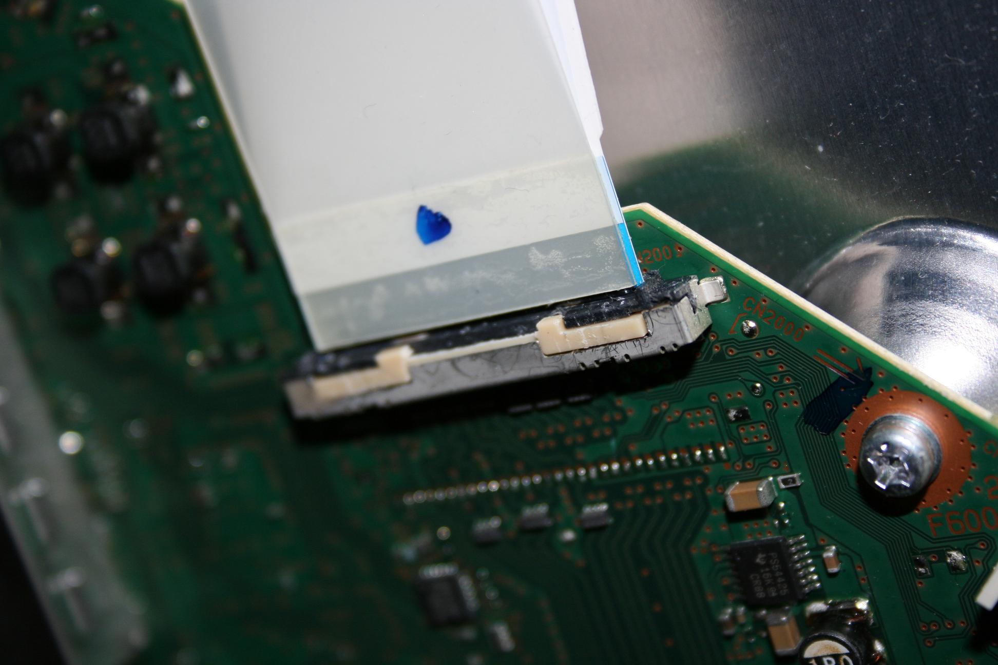

    KDL-32EX653 ldvs t-con cable connector
    please help i cant seem to figure out how to open this. i have already damaged it.
  • holmzy
    • Nov 2009
    • 99
    Re: KDL-32EX653 ldvs t-con cable connector
    see attached
    • holmzy
      • Nov 2009
      • 99
      help please
      • holmzy
        • Nov 2009
        • 99

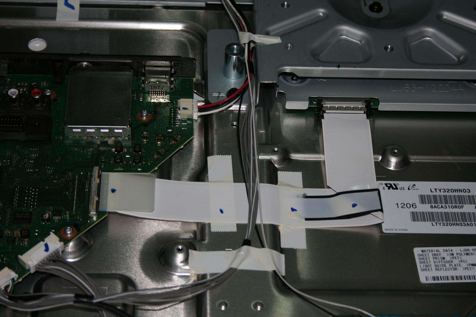

        anyone? any ideas? i can provide more pics

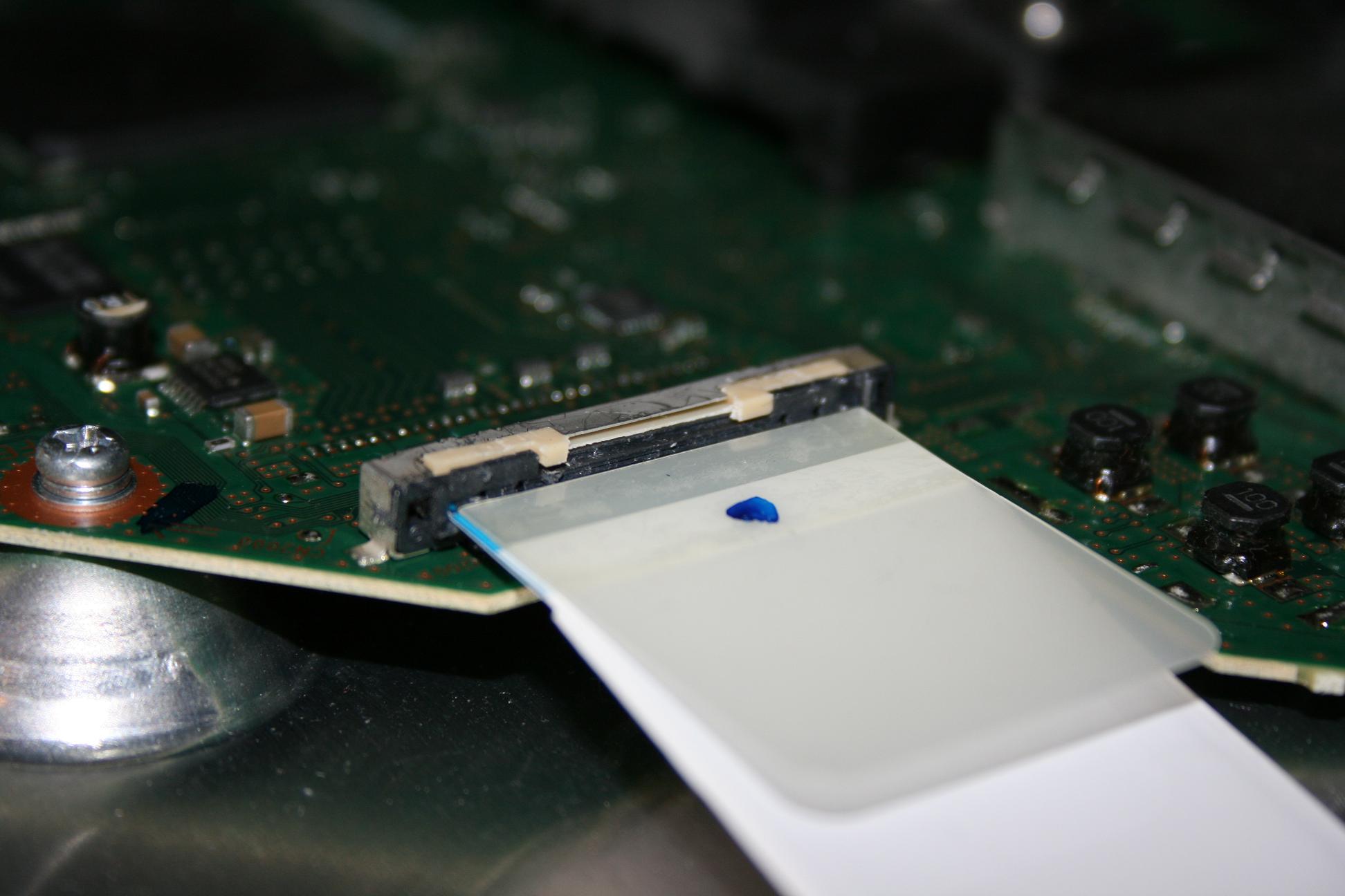

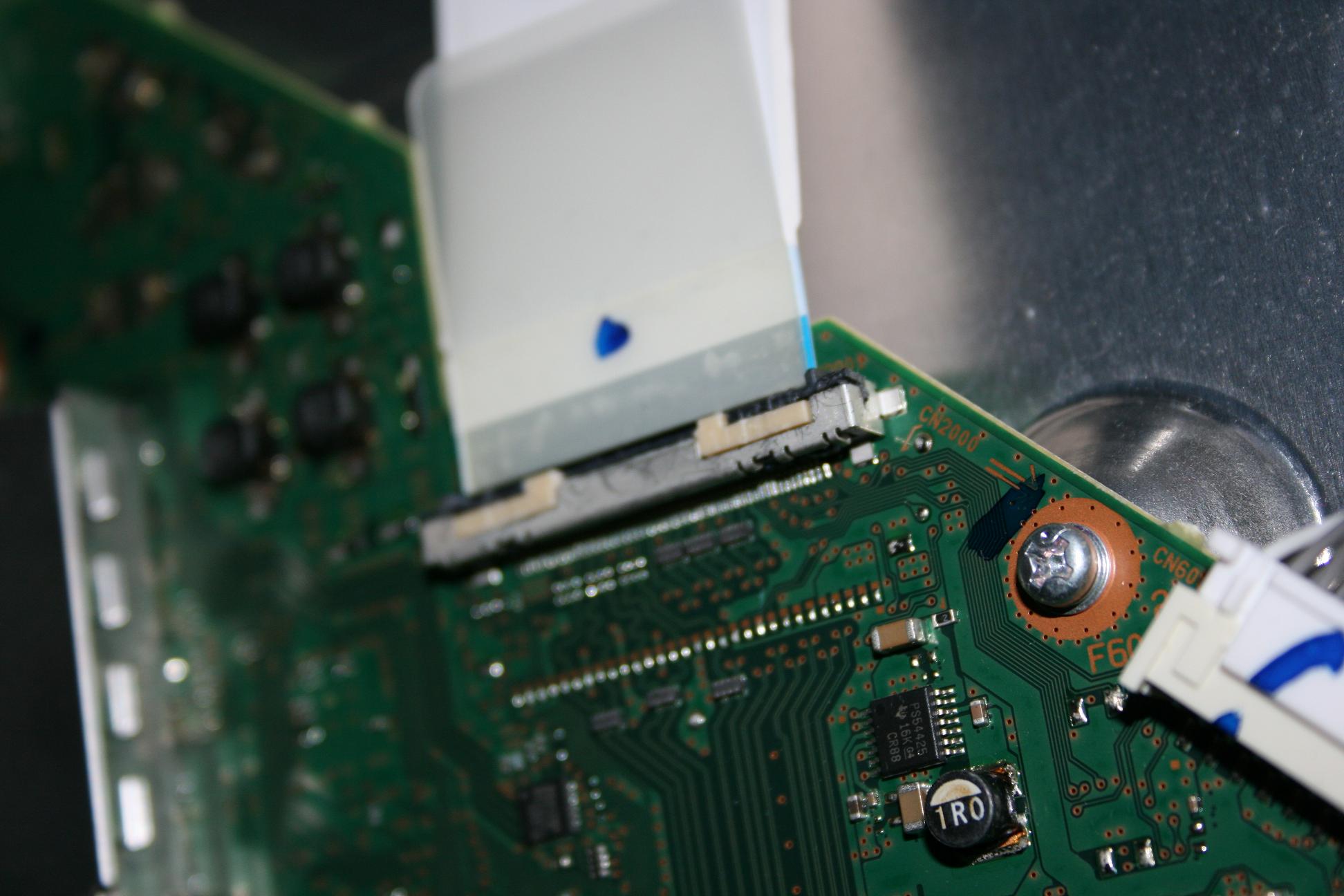

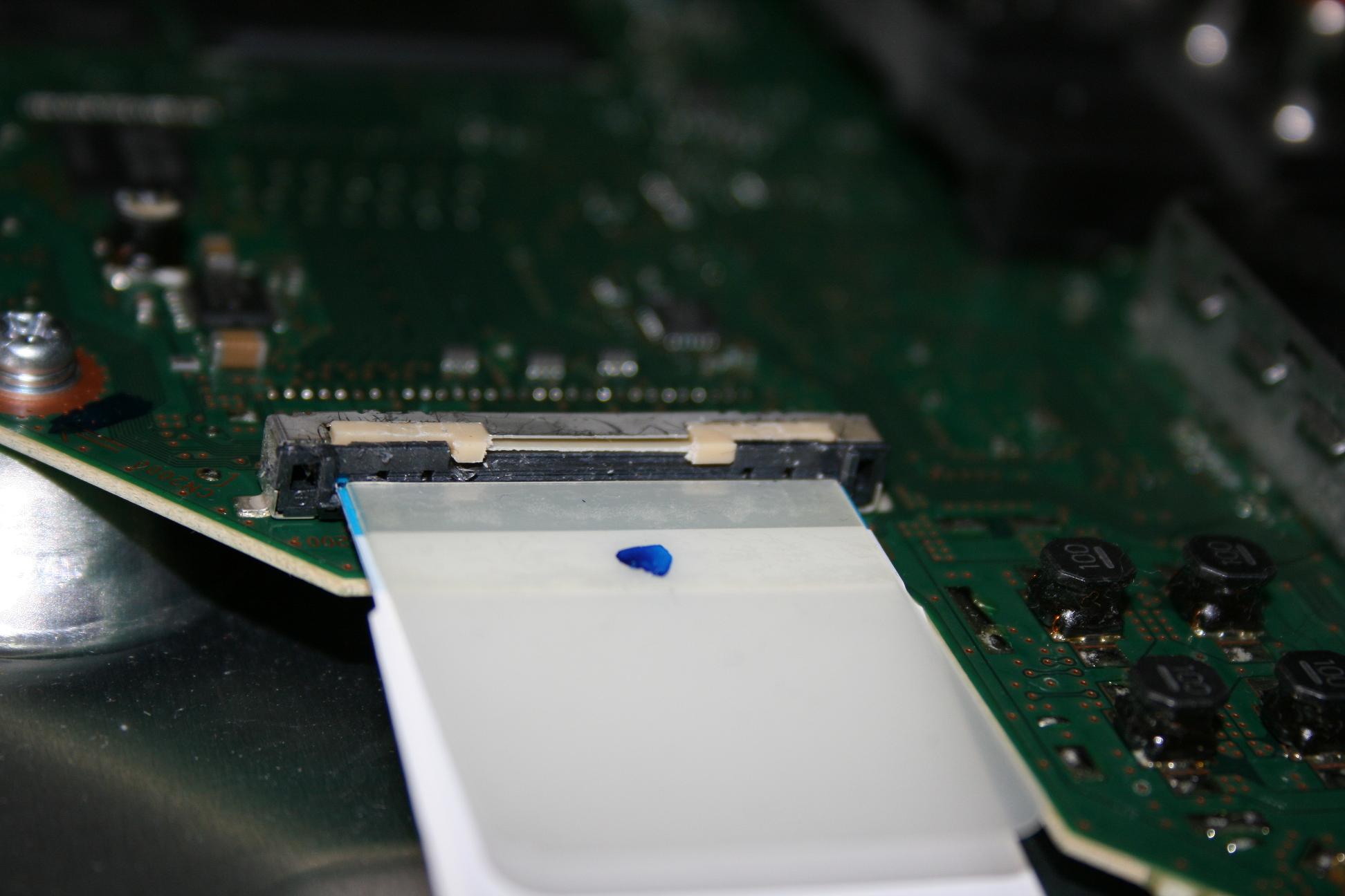

          not a clue but more pics. maybe from different angles, couldnt hurt.
          • holmzy
            • Nov 2009
            • 99

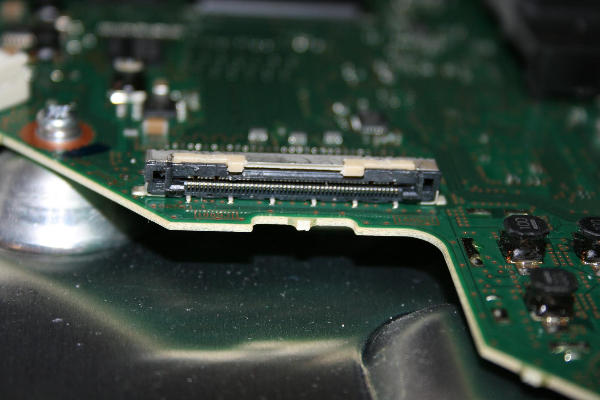

            see attached
            • splitcrete
              • Dec 2012
              • 387
              • usa
              I think I would try to swivel the red circled tabs out. Not Sure so be easy.

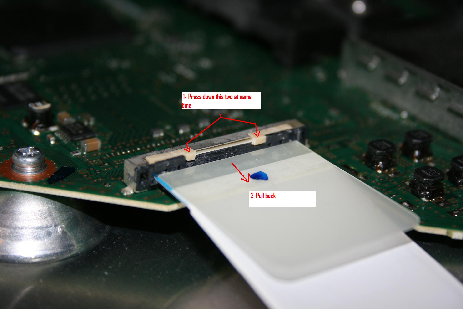

                Press down white tab at same time and pull back cable .
                  Hi thanks for the replys @splitcrete you cannot swivel it. the two white pieces were connected in the middle before i broke it. @anmol i was trying that but it didnt freely come out but that was the only logical solution. do you know for sure if that is the method? thanks again guys.
                    Yes I'm thinking the same , try to pull it down! It must be "easy" to remove these cables , if this does not work try to pull it up.
                    Its hard to see as you broke it off haha.
                    • holmzy
                      • Nov 2009
                      • 99
                      finally! I decided to be brave. go hard or go home! pushed down with scissors and yanked it out, it fought back with vengeance but then gave in and poped out due to my sheer biscep strenght!
                          only a week!
                          fixed the tv in 5 minutes. basically it had backlight no image. then on the board a saw a X-Reality chip, now coming from a gaming background i knew that chip had a failed ball joint. 2 minutes of a heat gun TV working! and yes the delay was the connector as i suspected before it had a bad connection. love fixing sony's!
