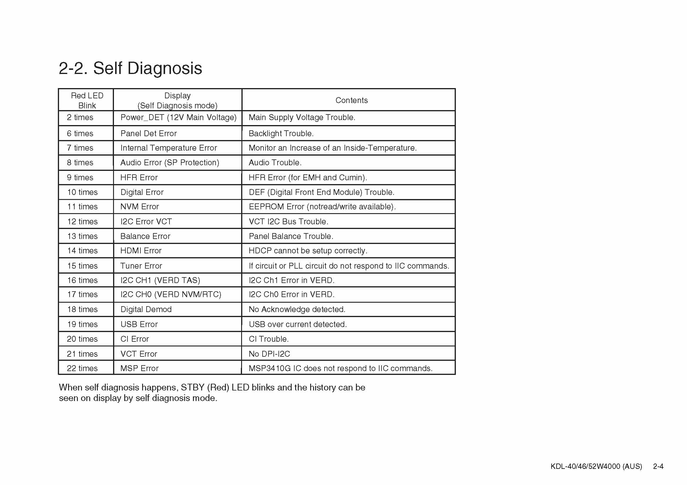

                        Page 44 & 45
                          Re: Sony KDL-46W4000 (2 blink code)
                          Did you hear the relay click when you activate the power switch?
                          BTW, I found the SCH of the power supply on the second file I down load from elektrotanya.
                          • funtastic
                            • Nov 2012
                            • 63
                            • New Zealand
                            Yes, it clicks once when switch is pressed and after the first set of 2 blinks it clicks again and that's when the above voltages change.
