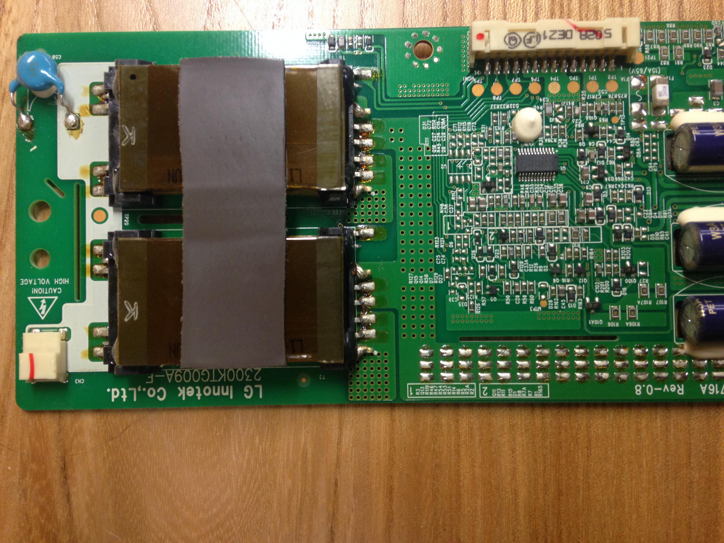

    I was given a LG 42g30-UD, because the picture doesn't work. With the help of this forum I was able to repair my Samsung Plasma so I thought I'd give this a shot also.
    I've searched on here but need some direction to troubleshoot further, as other sets close to this model seem to be "-UA" and have more boards in the back.
    when you power on the set there is no flicker or flash of backlight, just dark, but there is sound. With a flashlight, I am able to "see" snow on the screen and also the input options if I scroll though them. I've added a couple pics of the opened back for reference.
    thanks in advance!

      Need hi res pics of the whole power supply and areas with the cables unplugged so we can read the pin outs.
      Basically you have to see if the inverter board is getting the supply voltage and the BL ON voltage. If either is missing, the backlight is off.

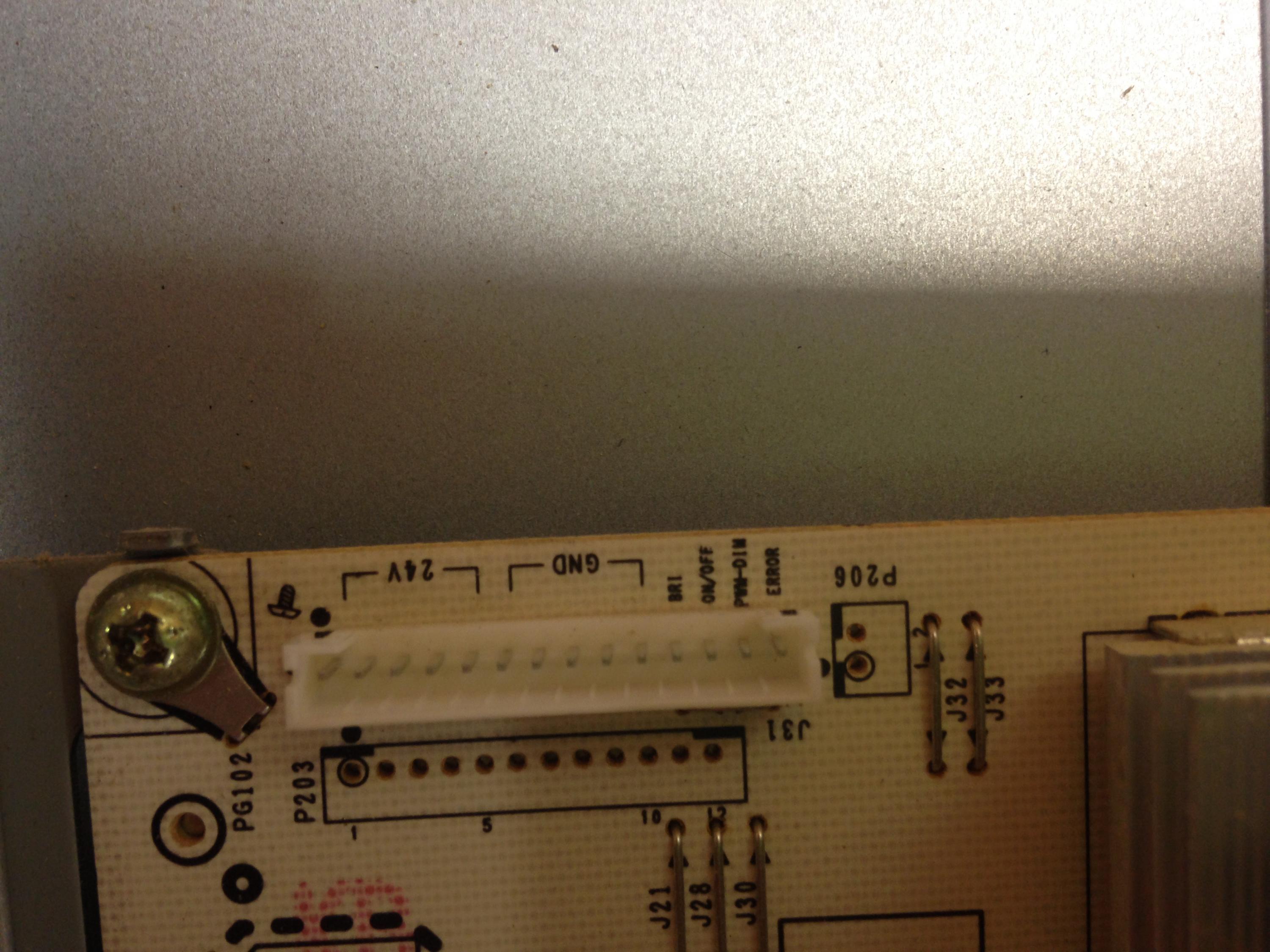

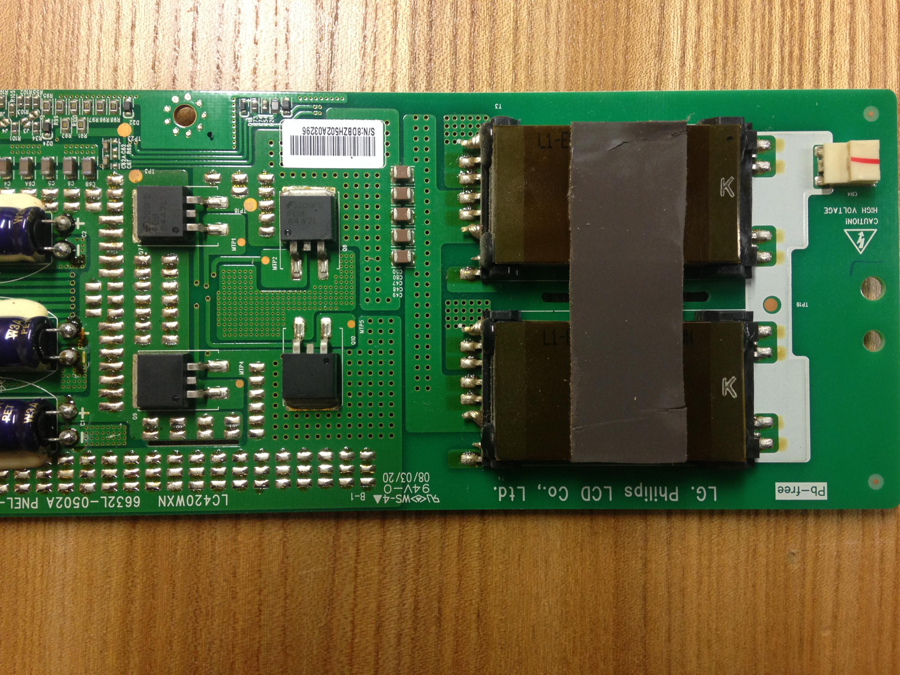

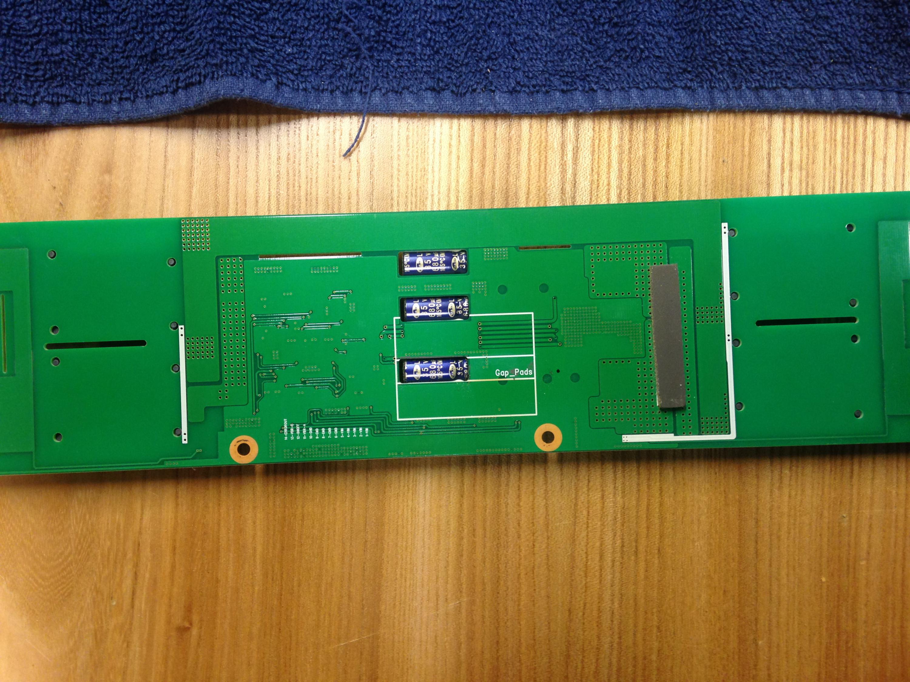

              Re: LG 42lg30-UD... no picture

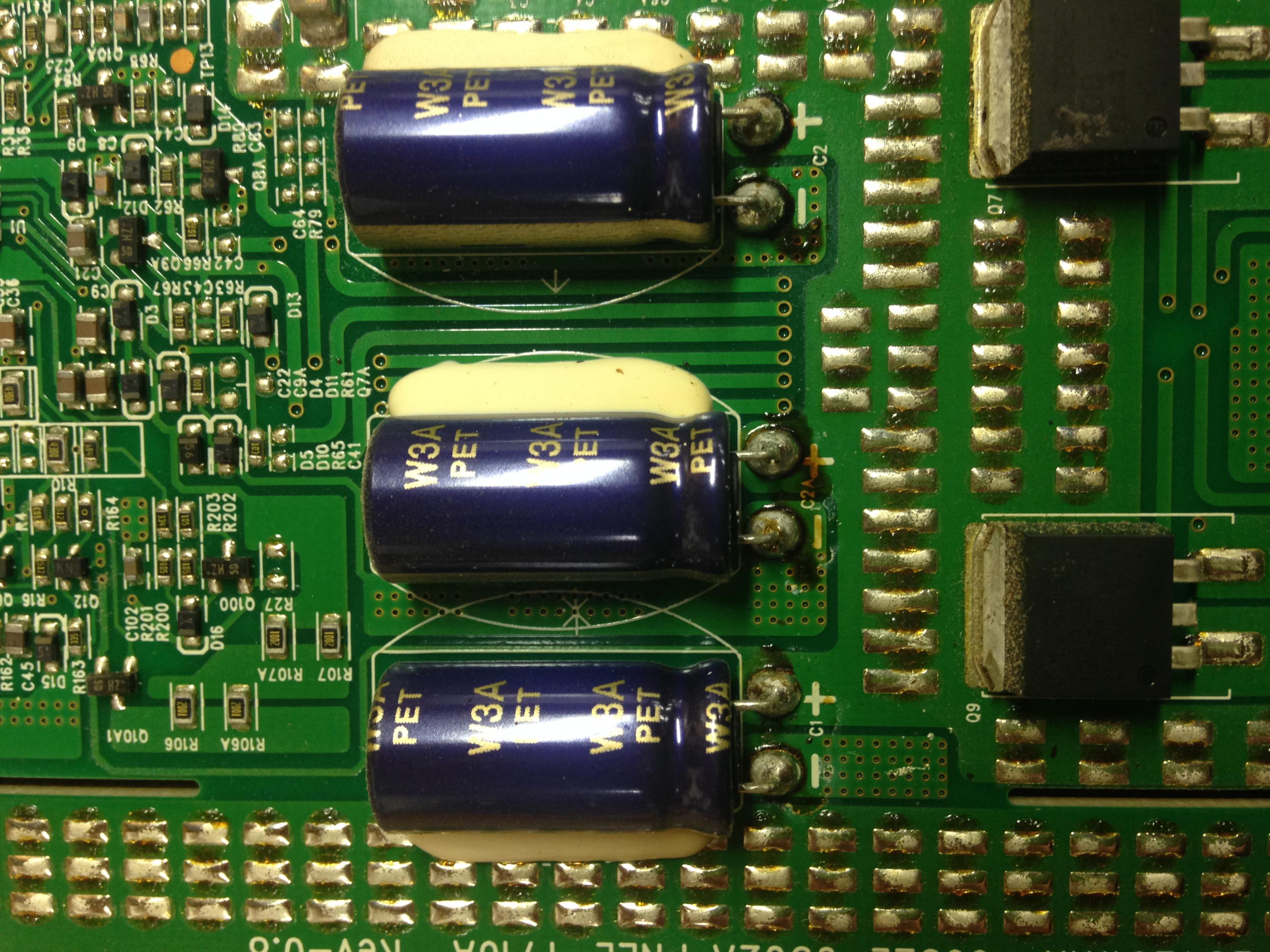

              Here are pics of Inverter board front and back. I took a close up of the caps as the connections to me looked like they got hot. This board is getting
              24.8v on pins 1-5,
              pin 11 (VBR-A) was 1.6v,
              pin 12 (on/off) 1.4v,
              pin 13 (VBR-B) 2.6v,
              pin 14 (errout) 0v
              Can the output to the bulbs be checked?

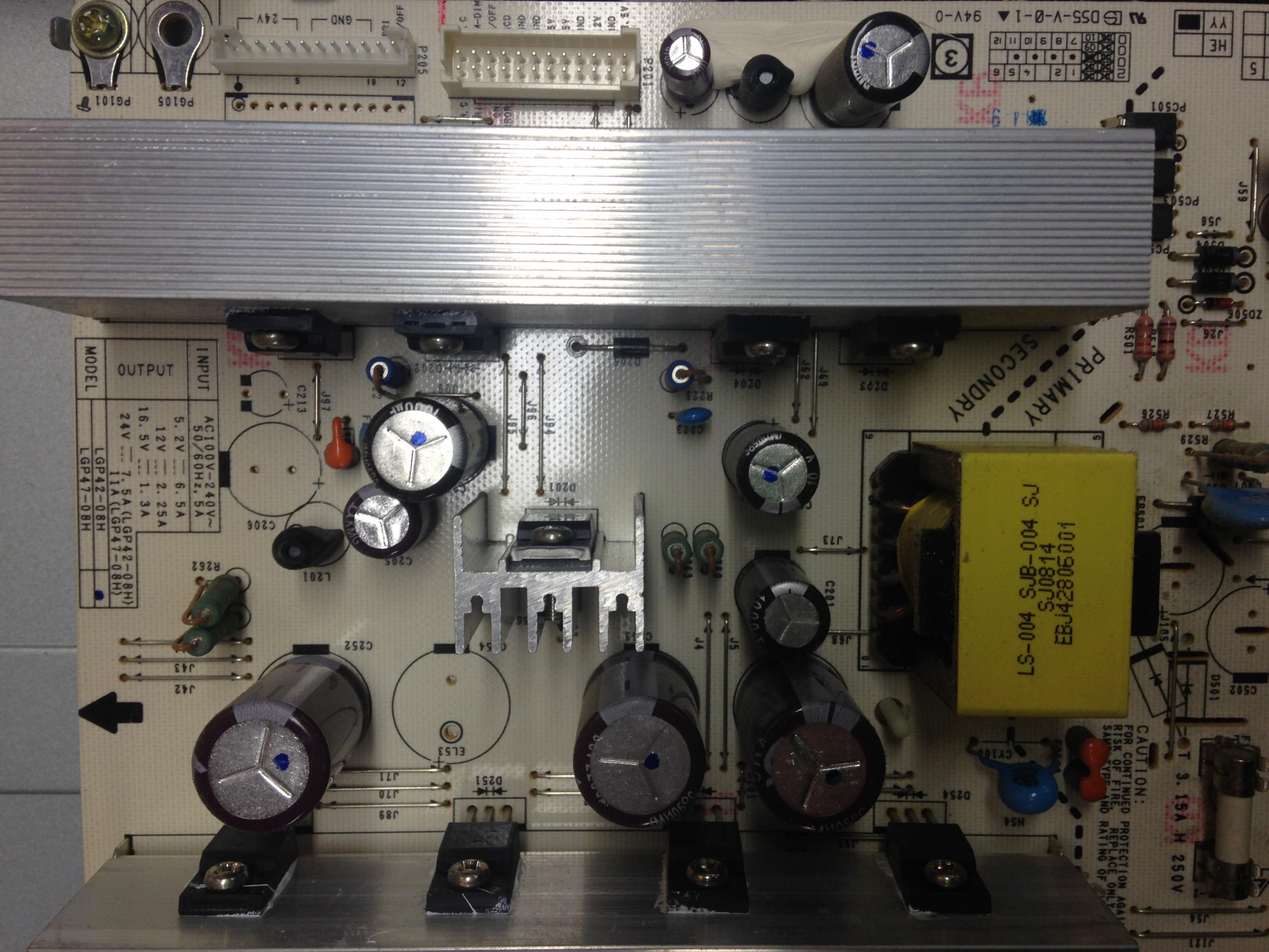

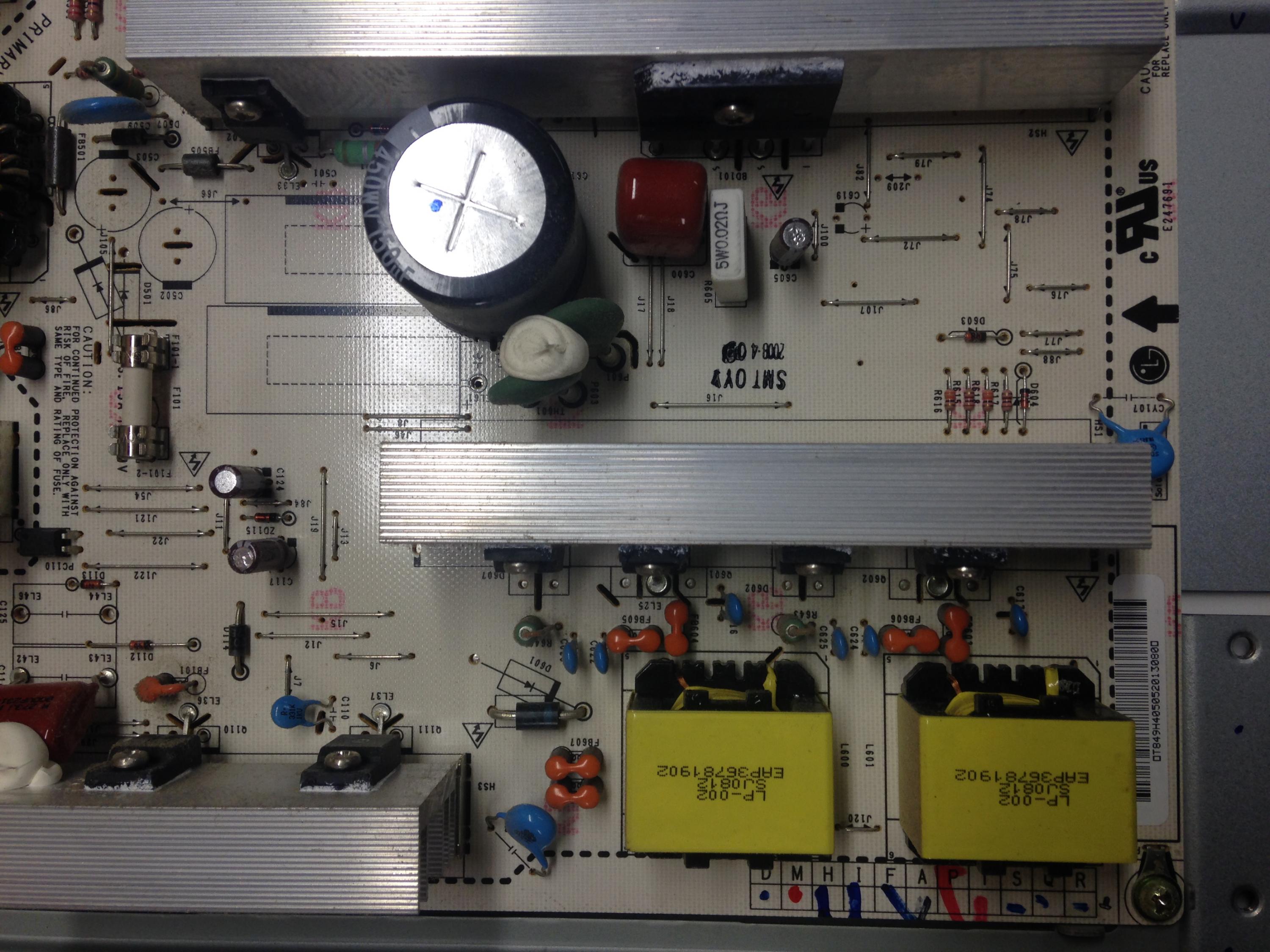

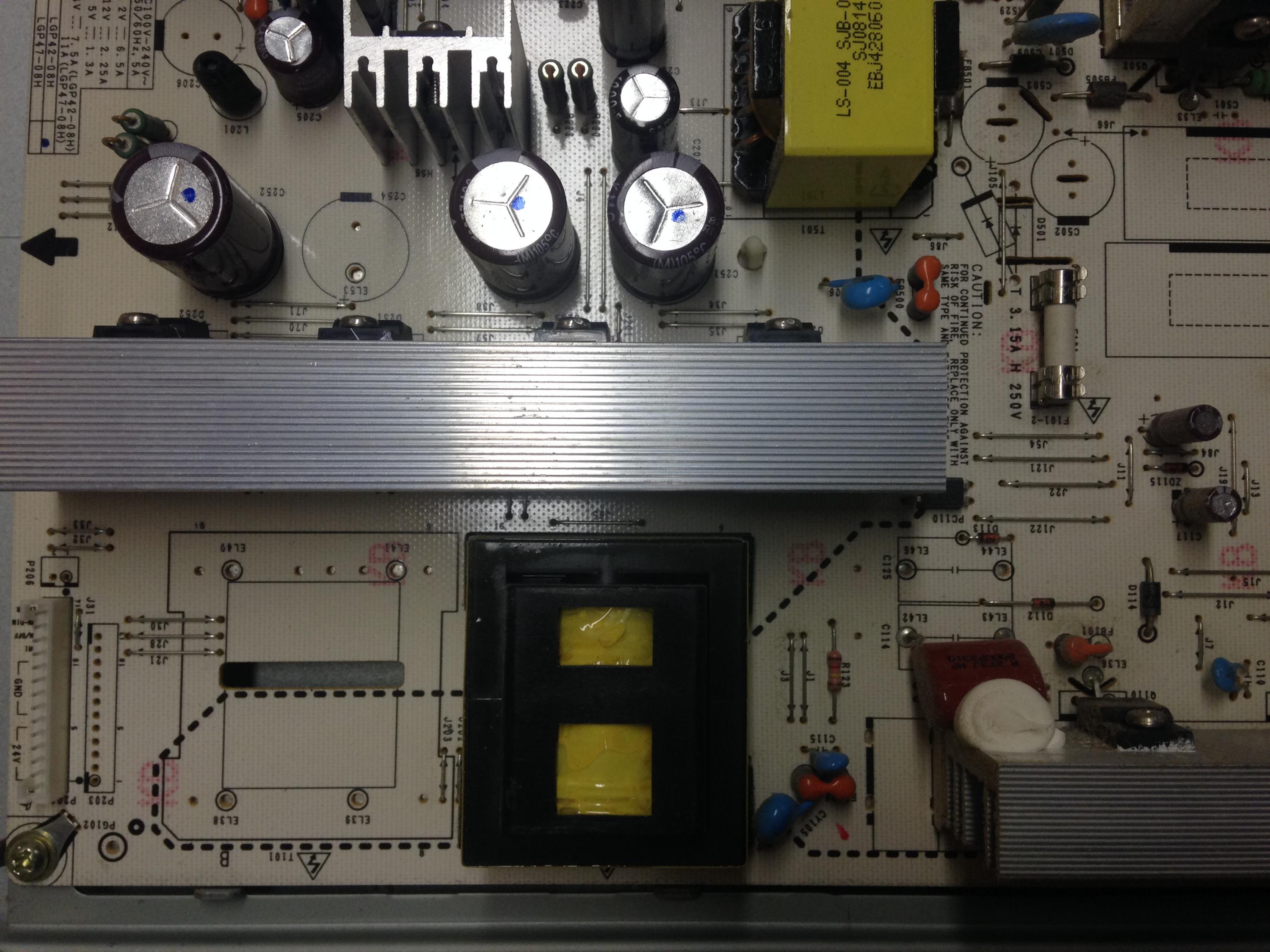

                These are power supply pics. I checked voltage out on all the pins, I wrote down what I saw but I really don't know if they were proper or not. Nothing on the board to me looked visually bad or that it had become overheated. both fuses were good. pics are clockwise around board starting at bottom right corner where power enters.

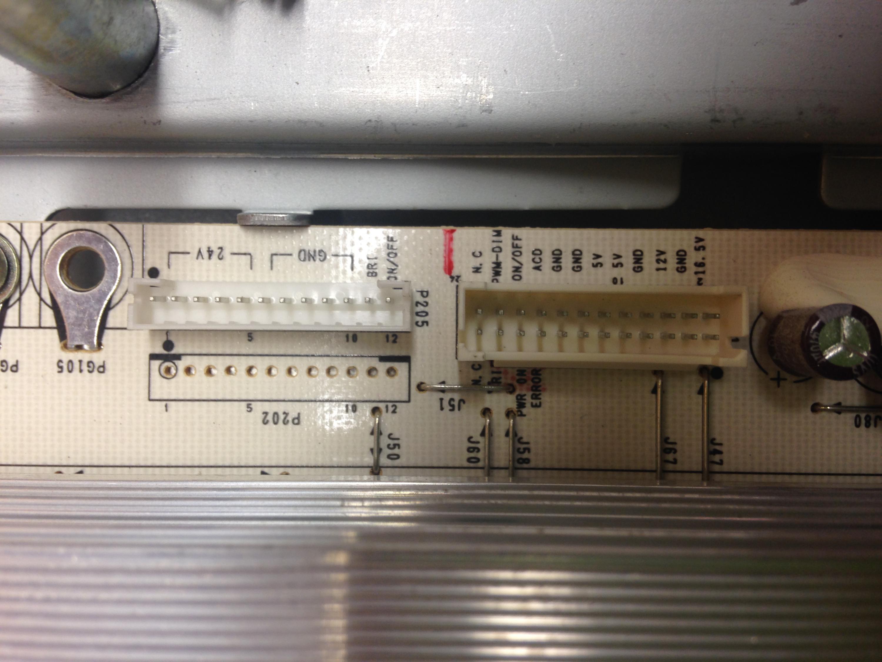

                  Yep, but need those pics from the power supply so you can force the power supply and the backlight on.
                  Can you make another one of the 2 connectors so we can see the writing?

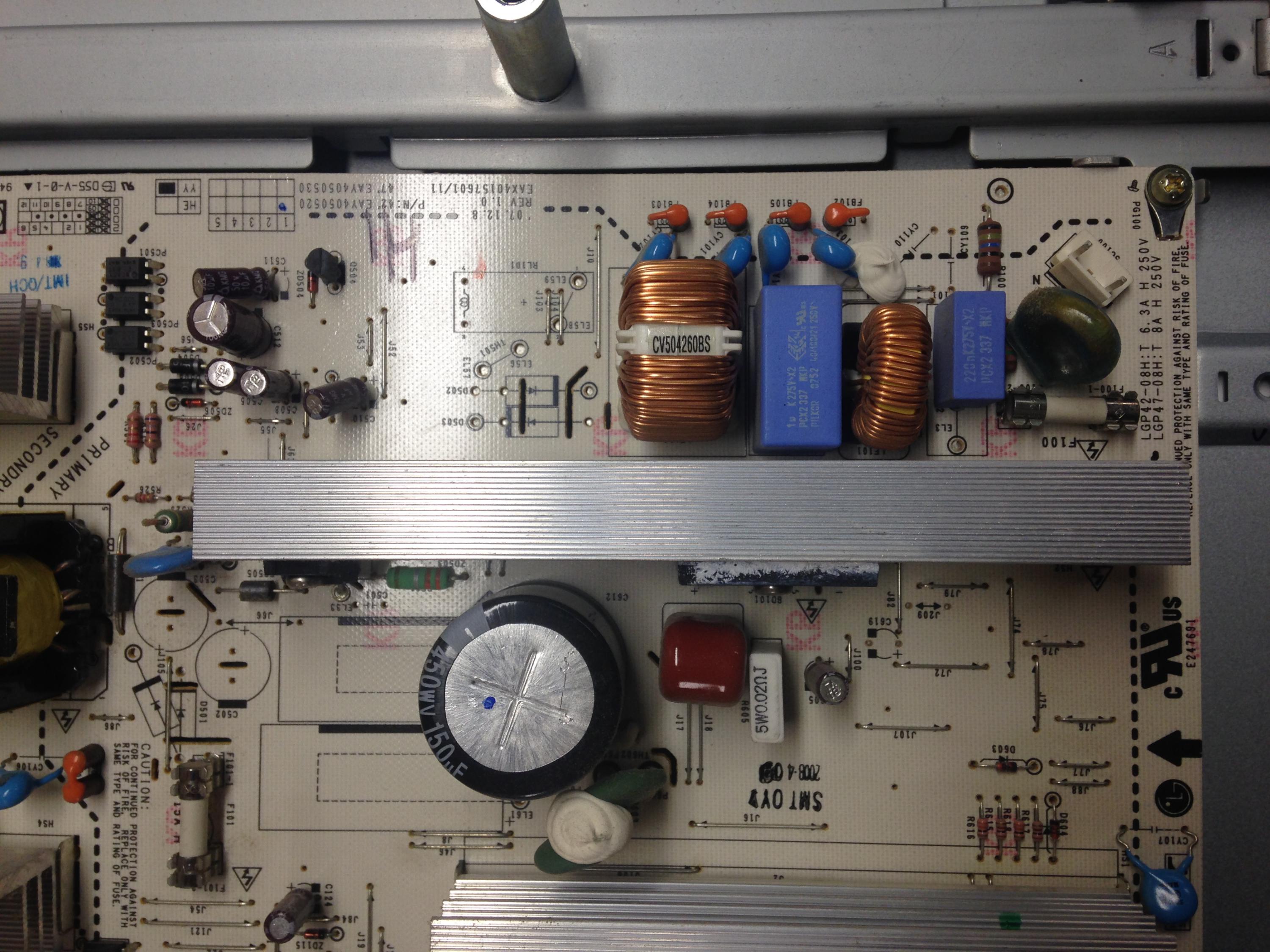

                    Here are connectors on power board.
                      Looking at what you have posted so far is that the on / off voltage for the inverter is too low to turn on the back light. I'd expect more than 2.5V there.
                      All in a nut shell, you have to disconnect the main board so that only the inverter is hooked up to the power supply. Then you have to jumper the PWR ON and the ON/OFF pin through a 1k ohm resistor to the 5V Stanby.
                      With that the power supply is forced on and the backlight should light up.
                        Thanks for the manual!
                        A couple questions.
                        on the double pin connector of the power board the 16.5v pin is only putting out 15.6v, could this be a problem?
                        the on/off pin on the double pin connector has 2.8v, the pwm-dim has 1.6v.
                        the PWM-dim pin of the inverter has 2.6v, while the on/off only has 1.4v
                        Are the ON/OFF and PWM-DIM pins the "same" on the double pin connector and the inverter cable connector? seems weird to me to have 2.8v at ON/OFF and 1.6v at PWM at the double pin connector, then at the inverter connector have 2.6v at PWM and 1.4v at ON/OFF, like they swapped??
                        just to clarify this, what I'm trying to do is take the 5v standby and with a 1k resistor put more than 2.5v onto the on/off and PWM-dim inputs of the inverter board to get it to turn on.
