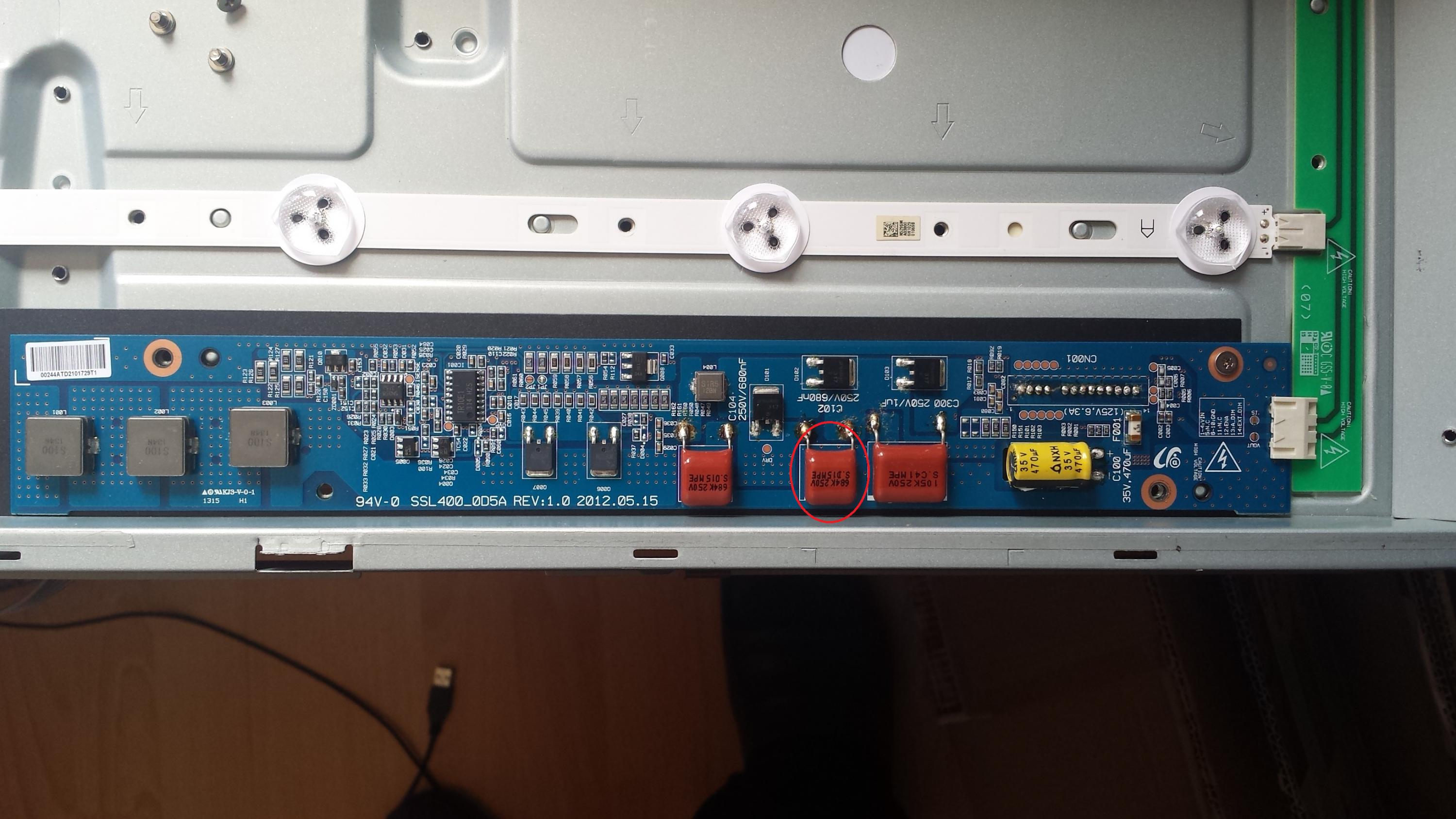

      I'll give it a try later, i have a new inverter board to try as well,

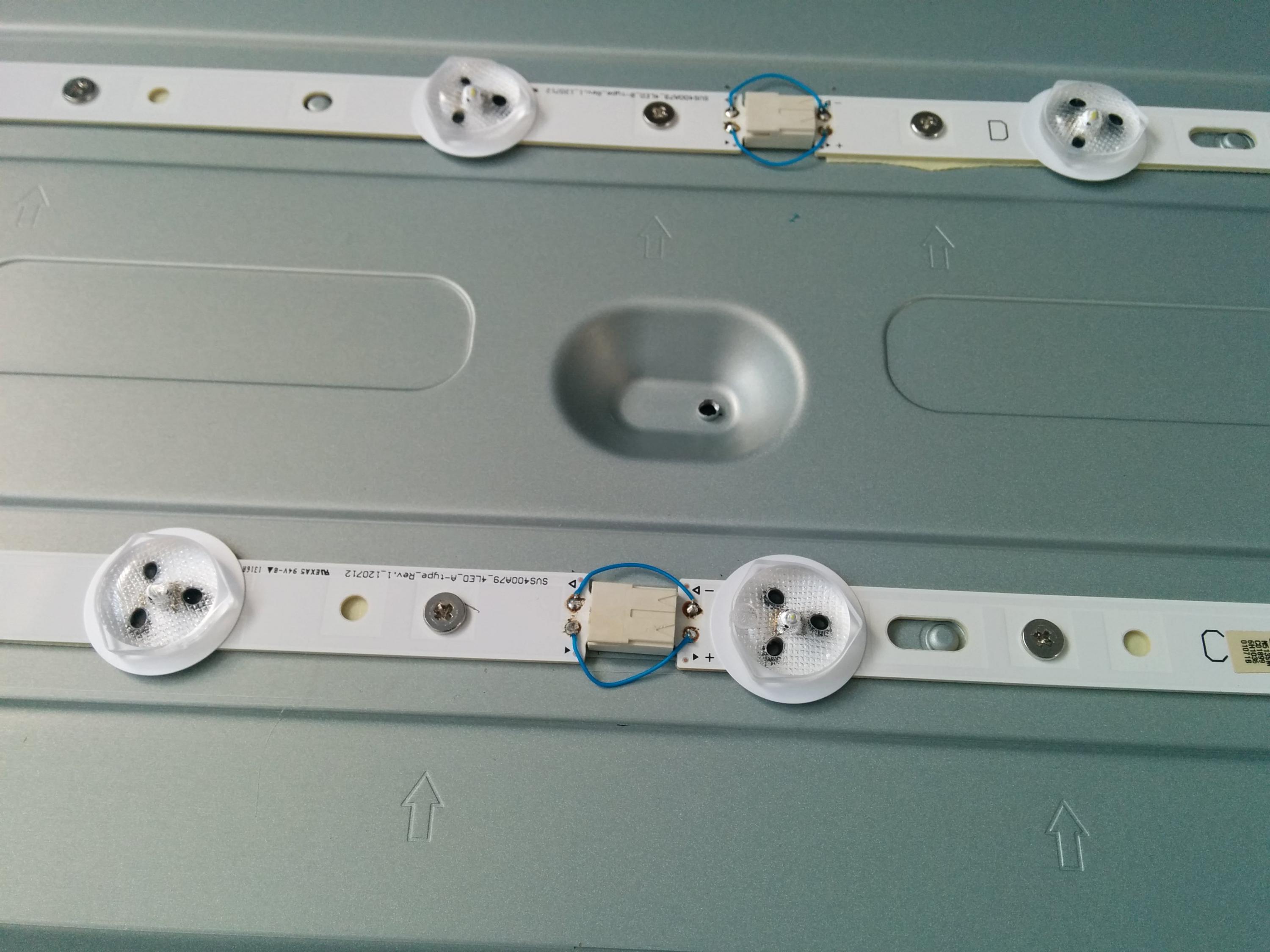

              Did one of these over the weekend.
              had to bridge the led connections with wire.
              and all was good again..
              They are a pain for this fault.

                          I have the same problem with my lcd driver board. The red cap has no voltage. I have checked yellow cap and it has 24 V. Has any one schematic of this board, please?

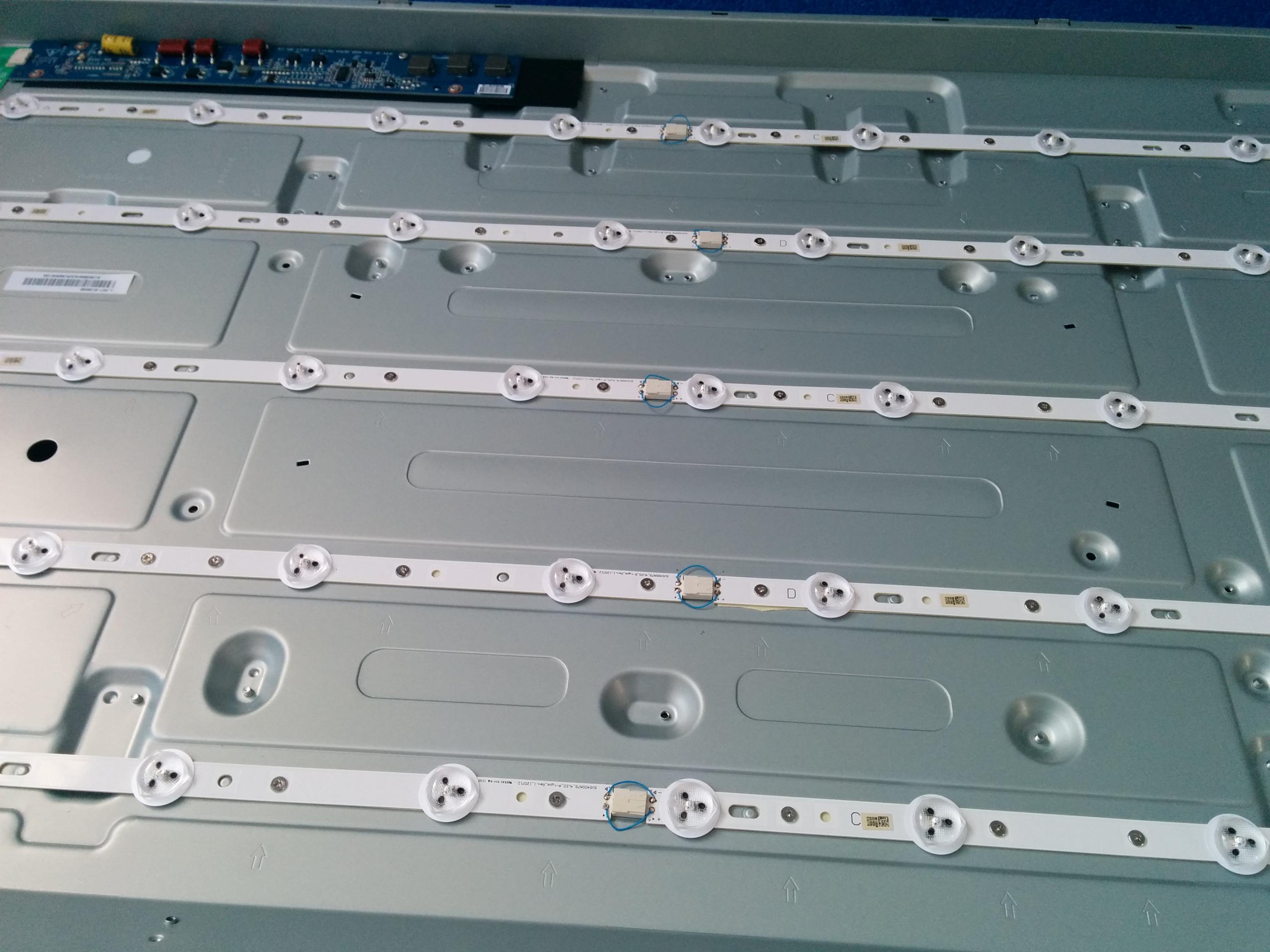

                            Quite random that I stumbled across this post...
                            I just fixed a Toshiba 40L133b with the exact same fault.
                            Was the bottom connection between the 2 led strips.
                            I went a little further and hand modded all the connection so it doesn't fail in future.

                              Same problem here. Already fixed, at least so I thought, three months ago. It's going on the blink again today.
                              Can I ask you what wire you used to duplicate those connections?

                                It looks like the standard 0.5mm wire that Maplin sells in little bags. I guess that I need to do the same to my dad's 40L1333B TV. The LED strips do seem to be a rubbish design.

                                      I want to thank everyone who has contributed to this discussion.
                                      I too have a Toshiba 40L1333B which suffered loss of backlighting. I followed the advice I read here, stripped it all down and removed the stupid bridge connectors. One was a little overheated and another was quite spectacular in its distress.
                                      I had no wire available to bypass them, so instead I removed all the plastic bridge connectors, cleaned the contact areas on the LED PCBs, and applied a nice amount of solder to each. I then used a length of thin solder braid, heated and reflowed the solder so as to allow it to wick into the braid. Then cut off the braid so it provided a connection between the PCBs.
                                      Then checked for continuity and for shorts to ground and between tracks before going through the hell of putting it all back together.
                                      Frankly I did not expect it to work, but I was delighted to find it proved me wrong and it is back in use.

                                          Two things to add to what I said before.
                                          1. If you strip down the display to do this job, you will encounter a number of sheets of plastic between the LED housing and the rear of the actual display panel. When you put these back you must ensure ether go back the same way they were removed as they pass light in one direction and tend to block it in the other.
                                          2. Watch out too for the power supply PCB, (the one mounted on the back, and in the middle of the display), as it has several capacitors that will hang on to a pretty impressive charge for quite a while.
