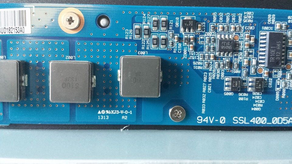

        i have checked the the out put of LED driver board its putting out 118.1mv

          Re: Toshiba LcD TV 40L1333b sound no picture
          pics

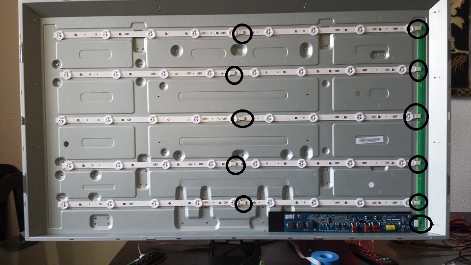

                thanks every 1 the back light is working now i could not have done it without you
                it was these little connectors i gave them a clean now it works

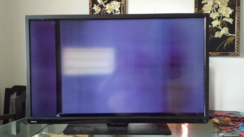

                      and now i have cracked the screen aaaaaaaaaaaaahhhhhhhhhhhhhhhhhhhhhhhhhhhhhh
                            What rotten luck. How did you do that? I was extra careful in handling the screen when i did it for my customer. I am glad that cleaning the connectors got the tv to work again but it would not probably not solve the issue. That is why i recommended to duplicate the connectors with bus wire so the issue would not return. The connectors are poor quality as documented in some russian forums. Its like doing an engine job and not replacing everything while you are that far in. Sure it takes a little more time but worth it. I am glad i could help you though.
                              the screen was just out of place when putting screws back in

                                If you read my post carefully i also made a mistake. I got a little too agressive with one of the strips and it cost me some time. I had to really scramble to recover. Ended up bridging the strip because the only ones that could be found were in russia and could not be shipped to the US. There will be thousands reading these posts and if i could impress anything upon them it would be to not try and pull the strips out of this tv without some heat source. They are glued down hard and the strips are flimsy. Like bud said, the panel is a dumb design. The sanyo that i worked on was sold by a big box store that we all know. Cheap set. I am quite sure your toshiba was not that cheap.
                                • zomi
                                  • Nov 2011
                                  • 512
                                  #36
                                  I used a heatgun set at 150 C and the strips came off very easily.
                                  Just incase any oneneeds to do it in future
                                  Just heat them for about 20secs and then pry them off using constant heat.
