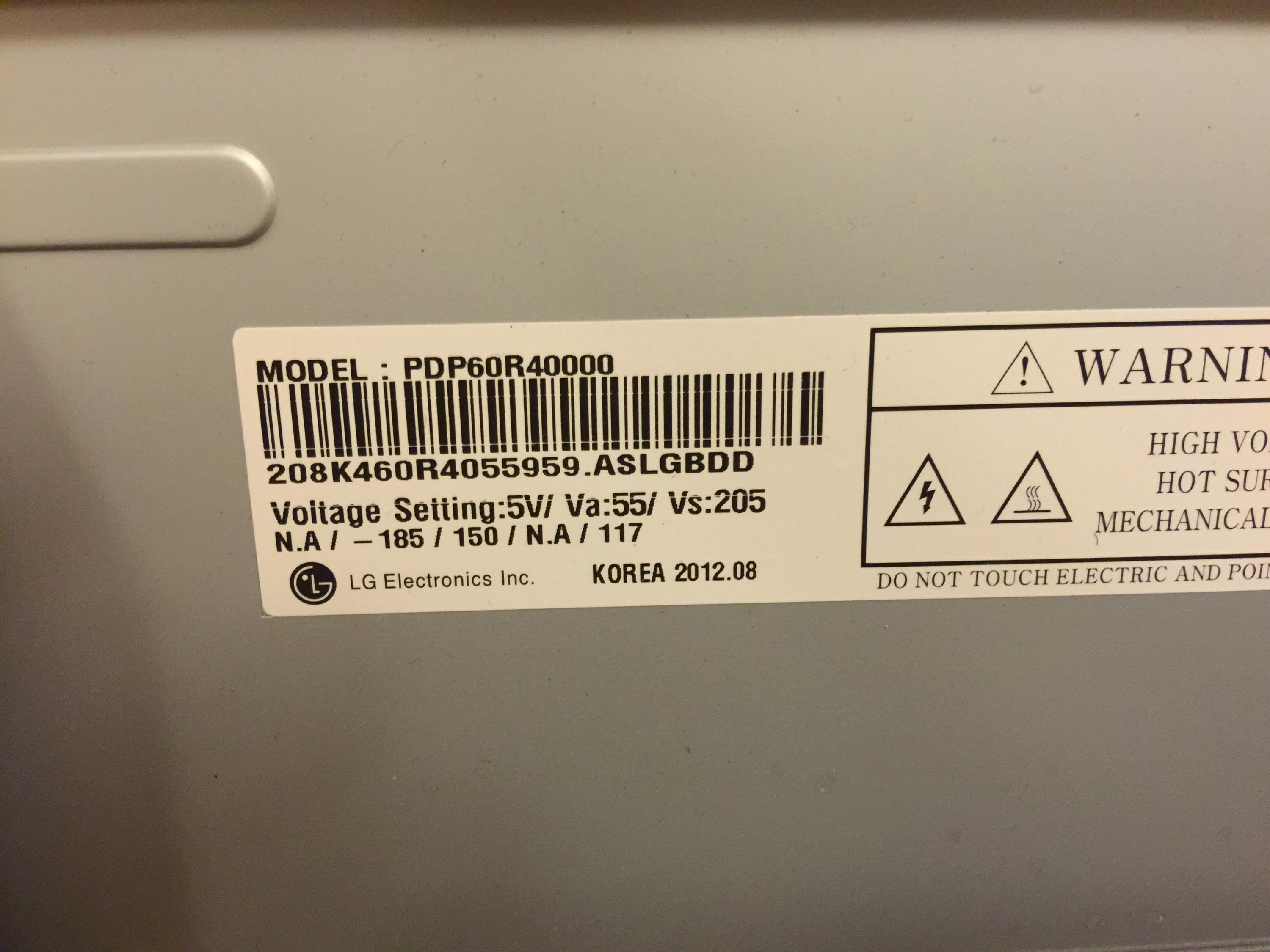

    Check all your voltages as per spec on the sticker inside your panel.

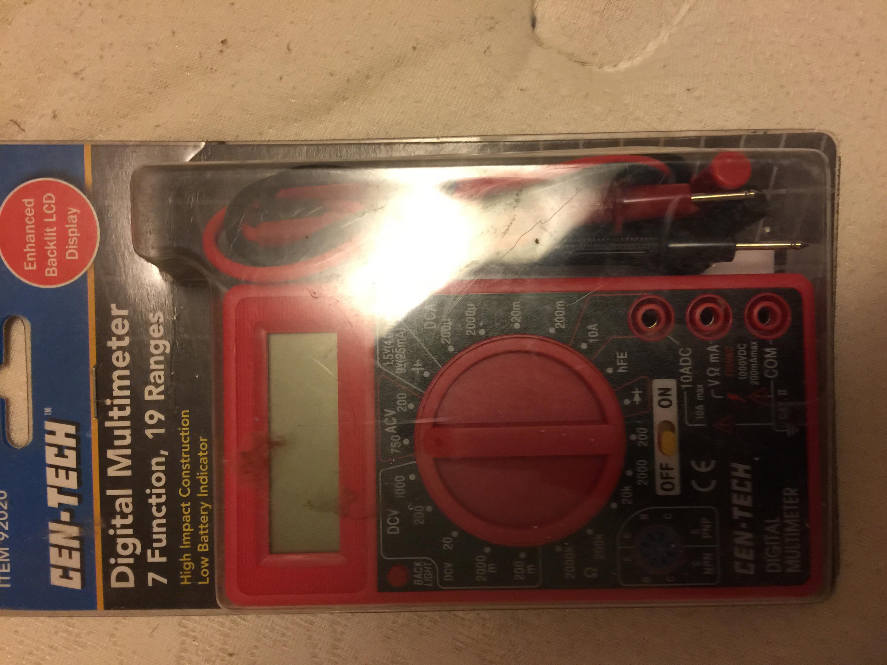

        Re: Lg plasma 60pa5500 picture issues
        Can you post a picture of your "gauge" (multimeter I presume)
        • Nrollins04
          • Jan 2015
          • 19
          • Usa
          Here is the meter

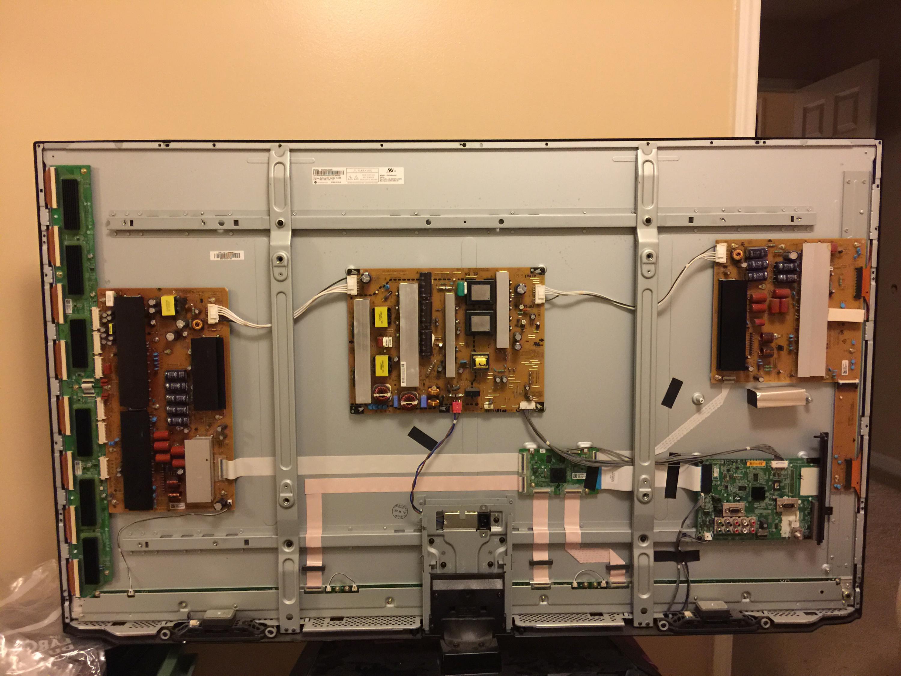

            Here is one of the back of the tv.. Having trouble uploading more than one pic at a time

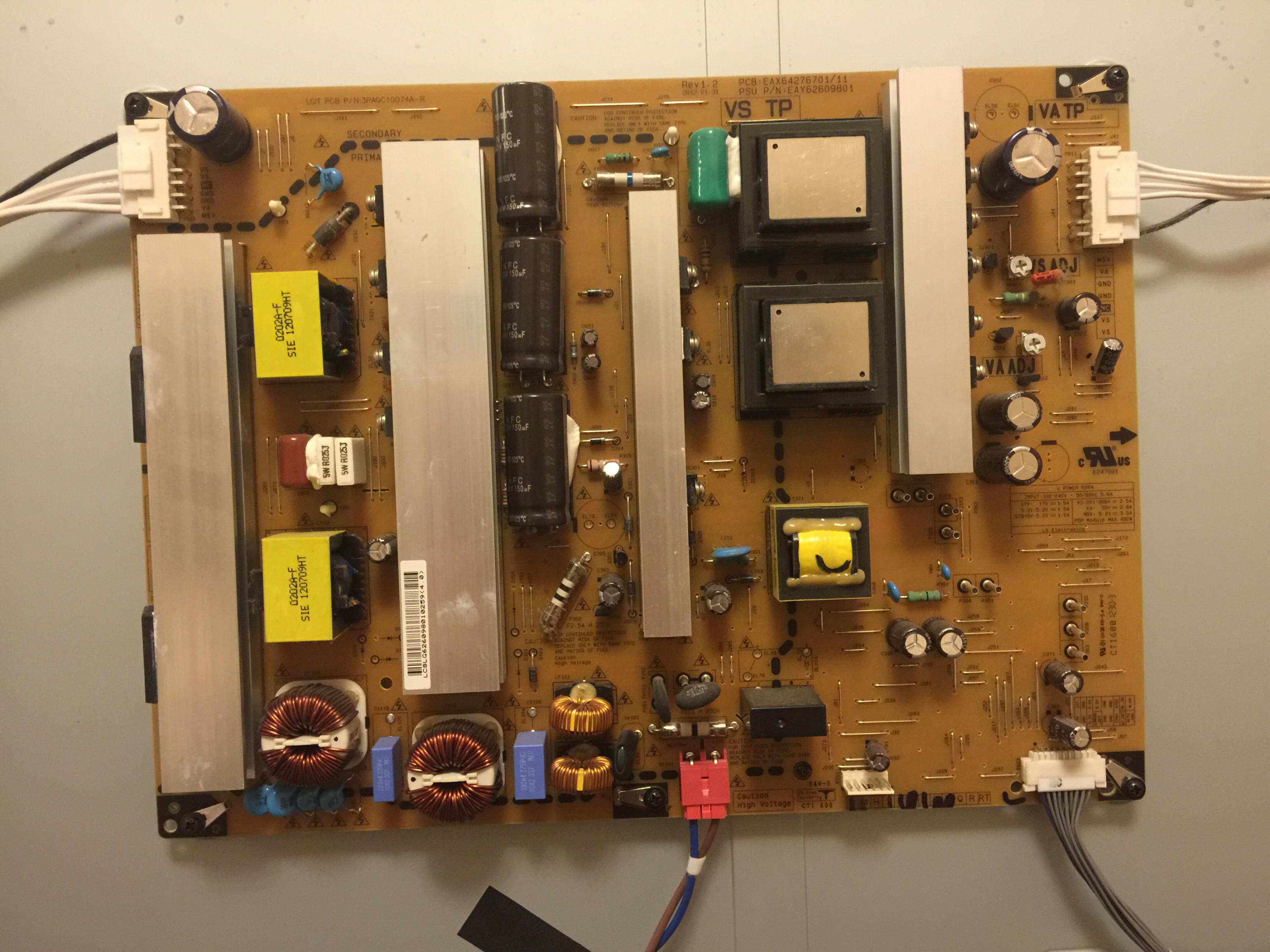

                            Better pics of each board will us help you figure out where to test each voltage.
                            PSU usually has test points for the VS and VA voltages. Top of board clearly marked. If these are not to spec then other voltages will be off. The value is on the sticker on the panel. Vsc and -Vy are on Y sus, VE is on X sus.
                            These voltages can be enough to KILL so be careful when testing.
                            When testing volts on the boards ground lead goes to the metal chassis of TV positive lead to the various test points.
                            The plastic screws are potentiometers for fine tuning each voltage to spec.

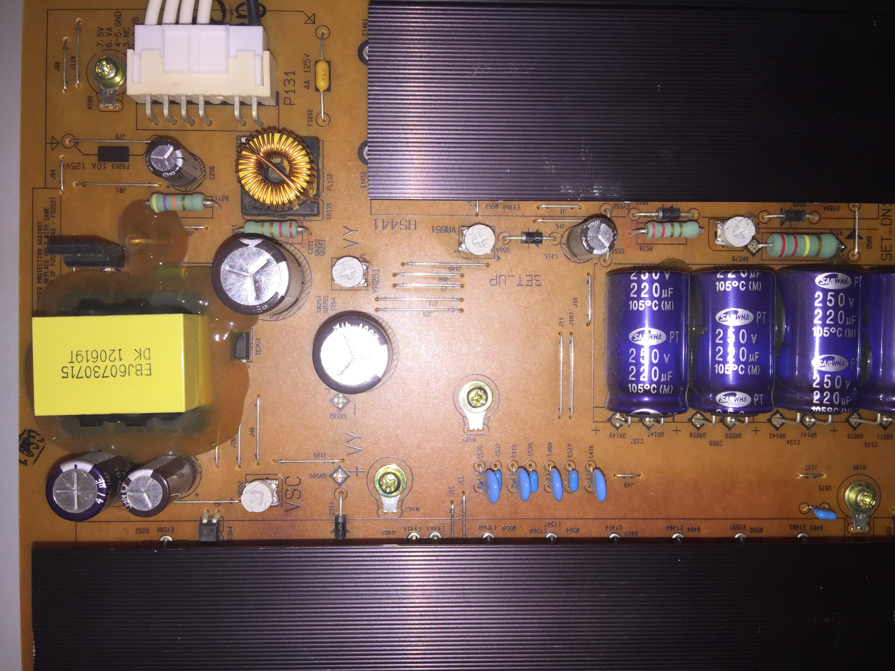

                              Ok thanks. I'll put a pic of y sus board up. When I installed the new y-sus board I turned the plastic screws all he way right thinking I was tighting everything up. I turn them all the way left and everything started working correctly wish I had know what they were from the get go. Glad I came back here to see what u guys said.

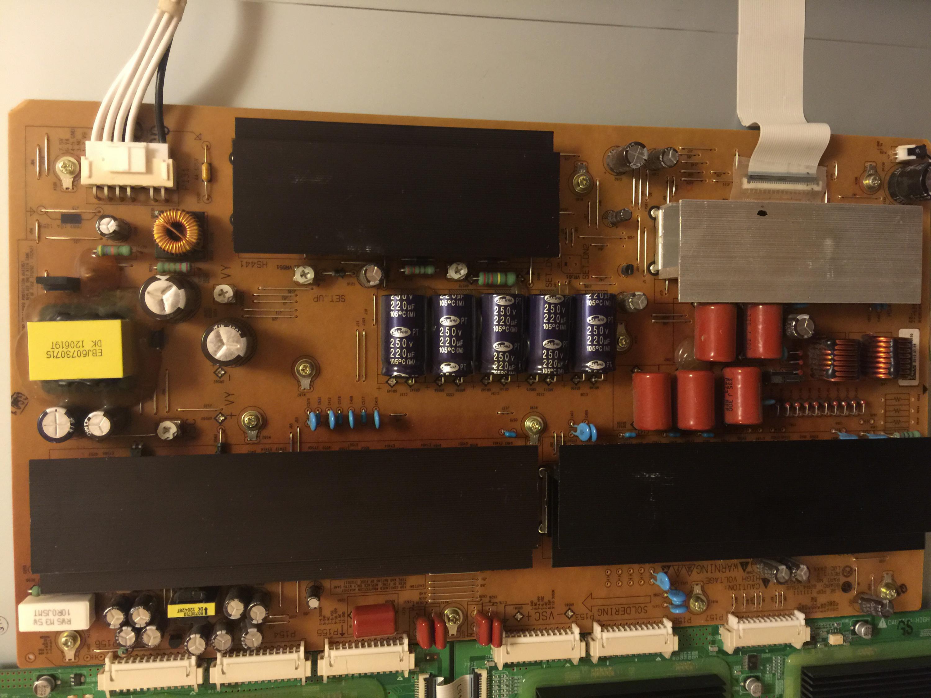

                                Y-sus
                                  Main power board

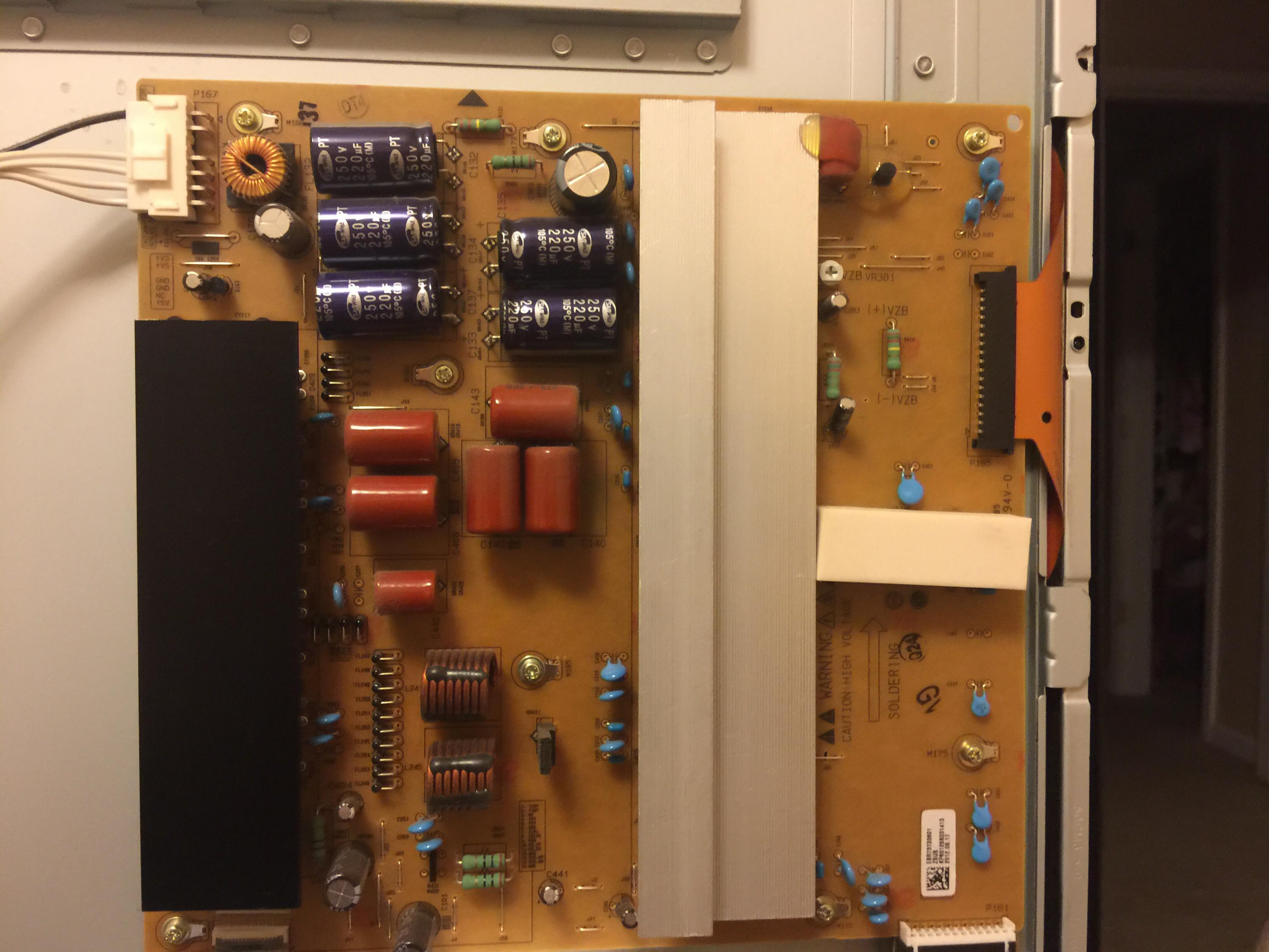

                                    X-sus

                                      Voltage settings. If I'm testing correctly VS 216 VA 58 Found the proper test points for those. Vsc is 67 -VY is 63 this is touching one of the legs where the plastic adjustment screw is.
                                      • MagicSmoke
                                        • Feb 2011
                                        • 275
                                        VS is high adjust vs pot to bring it down to spec. Vsc and -Vy is very low, -Vy looks like it should be -185v .
                                        I'm not familiar enough with the IPM boards to be more helpful but there are people here that will.
