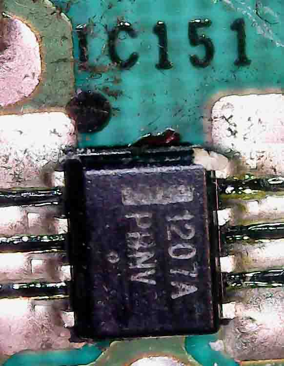

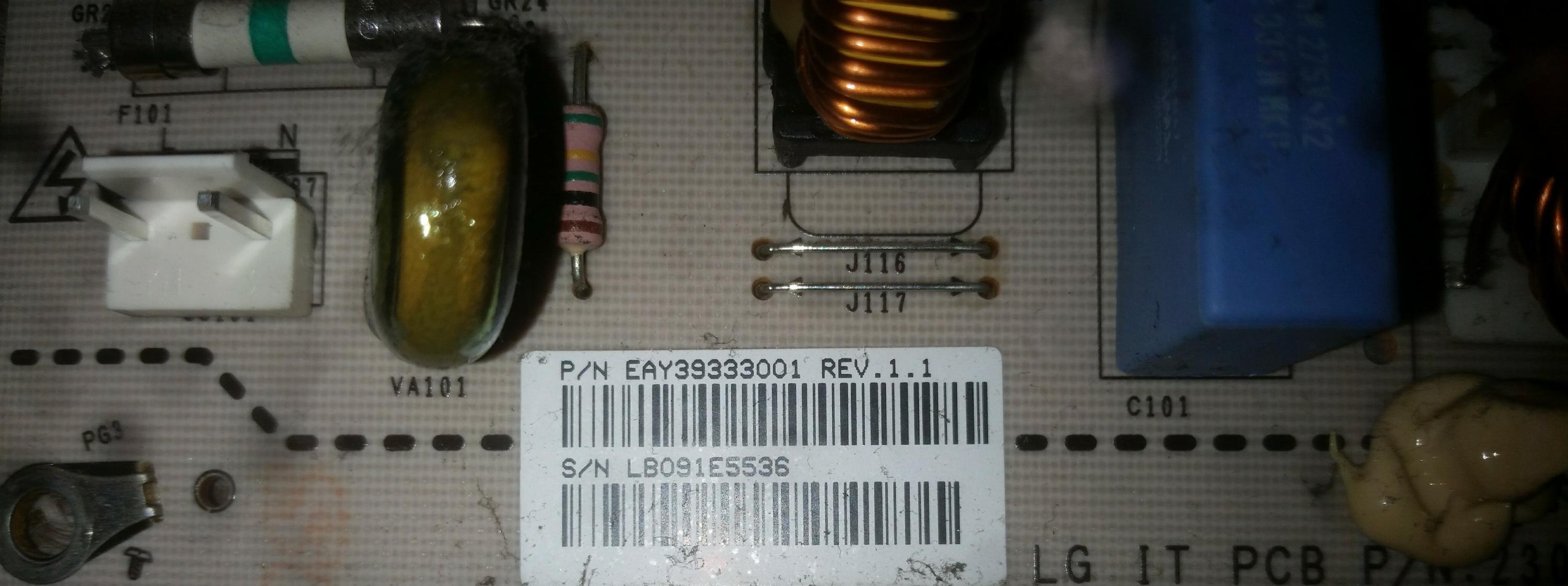

LG EAY39333001, anyone know part number of IC151?
    Top is blown off completely. It's a 8 pin SMD mounted on the solder side of the PSU and it's been destroyed by Q151 failing.
    Does anyone know IC151 part number?

    Re: LG EAY39333001, anyone know part number of IC151?
    sorry Tom, it looks like Shopjimmy has blurred out any and all IC numbers on their site I tried to blow it up as big as possible but no luck.
    I also had look at a few service manuals too with no dice.
      i think its a NCP1271B PFC controller IC,used on a few LG tv's,im not 100% though
        scrub that,its a 7 legged ic... 8
                      Ic151 = 1207a = ncp1207a
                      q151 = fqpf6n90c
