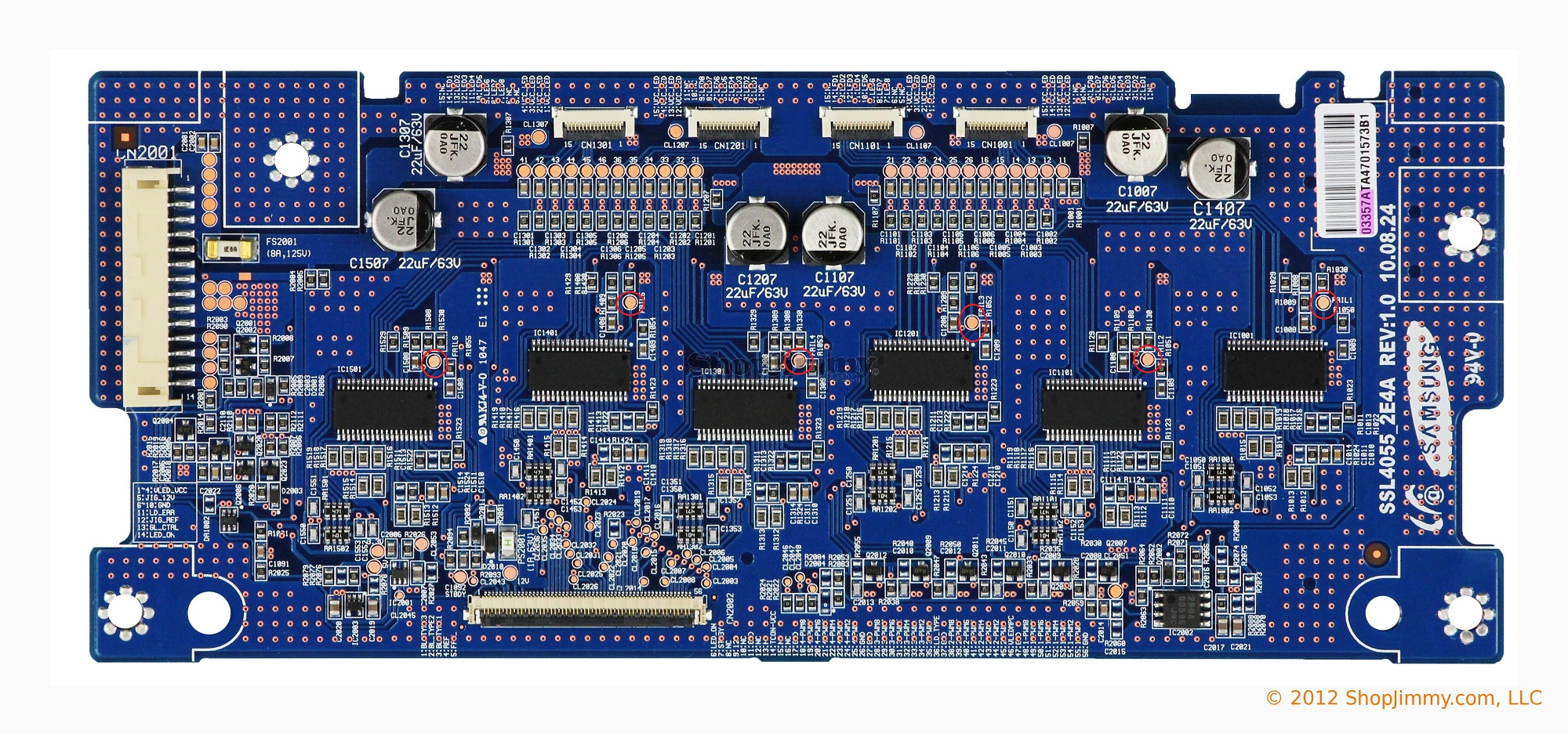

    I am working on a Sony KDL-46HX820 and am getting the dreaded 4 blink error. The screen comes on and everything appears fine for about 5 seconds and then it shuts down and the standby light blinks 4 times. I'm hoping the issue is with the inverter/LED board and not the panel. I've tested the voltages from the psu and all test within range. I'm wondering if there is a trick to these? a common problem on the inverter board that I can search for or a trick to bypass the failsafe?

    I had a similar a issue, with a NX720 and I have found some differences between ICs, on the LED driver board.
    Next to each IC there is a test point marked Fail 1,Fail 2,... Compare them and see, if you notice any difference between them.

      can can you post some good clear pics. of each board and one of how they are all connected?

        4 blinks could be your led driver board, not too familiar with led tvs, hopefully theres an easy way to test led driver board, ok I see tibimakai has a test procedure in post #2.

              I'm not and expert with these either, but this is how I have found the problem, by checking these test points. Course, it could have very well be the LEDs too, I guess.
              I have circled the test points.

                I had the similiar problem for this model, what I did was to disconnect the t-con cable from the main board, power on, then no shutdown, turn off tv, and connected the t-con cable again. This fixed it. I guess, was the t-con was too hot cause the tv go protection mode. Hope this can give you a hint.

                  It barely allows power through it long enough to test. After messing with it this morning, I noticed that the top part of the screen goes almost black. It seems like it's probably an internal LED causing the issue. Thanks for the help, but I'm going to scrap it me thinks.
