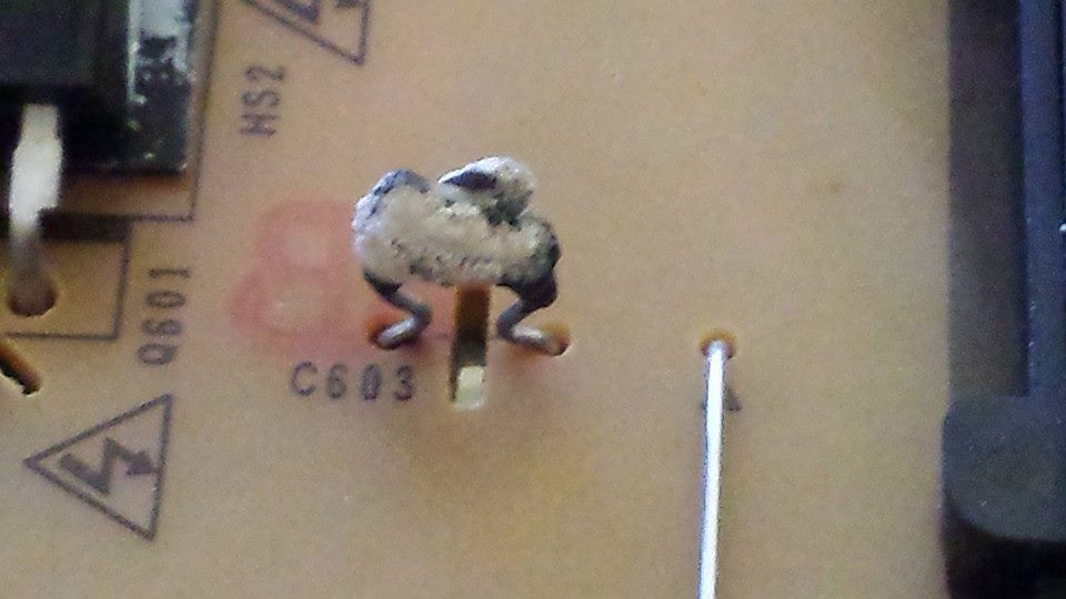

    Ok folks....as it says in the title.....I'm suspecting that North Korea killed my TV. We were watching "The Interview" on New Years day and not 15 min after completing the movie.....the TV went black. What really sux is that the movie did not live up to the hype at all......so why did you do this to me North Korea??
    Anyway...back to the issue
    I checked the Power board and found that C603 was burned beyond recognition. The board is a EAY 62512801 Rev 1.0. I downloaded the service manual however it does not have a schematic of the power board. There was a post recently by Sniper 82 with a similar board out of a 47LS4500. Just a visual of that board shows the same circuit with what look like the same components. I would be very appreciative if someone could identify this cap for me. I know its a ceramic disc...probably 220pF at 1KV but thats just a guess judging at whats around it. I havent done any further troubleshooting based on finding this cap in its current condition but if any of you gurus can give me an idea of what might have caused it to go. Thanks in advance for any info!
    CB
    P.S.......I'll post photos in a sec....forgot I cant do it from this computer

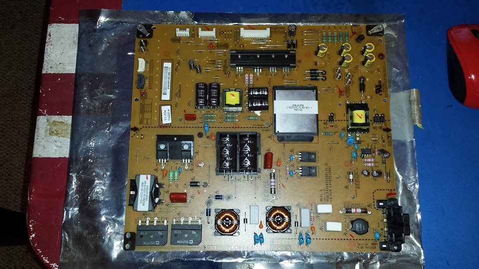

    Re: LG 55LM6200 no Stby 3.5vdc caused by North Korea
    Here are the pics. The pdf is a pic of the board that Sniper82 posted with an arrow and a note pointing to the suspected same cap.

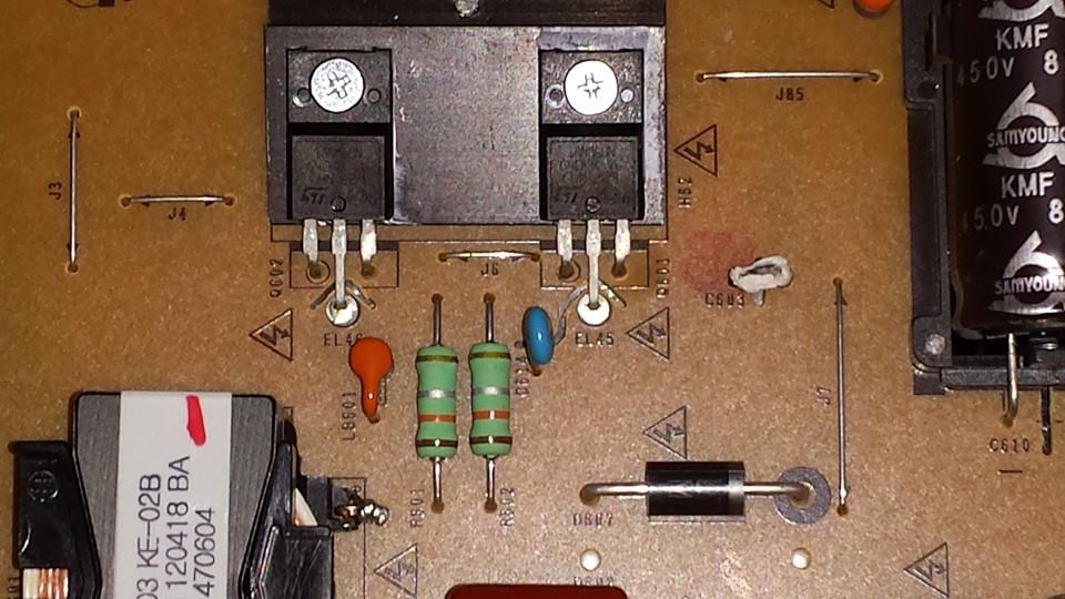

      • retiredcaps
        • Apr 2010
        • 9271
        You might want to check to see if Q601 (the transistor on the heatsink) and Q602 are shorted. In addition, see if D607 is shorted.
        Since the board is flat and pretty easy to access, you might as well check all the components on the hotside to see if the usual suspects like the bridge rectifier, diodes, SMPS IC are shorted.
          BTW, what is the value of C614 (right next to the two green resistors R601, R602)?

          • Castlebravo
            • Jan 2015
            • 9
            I was going to look at those. The traces go to one side of the transformer nearest these two transistors and the two bridge rectifiers. I cant seem to cross reference this transformer (inductor or current transformer?). Of course I left my meter at home so no checking till tomorrow...
            CB

                  • retiredcaps
                    • Apr 2010
                    • 9271
                    BTW, I made some edits in my previous posts regarding the pcb designation based on clear focused high resolution pictures I found here. In your pictures, it was difficult to read them.
                    http://assets.shopjimmy.com/media/ca...512801-top.jpg
                      That C603 cap is the snubber cap for D607, so check MOFSETs as retiredcaps suggested.
                      That section of the circuit is the PFC Voltage booster, it it is working the Voltage on the main filter cap should go up from 160VDC to >360VDC.
                      220pF 1KV or higher will be fine, I would go higher Voltage.
