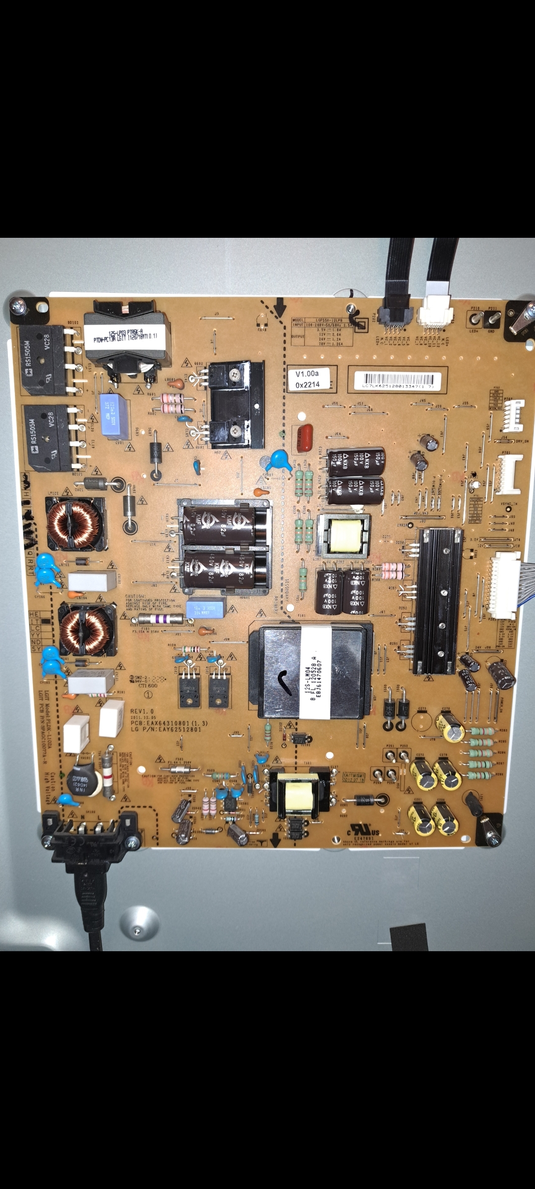

    LG 55LM6200 buzzing / humming power board
    Having replaced a brand new full led backlight set and fixing a mainboard fault (power-on transistor) theres now a louder than normal hum / buzz coming from the power board in the AC filter, namely in the LF101 / 2 area, or at least thats where the sound is more resonant whilst the backlight is set at 100%. Turn down the backlight to 50% its less noticeable and 0% its non-audible.
    When the rear case is fitted back on its more audible and its certainly more than an acceptable level so would rather solve than leave like it.
    Have powered on the tv with panel disconnected from the t-con and sound persists so think this eliminates the panel.
    Have started reflowing some of the solder joints on the AC side but sound still persists.
    I cant find it now but I came across a method to modify the led driver circuit, anyone know the fix or can direct me to it? thanks. I know this may not cure the problem but may be worth doing also.
    PSU board : EAX64310801 (1,3)
  • notallbad
    • Oct 2012
    • 1183
    So found the culprit, a failed diode D607 MUR460.
    Replaced and now buzzing gone! Back down to a susceptible level.
      Failed or failing?
      • notallbad
        • Oct 2012
        • 1183
        DMM diode test showed as shorted both ways.
