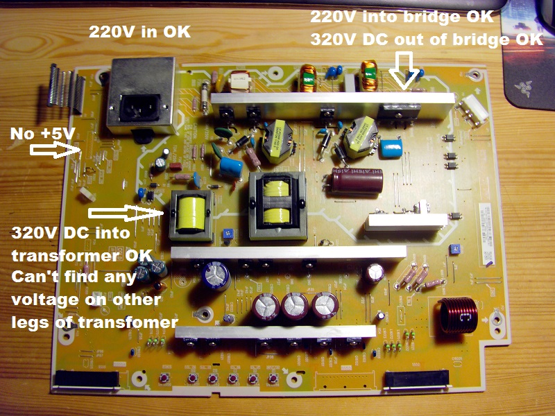

    I just got a defective Panasonic P50XT50Y plasma TV, that is totally dead;
    no lights no nothing. I check the power supply and there is no standby +5V.
    There is 220V in, this goes to the bridge rectifier and gets out as 320V DC.
    This 320V DC goes to the transformer, that I understand should output
    something that would end up being the standby voltage. However, nothing
    is on the other legs of the transformer(Darfon 1151 S)
    I have attached a picture with text!
    Any advice about what I should do?
    Thanks,
    Nicholas

    Re: Panasonic 50" power supply, no standby +5V
    https://www.badcaps.net/forum/showthread.php?t=36055

          Oh, it's a PSS, combined psu/ss board. crap.
            The board looks the same one I fixed the other day no 5v standby tv totally dead changed u203 all working again
              Me also replaced U203 the other day and got the TV working again, but in one spot the etching slightly lifted when I removed it and formed a small bubble because of the heat from the hot air gun

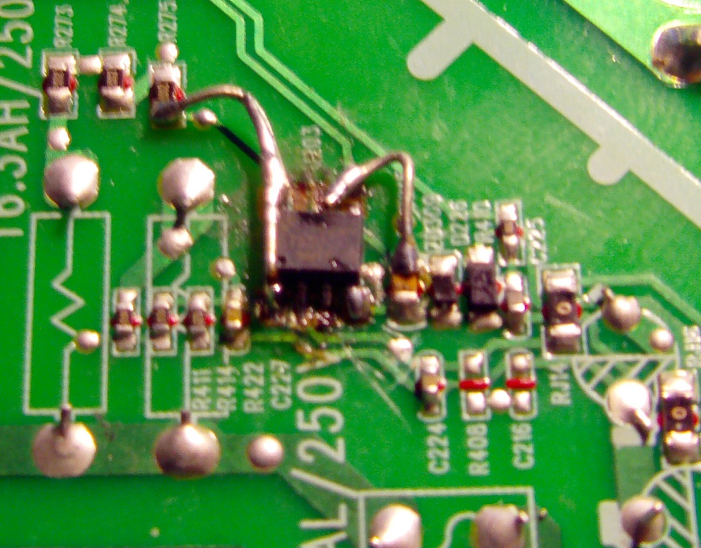

                Okay, it seems I should give U203 a shot then...I'll take a picture of the previous
                work on it. It is HORRENDOUS. I hope I can fix it.
                  Here you go:
                    Originally posted by Nicholas
                    Here you go:
                    OMG. looks very bad, dodgy and I wonder if the cct has been modified or jumpered. looks very wrong. also in that pic R410 looks sus as if it has a hole in it. I'd check that and the diode next to it. maybe it has not been replaced but attempted bypass or something ??

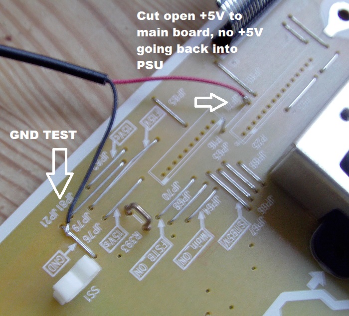

                      The R410 and the diode next to it looks fine, no holes or anything.
                      What is my course of action? Should I remove the hack-job, remove solder then sand
                      the area to see what the real world beneath looks like?
                      Also, could I test the TV set with an external +5V source, for standby voltage? If I
                      lift the STBY5V test point and the GND next to it, and attached leads to a 5V supply?
                      Just to see if the standby voltage is my only problem.
                      Thanks!
                      Nicholas

                      • tw2005
                        • Oct 2011
                        • 6458
                        Thanks!
                        Nicholas
                        never tried injecting 5v for stdby but might be worth a shot. I'd definitely remove all those rediculous jumpers and dewick it so it's neat. probably safe to assume that IC is dead hence it being butchered.
                        IC like that should be easy to get off. If you have 2 irons you could flow solder both sides and heat at same time and get it that way .
                        I would only carefully dewick those pads, no sanding, inspect the traces, get a new Ic. Does not take too much heat for pads to lift.
                        that's how I'd attack it. have you found the Darfon schematic to see how that IC ties in with the cct?
                          after dewicking, if you have isopropyl alcohol to clean it up nice for a good look.
                            I'll do that, remove it since it is not trustworthy as it looks now
                            Where do I get another IC for U203?
                              Schematics are not my strong point, haven't even looked for them.
                              ebay, china, google.
                              or PM
                              PowerAmpFreak who is in Sweden and verify the exact part number he used as i think there are 2 versions. He may have a good advice for where.

                                    • Neelix
                                      • Oct 2013
                                      • 145
                                      • South Africa
                                      Must be the 6755UW one yes. The 6755W is for a different frequency
                                        Ok, I'm ready for the external +5V test(for standby voltage)
                                        As seen in the image below, I cut open the jumper and soldered the +5V, so it
                                        only goes out to the main board, not back into the PSU. I soldered the GND to
                                        the GND test point (did not cut it open )
                                        Should I test it in the TV now? Any reason it would do something wrong?
