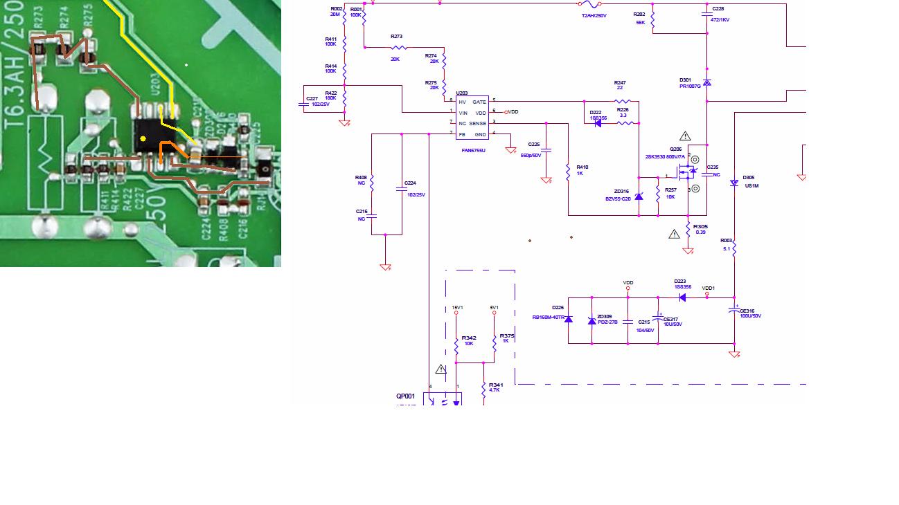

            Update. I got the ICs and removed the old one from the PSU board. It's a real
            mess, all the solder pads + some traces are gone.
            Does someone know where pin 1 should go? (See attached image beneath)
              It shows you in that picture, goes in as drawn. pin 1 is bottom left

                He means, where does the trace actually go to? His pads and traces are gone and he's trying to figure out where it's supposed to go, what pin 1 is actually connected to, I believe...
                I don't have one here to look at for him, unfortunately...
                Anyone have good pictures of the back of this power supply board or an actual board that can look?

                  best guess using a photo and schematic

                    Yes, not the direction of the IC but which leg goes where
                    tw2005, thanks! That really goes and above the call of duty. I'll go back
                    in when my daughter gives me second.
                    Thanks a lot for the drawing!!!
                      Nicholas
                      If we had a clear close up of yours without the IC in place that would be handy to see what's under the IC. If it's just pin 1 then I'm confident about what I have but pins 3 & 5 not so sure. had to rely on the schematic to have a bit of a guess as that photo is not clear enough.

                          Hi guys, a managed to solder on the wire to pin 1 on the IC, and the TV works!
                          Thanks for all your help, especially tw2005's drawing!
                          So, another thumbs up for the U203-solution!
