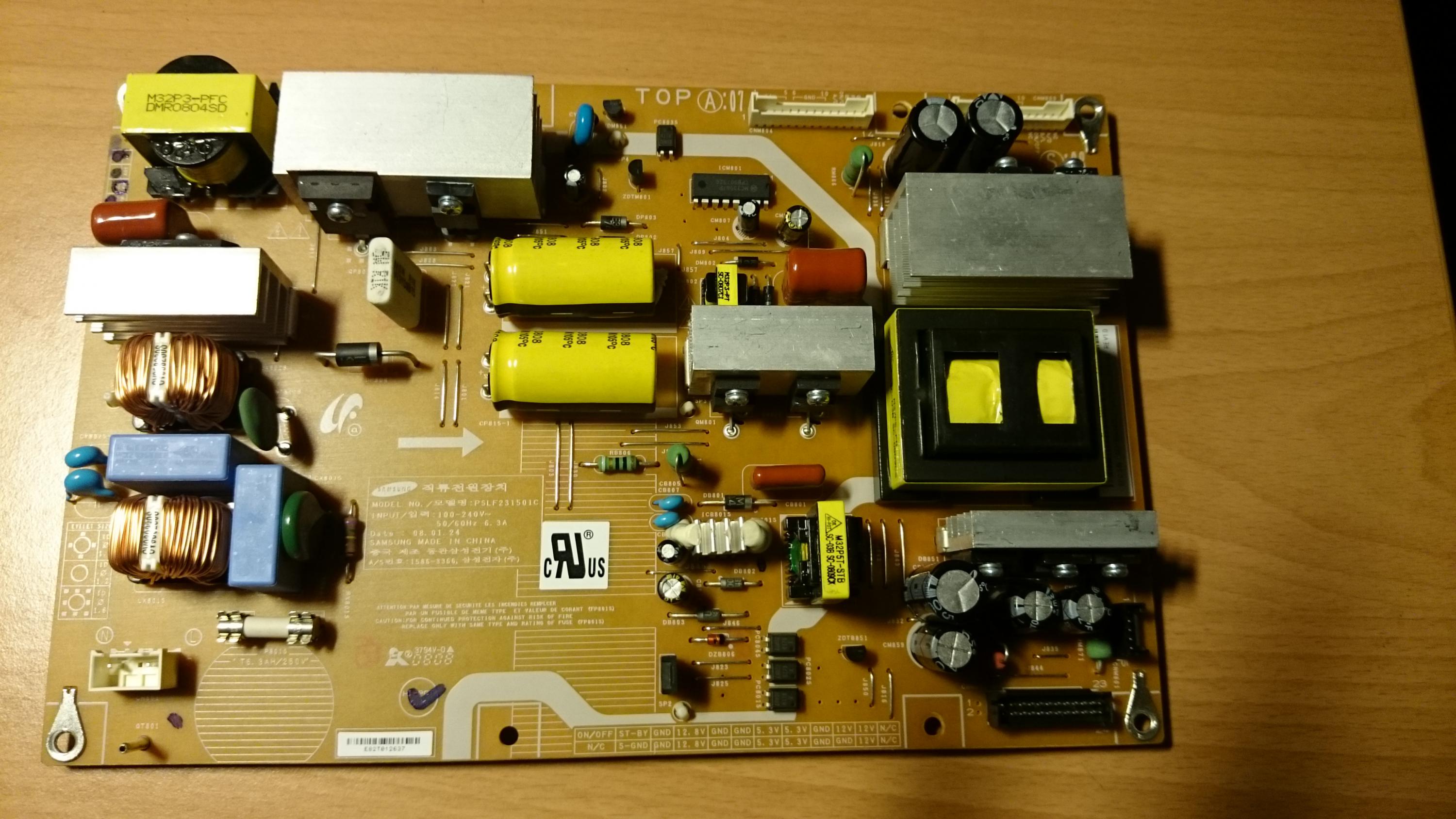

              Can we see good clear pictures of both sides of the main board, power supply board?

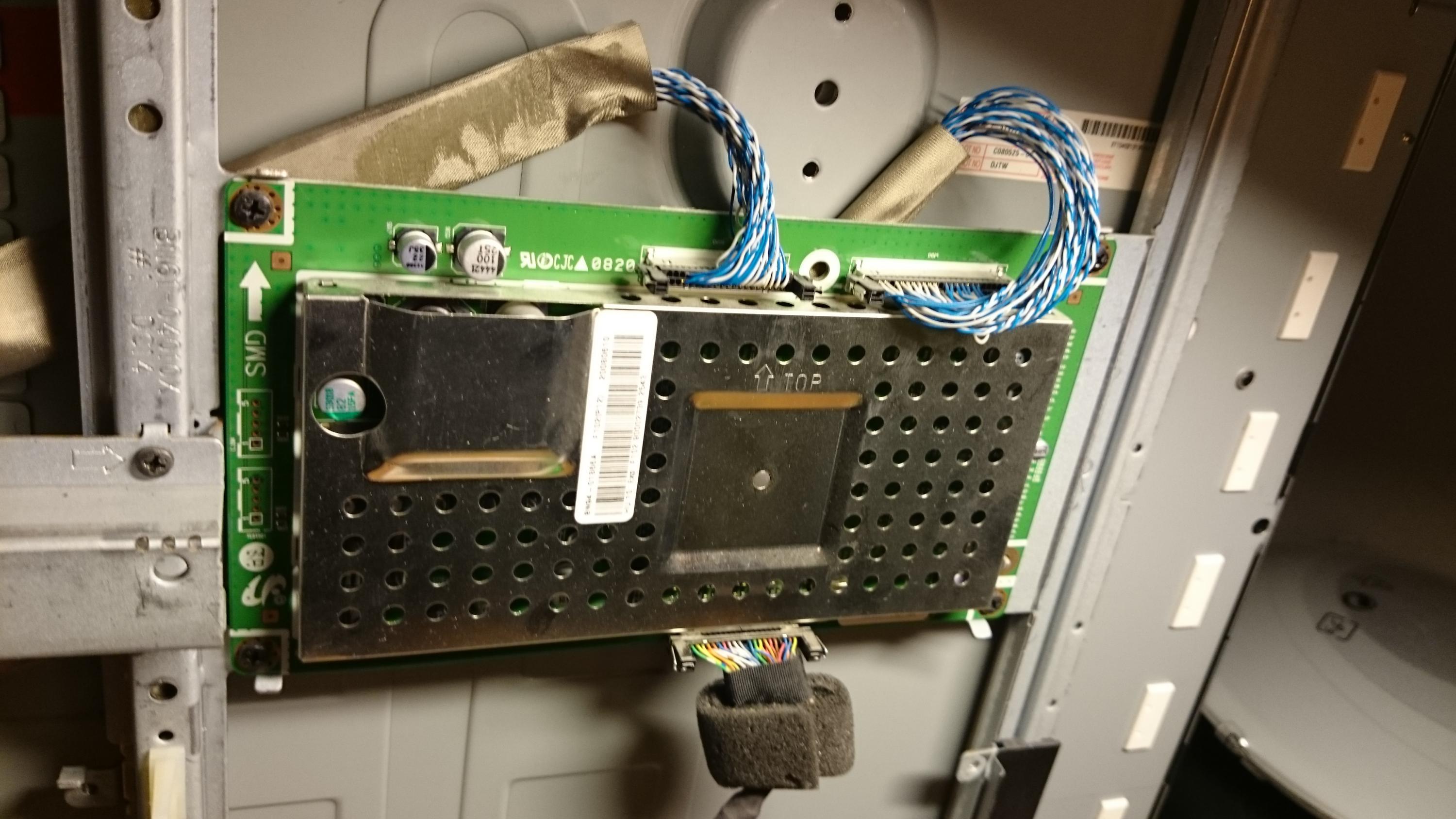

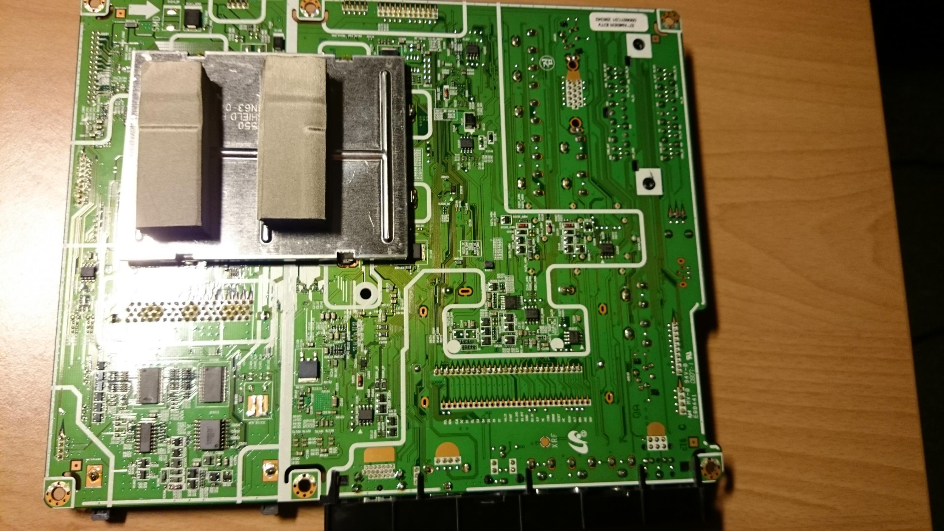

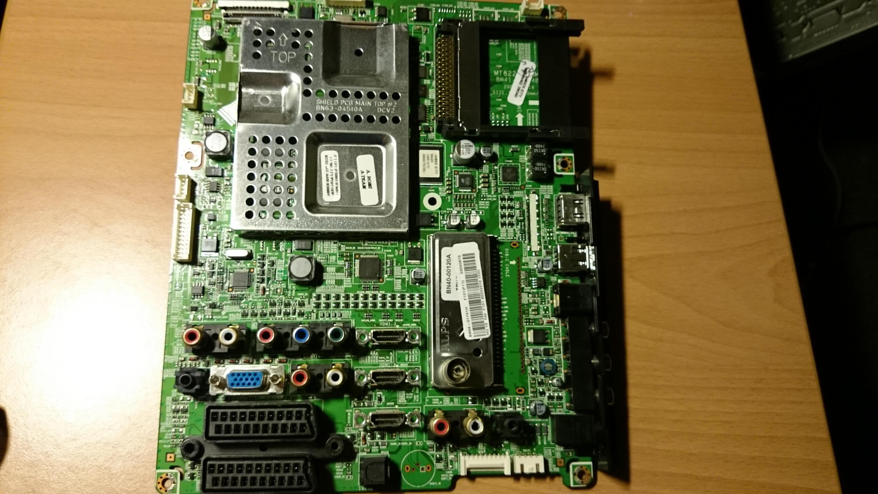

                Re: Samsung LCD LE37A656A1FXXC , trouble starting up!
                Thx for the replies guys! Much appreciated!!
                Here are the pictures , tv is acting like its in a bootloop or something...

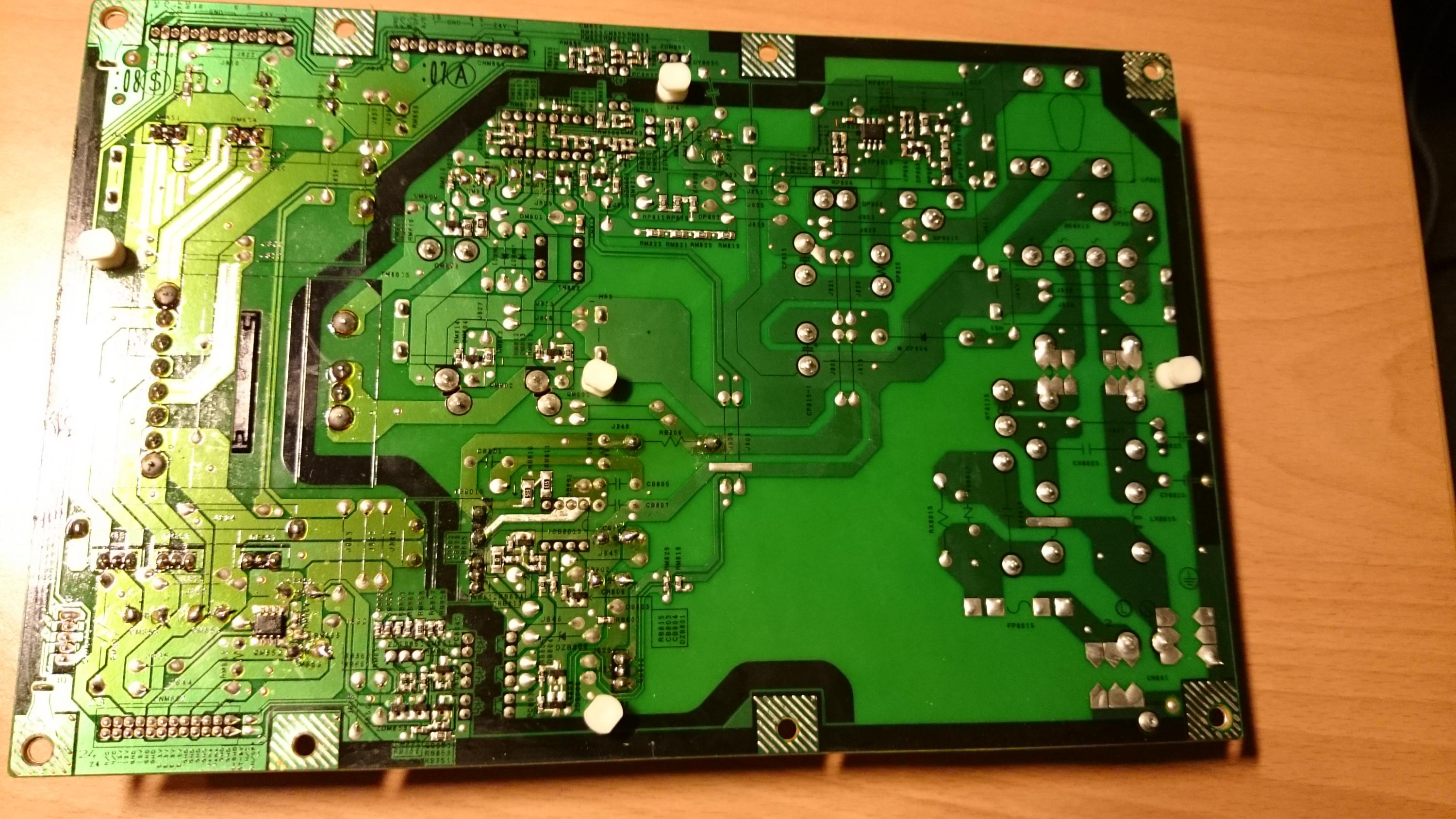

                  Back of the PS

                          Ok i disconnected the 2 boards ( T-con and … ? ) and the TV starts up , red light is blinking really fast but i hear sound. It starts up quicker then normal.
                          Im suspecting the board on picture 4 , is that a video board?
                            It looks to be FRC (Frame Rate Conversion) board.
                              It will have a part number on it somewhere and perhaps the number on the barcode sticker?
                                The numbers as printed on the barcode sticker is the PCBA (Printed Circuit Board Assembly) number that you need to match, not the blank board P/N as printed on the board with white letter.
                                The picture is not clear enough for me to read the numbers on the barcode sticker.
