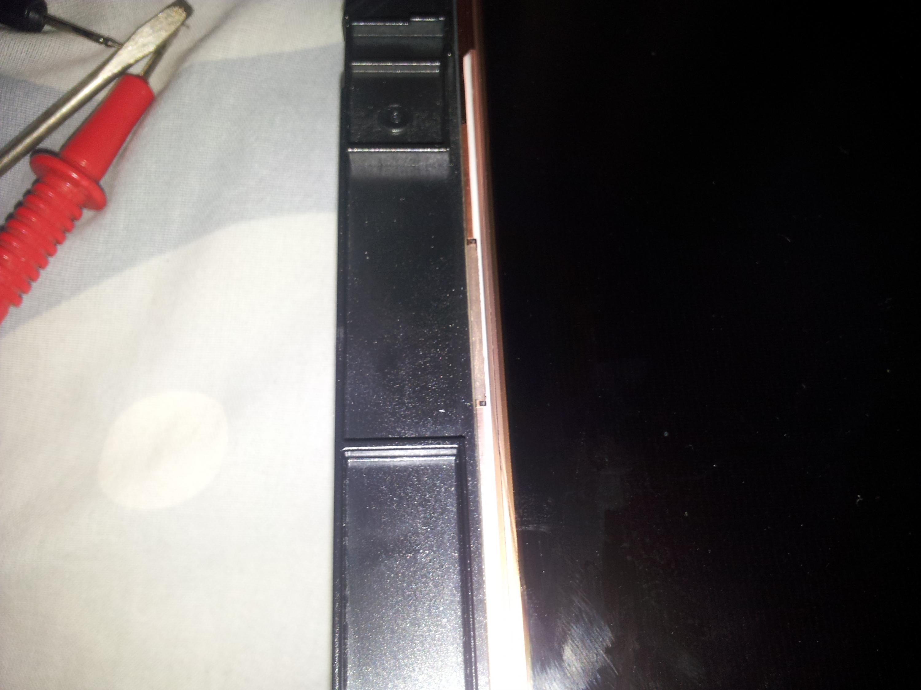

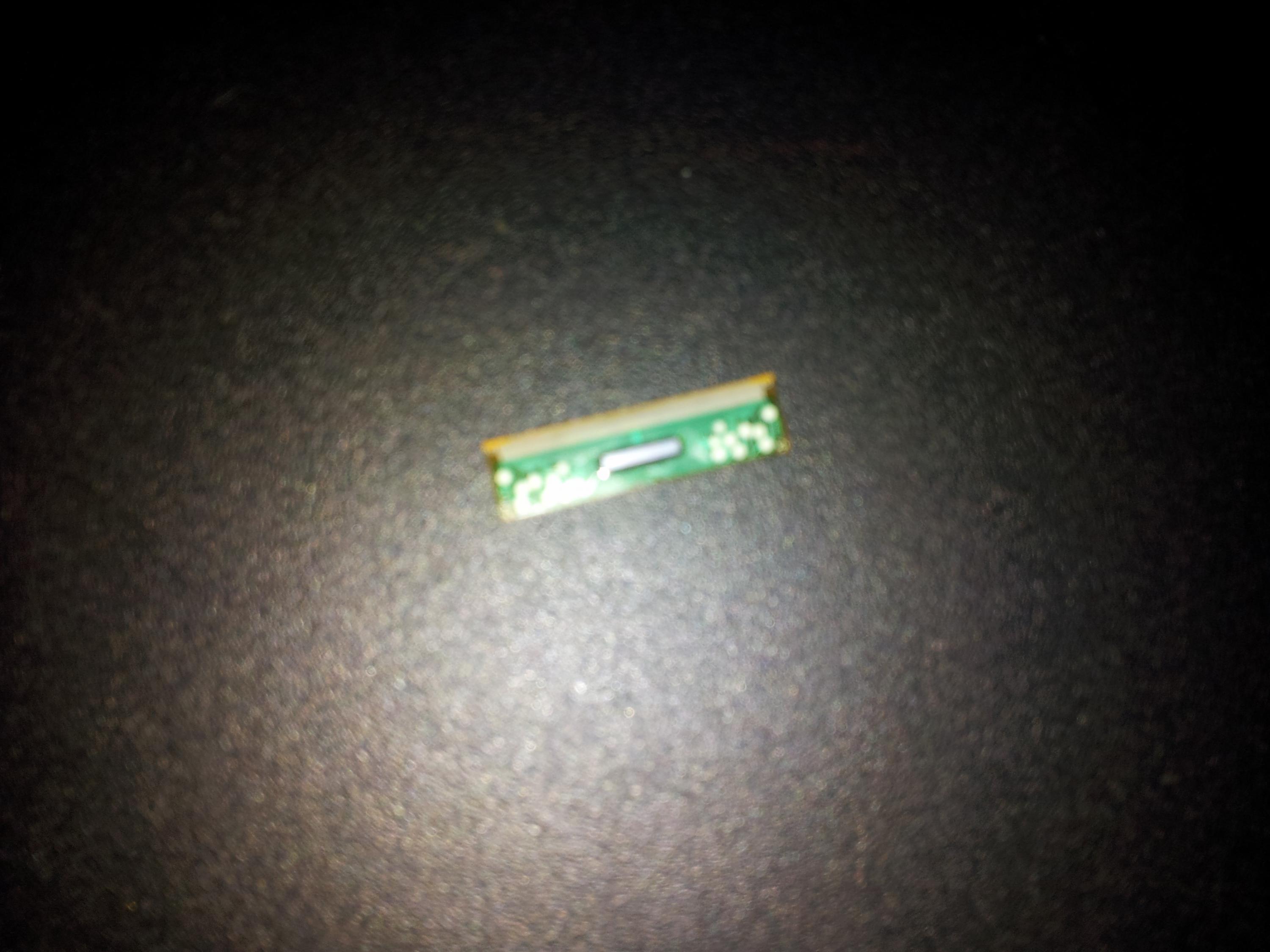

              Hy, it was the backlight problem, plastic behind backlight line was broken, so spark was jumping from + to ground on backplate.
              But now i have even bigger problem :SSS
              I pulled some part out of upper layer of display :S
              Can i do something to fix it? here are the pictures
              Please help, i feel like shit right now :S
              Thank you

                Re: Panasonic LCD TV turns off after few seconds! HELP
                That's a tab bond from the lcd display. Not repairable.
                  That panel is toasted!
