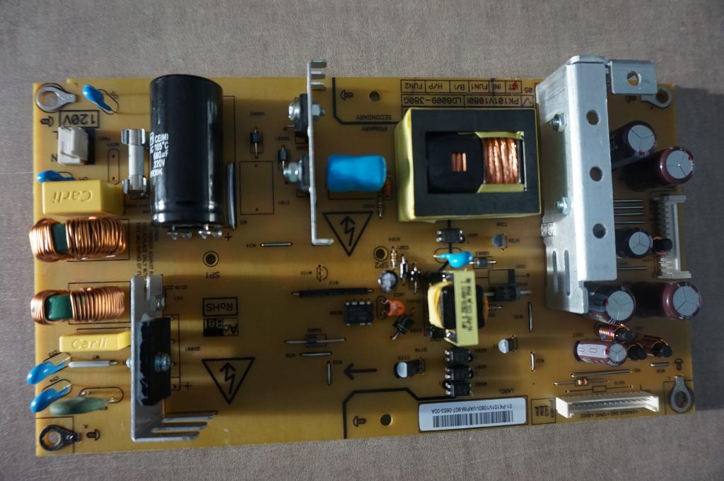

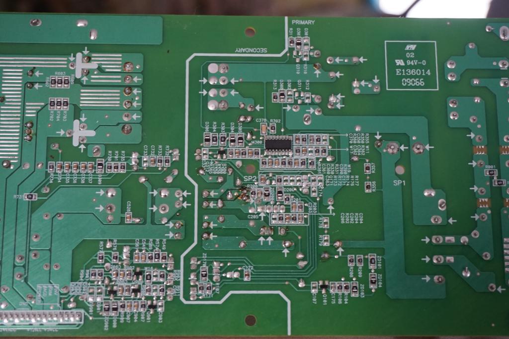

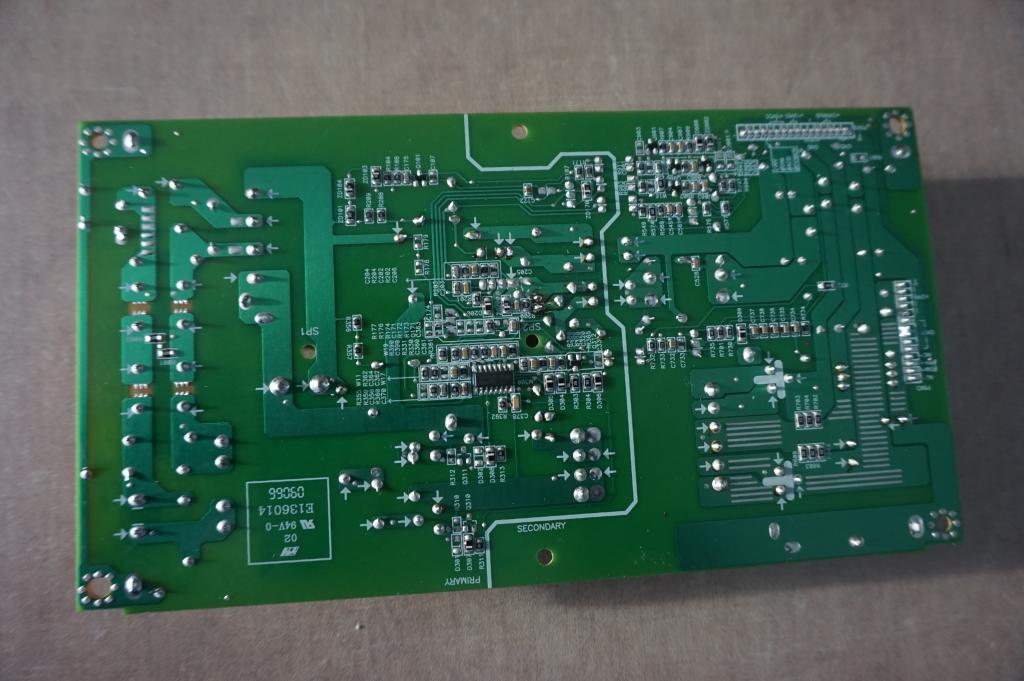

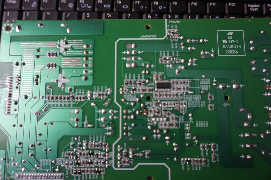

    Toshiba 37AV502R off/on
    This tv shuts off by itself , i tested the caps on the psu and everything seems to be ok , i use the hair dryer to test one of them and it brings back the image and sound , so i changed the capacitor (c 207) it lasted one day then the trouble came back ,anyone else had this kind of prob ???

        Not much I can suggest without pictures of your boards - see "sticky" for how to post
        https://www.badcaps.net/forum/showthread.php?t=39740

              not sure if it is applicable to the 37" but budm had a 32av502r with a leaky signal diode on the power supply causing an unstable 5v I believe it was d200 (smd 1n4148)
              Liberating magic smoke one part at a time
                Re: Toshiba 37AV502R off/on
                In other thread for the same model I requested the OP to provide good clear pictures of the bottom side of the board to see if it uses the same circuits as the 32" but I never get the pictures I requested.
                https://www.badcaps.net/forum/search...archid=4300100
                This is the 32" version that I fixed:
                http://s807.photobucket.com/user/bud...in=true&page=1

                              As mention before to Budm the board is exactly the same for the 32 and 37 inches Tv
                                Yes, it did fixed the problem, took me a while to find out until I got the IC SPEC. At first I thought it was the startup cap because when I heat up that are the 5VSTBY becomes steady, replaced the cap then it works for a couple days and then doing the same again, the 5V will be fluctuating, replace the diode with 1N4148 and the TV has been working ever since, I still have the TV at home.
