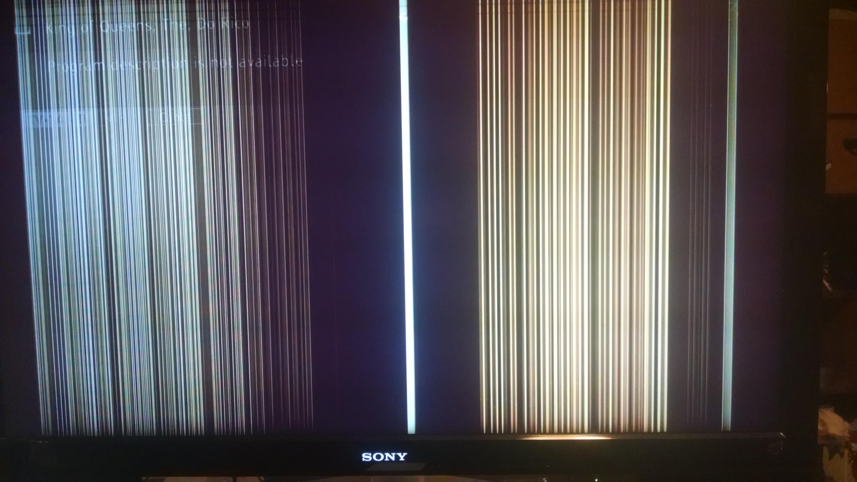

    I have a Sony 46WL140 that has vertical lines when first turned on after being unpluggged for a few hours (See photo). After about 5 minutes, the lines go away.

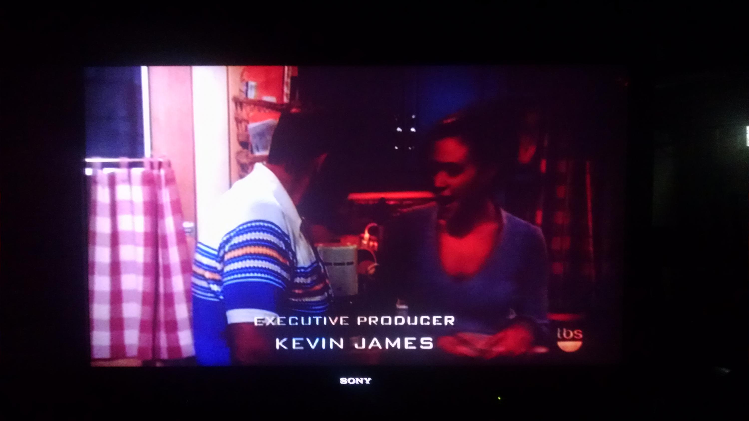

    After the lines disappear, the image is dark except for the left side and ghost images appear on the right side(see photo). After 15 to 20 minute, all problems go away and the picture looks good.

    Re: Sony KDL 46WL140 vertical lines that eventually go away
    Can we see the screen shot? It sounds like typical bad tab bonding problem.
        Oops. Here are the screen shots. Thanks for responding.
              curious, when I had a bad tab bond, the tv come on was blotchy like your pic., then gradually got darker to just about black.
                Looking at the screen shot, it may not be tab bonding.
                Can you try flexing the screen to see if it will change.

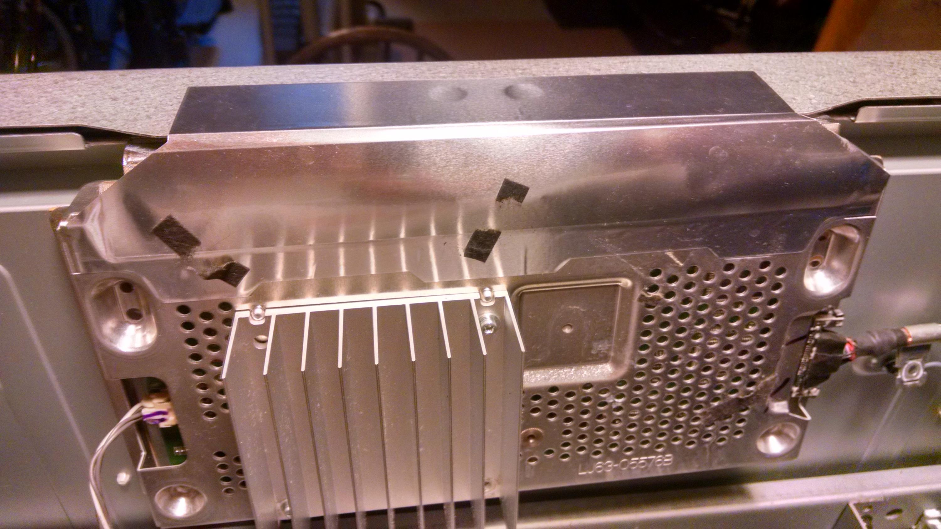

                  This aspect is all new to me, so please understand that I am experimenting more than following a guide to fix the issue.
                  I removed the plastic and have moved the metal back just far enough on the corners to put some thin cardboard shims in. The picture then looks great! For a bit.
                  When i tighten the screws the middle darkness and ghosting appear. Tapping on the loose screen does nothing, but pressing on the upper right corner changes the picture. I think I need to bend the screen slightly outward in the upper right corner to get a constant good picture.
                  A question: I am limited in getting to all the tabs by the metal connector from the heat sink to the frame. (See photo) I am really a newbie so I am asking what does the connector do? Is it a ground? Can I peel it back and reconnect it? If I can remove it, I can get to the screen so much easier to put in shims.
                  Can i remove it and what's the best way?
                  Thanks again. I feel I am almost there!!
                    more than likely its not all the tab bonds that are bad, try checking each one or at least the ones you can reach, see if the pic. changes.
                      Of course, one of the places that needs a shim is next to the foil connector. I am going to get a hair dryer to remove and then replace to give me more room.
